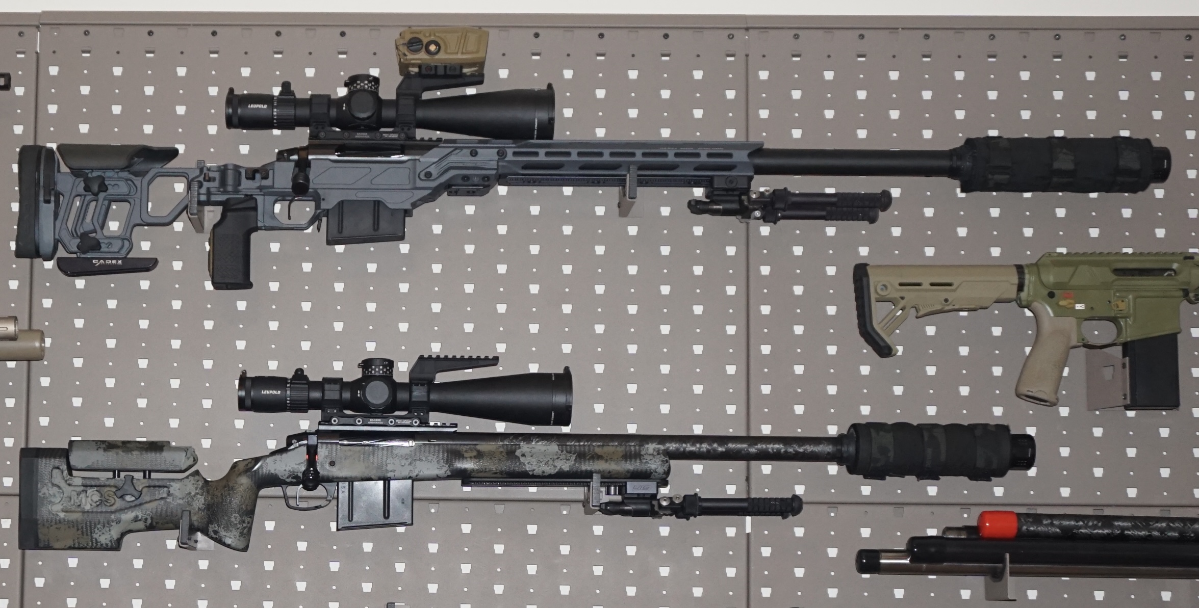

    This is going on a 700 action I am doing nothing with currently, and only want it for a cheap alternative for a true hunting rifle, sub 200 yards in 300 Win Mag, and I will upgrade suppressor to the longest model. I may shoot it farther, but I will not pick this up over the other custom guns I have for my 3-4x per month long range shooting (attached so you don't have to call me cheap, or think this will be my 1k yard gun)
    Does anyone else have thoughts on this and/ or considering it? I normally am extremely suspicious of cheap gun parts (again, see picture), but for some reason, this one has me intrigued. https://getoutlier.com/products/308-7-62mm-backdraft-cf-barrel
