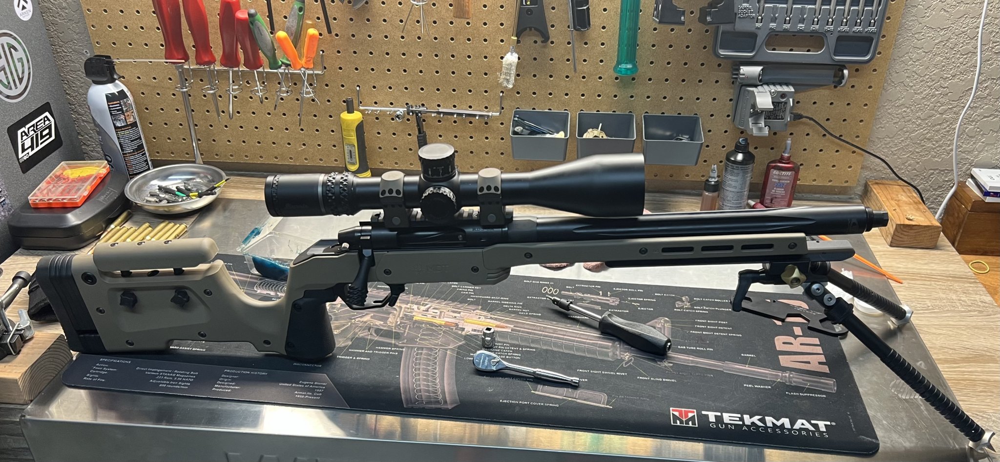

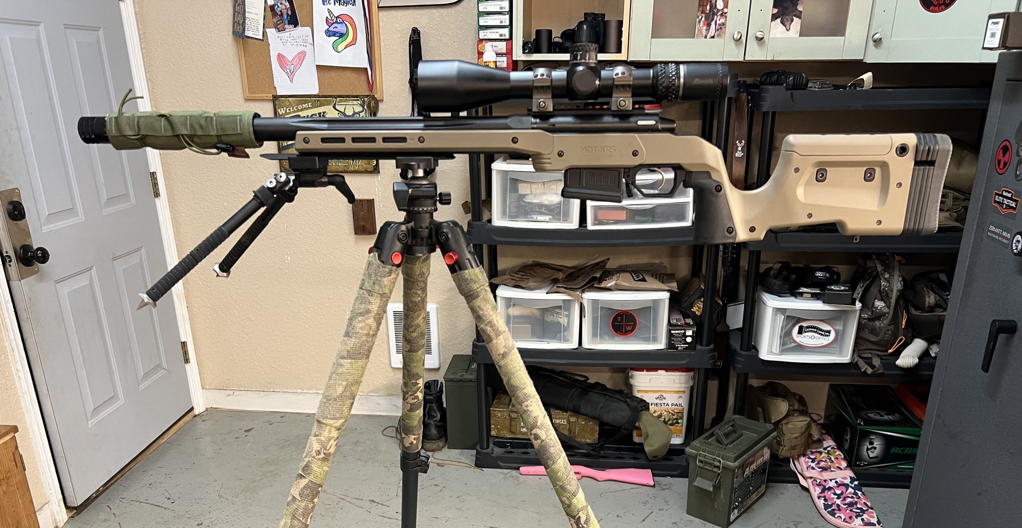

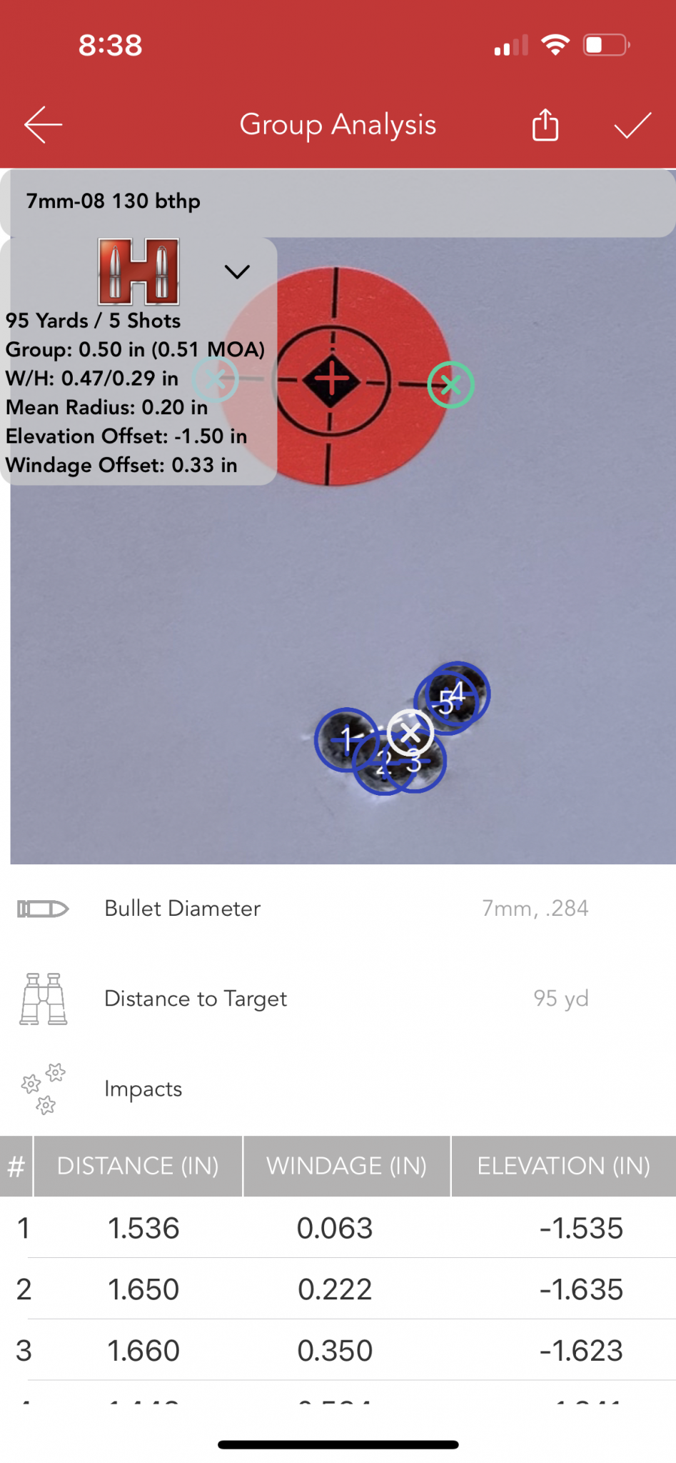

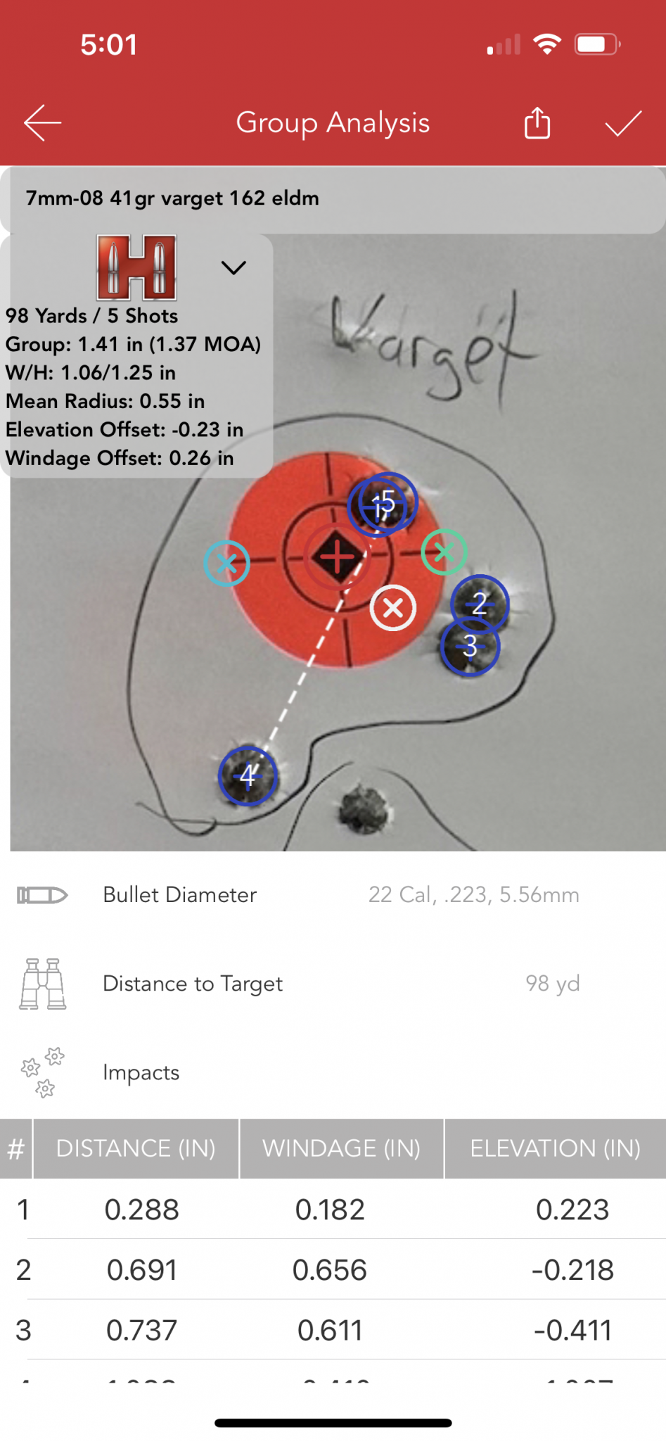

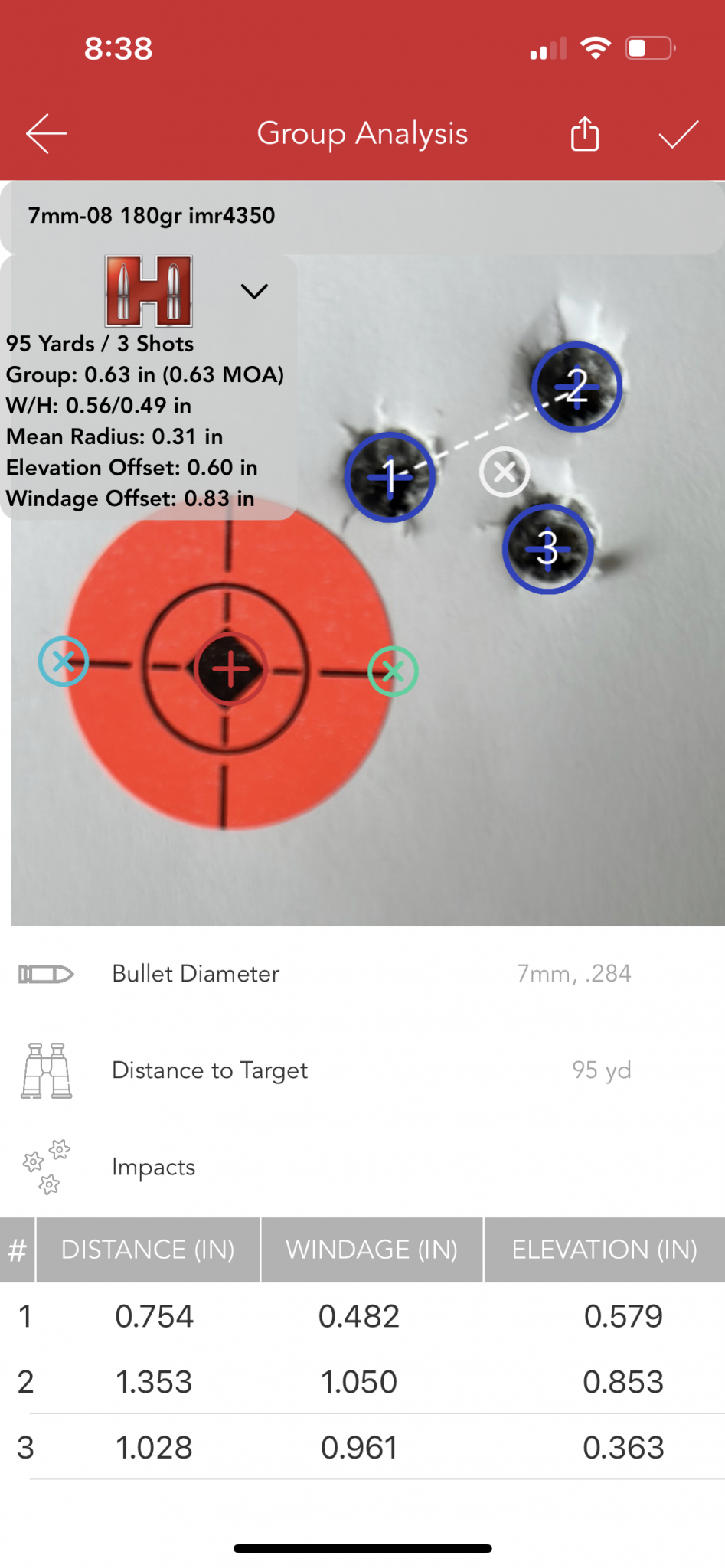

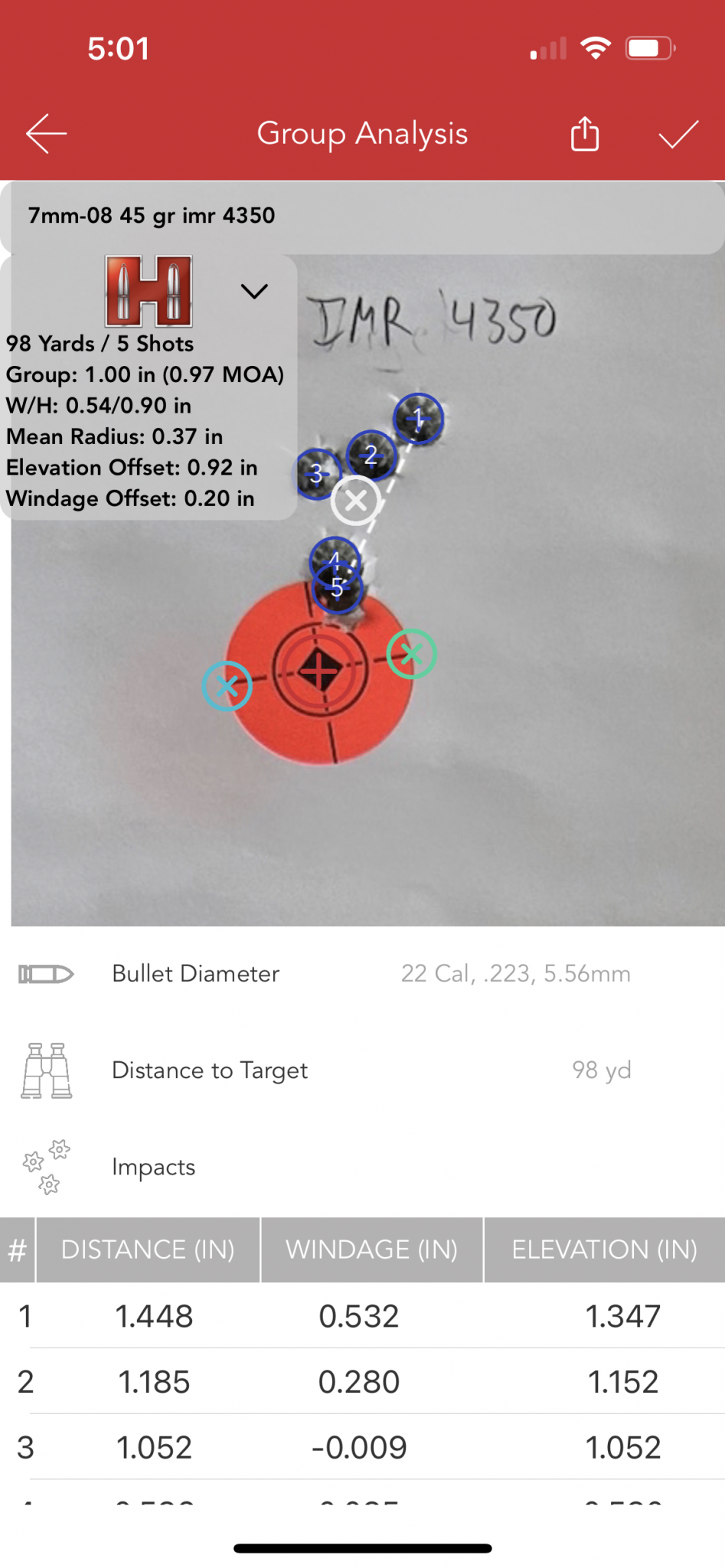

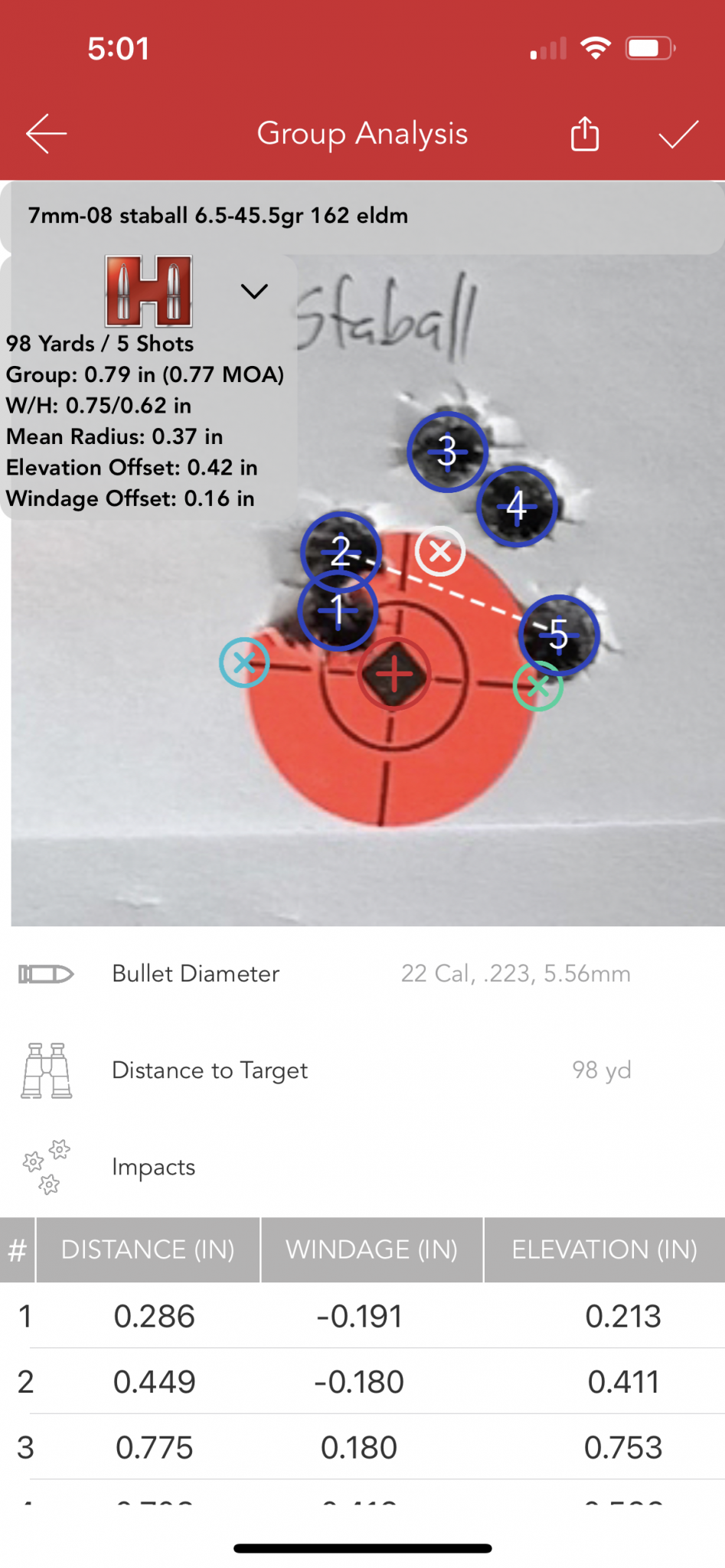

I Ordered an Arken EP5 and an outlier 7mm-08 26" Nitrided Howa prefit on Memorial Day for $630 shipped.
I did not receive a shipping notice for the barrel or scope. The scope arrived in about 7 days and the barrel 10 days.
Initial impressions of the barrel were it was packed in a hard cardboard tube with adequate protection. It had a thin layer of oil on it but there was still some very light surface rust on a 2 inch section of the barrel. The first thread on the barrels tenon was a little rough but all of the rest were very nice. The barrel is a straight 1.2" and has a CNC zippy surface texture (it was machined quickly with a single pass). Barrel weight is about 7.5 lbs.
I loaded up about 60 rounds of various bullets and powders just to kinda see what the barrel liked and do some break in. The first 20 shots were with 139 gr Hornady SP and 140 gr Sierra BTHP loaded with A2520. It would only hold a 2-3" group with these rounds and had me pretty worried tbh. The next 10 were with 130 gr Sierra BTHP and Varget these produced a 3/4" and 1/2" 5 shot group at 95 yards. 168gr sierras and 180gr sierras grouped around 1 MOA. It is advertised as a hand lapped barrel and I 100% believe this because it cleaned up about 3 times faster than a factory barrel and had very little copper fouling.
The next day I loaded up 15 shots of 162gr ELDMs with 3 different powders to do some velocity and accuracy testing.
The pictures below are 2 best groups from the first day and all 3 groups from the second day. The varget group had an obvious called flier where my morning coffee got the better of me. The picture with the barrels is the outlier barrel on top, 27" heavy palma about 0.9" at muzzle, and a factory 20" heavy barrel about 0.785" at muzzle.
Overall, I am happy with the barrel especially since I got the $350 off for the sale. I would say it will be a pretty consistent 0.5-0.75 MOA barrel after I get a load dialed in for it.

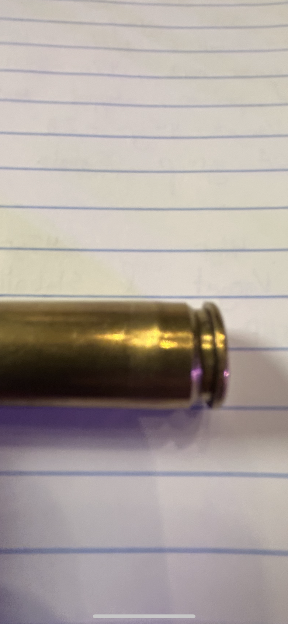

Got in on the same deal, got the 26" 6.5 creedmoor for a remington 700 and the headspace is WAY excessive. The bolt drops with ease on a no go gage so unfortunately I'm unable to test mine. I've emailed them (since they don't have a contact number) and I guess we'll see what they have to say. Hopefully they'll make it right.
My headspace is fine but the chamber might be a little loose. When resizing brass it required more force than usual to full length size. But to be fair I was pushing high pressure.

Michael from outlier, actually called me via video chat and I was able to show him exactly what was going on, and he assured me that it would be taken care and repeatedly apologized. So I will say, so far I'm very happy with their customer service.

The bolt bottoms out on the face of the barrel before I can set headspace, it's chambered to deep. I worded that incorrectly in my previous post. With the bolt bottomed out on the barrel face, I can rotate the action back minimumly to free up the bolt and drop in the no-go gage and the bolt falls free.

Can you tell if it’s the barrel count bores recess depth or diameter that the bolt is bottoming out on?

Diameter is fine, and the counter bore measures the same as the factory remington barrel that i removed. It's just chambered to deep, and the cartridge is going in to far, causing the bolt to bottom out on the counter bore. With the cartridge engaged on the bolt, the cartridge doesn't go in deep enough to contact the shoulder of the chamber. I hope that makes sense. Lol

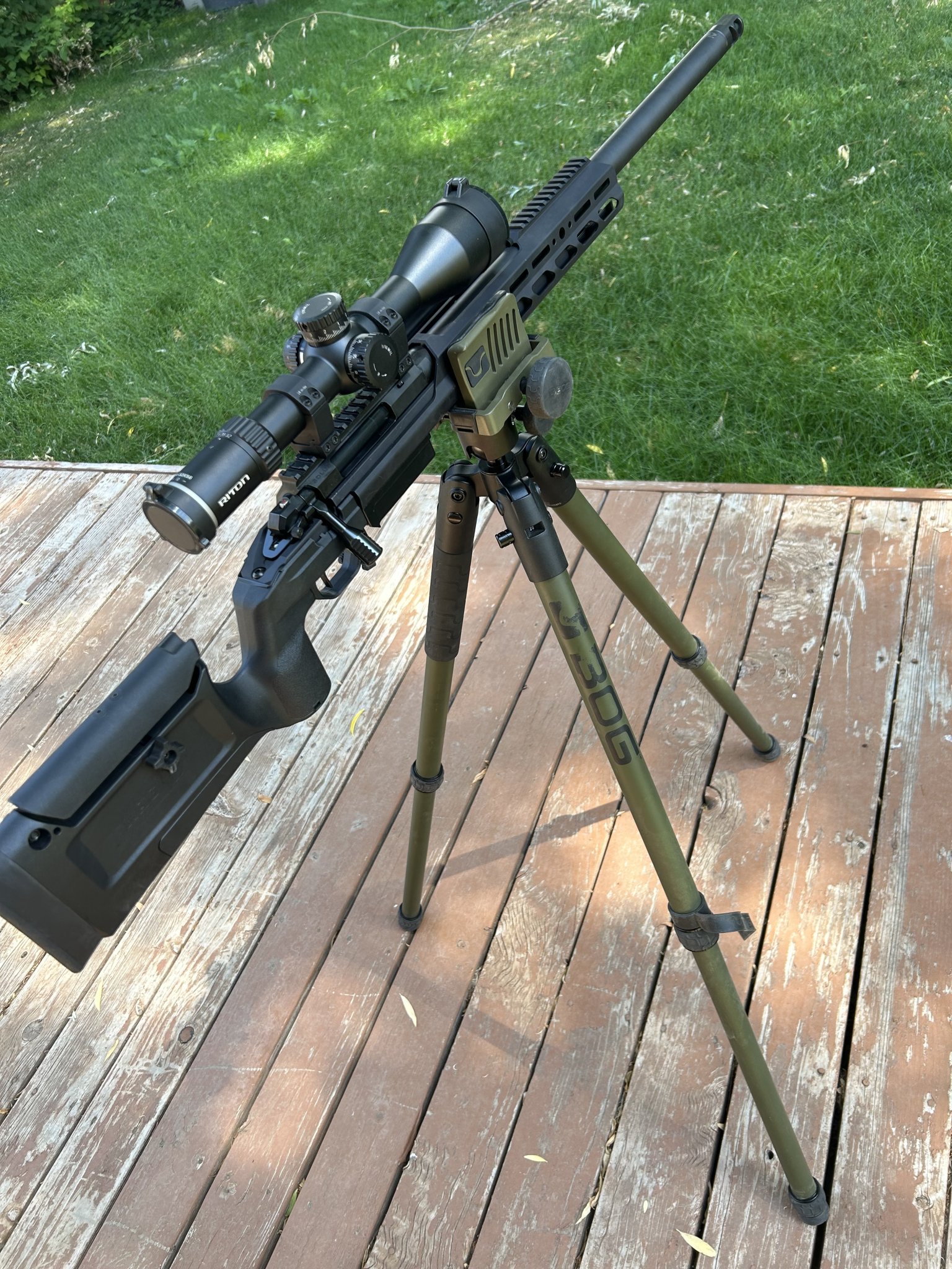

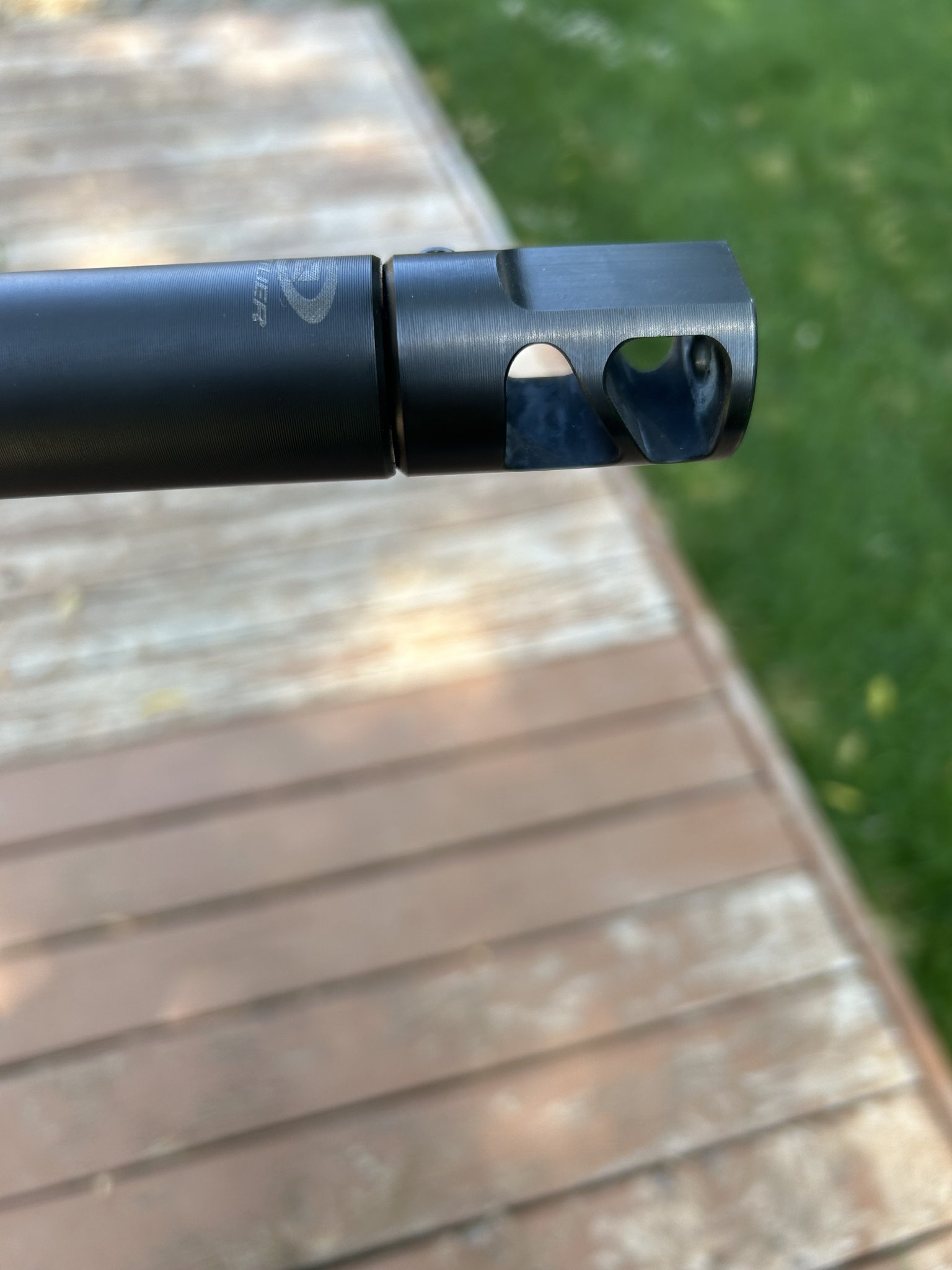

Just wanted to post an update from my initial review. Outlier finally sent me a barrel about a month ago this time a 26” 6.5 creedmoor that went on a aero solus action. They did include a free muzzle brake which was nice. But waiting almost a year is pretty crazy.
Anyway the barrel shoots. Headspace is perfect and no excessive case bulge. Installation was easy and uneventful as were the first couple shooting sessions. All groups were sub MOA with zero load development. Shot 135gr VLDs, 140 SMK, and 140 RDF.
Took it out this past weekend and had first round impacts on 1-2 MOA steel targets at 300, 400, 500, 600, 750, and 1215 yards. The 1215 yard target was a 2/3 IPSC so 20x12”.
During cleaning there isn’t any excessive copper fouling to note. Also velocity is exactly where I expected it to be for my reloads.
Final thoughts are this is a thicc barrel with a SAAMI spec chamber, that is accurate, and easy to clean. Would buy again especially at the $200 current price tag.
It looks like you have the brake on upside down? With how the gases hit that angled baffle it would actually be pushing the muzzle up instead of down?
Haha you a right, good call. That brake was only on for the first session. I generally run a silencer so it’s no longer a problem.
But lucky I was only shooting from a bipod that day. Probably would have been some funky recoil going on if I was positional shooting.
