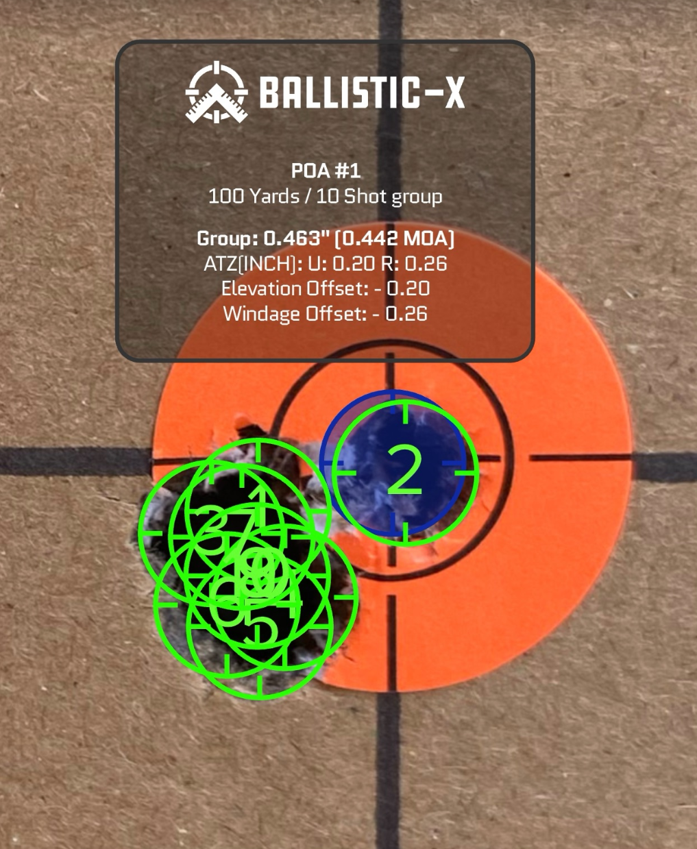

    I got a couple of Outlier unchambered .30 cal blanks to play with. They have some quirks but the one I chambered in 308 shoots really well. I have about 500 rounds on it now and it's averaging about .5" for a 10 shot group. When my new reamer gets here I'll chamber the second one and see if it shoots as good. If so, I'll probably buy a few more of them.

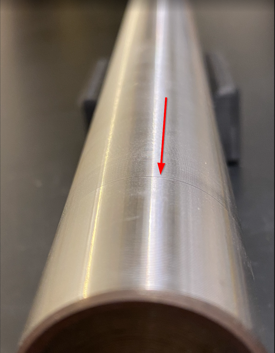

    • The OD of the first inch on the chamber end is not concentric with the rest of the barrel's OD. So they turned the OD of the chamber end in a different setup from the rest of the barrel. The difference is probably only about .005" but it's visible (see the picture). This caused some head scratching since I wanted to fix this but I also didn't want to lose any barrel length. The tenon I was planning to machine is only ~.800" long so the transition would still be visible. I ended up cutting .210" off the chamber end so that the tenon ended up cleaning this up.
