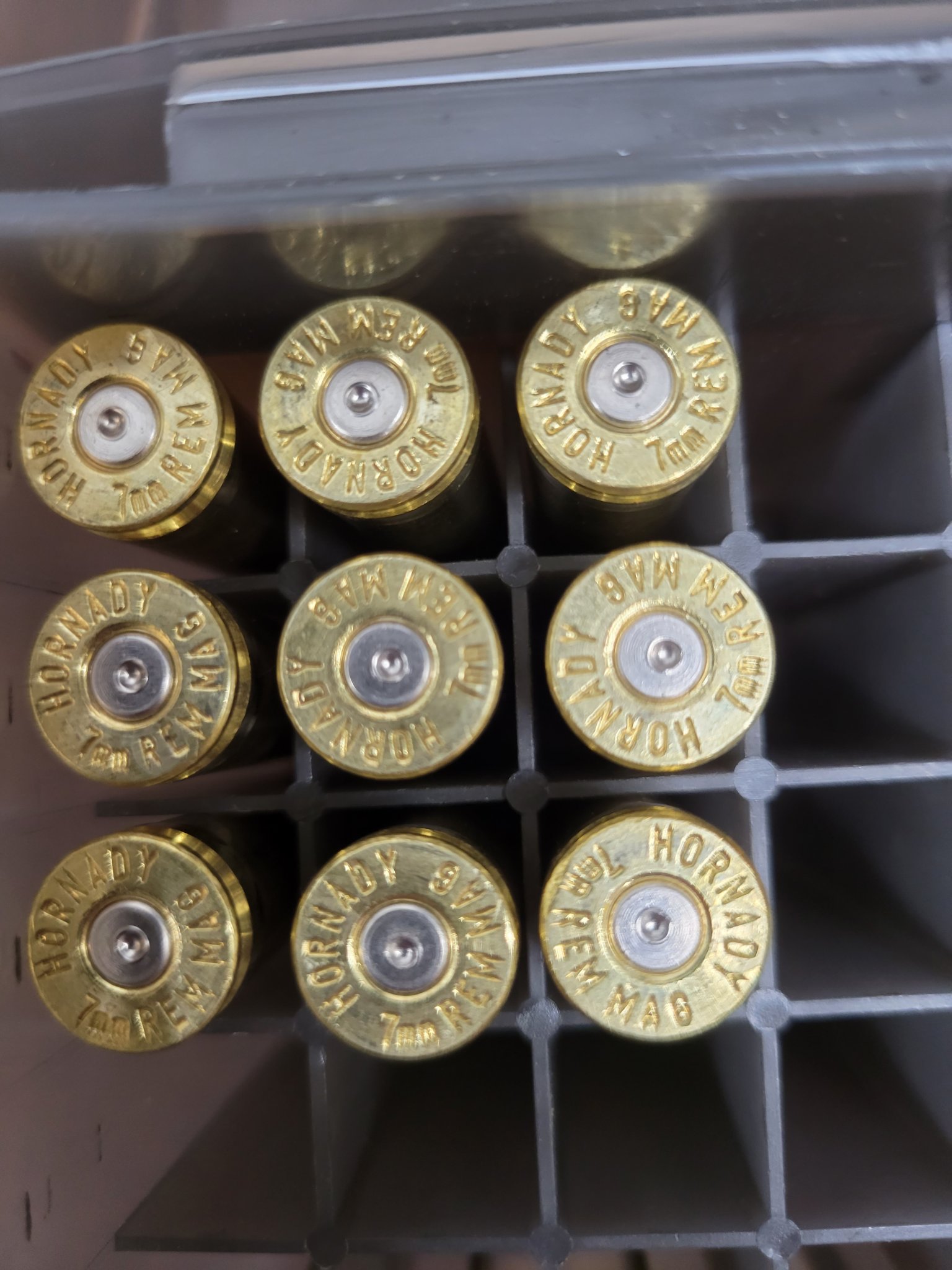

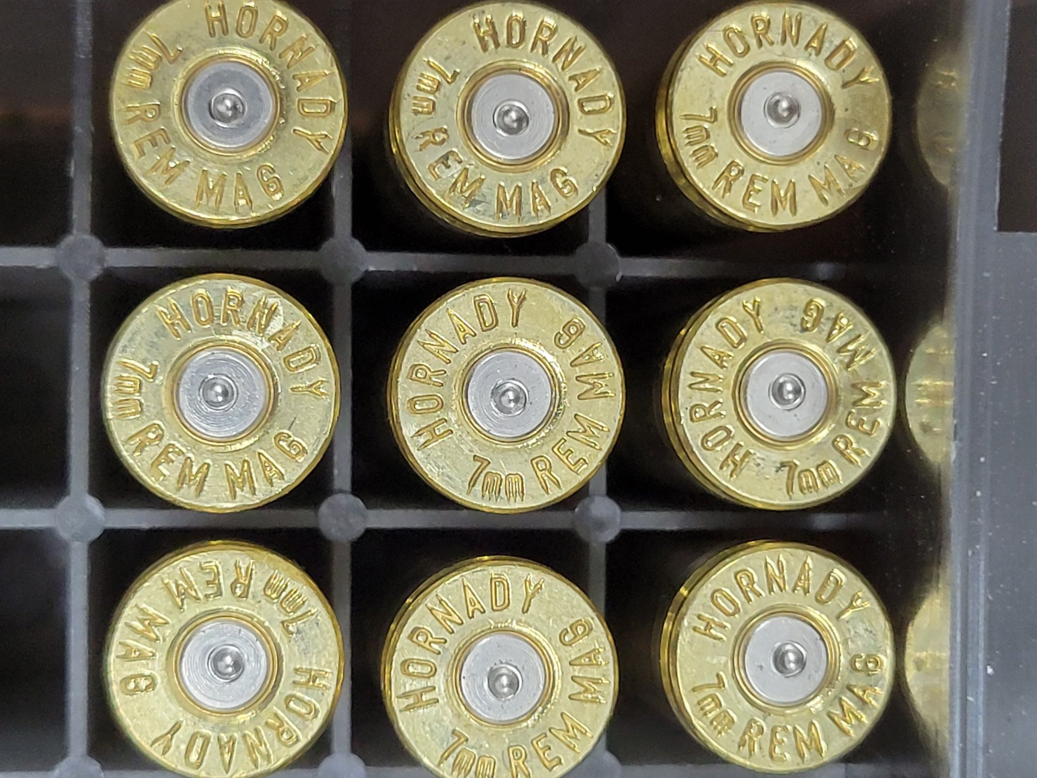

Here is a picture of the back end, the 67.6 starts on the left. I'm wonder if the brass is just getting weak and is expanding more? I feel like I don't see any crazy pressure signs per the primers.

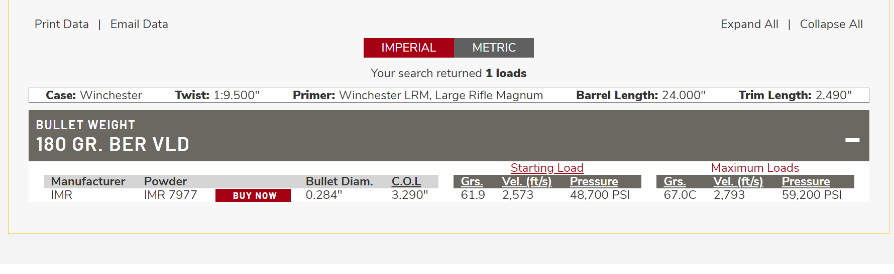

I myself don't put much faith in Hodgdon data, but here is a 180 Berger vld for reference.

With a little jump he shouldn't have too big a spike -- but he IS above published / compressed max (not that I haven't done it), and if you don't have data from others you have to do your own work-up -- which is what he's doing now.

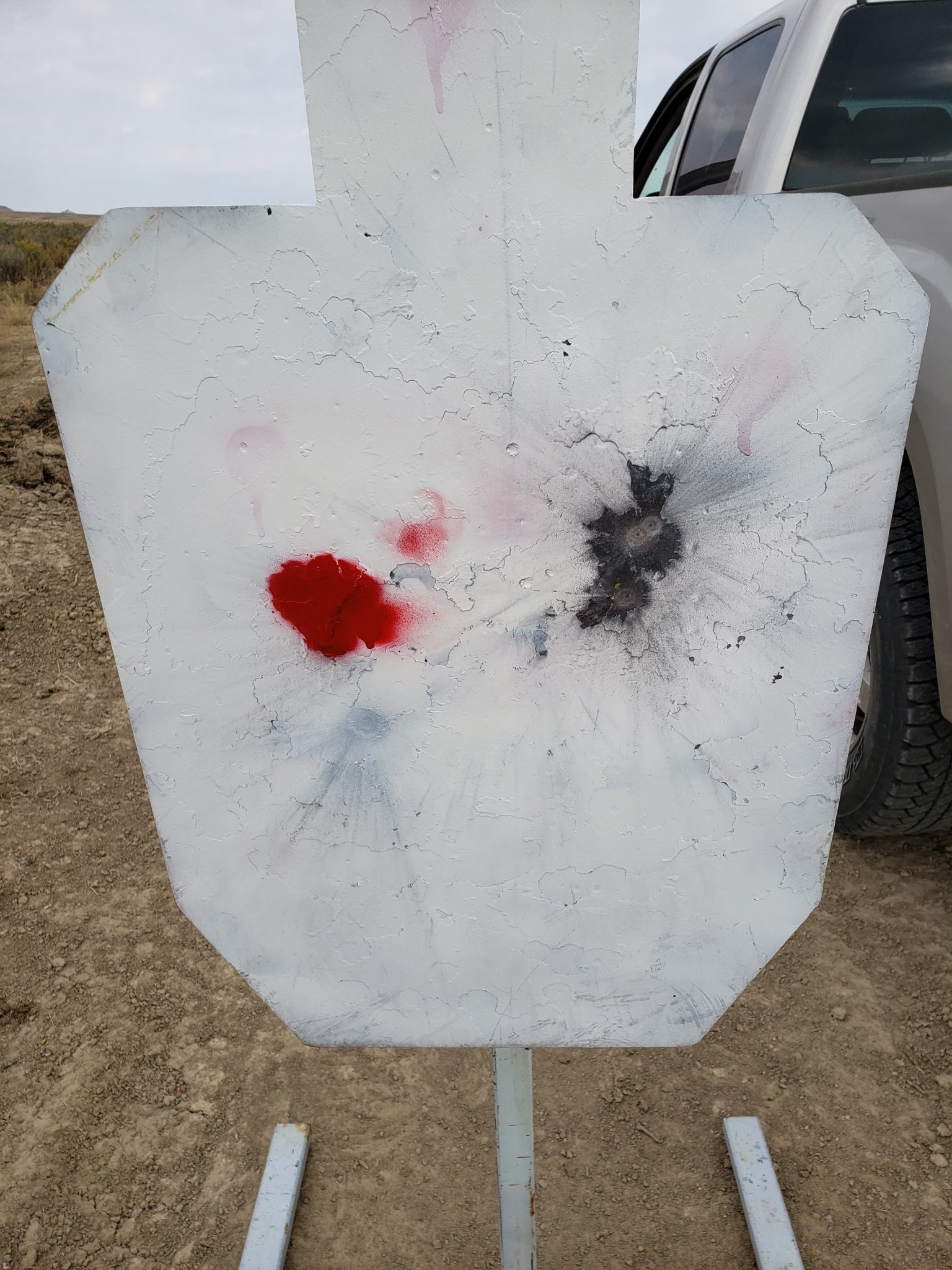

I picked up some ADG brass and did small development with the 184gr bergers. I backed off the previous node I found with the hornady brass by 10% per ADG hoping to be within same node of 2800fps. What I found was a great velocity recording ( 2570,2573,2575) and a 0.5" group at 100 yards with no brass prep. This isnt the velocity I was looking for but this will let me shoot this weekend, hopefully with good results.
I did find a wilson mandrel, I will take the 50 rounds of the new 100 rounds of ADG brass, prep with the mandrel and see if I can find the higer end node at hopefully 2800fps.
Just an update I found a node at 2885 fps per my chorno on the 184 bergers with 66.5gr of 7977 but based on Strelok it maybe faster than that as i had to adjust the program to match the actual data. I got a chance to get some data our to 500 so far, hopefully I can get back out there and get data to 1000 yards.
