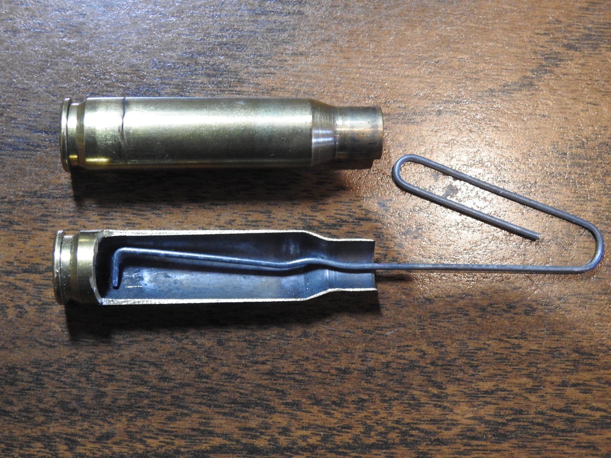

I find using the paperclip method works very well. It's a fast and effective way to test the cases, especially once you get the hang of it. I use is regularly after sizing brass that either has a lot of firings or seems to show a sign of case head separation on the outside. When running that bent end of the paperclip along the interior surface of the case, you can feel wither is slides smoothly all the way or feel some kind of indentation.
This is a pic on my paperclip:

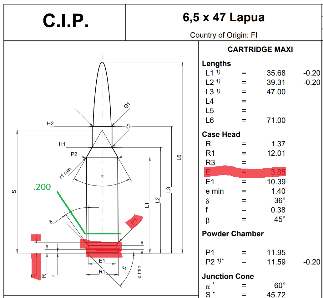

For CIP
P1 chamber spec is 11.99mm, which converts to 0.4720 inch.
P1 cartridge spec is 11.95mm, which converts to 0.4704 inch.
A resized brass case around the .200 line is probably going to be around 0.4714 inch (Manson) depending on your reamer. Some reamers call for 0.4717 (JGS) at the .200 line, so it varies.
https://bobp.cip-bobp.org/uploads/tdcc/tab-i/6-5-x-47-lapua-en.pdf

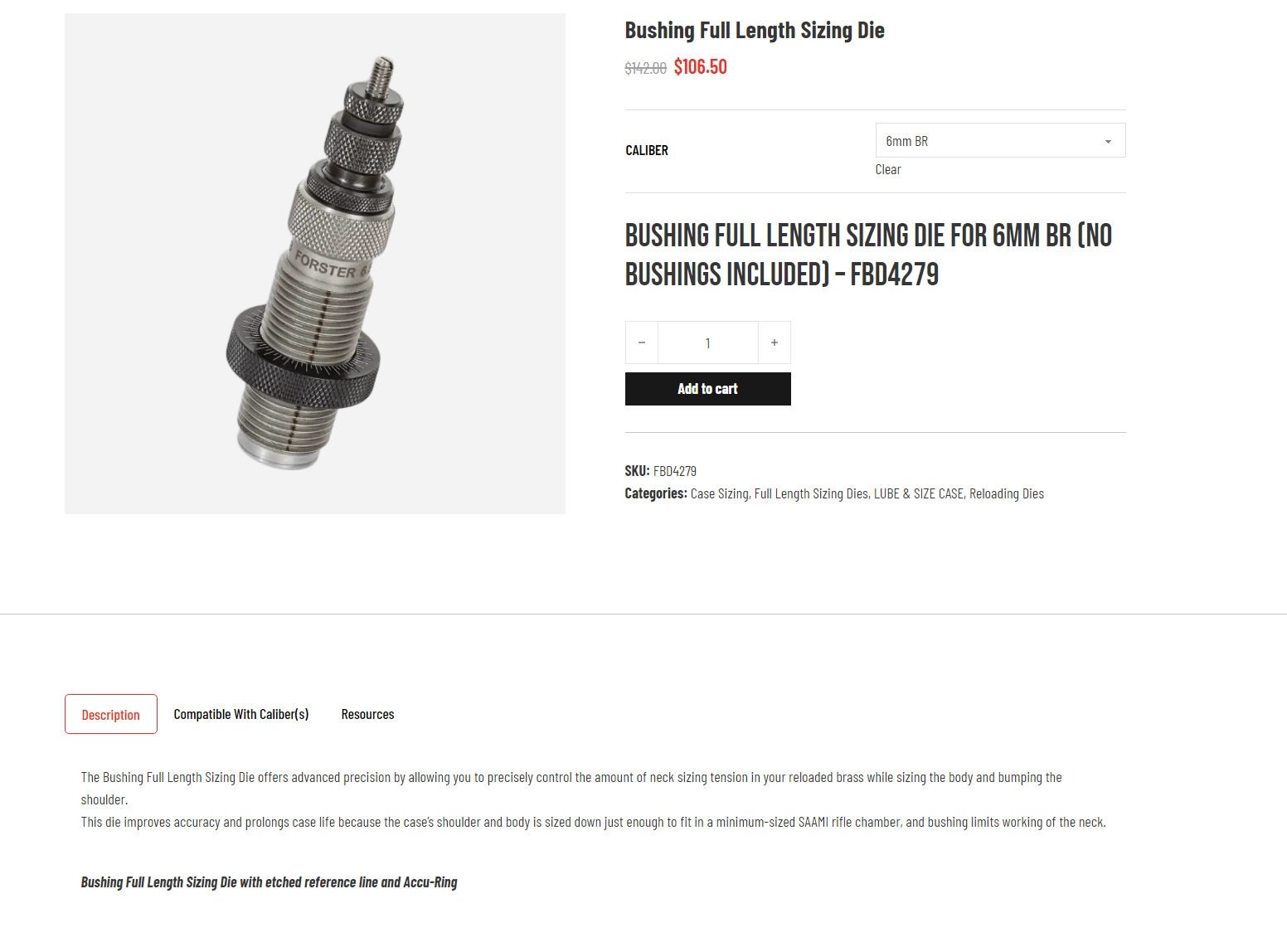

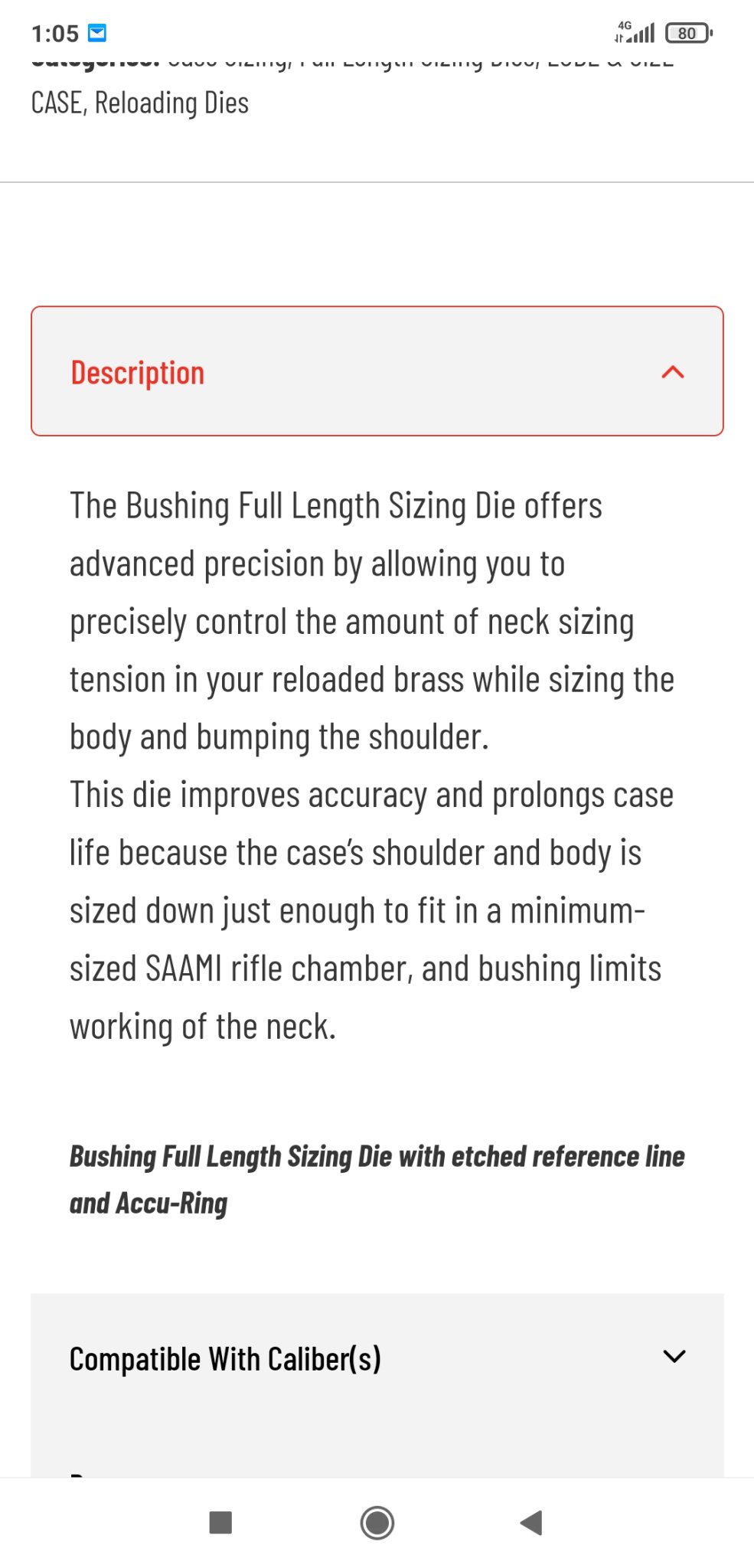

Hello attachment from Forster description.
I am aware. It is a generic description for the sizing die. For cartridges that do not follow SAAMI specifications, like the 6.5x47 Lapua, which follows CIP specifications, you should email and ask Forster directly for information. There is no established SAAMI specification for 6.5x47.

The SAAMI specs declared on the Forster FL Bushing die product description are intended for 0.470 diameter a the .200 line?
Hello, on many diagram of 6,5x47 Lapua the quotes at .200 line (web area ) are 11,95mm or .470".
Thi is not a my think but specifications of the cartdridge diagrams.

The PDF of the cartridge/chamber spec that I linked is directly from the CIP website. P1 is the diameter of the case right after the extractor and the .200 line would be above that. P1 spec of 11,95mm isn't the .200 line. The P1 spec is at 3,85mm which converts to 0.1515748", which is .0484" short of the .200 line (for the 6.5x47 lapua). The .200 line would be where the green line is, which is 5,08mm which CIP specs don't list. Because of the shellholder, you'll generally never be able to size down to the P1 line.

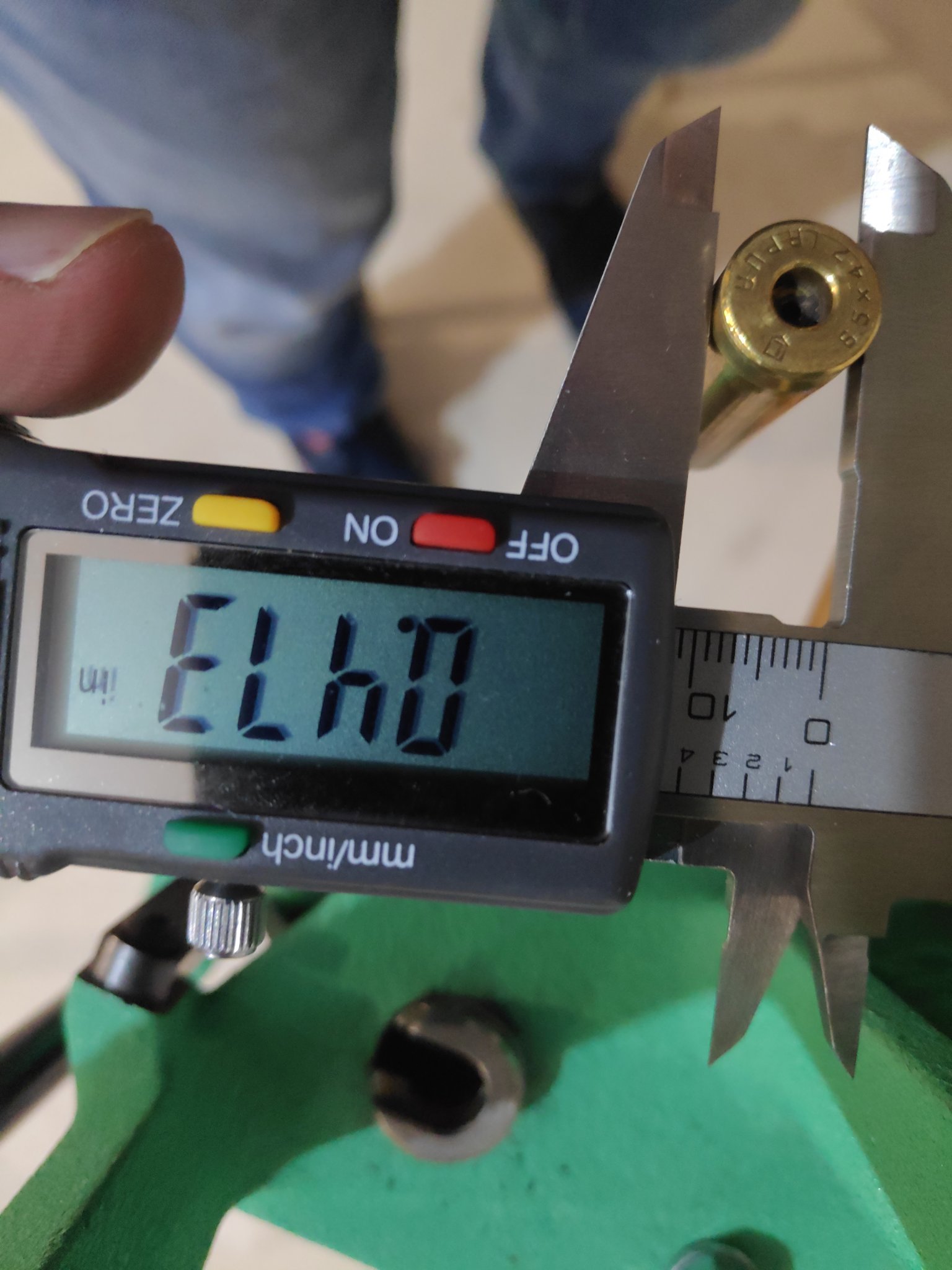

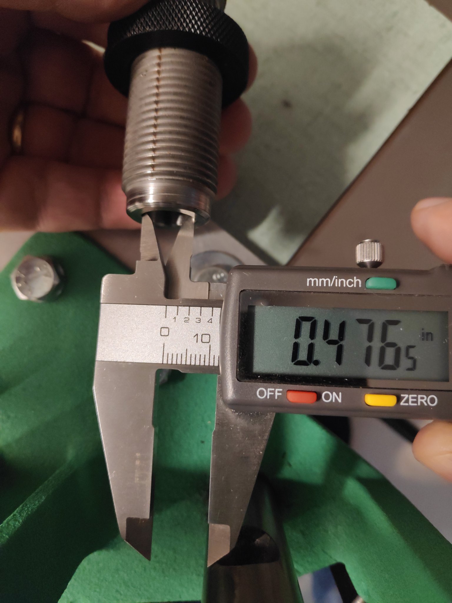

There are a measures of the base of the Forster FL Bushing die...

Based off the pic on your die with the 0.476" measurement, it's likely they used a slightly modified SAAMI 308 winchester reamer to make the 6.5x47 die, which would be incorrect for the CIP specification. Pic below of highlighted SAAMI 308 Winchester specs that Forster likely used. 0.4738 + .002 = 0.4758 (round up for 0.476"). The pic also means the die is at the maximum of SAAMI 308win rifle chamber spec and not minimum.

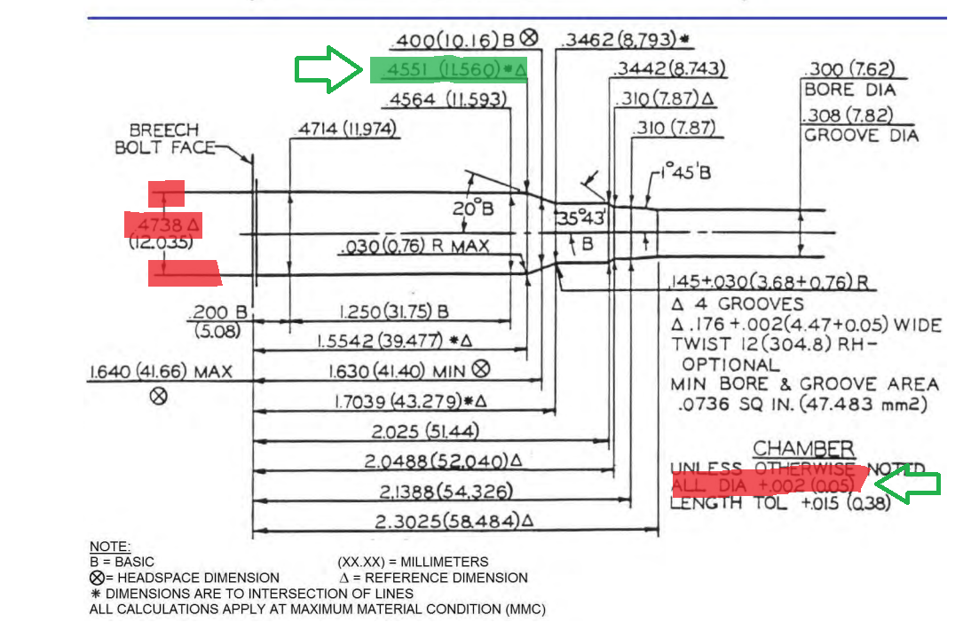

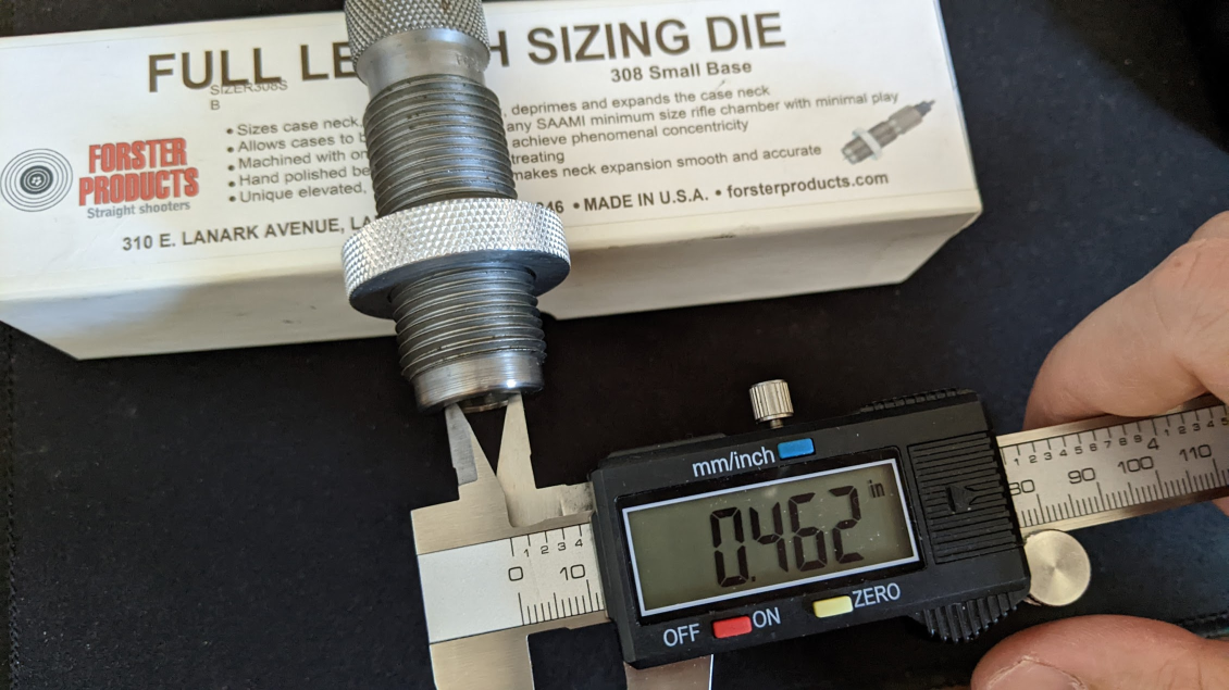

You can use a small base 308 winchester body die, pic below of the measurement for my Forster Small base FLS 308win die (remove the expander if using FLS die) to size the .200 line. The process would be, small base 308 die first, then full length size with the proper 6.5x47 lapua die.
The green highlighted dimension of the 308 winchester SAAMI spec will correspond to the P2 dimension for CIP. For 6.5x47 is 11,59mm (-0.20) diameter cartridge and 11,63mm chamber min. The 308 winchester die should be close enough (308 win is slightly longer than the 6.5x47 case) to size the P2 dimension down to around 11,56mm (+0.05) and won't distort the brass in a major way that a 6.5x47 sizing die can't fix and size the .200 line (5,08mm) small enough so you no longer have clickers.

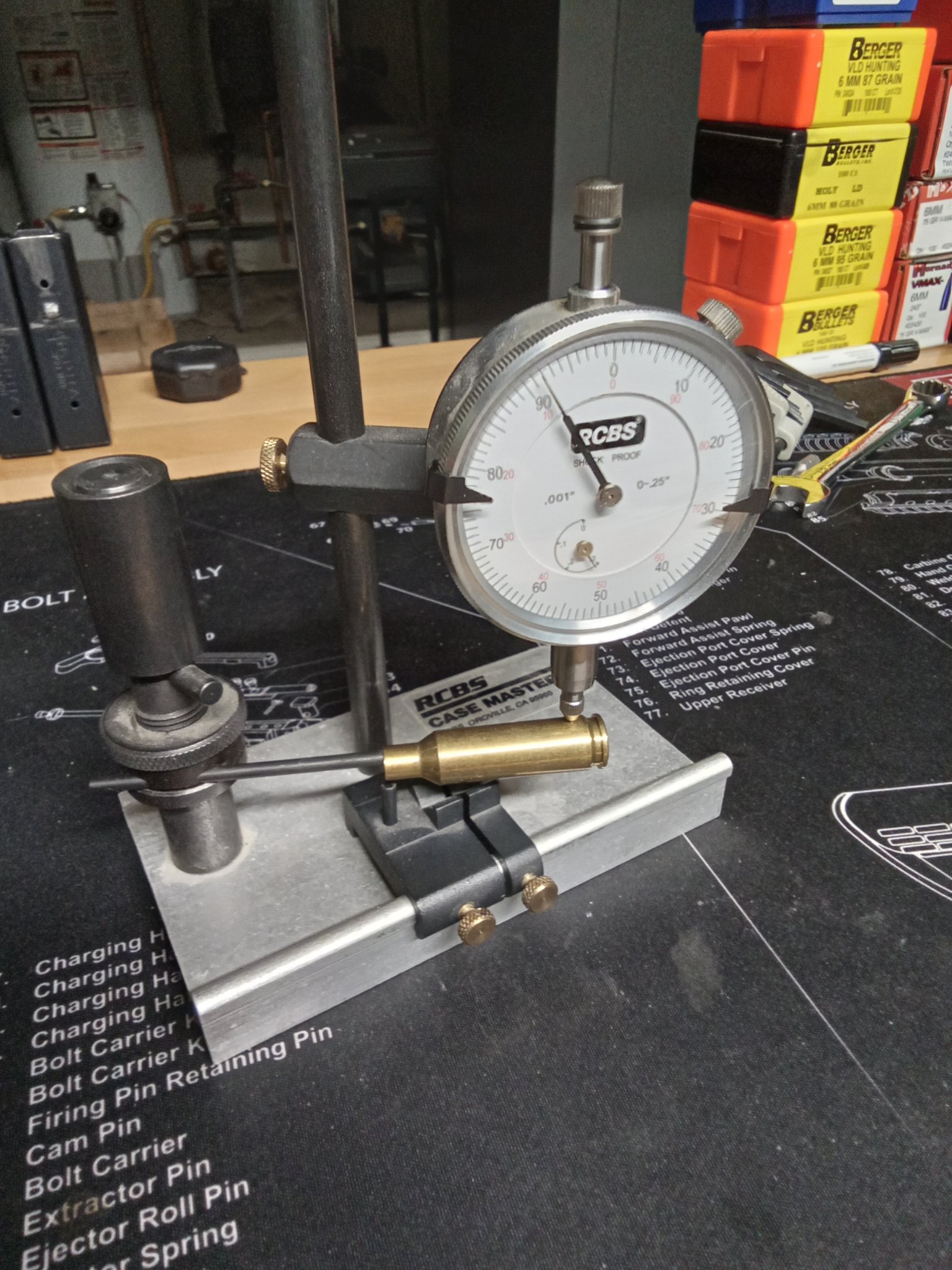

I use a dedicated tool for that measurement but rarely use it since I set my dies correctly to begin with.
The last time I had to use it but really didn't need to was I purchased a quantity of brass from another Hide member in 6.5 CM that was shot though an Accuracy International rifle with a fairly sloppy MIL/LE chamber that didn't give well with my match chamber done by Kelbly but no harm no fowl.
I had a 50% fail rate after full length sizing but shit happens.
The brass is still 2000% usable but just not inmy minimum spec match chamber.

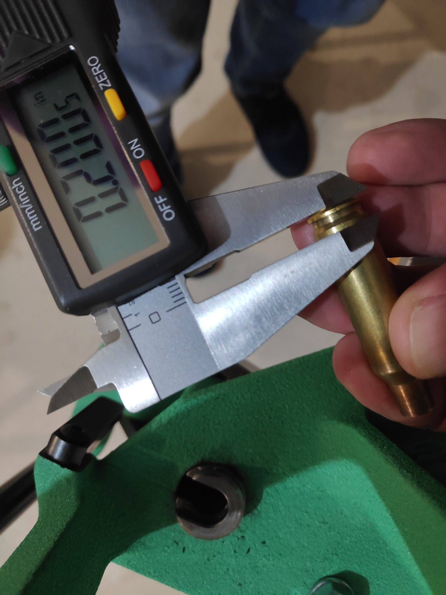

Hello,
yes .200 line or web are are siatuated a bit upper than P1, not precisely a the green line that you had marked.
I post one photo.
But at .200" line the measure are minor than the P1 line, the case body have a conical format.
So not 0.484"/12,294mm but I think less than the 0.4705"/11,95mm of the P1.
Tomorrow I make a measure.
If you look a the P2 the measure are 11,50mm, the case body are not straight format.
The area near at P1, responsable of clickering can be reformed/sized with the die, I reformed/sized some case with P1 over measure today with FL rcbs and body and the body Redding and the area of P1 was worked and the clickering are solved.
This is the original saami .308 Winchester drawing, a the P1 measure are 0.4709", not 0.476", or I misunderstod or you are wrong.
I don't speak about chamber measures but of cartdridge measures.
The brass is still 2000% usable but just not inmy minimum spec match chamber.View attachment 8528037
I post one photo.

You're misunderstanding. The green line is not literal. P1 spec is the .152 line (.200 - .152 = .484), the P1 is 0.484" shorter than the .200 line, because of this, you can't use the P1 spec to try and compare it with the .200 line spec.
Your case when fired will expand to fit your chamber. When you're resizing cases, you're not necessarily sizing it all the way back to minimum or maximum SAAMI or CIP cartridge specs, you're sizing them to a degree that so that it would fit well within the chamber of your barrel. This COULD but not necessarily WILL result in a case sized to within SAAMI or CIP min/max cartridge spec or it would be above max cartridge spec but still smaller than chamber min spec, or it could be sized somewhere within SAAMI or CIP chamber spec. In any case, the SAAMI or CIP cartridge spec measurements are irrelevant except for comparison with factory ammo because you have the actual barrel's chamber that you need size to.
The Forster die you have that is measuring .476 would indicate that the die was machined with specifications closer to parent case 308 winchester max chamber spec than min (even though it's 6.5x47). So because Forster die advertises as sized so that it can fit SAAMI min chamber specs, the die was manufactured incorrectly, because one area measures at max.
Your Forster die measures 0.476 and your measured case around the .200 datum line is showing 0.473. If 0.473 is the result after the RCBS or Redding die and it solved the clicker issue, but a die sized with the Forster die results in clickers, you can infer that your chamber at the .200 line is somewhere around 0.474" or 0.475", and you're not likely to be able to make the Forster work well for your particular barrel's chamber (because it's around 0.001 or 0.002 oversized).
Because your Forster die is "oversized" (even though it's still within SAAMI spec), any case sized with that die, will have trouble fitting in a barrel that was machined to a chamber spec that is smaller than that particular die.
If you go to Forster's website and use the drop down menu to select any caliber of die, the "Description" text does not change. The website description was certainly typed by a sales/marketing/web developer employee and not someone that knows the technical details of the product.
A revised generic marketing description for the product line that still has no technical details would be -
"This die improves accuracy and prolongs case life because the case’s shoulder and body is sized down just enough to fit in a minimum-sized SAAMI or CIP rifle chamber, and bushing limits working of the neck."
Some other examples of CIP cartridges with generic description -
Forster's 6mm Dasher.
A pretty good example of a potential description issue is with Forster's 6mm BR, which is a CIP cartridge as well and still has the same generic description. However, if you knew nothing about the cartridge, which standardized CIP 6mm BR are they referring to? 6mm BR Remington or 6mm BR Norma, or 6mm BR Faré?
In the US, the newly produced dies would be both 6mmBR Rem/Norma compatible (despite some brands having a label that still says 6mm BR Remington, the die is also compatible with 6mm BR Norma) because that's what the US consumer market evolved into based on demand.
In Italy, you would have to be more careful and ask the manufacturer questions because of the 6mm BR Faré (a cartridge that is not shot here in the US, as far as I know) that some of your PRS competitors are shooting.
https://www.forsterproducts.com/product/bushing-full-length-sizing-die/
The variation is why the cartridge spec matters less than the chamber spec when reloading used brass.
