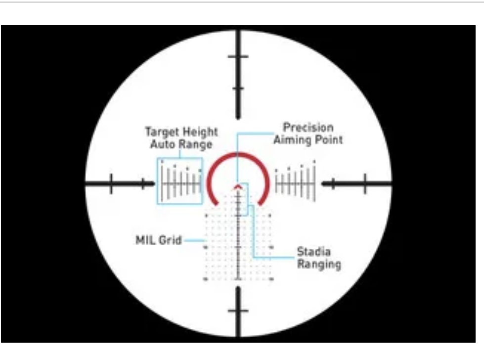

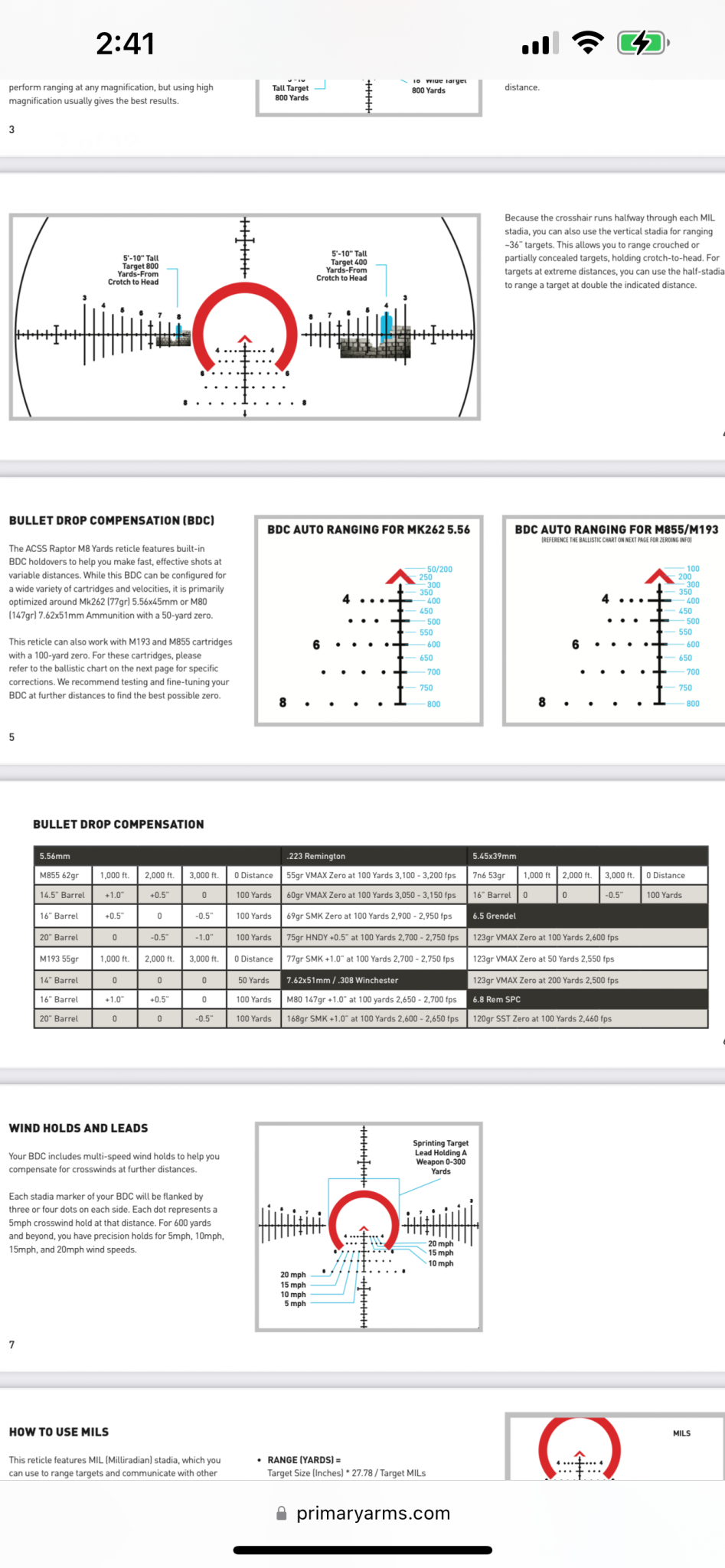

Hello all, newish to the forum here. I’ve built a 16” 6ARC AR and topped it with an Athlon Helos 2-12 which was highly recommended online. After shooting it a few times I am not a big fan of not being able to mount a piggyback dot up top due to the large turrets so I am now considering a PA PLXC 1-8 lpvo. Does anyone have experience with the acss raptor reticle bdc with the 6arc? I’ve emailed an online seller and they said I’d be better off with the griffin reticle but I’ve also read online that the raptor will work with 6.5 Grendel and I like the raptor a lot more for what I’m wanting to use it for. Plus I’m wanting more edge to edge clarity than what the Athlon provides which the PLXC supposedly has.

So I downloaded the Chairgun elite + app. Gathered other people’s data from their 6arc builds and kind of came up with an average muzzle velocity with the ammo I’m using (Hornady black). None of the PA bdc reticles correlate very good at least not at all distances. The razor 1-6 jm bdc reticle is almost perfect, as good as it gets anyway. I just really wanted a little more than 6x magnification for the 6arc but I absolutely love how bright that dot is and it’s the disappearing bezel that sets this optic apart from the rest. Idk, I am torn even worse now on what to do. I figured I could continue to save and get the 1-10x razor or get the plxc and print a bdc chart, laminate it and tape it to the inside of my scope cap cover. Might keep the Athlon for another long barrel AR build I have (coyote rifle) that could use a longer range scope than the pst 1-6 I had on it. I think I’m stuck with having a longer range optic and not being able to piggyback a dot up top due to the turrets in the way or getting the lpvo and being able to easily mount the dot up top but on a 1-6x, it kind of defeats the purpose since the 1x dot on a razor is almost like having an aimpoint anyway. Idk
Not sure if you tried this or not, but one of the main tricks to getting BDC's to work is playing with zero distance. I've got a fleet of BDC reticle all supposedly calibrated for 5.56 and a 50/200 zero. They all get zeroed at 180, 210, 230yds etc. to get the BDC almost dead nuts out to 600 yards. Beyond that range BDC's become increasingly untrustworthy anyhow.
