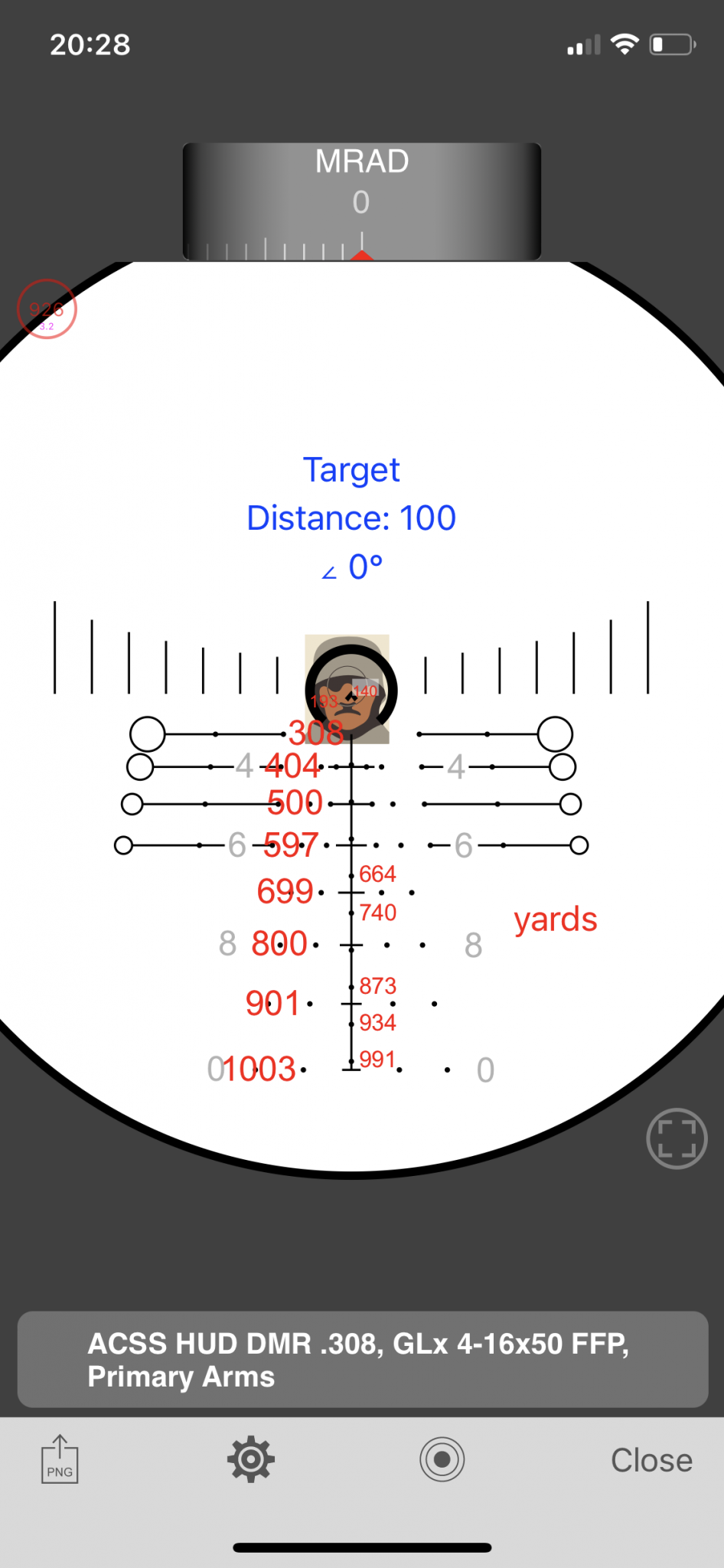

This is probably as good a place as any for this.
I picked up a 4-16 GLx with a 308 HUD/DMR reticle for my 16” 6.5 CM carbine, because…
This is how well the BDC lines up with 143gr ELD-X @2550 chronoed with a +0.1mil 100 yard zero. It was so perfect, I had to share.
The wind dots are ~6 & 12 mph.
Edit: RIP just realized this thread was a year old, not a month old. mb
Don’t worry, I’ll keep it going.
