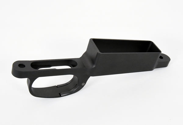

I've been corresponding with Pacific Tool & Gauge about bottom metal for an HS Precision Stock for a Rem 700 Short action in 223.
I've heard good things and a lot of horror stories about PT&G and wondering if when the guy says it is drop-in if it in fact really is drop-in. I'm talking about this DBM: https://pacifictoolandgauge.com/rem...ag-bottom-metalbdl-dbm-w1-mag-ati-legacy.html
Here is his email response to my questions if any of the DBM's will fit?
"Is it a Remington 700? If so, it will fit"
But then right on the page it says:
We cannot guarantee the part will drop in. We make products to tighter tolerances than factory. If bottom metal does not drop in or has tolerance issues, take the gun to a qualified gunsmith or utilize our inletting service.
This bottom metal only accepts the ATI polymer mags. See description below for list of sizes.
Has anyone tried this product. It is for a Rem 700 LTR. Also, are there other mags that will be compatible?
Thanks in advance.

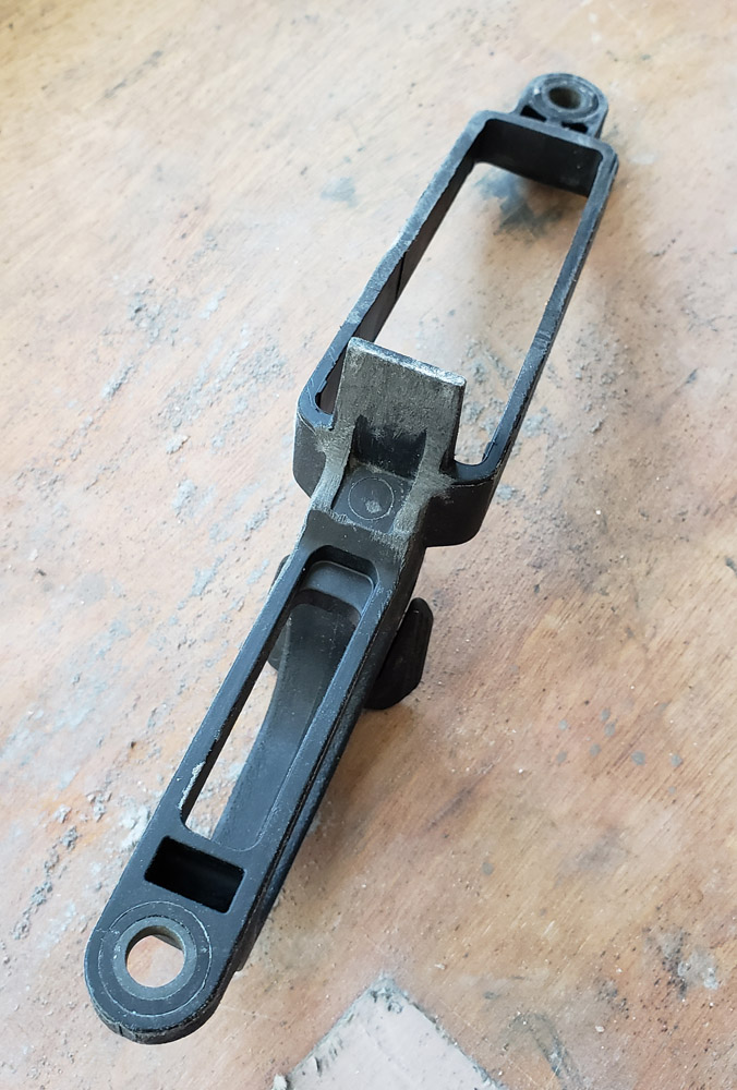

Legacy Sports makes a Dbm setup for Remington 700s that’s supposed to drop right in. I haven’t tried one but they’re inexpensive and you don’t have to modify your stock. Another solution is to sell your hs precision stock and bottom metal and buy something better. Look around and see what those parts are selling for it might surprise you because it did me.

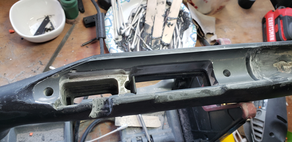

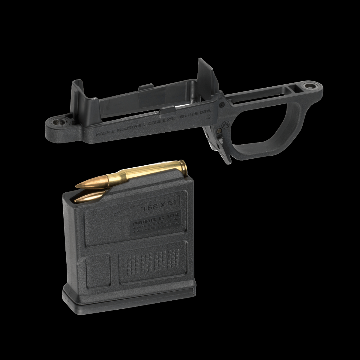

It's not really drop in ready but you can modify a Magpul Hunter DBM pretty easily to work in most stocks set up for the Remington BDL with just a Dremel and a hacksaw. The Magpul DBM was designed to work with the Remington BDL pillar depths and feed from AICS magazines so it's just a matter of getting rid of some material on the DBM and sanding the edges of the magwell to get it to drop in. Since the sides of the DBM are short you don't have to cut into the aluminum skeleton of the stock like you would the Hawkins, APA, Badger, etc...
In stock form:
My modified one to fit in my HS Precision stock:

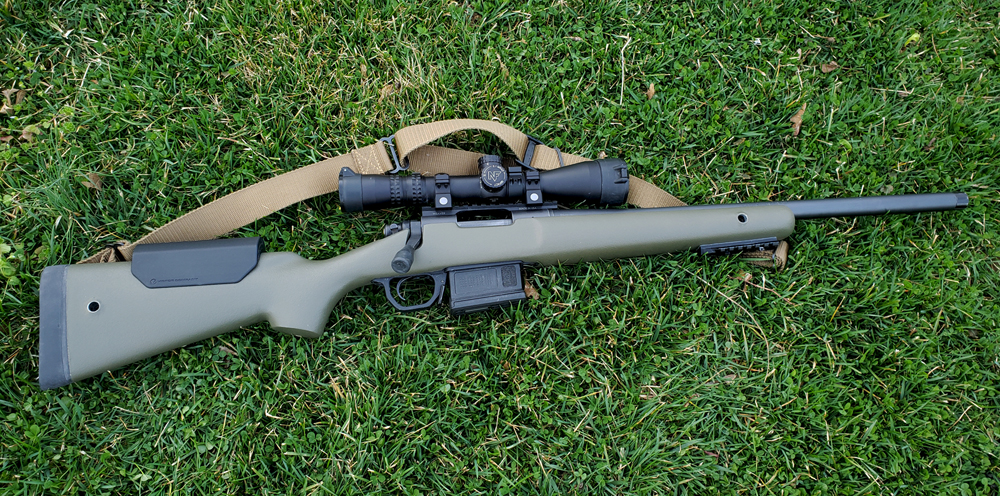

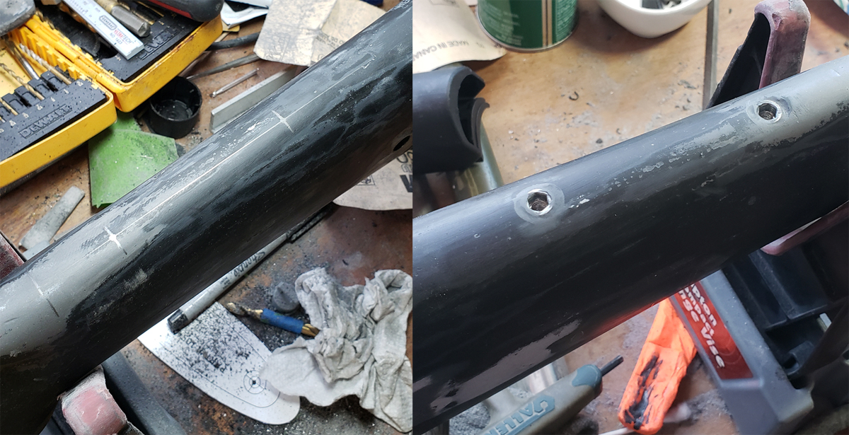

That is very interesting to me. Nice rig, by the way. May I ask what the cheek riser is as well? And thanks for the detailed pics and description. I will definitely look into the Magpul option.
The cheek riser is made by Victor Company.
I secured it to the stock with threaded inserts and machine screws.

Bottom metal isn't cheap, Legacy sports (the Howa folks) sell a polymer drop in unit that works quite well, you are very limited on length and it isn't what I would call "robust", but it works, I ran one for a while.

The Legacy model dropped right into my HS stock. Thats the good part. Knowing there was no way it would take 65 inch lbs torque I looked up there spec. Welp at 40 inch pounds (give or take) the rear most screw started to pull through the bottom "metal".
Im done with plastic junk. Im also not confirtable having that alum skeleton ground on to fit an AICS style bottom metal.

The Magpul is nice, it has steel inserts at the action screws so you can torque them down without worrying about it pulling through.
In stock form:
