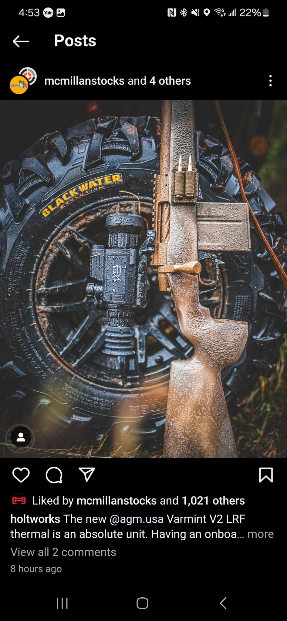

Liking the color scheme here between the two different 'browns'. I realize they're cerakoted, but does anyone know what colors these might be close to and if they're available in rattle-can/spray paint?
There's four colors/shades that I see. "Coyote" on the barreled action and a mix of "coyote", green, brown, and fde/tan on the stock.
In rattle can form I'd use Rustoleum Nutmeg on the barreled action as mentioned above. On the stock, I'd use Rustoleum Camo Earth Brown, Khaki, and Deep Forest Green with spritzes of Nutmeg. Then finish the whole thing off with several coats of matte clear.
This probably as solid advice as can be. I do all my rifles with rattlecan so I know a thing or two and I'd take the same route.
