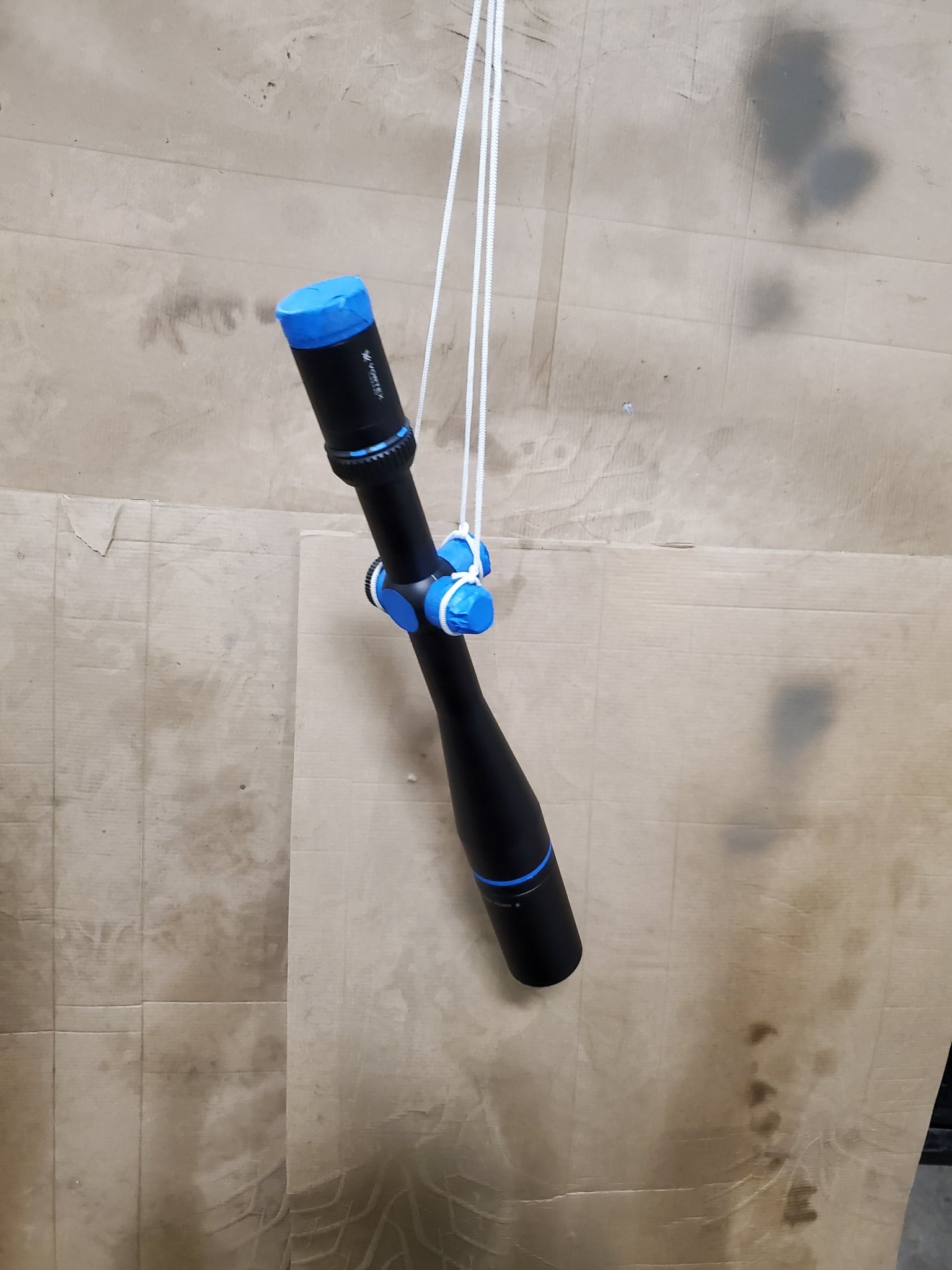

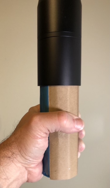

I’m getting ready to paint a scope and am trying to figure out a good way to either hold the optic, or hang it, while spraying the paint. I am painting it with the rings on, so could hang it from the bolt hole in the bottom of the ring, but am thinking the wire could get in the way and/or rub against wet paint. Plus that’s kind of a wobbly way to hold/rotate something while trying to get even coverage all the way around. I also thought I could thread an additional 56mm sunshade on the end and use that as a handle.
Any suggestions from those who have a great idea for a sturdy way to hold/rotate a scope while painting would be welcome.

Thin wire around the turret or cap for me.
