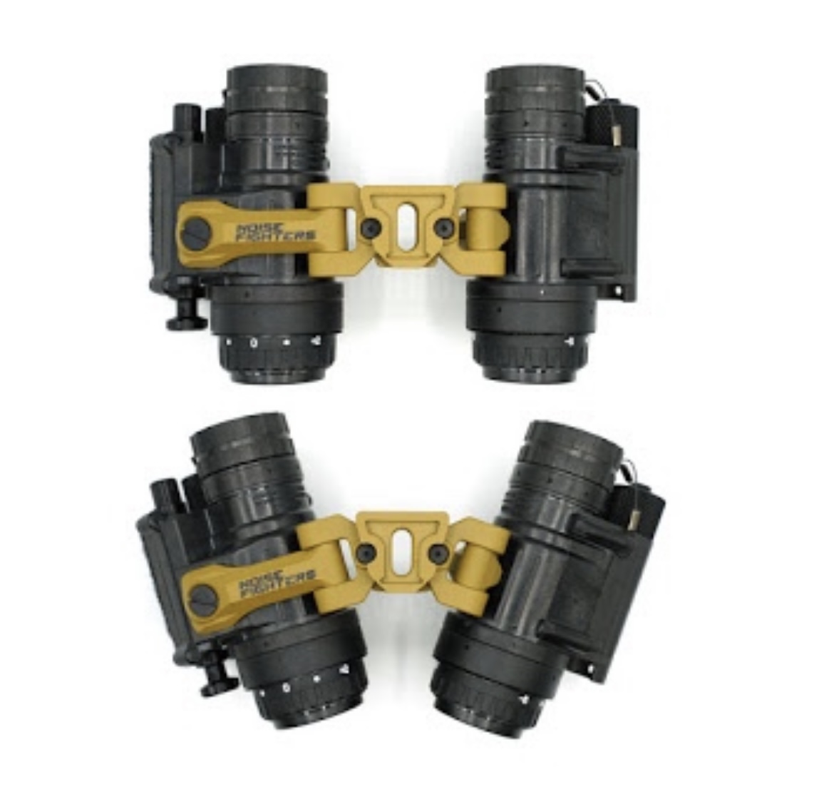

I really can't tell if this is ground breaking or complete garbage.....
Very curious to head first hand impressions - like does the limited overlap mean that the depth perception is similarly limited?
Reactions: Jgunner
So one problem I see right away is if you are a passive shooter.
I forget what its called, but when you look through your PVS/ANVIS/whatever and 'find' the red dot on your Aimpoint or EoTech and your head position isn't straight, the dot will have been 'moved' even though its parallax free.
It has something to do with the lens/tube in the PVS being angled and how/where it sees your red dot.
I've been able to recreate this many times and its always a reminder to shoot heads up/face forward when passive aiming and not try and tilt your head or rotate it like some people do even during the day when aiming down the RDS.
So with these, being able to angle them in/out is basically making that phenomenon happen. But if you're laser only, it'll be fine.
Reactions: Nik H and NHPiper
My first thought - besides hurting your brain - is, shouldn’t the pods be geared? So that when you turn one side, the other would follow? Turning one pod, even only a few degrees, seems like it would not be pleasant.
I have tired these and they don’t hurt your brain. It works surprisingly well given what it is trying to do. Yes there is less depth perception, but better then a single 14 and the wider FoV feels significant. Passive shooting is definitely more difficult, but haven’t used it enough to see if there is a parallax issue or not.

When used in "pano mode"... do you end up with a "blind spot" where you can't see dead-center in front of you? Or is there enough FOV?
Any guidance on matching PVS14s? (How close to specs should they be?)
Reactions: Lowdown3
@aard3 As close as possible but keep in mind even purpose built dual tube sets won't be "identical."
Also one advantage of two bridged 14's is if you end up with a slight difference in brightness levels between the two you may be able to calm it down a bit with working the gain on one to more closely match the view on the other.
Looking forward to getting some panobridges in soon.
Interesting product.

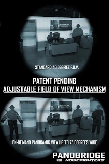

If you check out this video I posted late last night, I delve into most of the considerations one needs to take into account when using my new adjustable rotation mechanism:
To save people a click and their time, yes, there is a blind spot / zone in the direct center of vision that can extend up to approximately 2 feet, and it’s totally dependent on the amount of lateral rotation (panning) the user chooses to run. The width of the zone appears to be about 2 inches at most, and I believe it decreases linearly until the image appears to both eyes. It doesn’t appear to affect aiming with passive optics for most users since they naturally bring the sights up offset from the central zone and inline with their dominant eye.
Finally, I go into my recommendation for panning approximately half way or just further for the optimum balance of enhanced field of view with acceptable central resolution and depth perception, plus an almost imperceptible dead spot / zone.
My goal is to provide users with realistic expectations of the product’s capabilities. As I made clear in the press release and in a long-winded paragraph in the product description, this isn’t a direct GPNVG replacement. But, for those people who literally can’t afford $40k panos and / or want something with a simplified logistics chain and a smaller and lighter form factor, I am pitching the Panobridge as a possible alternative with a competitively wide field of view.
Having the blind spot in the middle makes functional sense to me for those guys that want to be able to keep the ability to shoot through their day optics. You can have your shooting tube straight, and have your non-shooting tube pano'd.
That's a big if though, it might end up feeling like a giant ass pain, or it might be unnecessary. I haven't tried anything like this before so for those reading take everything I say w a grain of salt
That's a big if though, it might end up feeling like a giant ass pain. I haven't tried anything like this before so for those reading take everything I say w a grain of salt
It’s certainly possible to do so, but the non-panned tube will be higher in view slightly than the panned tube. Hard to explain unless you watch the other video I posted about night vision mount adjustment with Panobridge.
I used to own a DTNVG and the tubes weren’t vertically aligned, either, when in use...so...I go back to the idea people can probably work through this kind of issue if they want.
Personally, I keep the tubes 60-70 degrees and don’t have problems with passive aiming.
