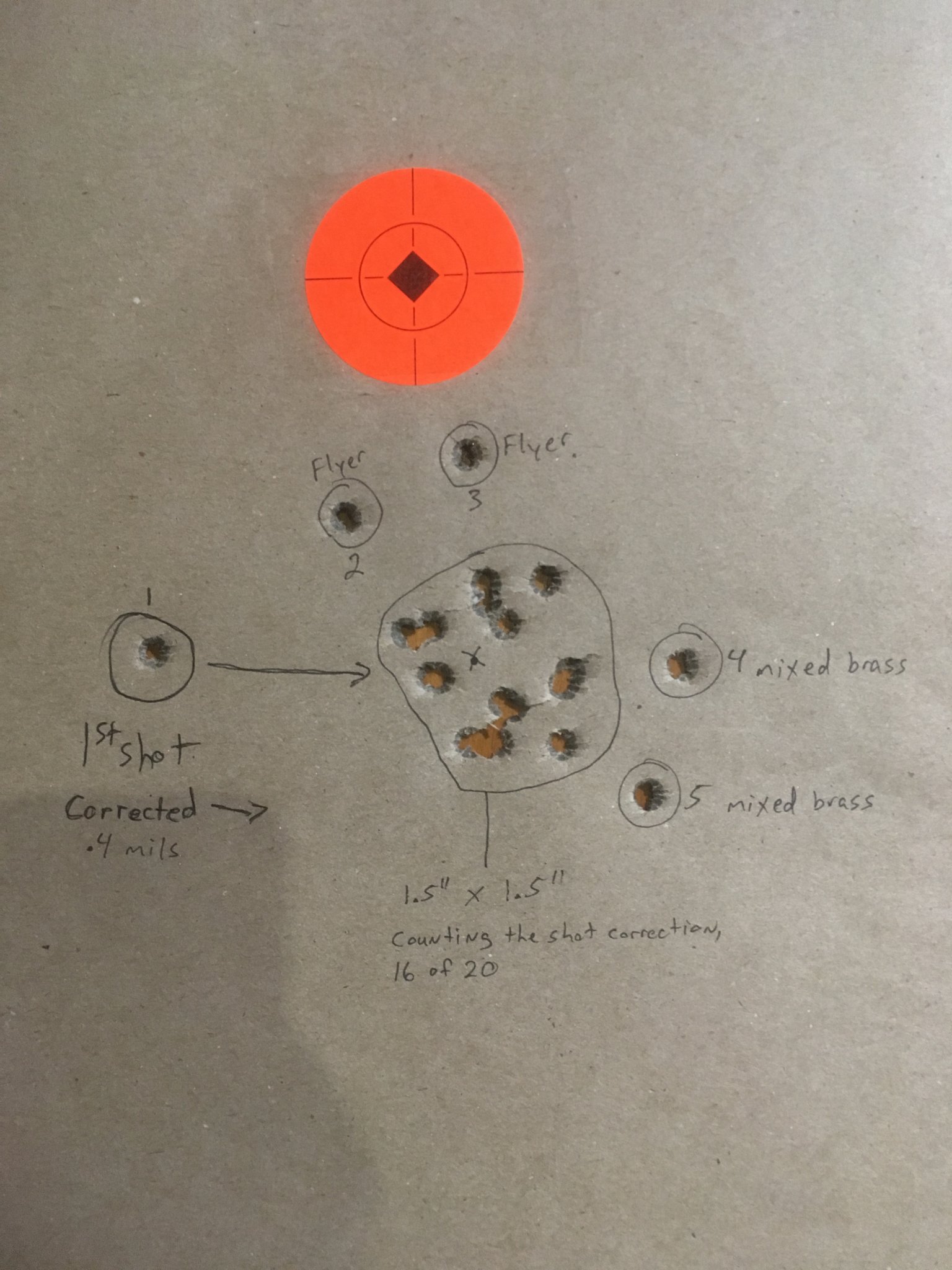

I just shot this group today. Since I had to make sight correction to center up the group, the first shot was .4 mils left of the group. In doing group analysis back at the house, how would you suggest I use the reticle to figure out exactly where that shot belongs in the group?
How would I use the reticle to figure out exactly how far away from the group center those flyers are?
If this was an ELR load I was trying to zero, how would I use the reticle to find the mathmatical center and exactly calculate what my remaining amount of zero offset was?

Eyeball it with the reticle. Think of it this way. You are using calipers that is accurate to the nearest thousandth of an inch and you are clicking a scope that is accurate to the nearest 1/4 of an inch at best. When shooting there are so many variables that you are never 100%. Even the grouping in the pic may not be accurate as there is a human on the other end of the gun. Shooting a larger group lessens that variable more but then the barrel is heating up which is another variable. Of course you could make a cold bore shot every hour until you have a 10-20 rd group and then use your calipers to get to the nearest ten thousandth of an inch and click your scope to the nearest 1/4” which makes the calipers pointless. Which is my point. As far as the ELR load is concerned, being a click off your “true zero” is much less of a error than misjudging the wind a fraction of 1mph. It’s much less of an error than the group size of your rifle. It’s much less of the error than the extreme spread of your Ammo. If you were centering a laser beam then your way would be the best as there would be very little variables.
Or you could shoot a few and dial the scope then shoot a few to confirm and bang targets as far as you care to shoot. That’s what I do. It’s quick. It’s easy. It works.
Neither is wrong. Do as you wish.

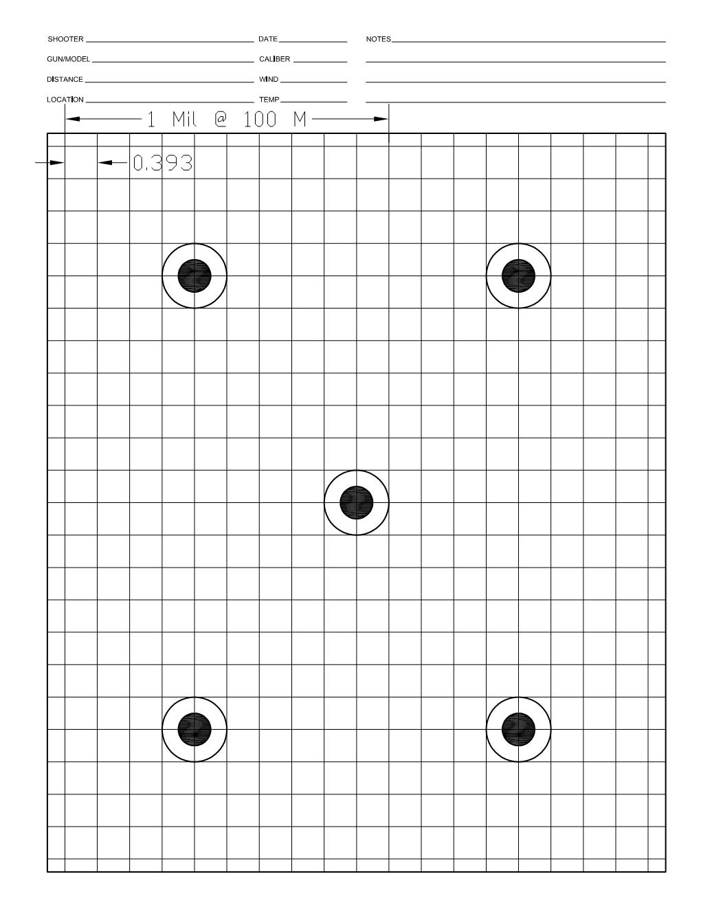

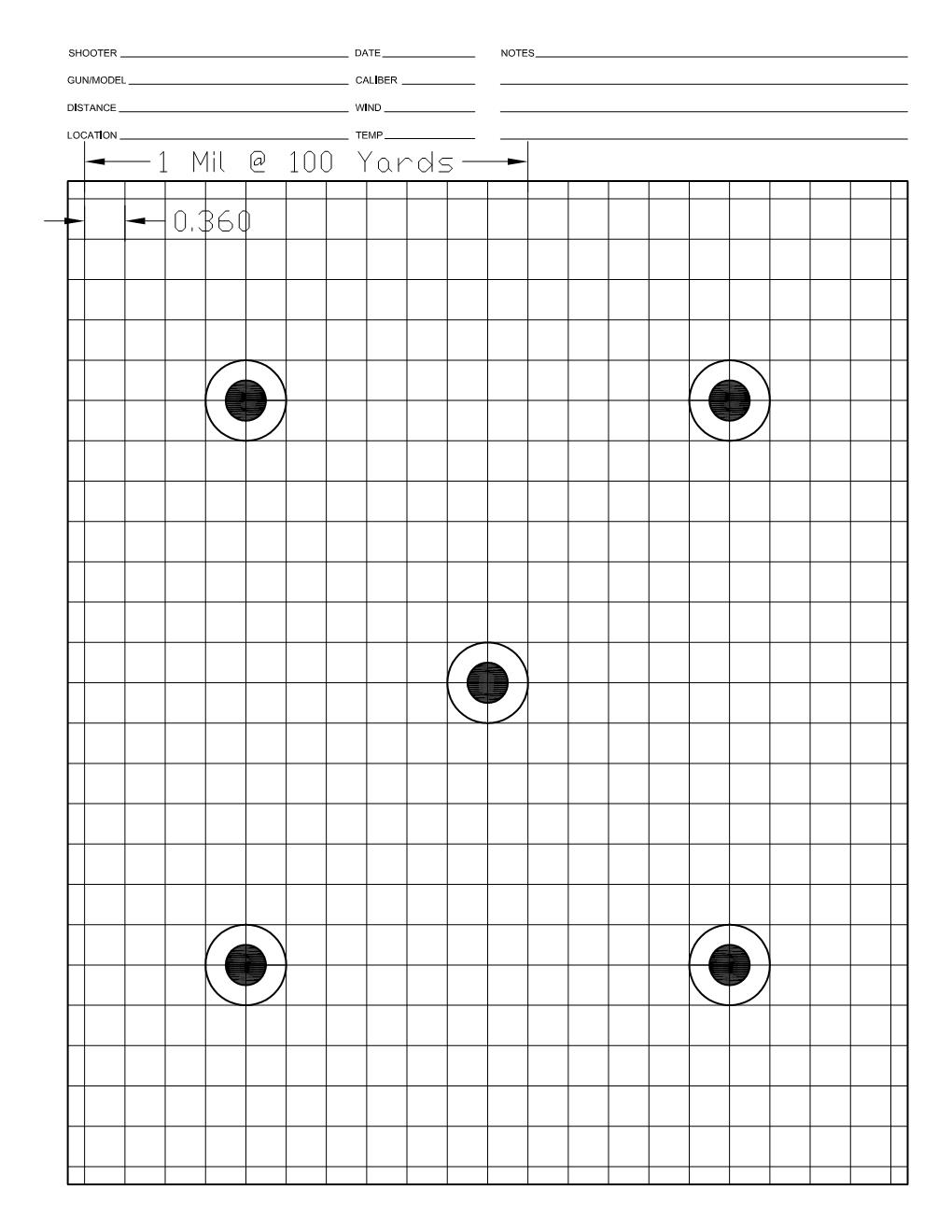

Here are 8.5x11 pages I have made, each of them are in .1 mil. PDFs also attached. Note these are listed for yards or meters. Be sure to use the correct target at the correct range.
1mil = 1 cm = .393 inches at 100 meters

1mil = .9144 cm = .360 inches at 100 Yards
Enjoy. Let me know if you think I could make these better? I can resize or add things as needed.
The last PDF is a bonus for ya if you can print 24x36 pages. Or staples will do it for you.
