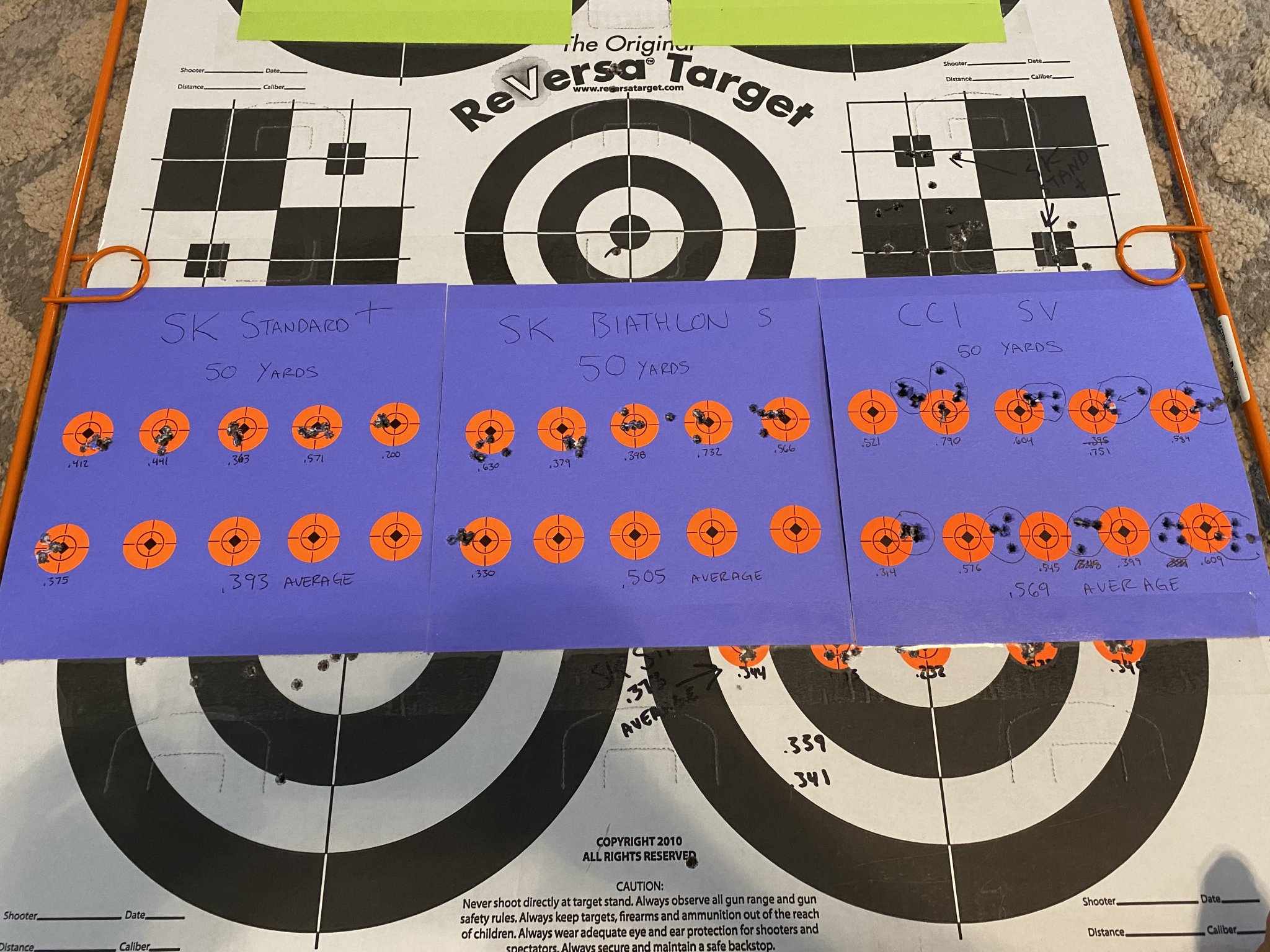

I agree a lot with that statement. I can move a group an inch easy with parallax set even just a little off at 50 yards. Here’s a perfect example from my last time out. My first groups were with cci, and the targets on the right. I thought I had the parallax set correctly but I didn’t. Every group was right. I adjusted it and everything went back to normal.
