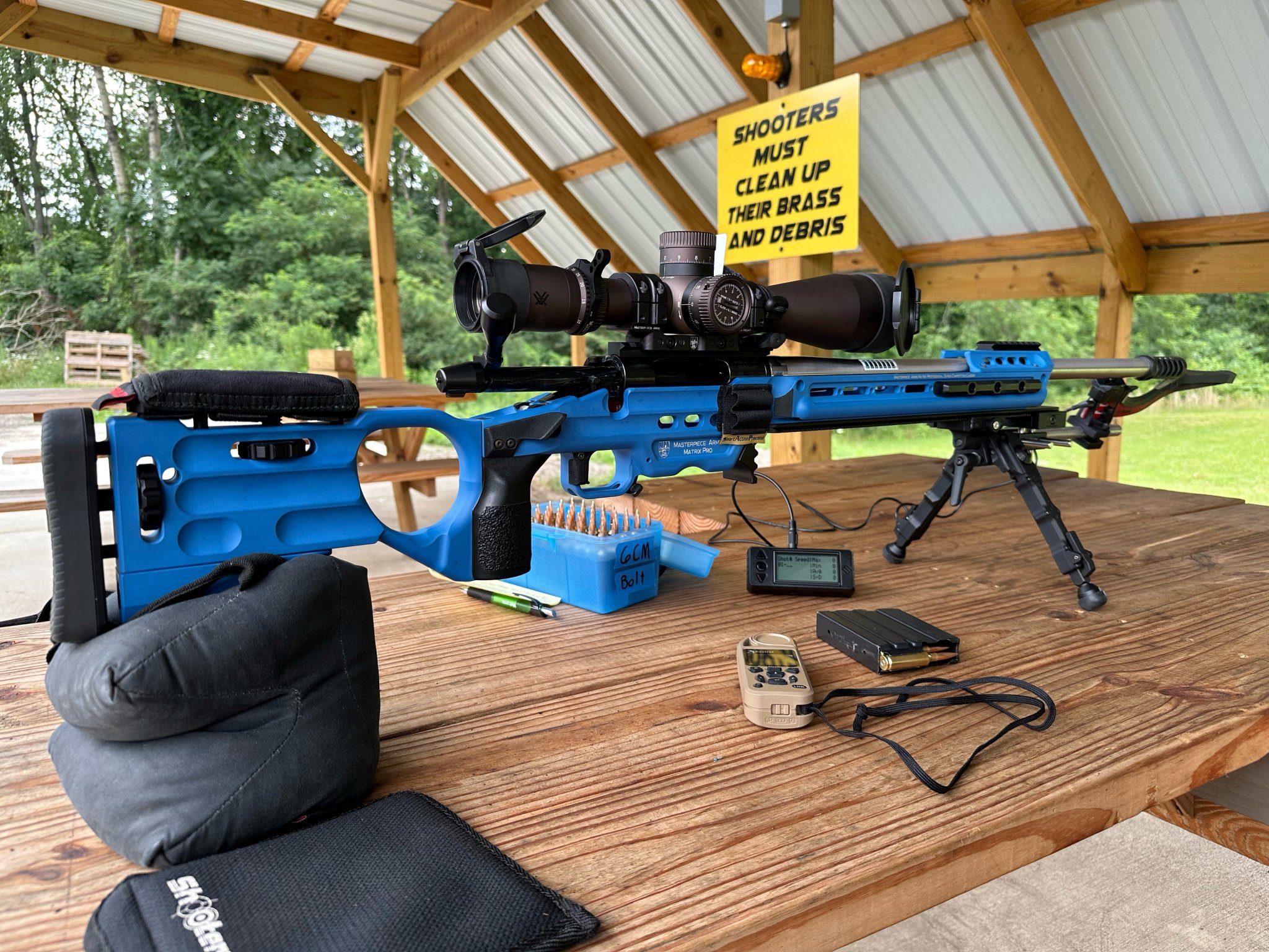

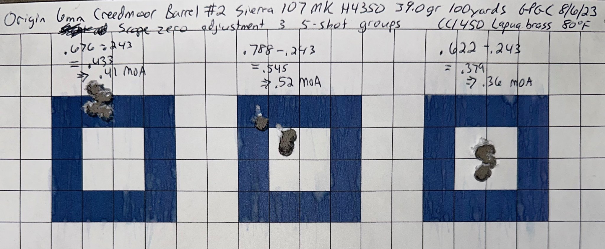

Greg and Russ at SPR are awesome! They've done several barrels for me and this is the latest one they chambered for my PRS rifle. The target was shot and zero load development on the rifle, so I'm super thrilled so far.
I have a Grayboe renegade stock on a R700 and it's super nice and sturdy. I haven't seen a HNT26 in the wild yet.
Since the AntiX action has a side bolt release, you don't need one on the trigger. I have specials and diamonds on different rifles, but for a hunting rifle, I would go with a special.

Stevie those are great groups and an amazing looking rifle. Thanks for the info. The Phoenix II is lefty so that’s the one I’m prob gonna go with.
