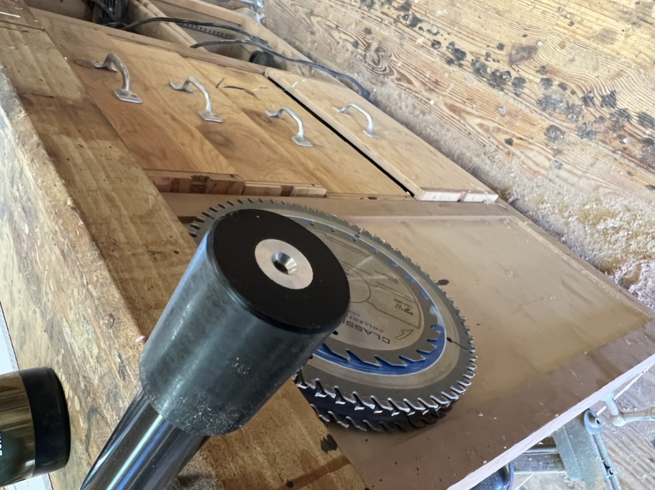

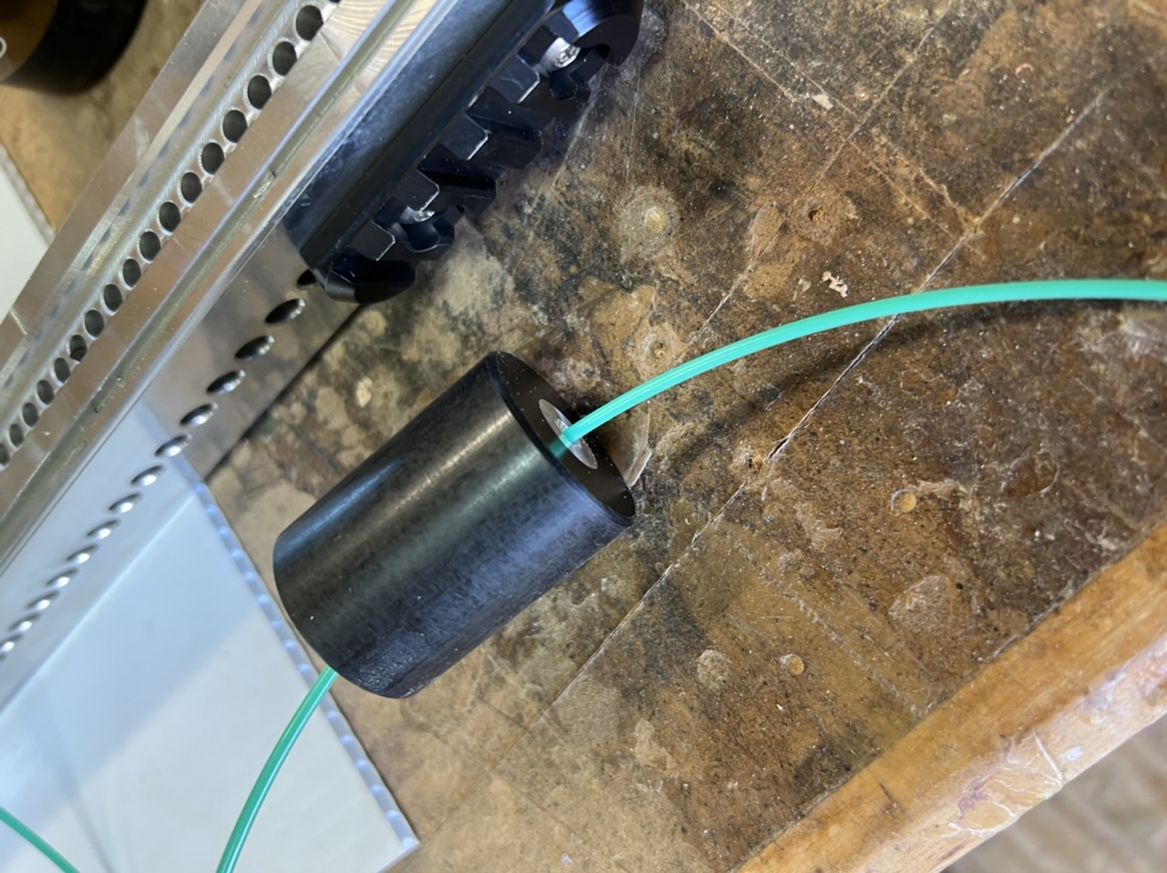

I made this to keep the string centered on the bore.
Interesting. I use a straw (cut to about 4”) that I insert part way into the bore.
If your straws are too big in diameter, use a razor blade to make a twisting/curling cut lengthwise over the straw’s whole length. This way you can sort of twist it to collapse the straw’s diameter down. The twisting cut limits the chance that the line will pop out of the straw and rub the crown.
