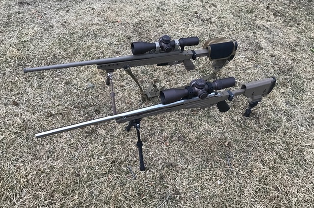

bumping this one up from the scout forum. It was 8 pages long there with lots of great pics.
I will get this new thread on the new old forum going by reposting my post from the scout site. Hopefully others will join along with some of that great content.
Here is my PVA rifle on the newly installed Josh-inspired tractor tire obstacle on my farm.
Stats on the PVA rifle:
  • 6x47L chambered with Josh's best reamer - he has thought out each dimension
  • Big Horn action
  • 24" Hawk Hill barrel 8 twist. Not sure on the contour. This barrel blank was from Josh's pile of best barrels from Hawk Hill.
  • Manners T2, w/ mini chassis and my well used Triad Tac stock pad.
  • LRA bipod - again another piece of kit Josh recommended.
  • Premier 5-25x Gen2 XR
  • APA LB Gen2 brake
  • Jewell at 1.5lbs.
Shoots the 105gr Hybrids at 3000fps, +/- 10fps (39.0gr H4350 lit by CCI BR4). Recoil feels like a BB gun. Plenty of splash at 700 and stacks the pills in the same hole at that range.

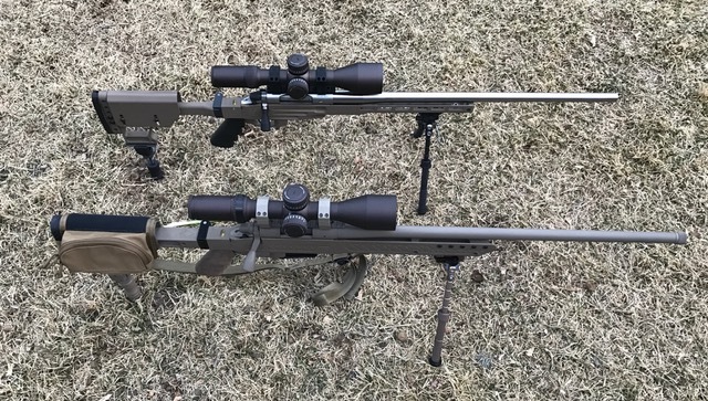

I got to get a pic up of my latest PVA mad scientist madness: a 308 that runs with traditional 300Win Mags:
30" barrel, long action, mag feed 198gr Flatlines (G1 BC ~0.8) at 2750 fps. Will put that ballistically up against any Berger bullet load out of a 300 WinMag.
Josh is pushing the industry forward... gunsmithing AND bulletsmithing

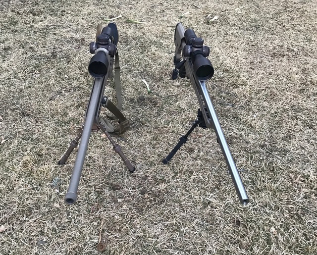

Josh re-barreled my Surgeon to 6x47L & DLC'ed the bolt. Bartlein 1:8, RemVar @ 23". Its threaded for a brake, but I've been shooting it without, as its such a honey. I did the bedding job into an A3 with jducos KMW hardware install. CG Mod 22 trigger, Surgeon DBM, Atlas bipod, Premier 5-25...
My newest rifle from Josh. He did a rebarrel on my .223. Got the scope back on it and it's ready to go to the range this weekend. Don't have any handloads ready to shoot yet but have some .223 factory match ammo so that should work to get some rounds down the barrel. Another great job by Josh as usual.
Josh is SUPER knowledgeable, and very patient and willing to give a full explanation about things. Most smiths won't do that; but, he's also a college educated engineer too so I'm sure it turns him on to explain the science behind things.

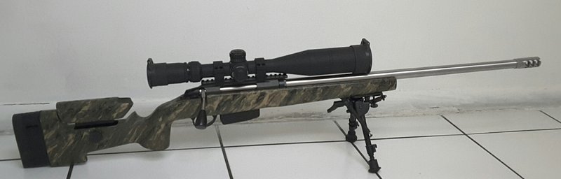

Got my rifle from PVA yesterday. Josh did an awsome work!
Tikka T3X receiver
PVA Tikka prefit nut barrel, 6.5 CM 24" Medium Palma
PVA Mad Scientist muzzle brake
McMillan A3-5
EGW 20 MOA rail
Vortex Precision Match rings
Vortex Razor AMG 5-24x50 EBR-7

My own PVA rifle from Josh!!! BigHornTL3, Hawk Hill, PVA Mad Scientist Brake, VZ Grip, LRA Bipod, Timney Two Stage, Vortex 15-60x, American Rifle Rings, Chambered in 308
Top Quality Work from Josh and PVA!!!! This thing is a Hammer!!!! I'm using it for F-T/R and Cast Bullet Benchrest
Very nice looking rifle! What kind of pistol grip are you using? My build should be ready in a few weeks and I can't wait to shoot it!
Updating group on my PVA 308 "special" project rifle-
Had the rifle out to 1255 yds now and it is producing magnum-like ballistics in the real world, matching Josh's and my paper ideas.
Details as follows:
Rifle built by PVA:
- 308 on long action Big Horn
- 30" Hawk Hill barrel in 8.7twist
- mag feeding from Manners mini-chassis plus MagPul 30-06 polymer mags (really slick product, huge improvement over the AIs)
- LRA bipod
- 5-25x Premier Tactical
Cartridge load:
- 308 Palma brass from Lapua
- 2000MR powder (yes, temp sensitive, but I know the change with temp and its very consistently changing)
- 198gr Flatline bullet loaded to 3.360" OAL
Sends the 198gr's at 2750 (60*F), mid-single digit SD. Josh and I estimate G7 BC is somewhere in the 0.411 range sent at that MV (its higher if you are sending it faster at muzzle) and barrel twist. 0.411 is getting me first round, perfectly centered on the vertical plane, hits at 1255yds.
Those ballistics will run with any of the Berger 30 cals sent at magnum velocities. It is shooting well inside of all 6mm and 6.5mm offerings on the windage plane.
This was yesterday 3 shots at 100 yards with my Tikka T3X with a 6.5 CM 24" PVA barrel nut installed by Josh on a McMillan A3-5, AMG scope. Awesome job.
Sent from my SM-T810 using Tapatalk
