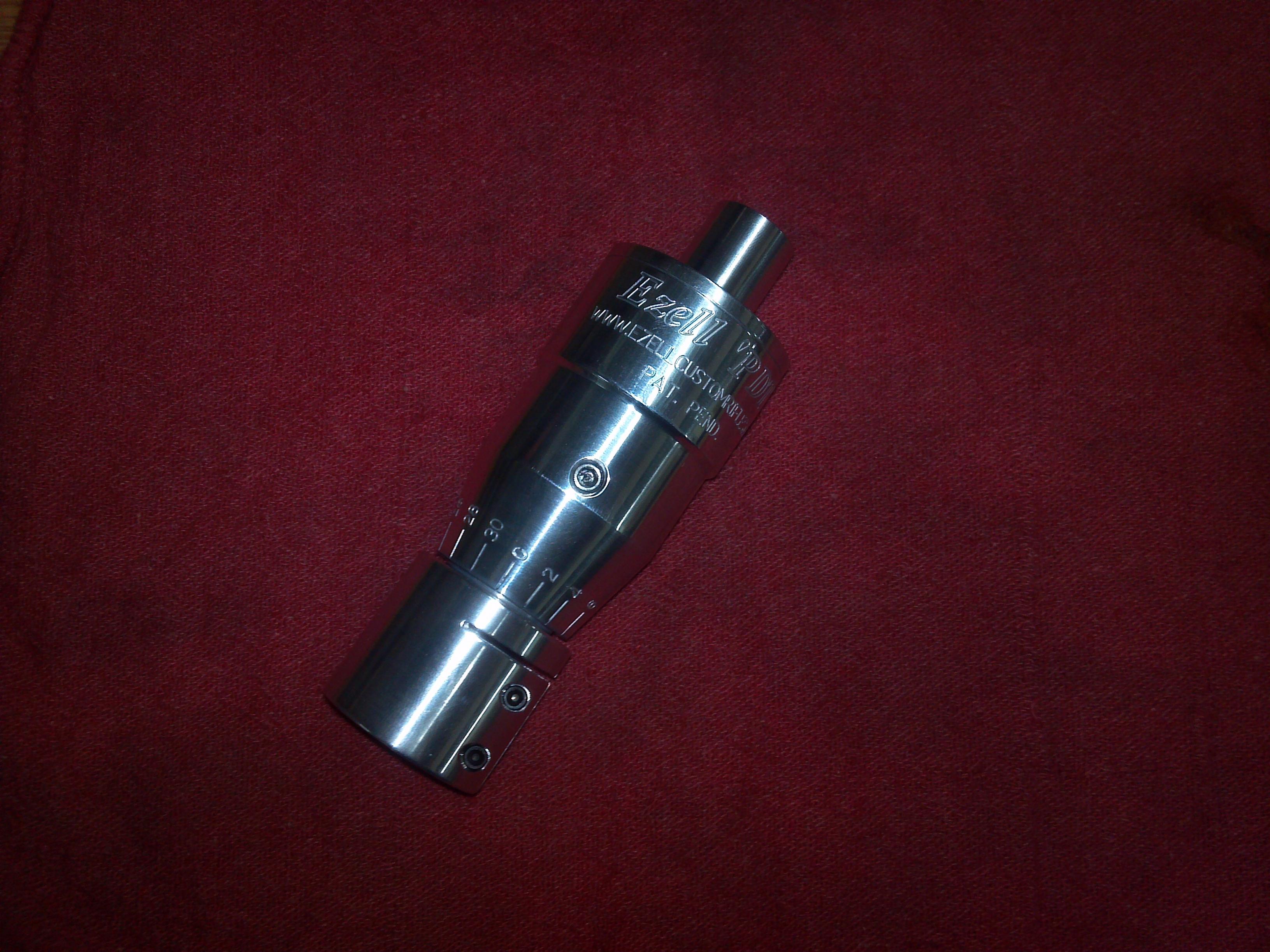

Many of us on the Rimfire forum enjoy shooting the 6x5 challenge at 50/100/200yds. Me included. My previous best at 50yds was:
Average = 0.212" 0.405 MOA
Best = 0.147" 0.281 MOA
Shot with my trusty old bone stock Remington 540XR tgt rifle with 36x Sightron scope. Those are good numbers for any rifle. But being a confirmed accuracy addict, I was seeking more, lol. Enter Mike Ezell, of Ezell custom rifles in Auburn, KY. Mike has developed what he calls a PDT, or Particle Dampened Tuner. I do not know Mike other than speaking to him on the phone and am in no way associated with his business but I did know a thing or two about harmonic dampening of steel structures and had an interest in bbl tuners having seen the old Harrells tuners in action at various benchrest matches. What he described is a barrel tunner that contains particles of tungsten powder in tubes surrounding the bore and these help to dampen and broaden the node in the harmonic vibrations of the barrel. Regular tuners do this but the particles in theory were proving to widen the sweet spot and enable a tuner equipped rifle to not only shoot better but to shoot well with a range of ammo. I swallowed that story and ordered one about a month ago. Well yesterday, it arrived. I dropped all my Honey-Do's and installed it to my Purdy number (google Purdy Prescription or PRx for details), and raced off to the range to test the wonder weapon.

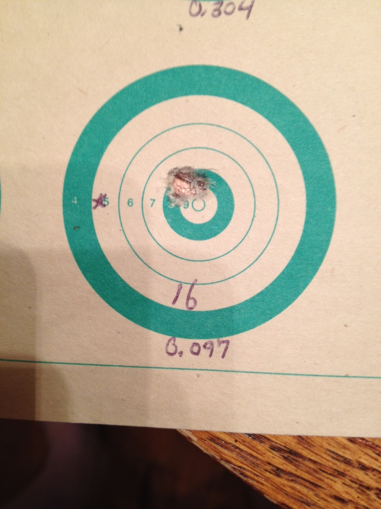

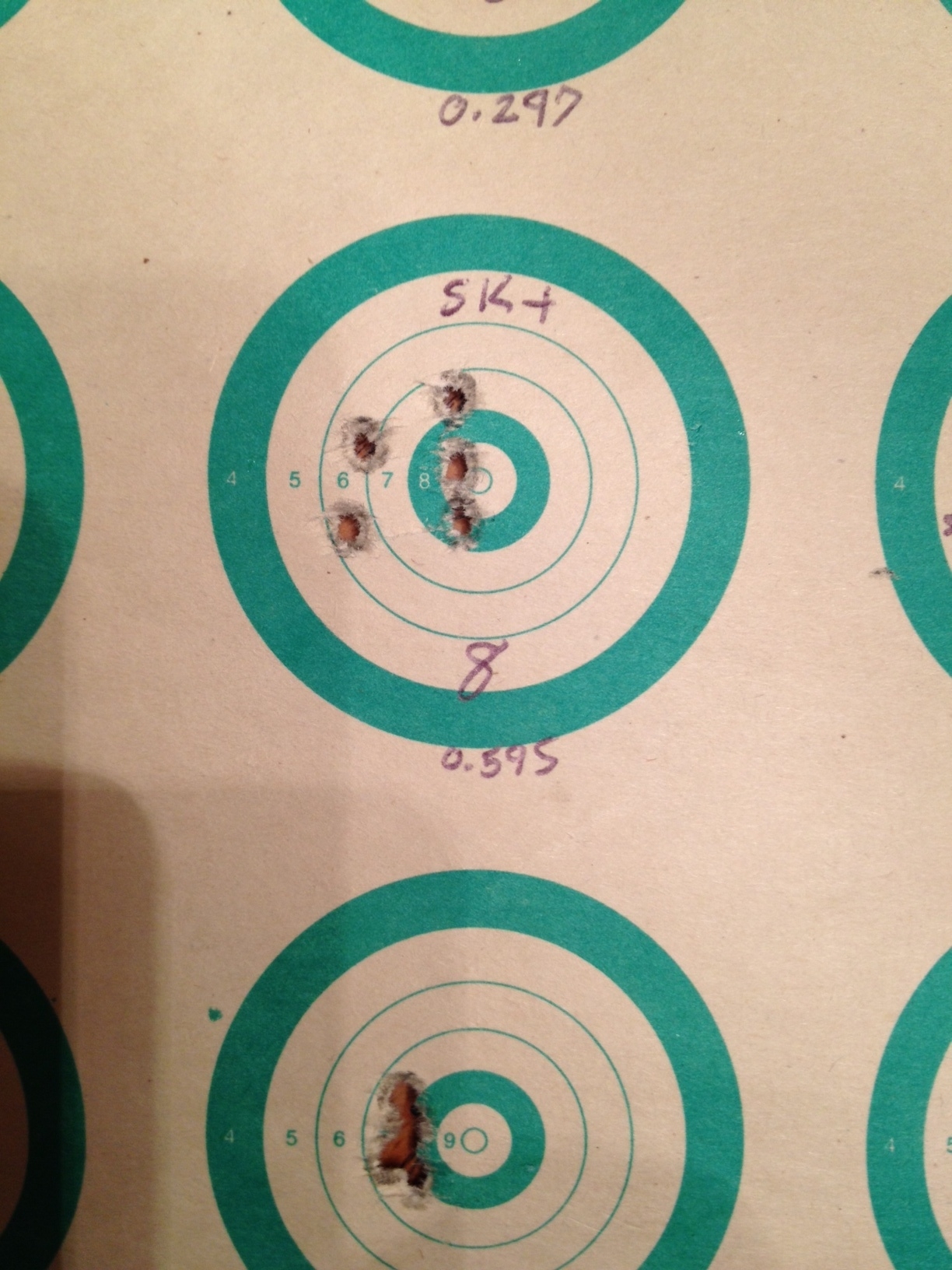

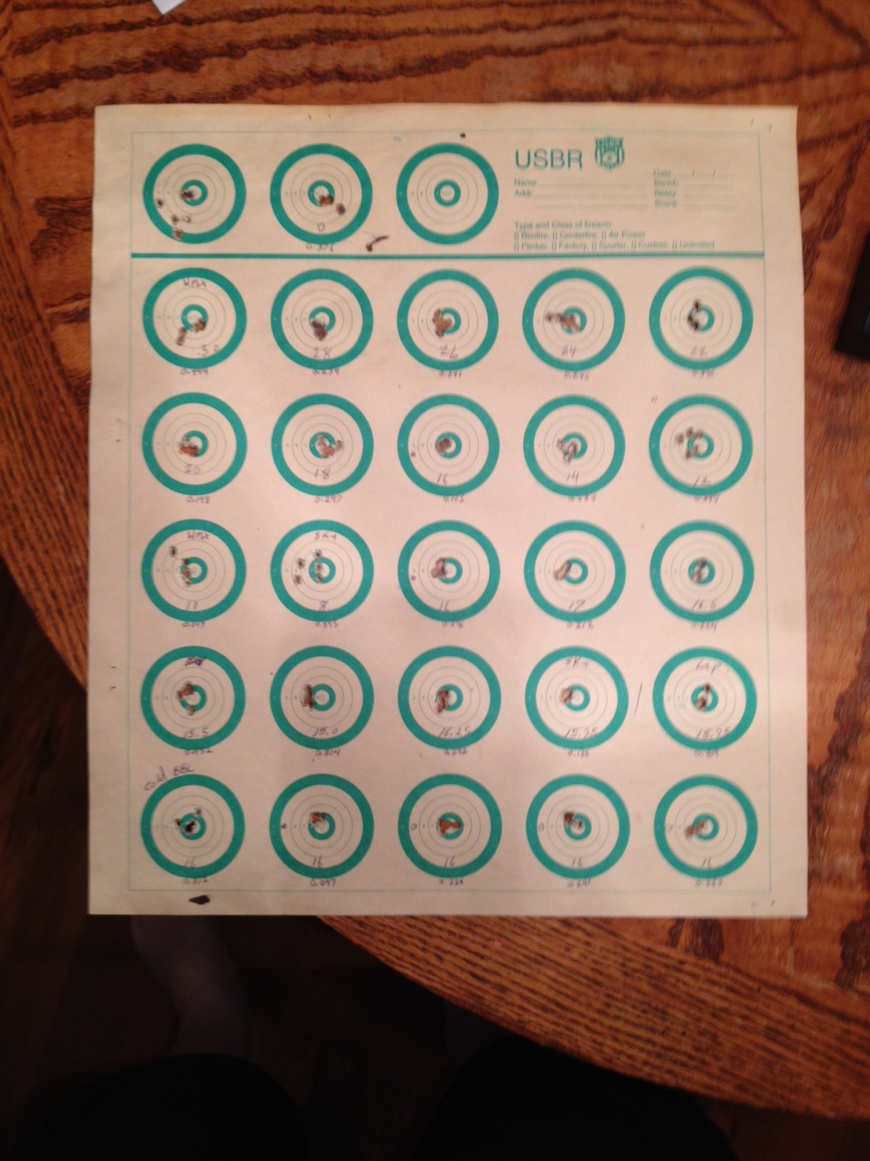

Range Report: Short answer is the PDT contains magic pixy dust that turns good rifles into amazing rifles and average ammo into Olympic grade match ammo. Wow, Wow, Wow!
Longer answer is this. I think I can legitimately claim that my rifle which was already shooting in the 2's at 50yds on a perfect day with one great lot of Lapua ammo, will now shoot in the 1's, even on a less than perfect day and will do it with several different ammo lots. I am pleased and really only scratched the surface. I set out shooting 5 shot groups at a USBR tgt from a two piece rest off of the bench at 50yds. After each group, I adjusted the tuner by two numbers and repeated the process. I was using Wolf Match Extra not wanting to burn up my good Lapua while warming up the bbl and clicking thru a range of settings. I was looking for the settings that caused the groups to tighten up in the vertical. It was windy and normally, too windy for me to bother to shoot. I aimed directly at the center dot of the tgt every time and did nothing to adjust for the wind or attempt to improve a group by holding off. This hurt the overall group sizes a little and raised the average group size. But what I was getting is a pattern, where the groups would shrink and then expand again as the rifle hit a node and then adjusted away from it. See the tgt pics posted below. I went from 30 down to 8. At this point, I ran out of Wolf and then switched to SK Std + ammo. The results to that point showed that set on 16 was getting the best results with a group of 0.165". So, I clicked the tuner back to 16 and repeated the group using the SK ammo. The result was a 0.206" group for five shots all in a nice little cloverleaf.
At this stage I wanted to adjust on both sides of this good setting to see if it improved. Clicking to 16.5 and 17 caused the groups to open up a little, so I clicked down to 15.5 and then 15. They opened up even more with vertical stringing but 4 of the 5 shots were all in one hole. With that in mind, I tried 16.25 and 15.75. Both of these settings got good results with groups of 0.292" and 0.135" respectively. Clearly somewhere between 16 and 15.75 seemed to be the sweet spot. Now I was out of SK ammo but was ready to switch to my Lapua Center X ammo and run some more groups. The first group was set at 15.75 and all four of the first shots hit exactly in the same hole with one flying high by about 1/4". Interesting. We stopped for 5 min to allow guys at the range to post tgts and when I resumed the cold bore caused the groups with setting of 16 to open up. But the Remington always does this after a break, so I repeated the same group with setting of 16 and was rewarded with a group that is the best ever for this rifle. It measured 0.097" center to center. Wow! I shot three more groups at that setting all in a row with the Lapua ammo but they were all in the twos with lots of horizontal dispersion as the wind had now picked up. The vertical dispersion was almost non-existent indicating that the tuner was still doing its job.
Some stats: I shot six groups with the PDT tuner at a setting of 16.0 and when I measured them, they averaged 0.199" with a best group of 0.097". That would be tops in the 6x5 challenge but they were not all shot in a row and were shot with three different Lapua ammo products (Wolf MX, SK Std+ and CX). So, I will not submit them as a legitimate series of groups. But the results on a less than perfect day were still impressive. I also measured the last six groups fired. These averaged 0.213" which equaled my best every run on a perfect day with zero wind. Plus the best group was that 0.097" which is a personal best with this rifle. I believe that if I sat down and shot groups on a perfect day with my focus on making the group as small as possible and adjusting for the wind with each shot, I can consistently get this rifle into the 10's at 50yds. I might still need to tweak the tuner a little bit as well. I also want to test it with Eley ammo since I have a bunch of it on hand.
Final summary: While the numbers indicate a small improvement, the most telling thing is the way the rifle shot on a day that was far from perfect and how well the rifle shot when dialed into a sweet spot. Out of 25 groups fired, I had 16 where all the holes were touching and nine that were smaller than 1/4 inch. All while NOT attempting to adjust for wind or mistakes I may have made on each group. And I was not being particularly careful. I was firing about one round every 20 seconds and as soon as each round was loaded, I aimed and sent it down range. At least 12 of the 25 groups had all but one round in a single itty bitty hole and only the one stray in some of those opened it up further. And in most cases, those stray shots were due to wind shifts that I intentionally did not adjust for. The results from this first test of the PDT are amazing and I am very pleased with it. Again, I have no association with Ezell or his business. I am just a happy customer. Now I want to go shoot a match to see how it does there. Need to shoot Justin's dot shoot again as well or take it out to 100yds. Will wait for a calm day for that. :cool:
Irish

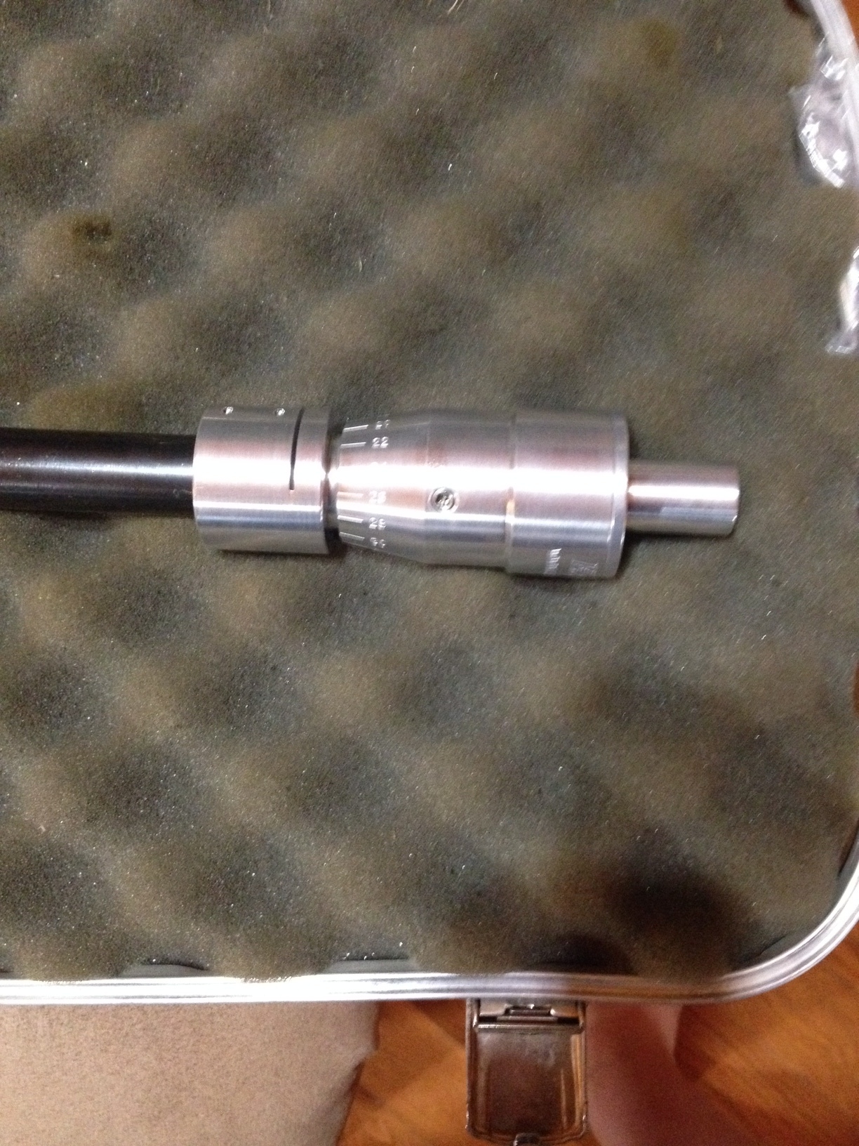

The rear portion of the tuner is bored to exactly match the taper of the bbl so, the tuner will not match just any rifle. I have a HB Rem 700 in 223 that I would like to try it on but the center fire tuner model is mechanically different from the rimfire model and so, it is not necessarily a 1:1 replacement. At about $200 a copy it is not cheap either, and so buying one for all my rifles is also out, lol. It is also not fool proof. When I switched to Eley ammo, it seemed to scatter the rounds with the tuner on the Lapua settings. One two hr range session is not going to get all of the potential out of it. I have a lot of Eley that does not shoot all that well and my next step is to go to the range and burn about two boxes of it while clicking thru the settings to see if the tuner will tighten up ammo that is not a proven winner. After that I will try it with some Eley that is proven to shoot well in this rifle. The tuner adds almost a pound to the weight of the rifle, which means it is not a great field rifle accessory. In my opinion, a shooter will only be able to observe a benefit from the tuner with the most accurate rifle/scope combos and shooting techniques. I would never see the benefits if all I was doing is shooting off hand at squirrels. Too many other variables would take over and dominate the accuracy equation, if that makes sense.
Look at it this way, while the Remington may be a proven hammer, its best ever 5sh, 50yd group regardless of conditions or ammo was a 0.128" before the tuner. Now with the tuner, it shot a 0.097" the first time out. That is a 25% reduction in group size and was done in windy, sketchy conditions. Before the tuner, I think I had recorded only nine total groups with it in the 1's and I shoot it a lot. After the tuner, in the 1st range session, out of 26 groups fired, it recorded four groups in the 1's. That is killer impressive to me. It tells me that the rifle is already consistently shooting measurably better than before. And keep in mind that only seven of those 26 groups were fired with the tuner set at its best setting, so I expect the percentage of tight groups to increase once I start shooting it for groups, making small corrections for wind, etc. I went back and looked at the tgt where I was testing the nice lot of very accurate Lapua Center X that shoots the very best in my rifle. This was before the tuner and in perfect conditions it scored 15 groups that all averaged 0.251". No other ammo has ever done that well for me. With the tuner, I shot seven groups with the tuner set to the optimum setting. I discounted the one where the bore was cold since this rifle needs a few shots thru it before it begins to shoot straight. Taking the other six groups there was one shot with the Wolf ammo, one with the SK Std+ ammo and four with the Lapua CX ammo. All together they average 0.199". That is a 21% improvement. Even if I include the cold bore group the improvement is 11%. So, the best group improved by 25% and the average improved by 20%. That is measurable in my view, even with a rifle that is already shooting very well. When I bought the PDT I thought it a bit of a gamble, but considering what I spend on ammo, it seems rather cheap. It will be interesting to see if it will allow me to shoot cheaper ammo well. That would be nice. Anybody know where I can find some "cheaper ammo"? :p
The real proof will be taking it back to some ARA and IR50/50 matches and shooting for score. Those provide independent measurable data under match stress conditions. My best IR50/50 tgt with it was 248/12x and a typical tgt is about a 243 with 11x. My best USBR tgt was 245 (forgot the x count). My normal USBR score is lower at about 231/4x. As for ARA, I don't think I ever shot this rifle in ARA. We have a local unlimited IR50/50 match every month near me. I will go and play with the big boys and see how it does. They usually trounce me with their high dollar custom match grade rifles. A measurable improvement will be to not score in last place.

Bertman, I posted a pic of just the tuner in the original post at the top. Here is a pic of the rifle with tuner on it perched on the bench and another close up of the PDT itself from Ezell's website. For the initial test I chose to use a Rock Rest with a very thin sandbag on top for a front rest and a heavy Protector rear sandbag at the rear. It was a basic F-class legal shooting rest. I wanted to eliminate as many other variables as I could so, the merits or lack of merits from the tuner were visible. If you zoom in on the full targets that I posted, you can clearly see the groups get smaller as the rifle goes in and out of tune and bigger when it is going out of tune. I am not going to try to explain the physics behind bbl vibrations and am not even sure I fully understand them myself but the layman's description is that when the rifle is fired the recoil energy cause the rifle to rock backwards and the weight or inertia of the barrel is attempting to remain at rest or resist this movement. This results in a moment of inertia being placed on the barrel and that force bends the muzzle downward. As the bullet travels the length of the bbl, the barrel will stop moving down and eventually spring back up. This results in a sort of tuning fork vibration of the long metal tube (the barrel). I have no idea if it cycles once during the flight of the bullet down the tube or dozens of times but the tuner in effect causes the motion at the muzzle to stop or at least be at the same place every shot, so that the result is better overall accuracy.
The PDT adds weight but I think it is the variable length and the ability to adjust the harmonic frequency of the barrel vibrations to the speed and energy of the ammo that results in the biggest change and not so much the weight of the tuner on the end. What may make the PDT different from other tuners is the use of the powdered metal further dampens the amplitude of the vibrations and may slow them down, which results in less disturbance of the barrel in the first place. How is that for "Cheap Rifle Barrel Physics 101?" :cool:

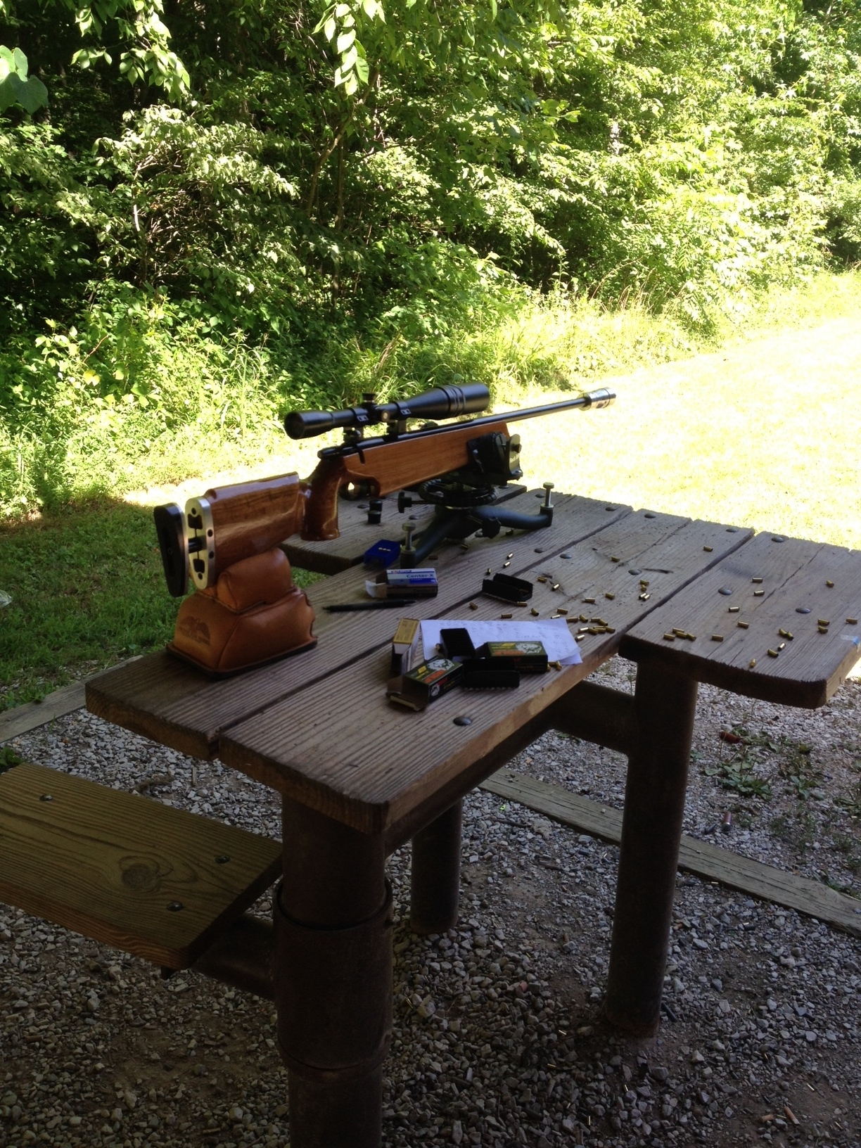

Took the Remington 540XR to the range yesterday. It was more windy than I like for this kind of shooting but I wanted to get more trigger time with the Exell PDT muzzle tuner using other ammo that has not previously shot the best in my gun. I chose Eley Blk. Out of all the top ten options that I have tested in this rifle the Eley Black only performs to 5th place. It is routinely beaten by Lapua CX, Wolf Match Extra, Wolf Match and 10x. Not that Eley Black is bad ammo. It is great ammo and is supremely consistent, but is always consistently shooting slightly larger average and smallest groups. I wanted to see if the PDT changed this. Conditions this day were not nearly as good as the dead calm day that I shot my best groups at 50yds but were reasonably similar to the day I last shot this rifle at 100yds (using my best lot of CenterX). Results. I shot 15, five shot groups at 50yds, all while adjusting the PDT looking for a sweet spot. It shot pretty good at my CenterX setting of 16 but seemed to be slightly better at 29. While it did open up at some settings, it shot pretty consistently in the 2's at most of the settings from 24-30. But at 29 I had one group measured 0.098"c-c and another just as good except one shot went high opening it up a bit more. A third was nearly as good but the wind blew one to the left. Yada Yada. Still, it is exciting to see a rifle just pounding them into one hole over and over save for an occasional stray. This was all done while trying two different lots of Eley as well.
I then moved out to 100yds. I had posted up two pages with five bulls each on them as well as two other tgts. The grass obscured two of the little bulls so, I skipped them and just shot groups at any decent POA on the paper. Again, I fired 15 groups of five shots each. All from a bench and two piece rest. Wind if anything was now worse at about 5-7mph and variable. Still the little rifle was pitching strikes. I used the first three groups to get the proper range and then shot 6, five shot groups in a row that averaged 0.493"/0.491moa with a best group of 0.247"/0.236moa. Ot the total 15 groups, the worst was 0.829".
It is noteworthy that my best average at 100yds using my best lot of CenterX ammo in the past was 0.840". So, the PDT using only average ammo was able to improve my average by about 41%. My previous best overall group at 100yds had been 0.408". With the PDT, my best group improved to 0.247" or about 39% better. And these six groups are not that exceptional. All the groups averaged 0.606" at 100yds. So, it was shooting an average of just over 1/2moa at 100yds in gusty wind conditions that normally, I would have judged to be too windy. It was also observed that 7 of the 15 groups at 100yds were wider in the horizontal dispersion than in the vertical indicating again that wind was a significant factor. I was not attempting to read the wind or adjust for it during this session but I did use a very nice wind flag sitting at the 40yd line as an indicator. I also, did not stop shooting when the wind shifted or got worse. I just kept firing. This was a pleasant result.
Going back to the 50yd results. This day's best group of six consecutive five shot groups averaged 0.254" which about matches the best scored with Eley ammo of 0.252" but the best was scored on a zero wind day. The Eley average today did not match my best with CenterX. The best group with the PDT did however beat my best ever group with Eley and CenterX (prior to installing the PDT). And matched a previous 0.097" group shot with CenterX after installing the PDT. So, my conclusions there are that it improved the best group with Eley by 24% and the best group with Lapua by about 27%. Undeniable, consistently better results in every trial so far. I did not have time to do the 30rd dot drill at 50yds. Will do that later.
