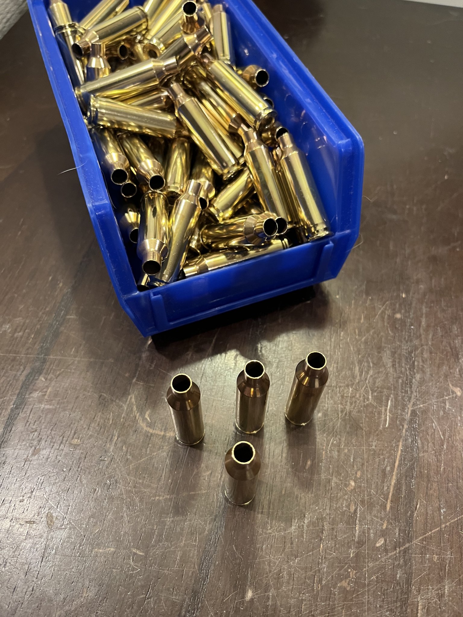

I have two sets of Lapua 6BR brass which is once fired. I loaded up some rounds (which would be second firing on the brass) and found that when I tried to chamber them the bolt would stop just short of closed.
I inspected the rounds and could see no obvious issues, and I found that if I lightly tapped the bolt forward I could then close it. I shot the ammo like this (it was annoying but shot great with the normal level of accuracy.
I figured I had messed up on headspace and hadn't bumped the shoulders back enough (I measured the original fired cases and bumped them back two thousandths). I use custom Whidden dies (this was my first time using them).

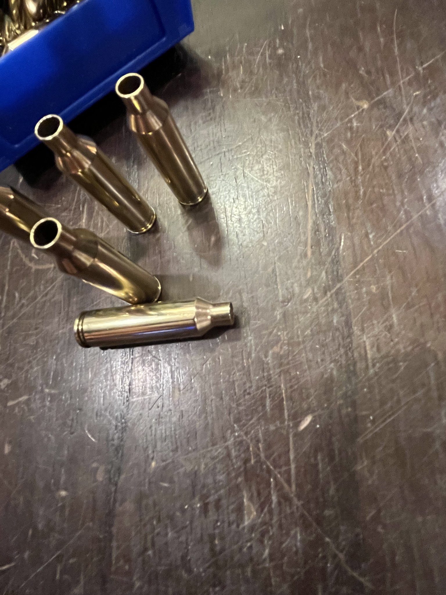

When I got home I looked over the fired brass and took some measurements, I also picked up a Whidden BR case gauge which has measurements and Go / No Go markings. I found that I had bumped the shoulder back but I was still ~ 0.001" shy of the GO length (easy fix, I tried to chamber some prepped brass (no bullet) and it was slightly tight but barely noticeable.
I also noticed that the prepped cases had some peening and I started to wonder if that was a factor. The extra force it took to load a prepped case was definitely less than it took me to load the loaded rounds so I got to thinking if the raised lip on the peened area was what was causing the issue (bullet would expand that area when seated which would explain the extra force required to seat between a loaded case and an unloaded case). To be clear the bullets are not in the lands (measured / confirmed as 0.075" jump).
I used a wet tumbler to clean them with no stainless steel pins. Even without the pins there is still peening on the mouthes (can feel a lip with my finger nail). I will reduce the time from here forward to see if that helps.
I still feel that headspace was the issue but how are others dealing with peening? I have a Giraud and could chamfer it off but I dont want to do this every time (even removing a very minimal amount of material is bound to add up over time.
You are probably either overloading your tumbler or running it too long. Unless the peening is extreme, a quick chamfer should take care of it.
Don't feel like it was overloaded (only 100 rounds / one lot of brass in the tumbler), as mentioned previously I will try reducing the time.
Reducing the time will help I'm sure but I'm still expecting peening (albeit a reduced amount).

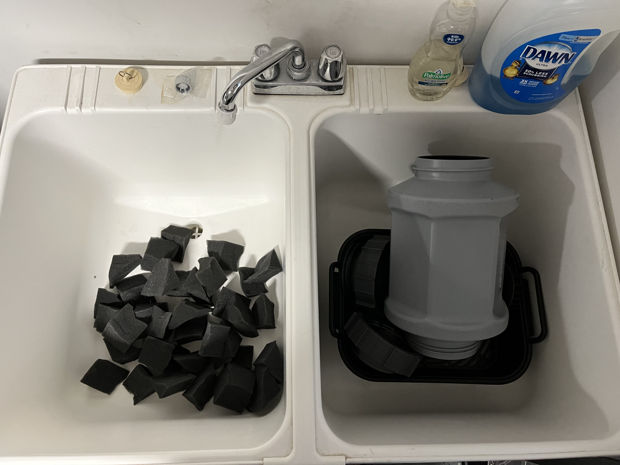

How many cases are you tumbling at once? Many people overload the tumbler and there is too much weight in brass and not enough pins to cushion. Case necks are soft and they will peen.
100 cases (1 lot) at the time. No pins. Interesting to hear you say pins help to cushion as many times I have read that pins cause peening.
Recently I have not been using pins so much, it makes the process much easier and I find it removes enough dirt to keep the dies clean but still leaves a little carbon in the neck which makes seems to seating more consistent (vs squeaky clean brass).

These were:
> fired
> annealed (AMP Aztec)
> deprimed
> FA 7L tumbler, ~5lbs SS pins, 98% full of water, splash of Armor All Wash & Wax and pinch of Lemi-Shine, 90 minutes, speed turned down to around half of its normal speed with the “fan speed control“ thingy mentioned earlier.
I probably don’t have a good enough camera to show it, but the necks look great, no real peening to speak of.
It probably helps that I only deburr the outside of the case-mouths/necks once when new, and whenever I trim. Otherwise, I just chamfer the inside of the case-mouths every time. I think leaving the outside of the necks alone and not thinning them out unnecessarily helps protect them a little better when they’re bashing around in the tumbler.
Anyways, so far, so good…
