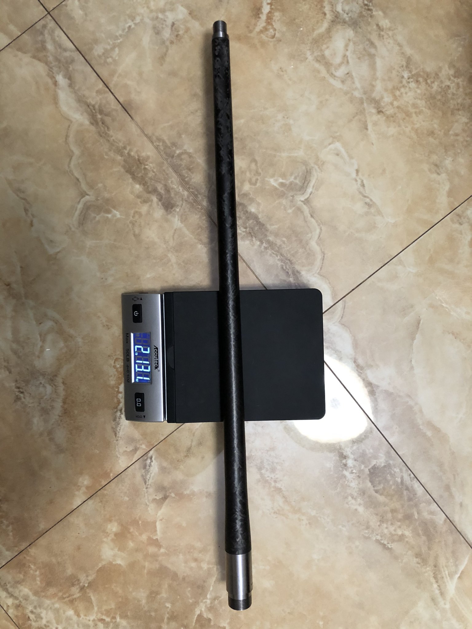

I run a proof CF barrel on my rig but with my 5+ lb stock it’s still pushing 14+ lbs for hunting.
From a 24” 6.5 creed medium Palma steel barrel to a 26” CF proof 6.5 prc sendero lite I saved about 2 lbs on the barrel alone.

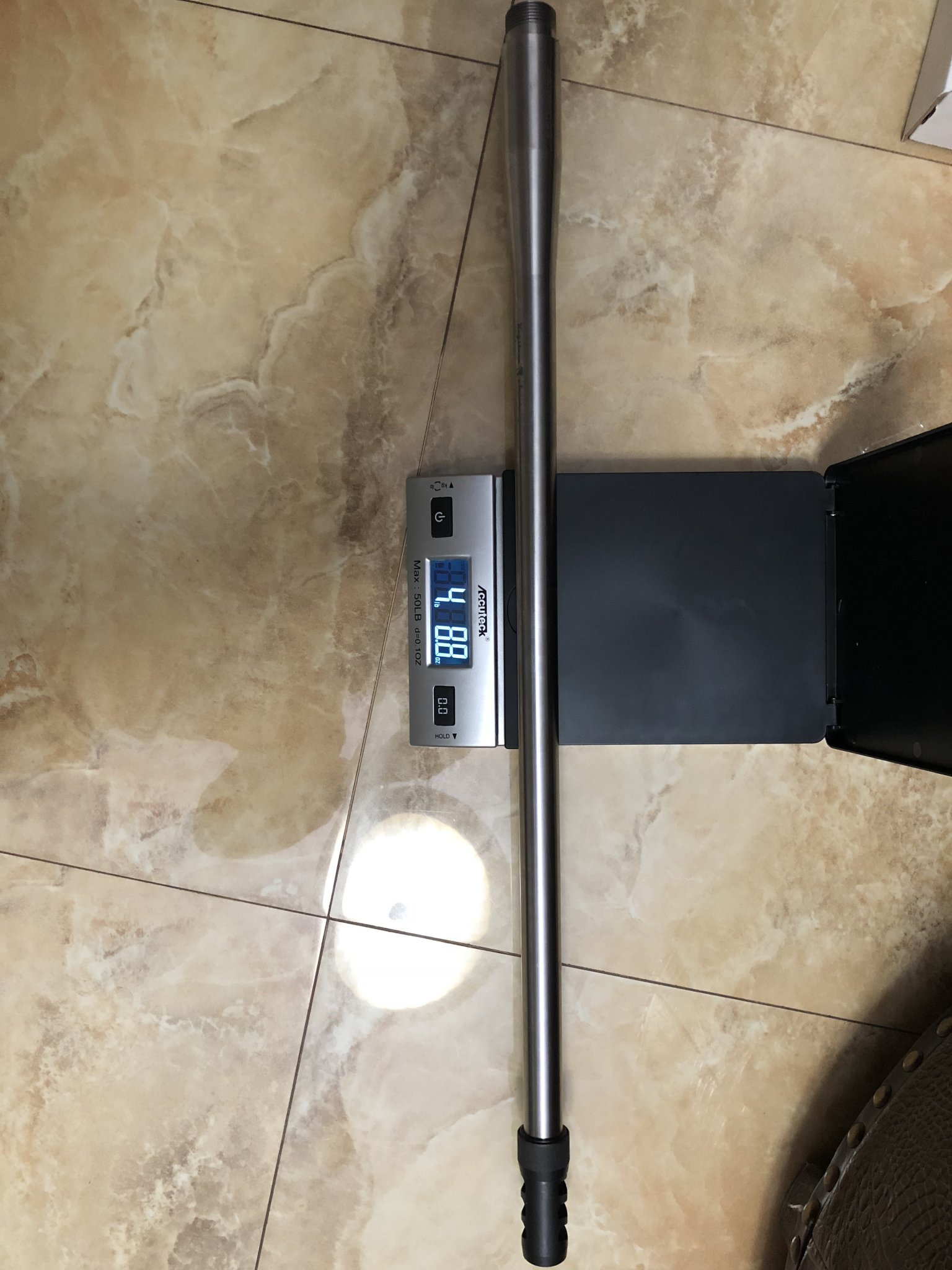

OP-I had this same dilemma and wound up going 6.5 SAUM. It’s got a Bartlein 3b at 22” and wears a TBAC Ultra 9. Rifle sits in an EH1 w/DBM. I’m kissing 3000 FPS w/143 Grain ELD-X. I’ve shot a Pronghorn at 355 and a Whitetail doe at 520 with excellent results. Wouldn’t and will not hesitate taking an elk with this set up. Recoil is non-existant.
Medium Palma is going to be heavier than Sendero. The Sendero contour can allow it to fit into smaller stocks, not really an issue if you are set on the KRG Bravo.
You talk a lot about weight concerns but don't mention a weight goal. Fluting isn't going to change either of these contours into a 'field' rifle, at most you will save 3/4 lb. A 12.25 lb rifle is still heavy. Besides, it looks like you have field rifles covered.
