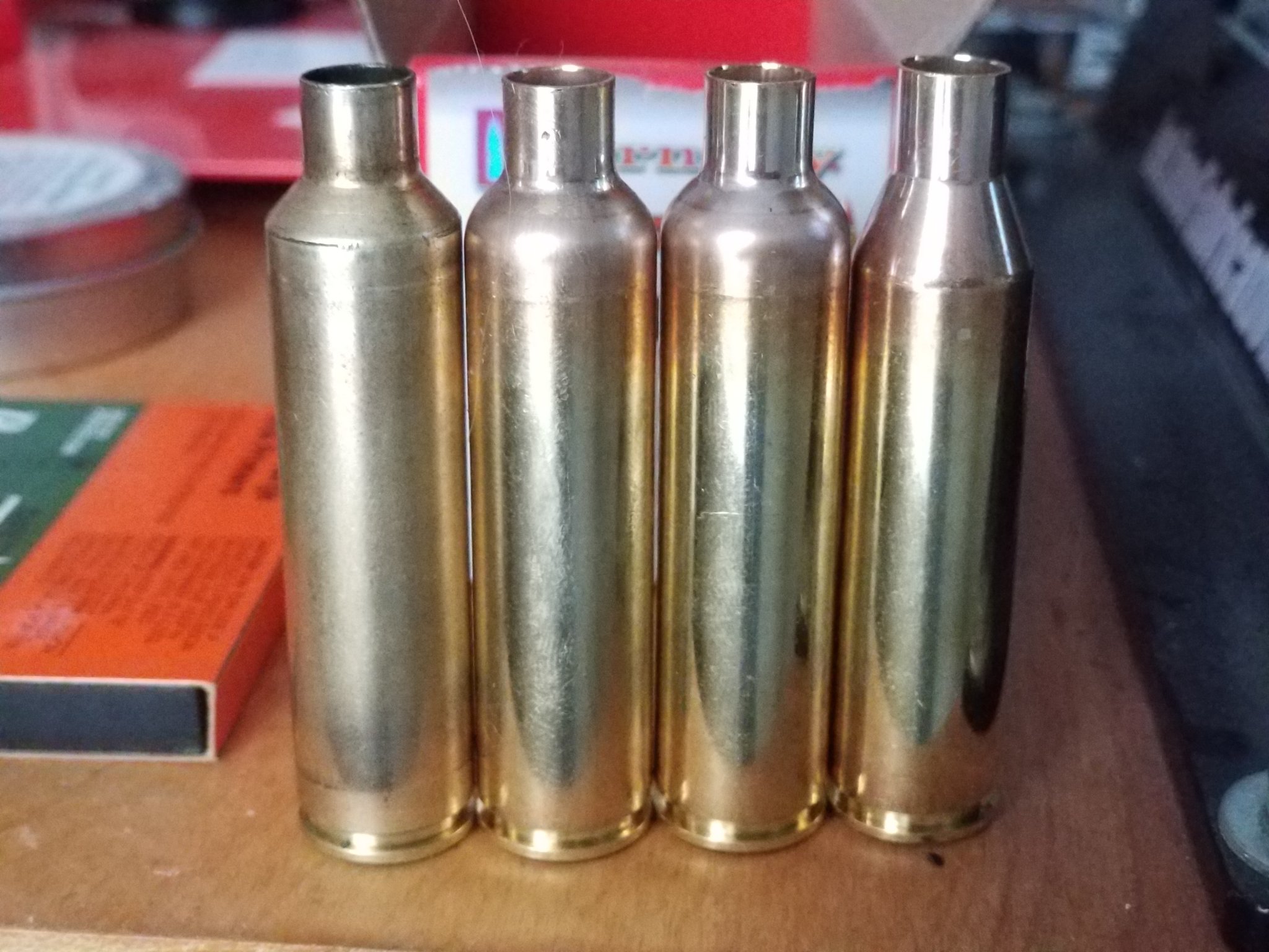

I have a 300 Norma Improved which I used Peterson Brass to form. I was a bit hesitant due to the note which was included with the brass and the postings on this thread... with the back order on Lapua's 300 Norma brass I decided it give it a shot... (see attached picture) Trying to mitigate the shoulders from splitting I hydro formed the brass then annealed it before loading and firing in my rifle. All 50 pcs of brass formed well without issue.

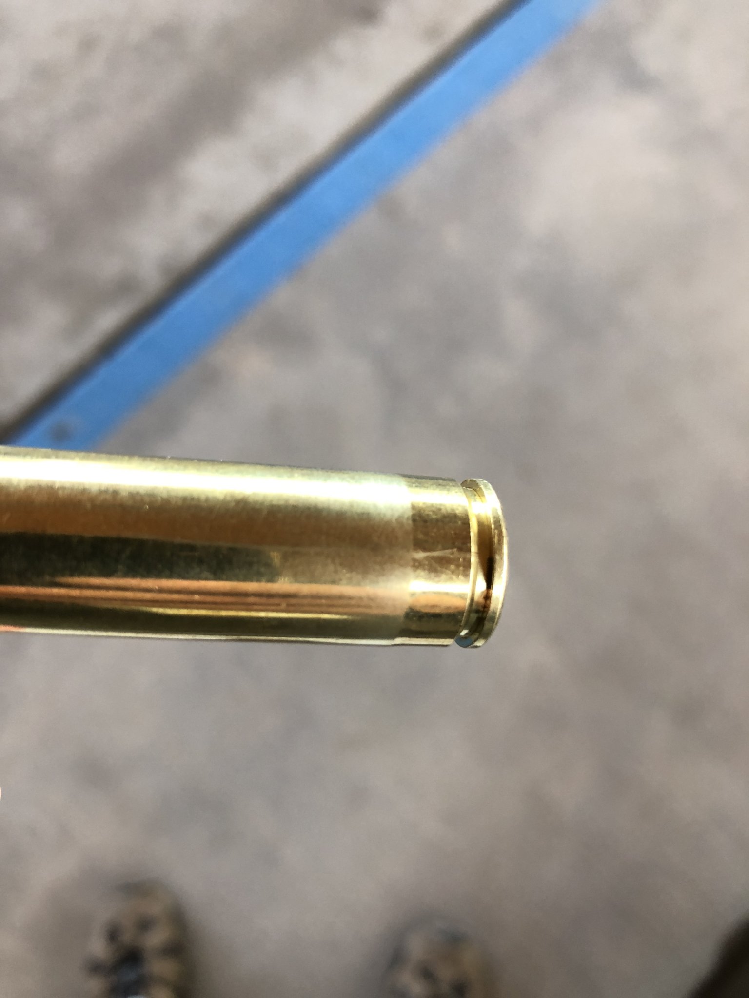

338 Norma Mag, apparently I have first run brass. According to a notice from Grafs they purposely used 338LM brass as a starting block causing what you see in the picture (I didn’t know this when purchased). Makes it appear you have an oversized chamber, something my smith felt pretty bad about until I discovered the Grafs notice.
I have an email into the company now to see if they will make things right by giving me an exchange on my first run, out of spec brass, with the newer in spec brass. I’ll update my post with the results or lack there of.
I have a box of factory Norma ammo coming just to ensure it’s not an oversized reamer (mine was the first chamber on this reamer).
I hope it works out because besides the out of spec body size, it’s the nicest packed, most consistent brass I’ve ever seen.
UPDATE 10/15/2018: I was contacted by Derek Peterson who said he will do the exchange with me once they have finished manufacturing the cases. He advised it would be around December or January, but I'm okay with that, Peterson brass is the most consistent and nicely packed brass I've ever seen.
