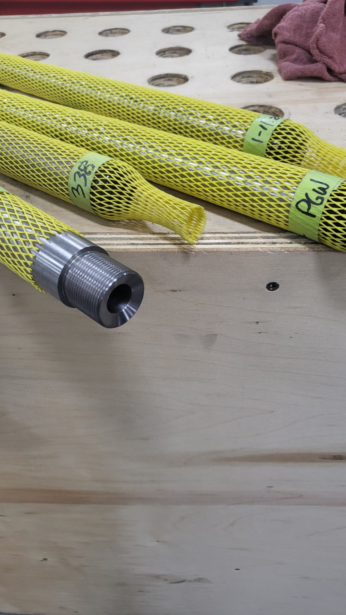

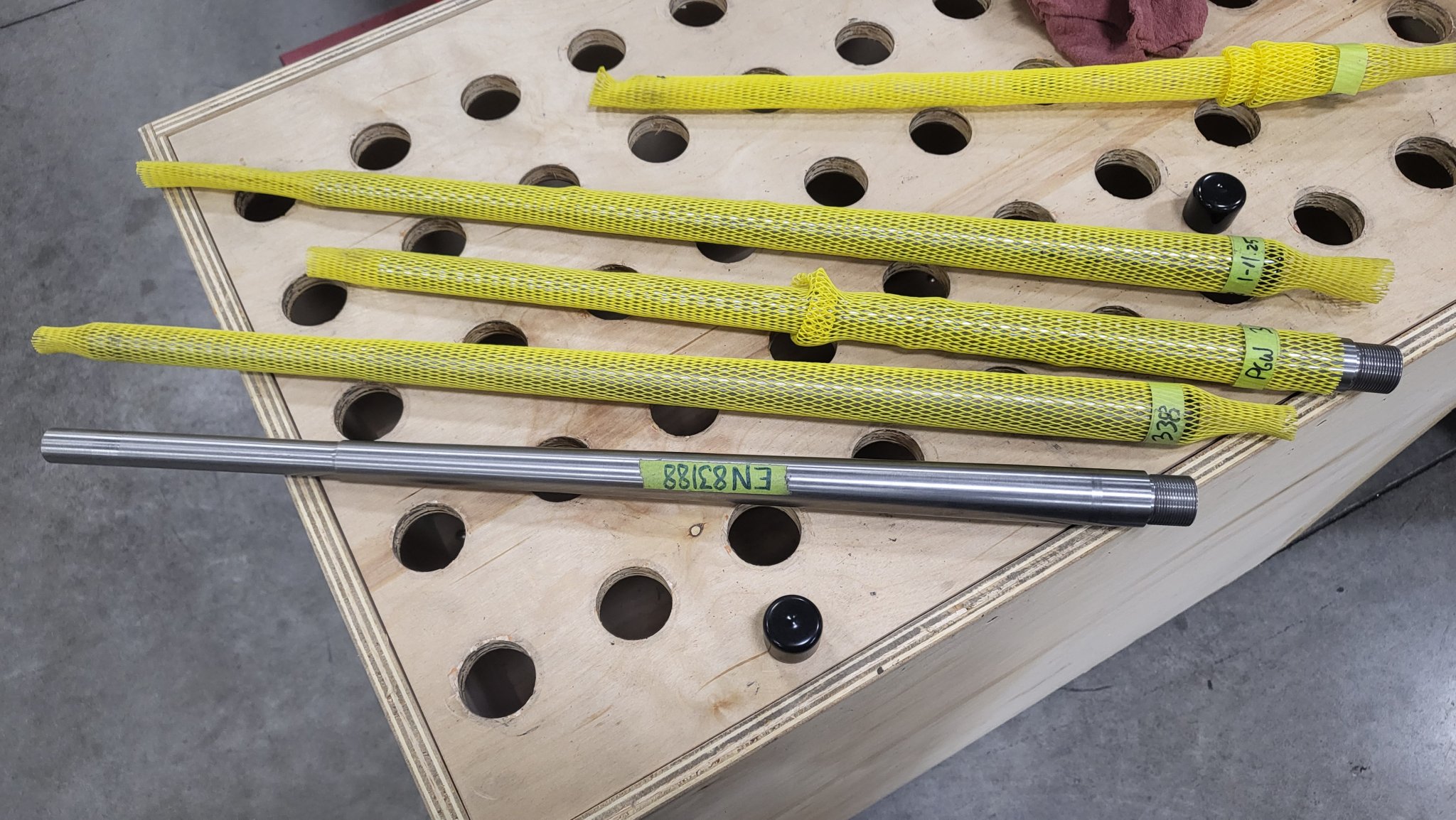

I've got a total of four PGW Coyote action barrels for sale. Gonna blow them out at a low price.
Two barrels are 5R rifling and 11.25 twist 308cal chambered with the PGW reamers and threaded for PGW actions and are 25" blanks in the PGW contour. They are not cut and crowned yet. The major diameter of the threads for the actions is 1.155". The breech diameter is 1.300" on the barrels.
The other two barrels are 338 Lapua and chambered in 338 Lapua CIP spec. chamber. The blanks are 27" long and again not cut and crowned. 5R rifling and 1-10 twist. Same contour and same breech threads as the 308 barrel just 2" longer.
All SS material.
PGW is out of business and these where left overs from a previous run. There is nothing wrong with the barrels.
I'll do a flat $250 each on them including shipping to any of the 48 states. First come first served.
