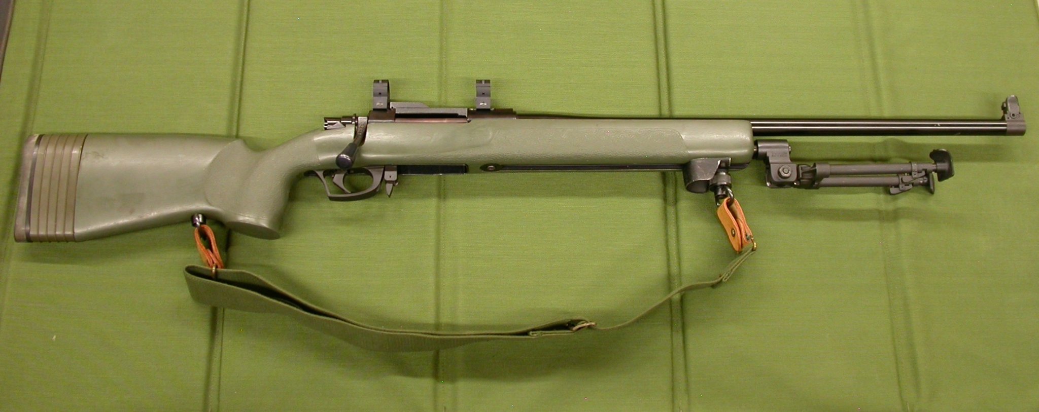

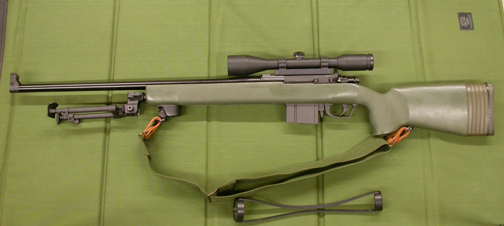

For your viewing pleasure
From Parker Hale records:
This Parker Hale M85 was completed on the 27th April 1987, and built by Eddie Taff Chief Engineer.
It fired a 14.5mm group @100 yards with 10 rounds.
No scope was ordered or fitted with this order.
It was built into a GREEN NATO stock and sold to the German Army under contract 10682 with 4 other M85 rifles.......232F/259F/281F/275F all were supplied without scopes fitted.
For your viewing pleasureView attachment 7108434
That’s pretty cool you found the contract. The only units I could find who openly used them were the Malaysian Paskal and the Brazilian Marines. There are “hints” but no proof that several special ops units, I.e. SAS and GSG9 but nothing I’ve seen in the way of pics or contracts. How did you find the contract? Provenance with the rifle?
Added: https://www.militaryfactory.com/smallarms/detail.asp?smallarms_id=1019

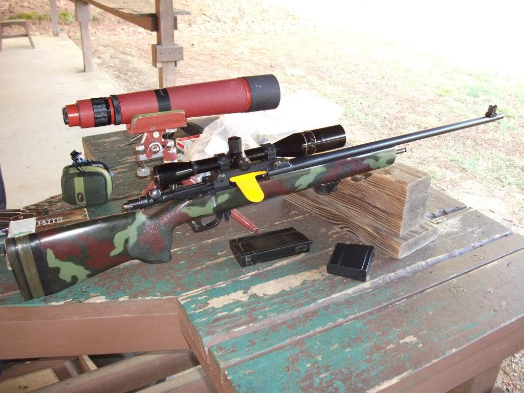

Note that the stock pretty much looks the same. ChrisF’s pics looked like it but had camo painted on.
Reactions: TacT-MecH

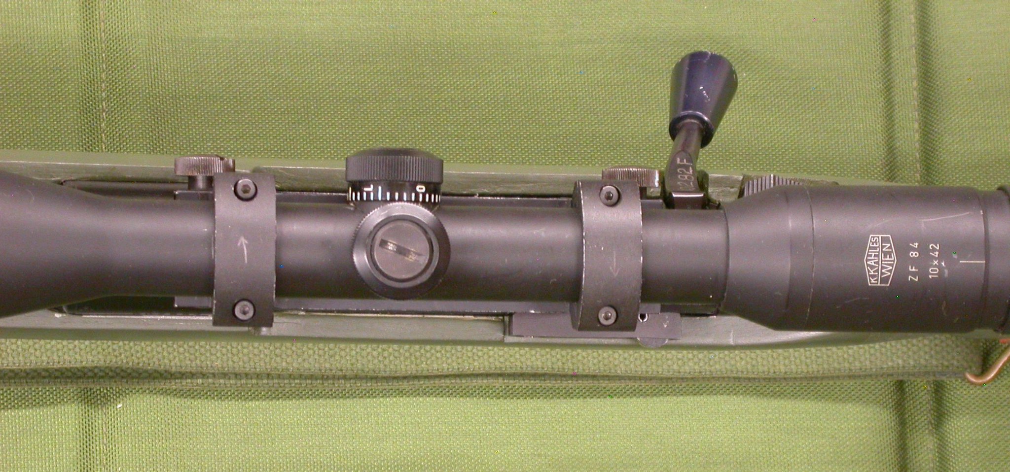

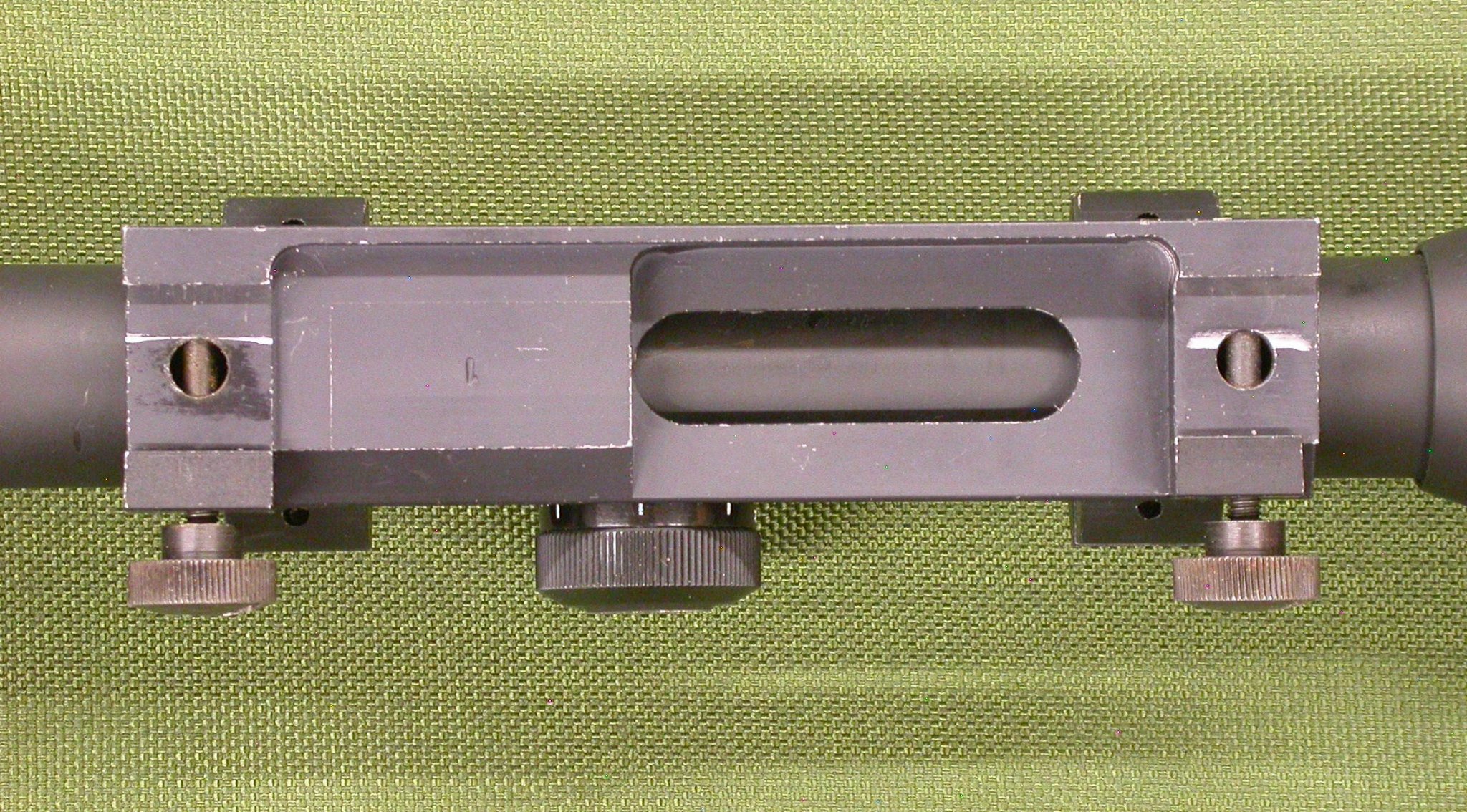

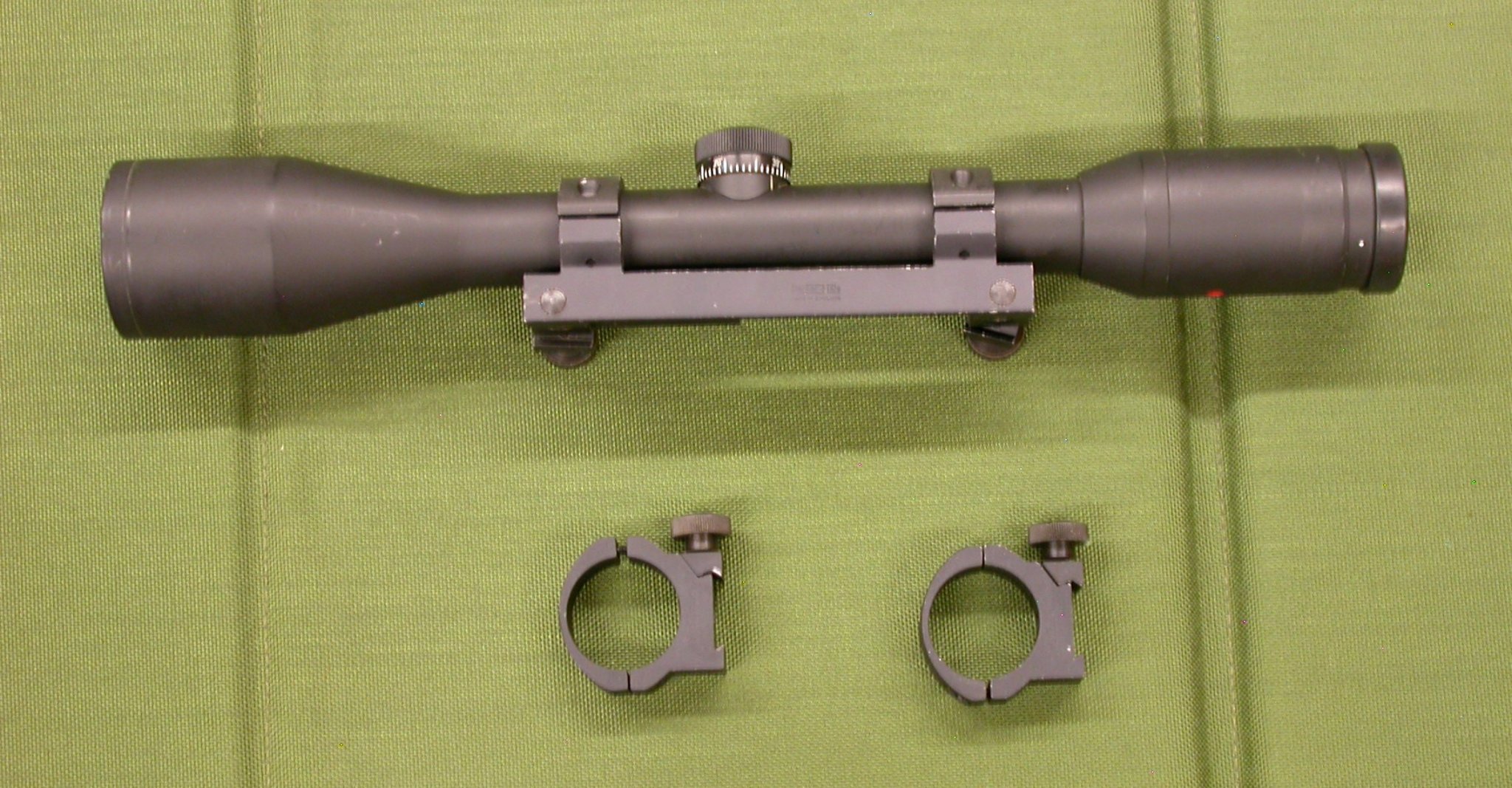

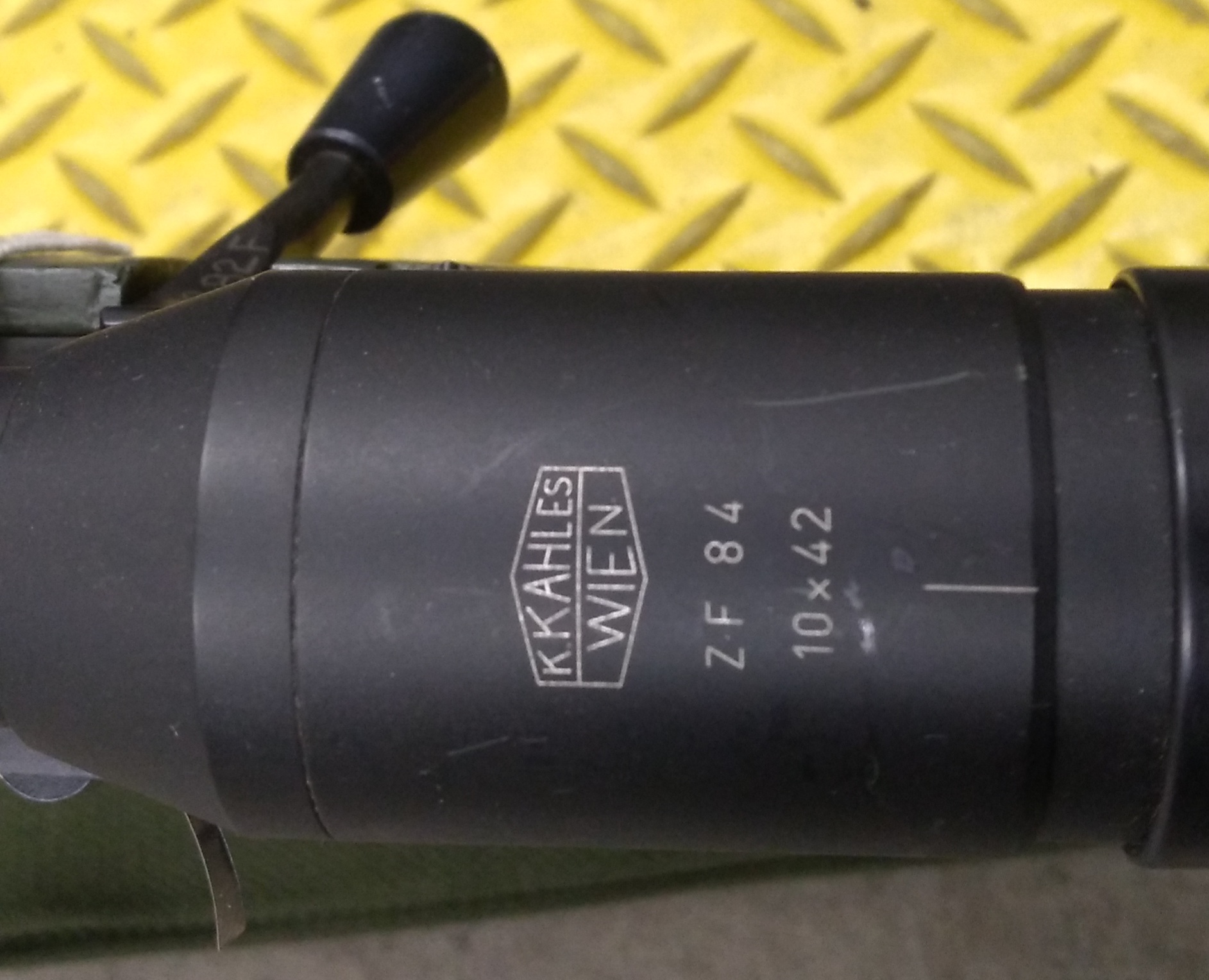

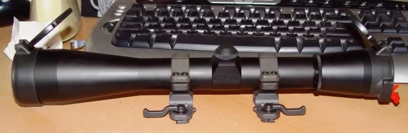

Kahles ZF84 and ZF95 in both 6x42 and 10x42, but most british M85s have been seen with S&B PM1 6x42. Rings where Parker hale 1 piece and 2 piece.
What rings and scope mount was used on the M85?
Neat rifle!
It was it's own deal. Like the M87/C3A1 it has a contour all it's own and it's a one piece.

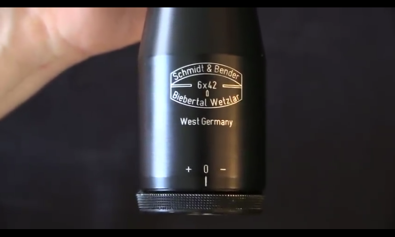

As far as the Schmidt & Bender, if it was, it was the 6 X42 in all probability. The rifle has been "on the way out" for a while and I doubt they would upgrade the scopes when they are wanting a new rifle.

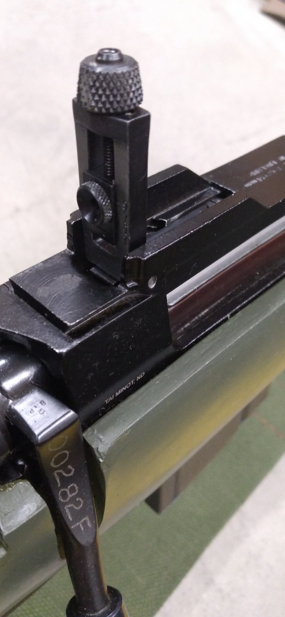

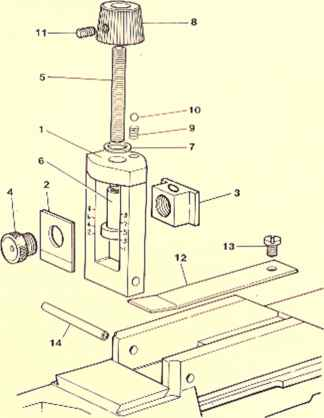

One of the hardest pieces to find is the rear sight: Added- PH-5B?
It actually looks pretty simple to make. You just have to have the right increments in the threads and markings for the elevation. No windage on this sight as I recall.
Added II- The website where I found this:
I wonder if you could make one from a Lee Enfield sight or something similar.
I think you could just make one. Of course, it takes skills ...and maybe a machine or two.
On the Lee Enfields, the elevation screw is on one side. On the M85 it's centered. You could still make one work maybe if you could offset the front sight, just that little amount.
Good luck finding the appropriate S&B scope for the M85, I think that's a tough one here in the USA...but hopefully you'll get lucky and find one.

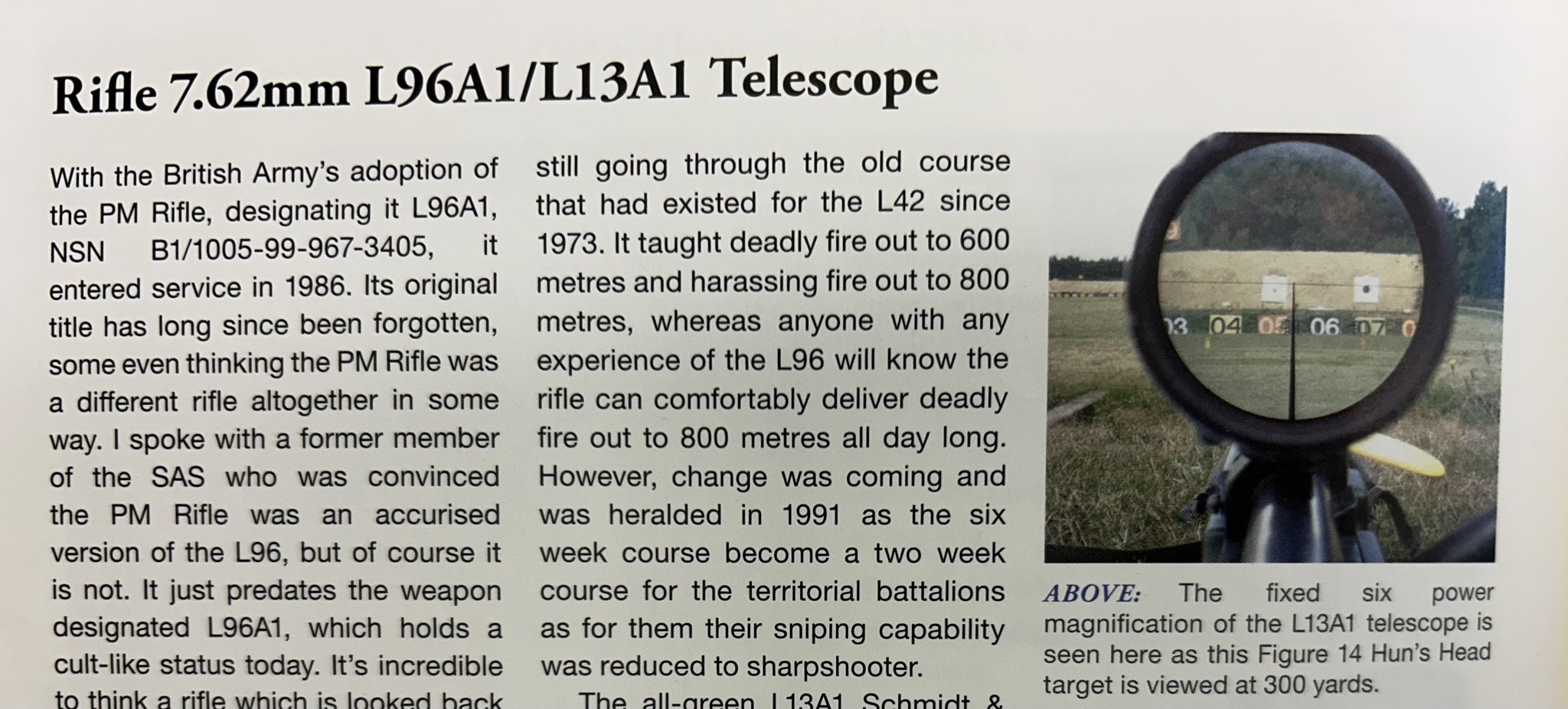

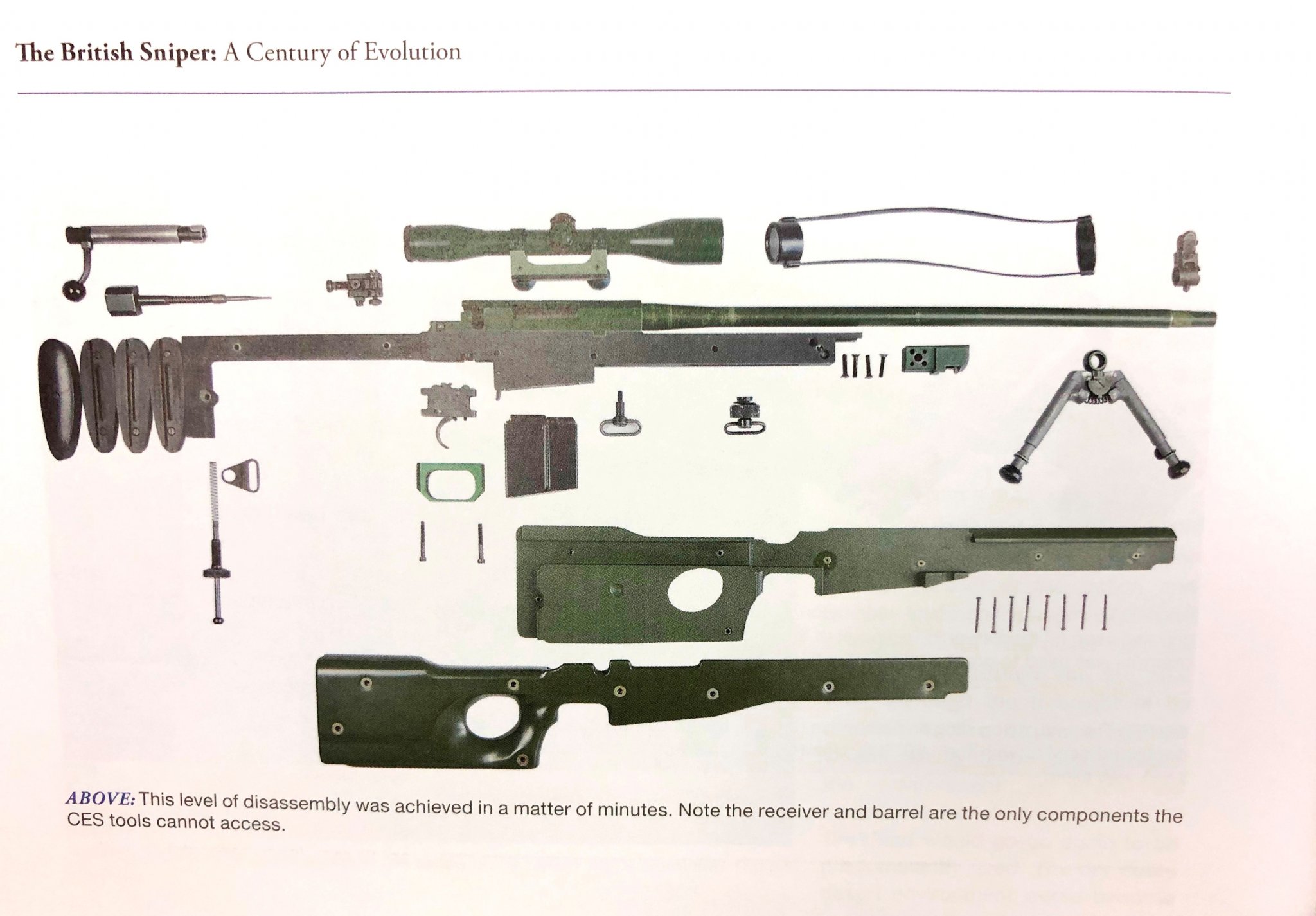

Attached are 4 pics from Houghtons' excellent book. Pic #2 shows the 4 small tools included with the rifle that allow a sniper in the field to easily and relatively quickly dissemble all of its components except the barrel from the receiver. (ie, if the trigger developed an issue, it could be removed by the sniper in about a minute and swapped, etc) The M85 simply did not have that level of user serviceability - and thus logistically it lost the competition to the much more innovative AI chassis-based system. Last picture shows an interesting factoid re the AI PM/L96 system - if the side panels are damaged or otherwise destroyed in combat or a parachute drop, the rifle can still be operated and will be accurate, assuming the sniper can figure out the sub optimal grip/ergonomic issues. Again, the M85 was/is a much more traditional system and didn't have this level of serviceability/survivability.
The last attachment is an except from page 187 of Houghtons' book, which notes that British Special Forces (SBS and SAS) were unhappy with the old L42A1, and used their own funds to buy the new AI Precision Marksman (PM) rifle back in 1984/85. At that time it was not yet officially adopted as the L96 rifle, but given that the SAS apparently replaced all or most of their L42s with 32 of the new AI PM rifles in 1985, all suggests that they really did prefer that new chassis-based system.
Bottomline: I like the historical M85 and wished I owned one too, however, the historical record is pretty clear about why the British adopted the AI rifle over the P-H M85: Superior logistical support and field serviceability by the sniper, and thus the L96 did not require shipping the complete rifle back to a specialist armorer for repairs (which was considered a logical problem with the old L42A1 at the time, and as Broughton notes, that constraint would have continued with the M85, had it been adopted). Today, its hard to underestimate how truly innovative the AI chassis system was when it formerly evaluated 35 years ago...my 2cts.

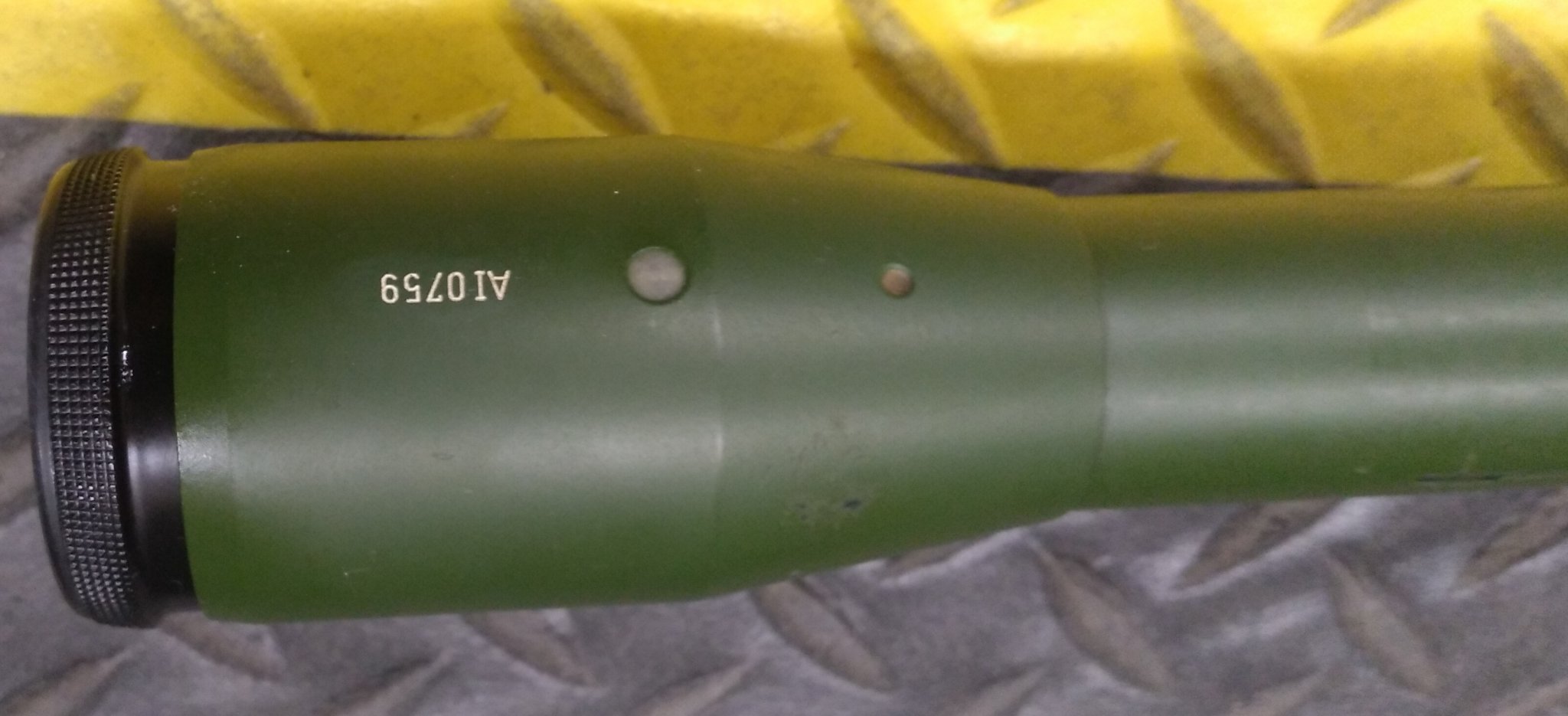

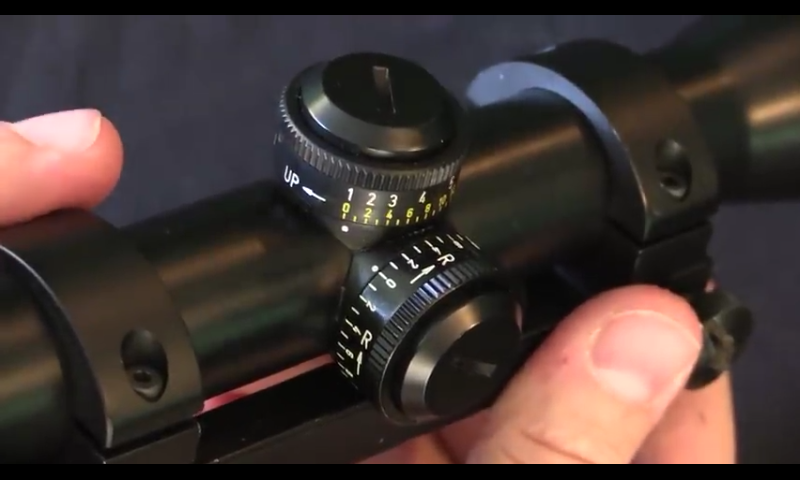

The M85s were apparently often sold without optics, with the end customer supplying them. Some of the ZF84 and ZF95 Kalhes scopes I have seen used the 104 reticle shown below.
…one day I hope to use my spare ZF95 on either an SSG-69, or preferably an Parker-Hale-ish M85. It has a Mil-Dot reticle, which seems a little unusual for these scopes. (Note the typo “MILL” DOT).

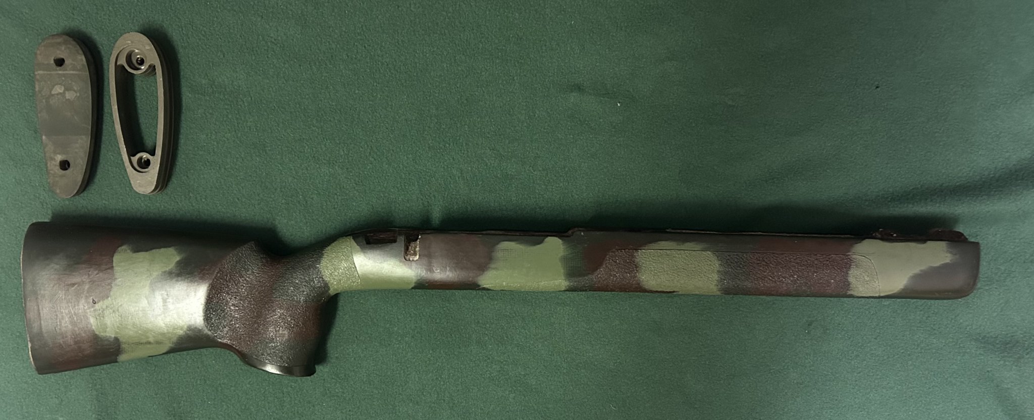

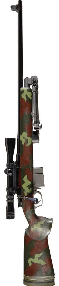

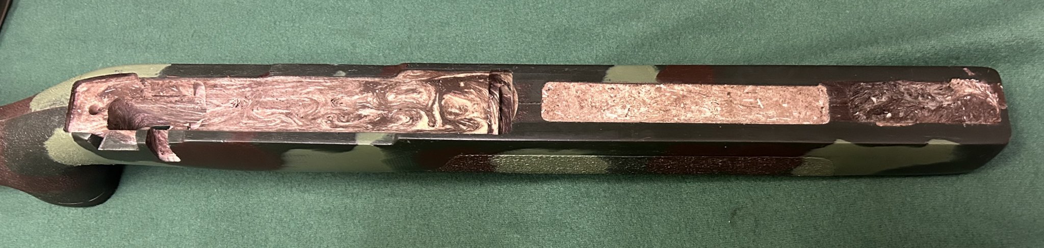

I found a neat original M85 stock, but unfortunately it was never milled for the action and its going to be hard to find someone who can properly mill it….
….yep, I’m in way over my head w/ this project.

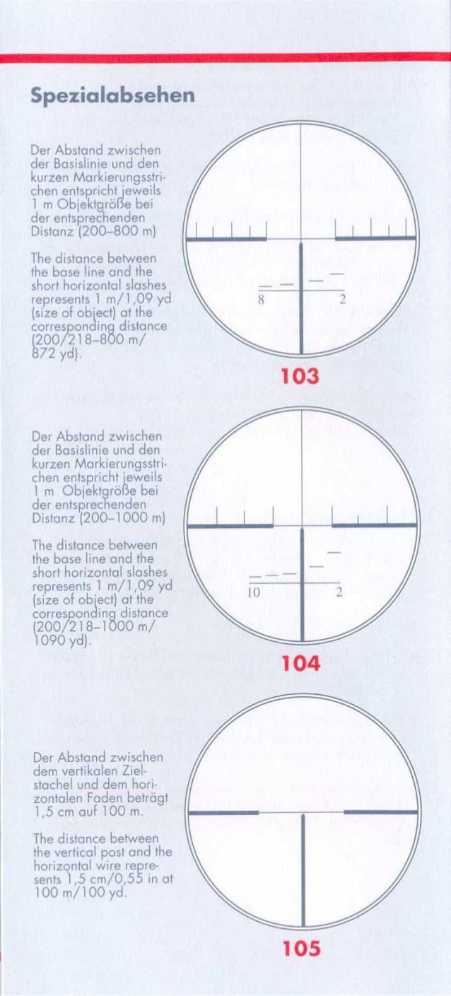

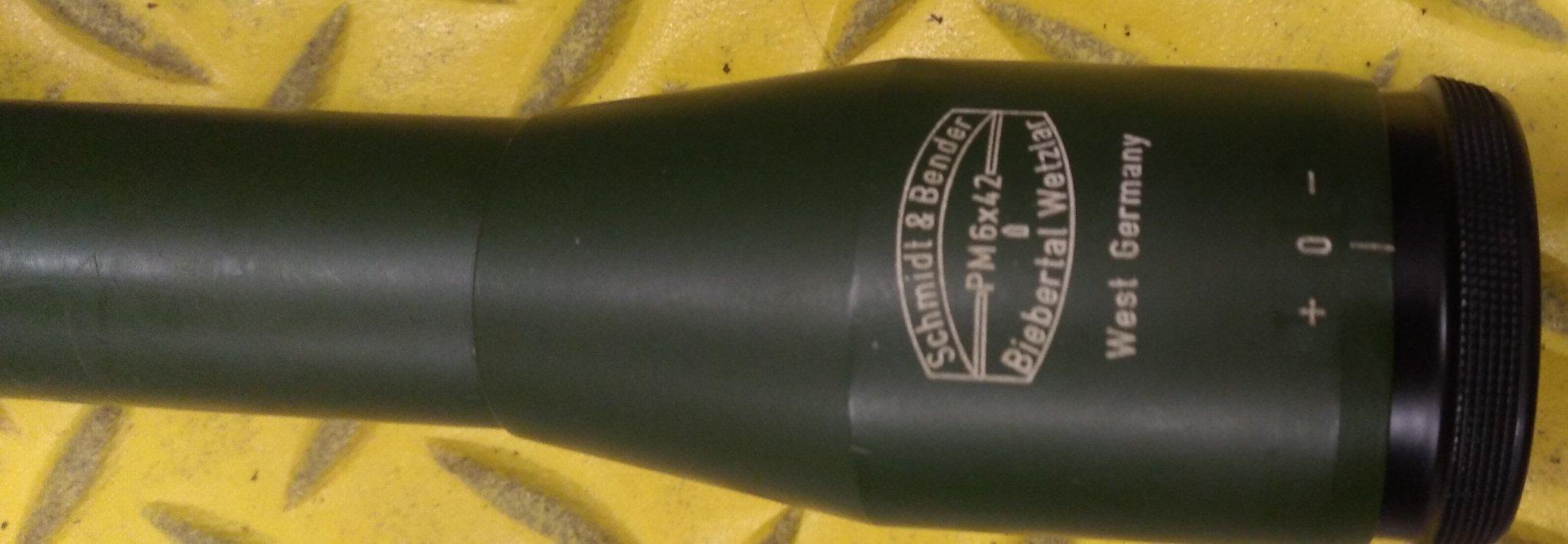

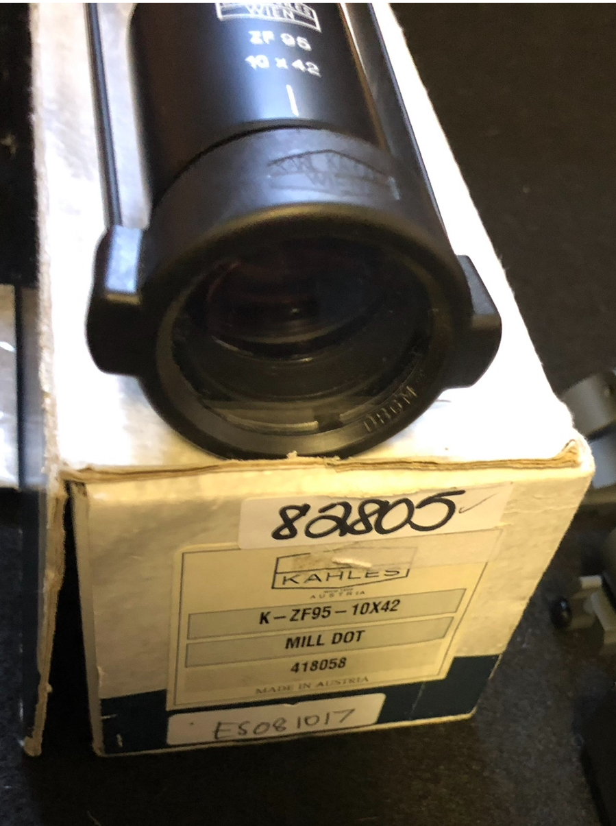

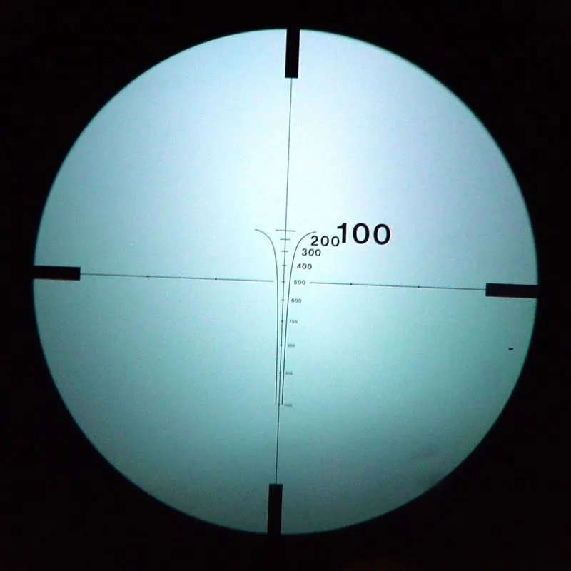

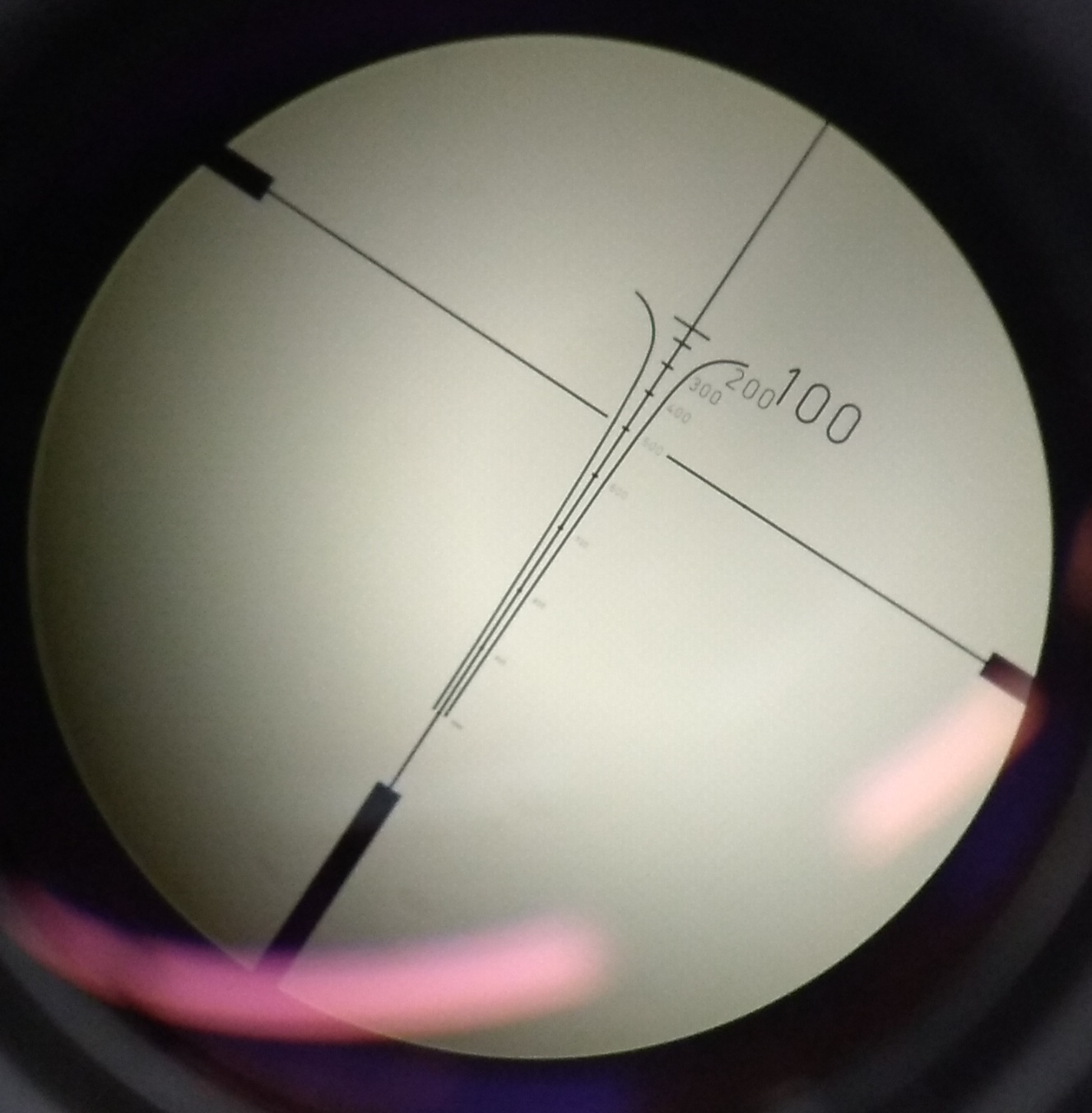

I should note that the 6x S&B L13A1 scope seen on that M85 in your post likely has the below reticle (thin horizontal line with thick post on the bottom). Again, this is what the British used, but M85s purchased by Brazil, Malaysia or Germany might have used different scopes & reticles.
Here's what I found regarding the reticle.
According to Kahles:
"The reticle is the reticle 111 which was made solely for the US Army and for snipers. Zero in at 500 yards, one click equals ¼ MOA (minute of angle).
The distance between the stadia lines are 19 inches at that particular distance which correspond more or less the width of a man’s shoulders.
The horizontal tic marks on the center crosswires are equivalent to 6 inches wide at that particular distance.
• The BDC is made for .308 168gr 10,9g”
Apparently, this reticle is considered a rare offering. I have no idea which reticle would have been issued with the M85. I presume it was whatever suited the individual or unit.

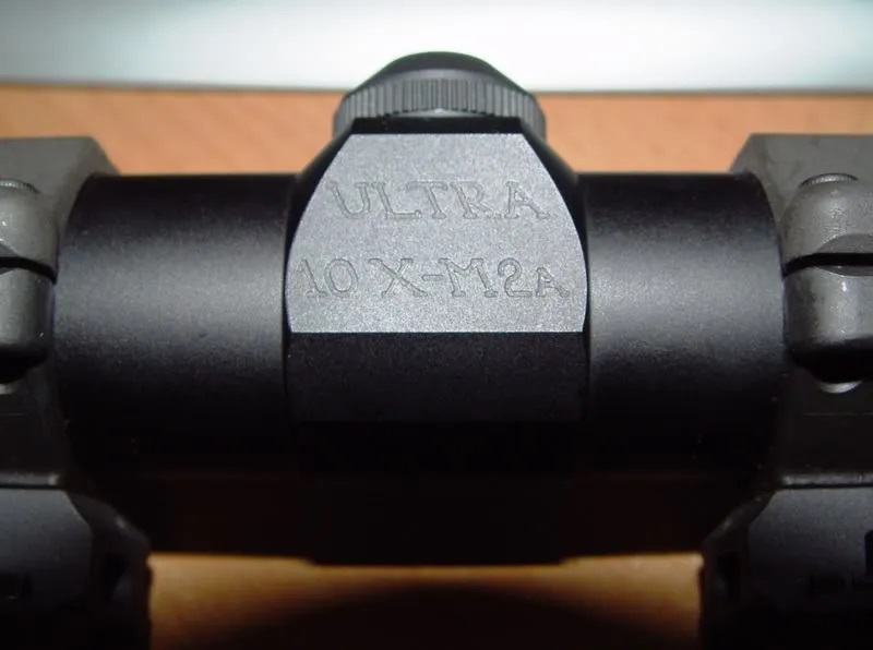

Back in the mid-1980s Leupold learned that the US Army was looking for a replacement sniper rifle (to replace the old M21 and it's antiquated ART II scope). This lead them to develop three new tactical scopes with the then brand-new 30mm tube diameter. The M1 Ultra, M2 Ultra, and M3 Ultra. They gave these gratis scopes to the US military in the mid-1980s and asked the military to test and provide feedback on how to improve their new tactical scopes. The odd-ball M2 Ultra had the funny range-finding reticle, and here's some more info regarding that mid-1980s reticle.
"No doubt they are rarely seen; I posted on one f/s here a year or two ago. Copyright 1986 Leupold Law Enforcement products literature indicate "friction type" 70 min wind/ 70 min elev, 3/4 min adjustment resolution. The reticle ( 41261 ) was developed for use with the 7.62 Nato National match ammo; the M2 is factory focused ( parallax ) at 500 meters. I hope this helps----joe
Big Army tested a bunch these gratis Leupold scopes that came in 6x, 10x, 16x and even a few 20x scopes, and by about 1987 they settled on the 10x M3 Ultra - but they requested 1/2 MOA windage clicks instead of 1" windage clicks. This resulted in the M3A Ultra, with the Mil-Dot reticle, chosen to go with the new Remington M24 rifle. The M2 Ultra with its odd-ball "V" shaped range estimation reticle was relegated to the dust bin of history by about 1987, with the Mil-Dot becoming standard for most military and LE customers.
I had no idea that Kahles made a scope in that era for with that odd-ball reticle, but perhaps they were competing with Leupold on the M24 optic contract competition? I suspect that Kahles scope on the M85 is exceptionally rare - thanks for the pics.
I have owned several M85's since the late 80's. They were freely available in the UK from PARKER HALE. PH would sell them to firearms dealers for £750 at the time (The £ was $1.70 at the time)
I bought a cased version, with an S&B 12x42 PM1 scope for £1250 in 1990.
They came with whatever scope you wanted. PH would put a scope on if required, or the dealer did. There was no standard scope.
I bought one about 6 years ago, it cost £5500.00 GBP, cased with a 6x42 S&B PM1 scope in black.
Now they are selling for anything from £10k to £16k in the UK, cased and scoped. In fact, prices have rocketed.
I don't think they are now unreasonable, I just think they took their time to catch up to where they should be. They were a future classic waiting to happen, and now it has happened.

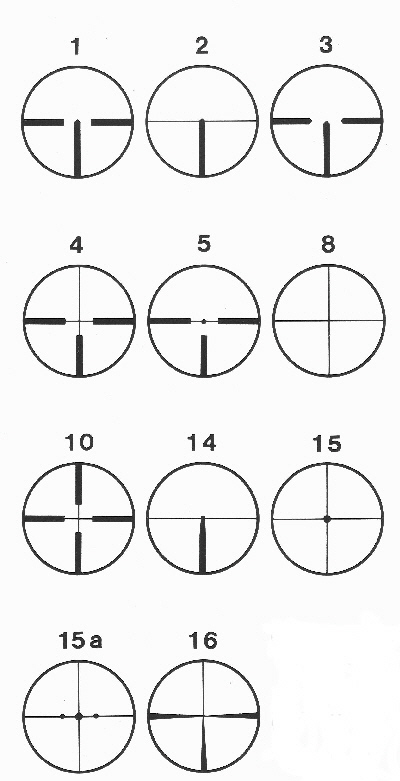

Truly informative, TorF.
That is remembering me the Pecar-Reticle No. 15 a, a bit.. . But that would have far to few dots, ultimately.
Which number or name had this reticle ? A pic, please :) ?
