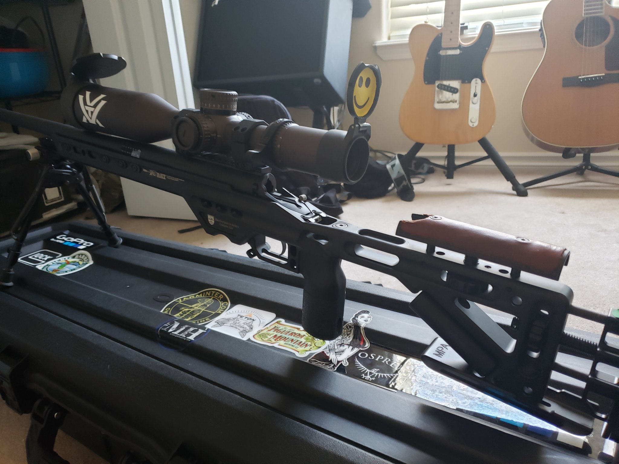

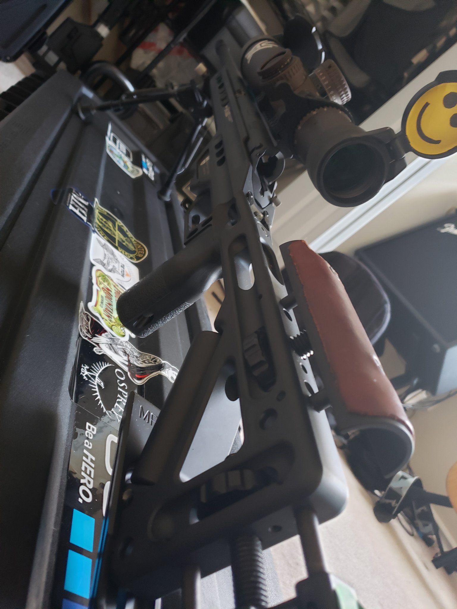

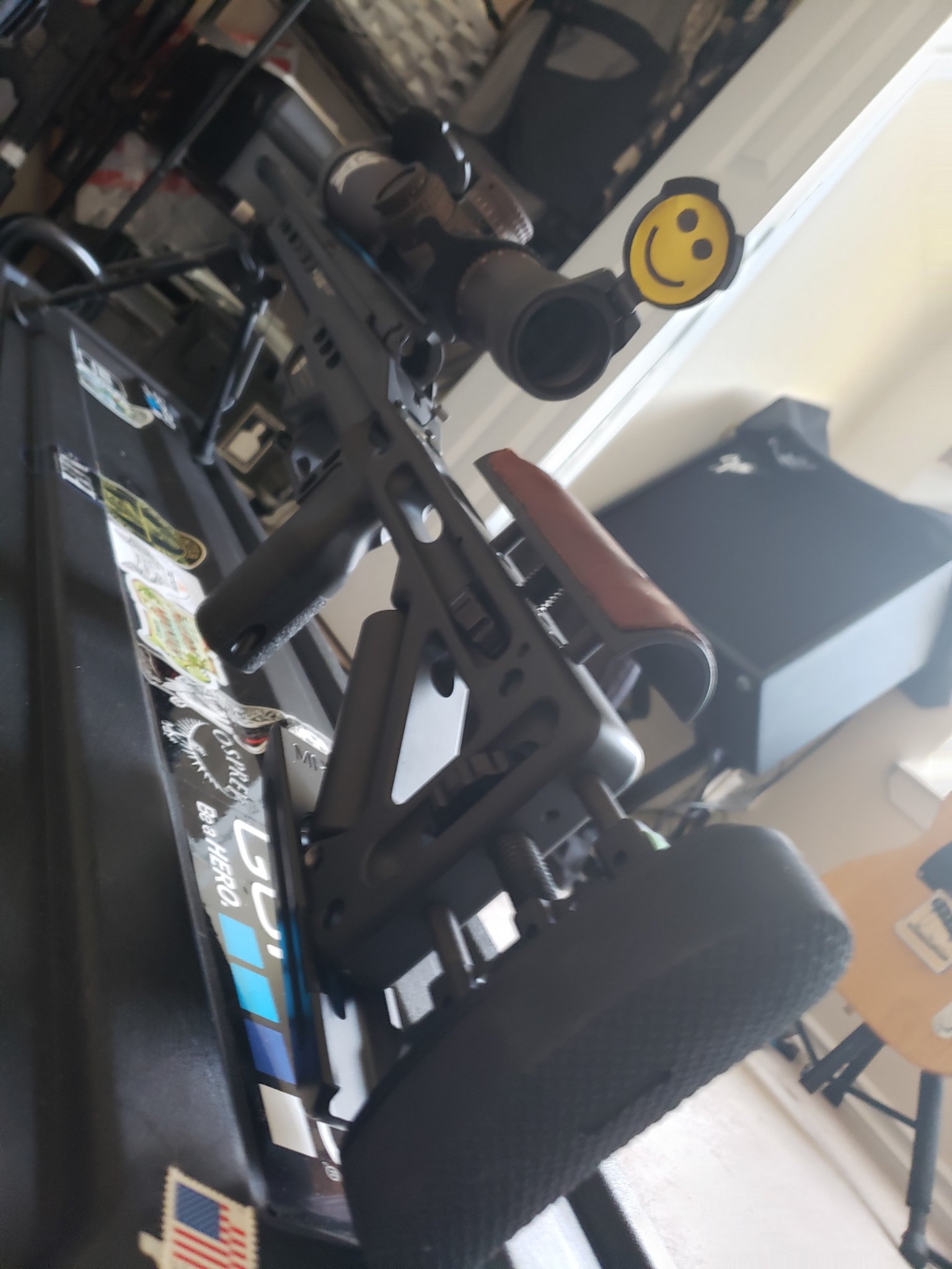

Pretty common occurrence of anyone that has an MPA chassis is the foam covering on the cheek rest comes off. I'm currently not able to shoot as much as I'd like being stuck on nights for the unforseen future. (120 days and counting) so I decided to take up leather making as a hobby... I think I'm going to make some MPA leather cheek pads for my chassis but it's alot harder then I'd thought . There's the first trial I did. Fortunately ingot unlimited resources to deer/ elk/ cow/ antelope hides. Pretty experienced with tanning but not so much using it for anything but rugs and throws. Tanned / dyed some cow hide and come out with this .. I will update will some veg tan that I stamped as soon as it's done sun drying . Here's the cow that I dyed. Pretty shitty / basic.

I took off the remaining of the torn foam pad then used a piece of paper to lay over the riser and ran a sharpie around the edges to get the pattern.
I then layed it on the leather and basically transferred it over/ cut it out.
I definitely shortcutted when applying it to the riser. I should have smoothed out the edges on the leather first. That and the fact I just used super glue to glue it down.
I'm ordering the adjustable riser from MPA ( forgot what they call it, but it adjustes side to side as well) pretty soon so I wasn't too worried about messing this one up. I think I'm going to rip this one off and try to do something with some strong velcro or something that I can swap out different materials/ designs.
