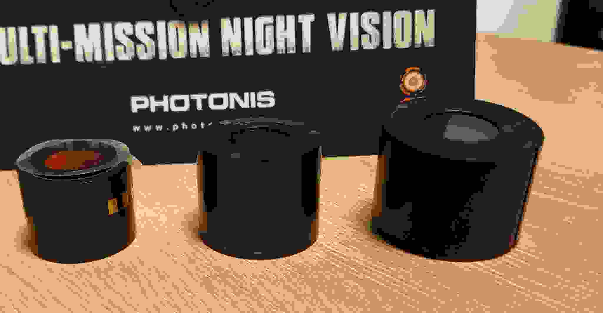

Here is a photo of Photonis 18mm, Hybrid 18mm and a 16mm so you can see a size comparison. All have the same performance specifications for the same type (4G). The 16mm and Hybrid 18mm are not available in commercial specifications only military type specification. Only the standard 18mm comes in milspec (4G) all the way to lower level commercial specifications (ECHO, XD-4, SR5).
That is considerably smaller. My first thought is why did they produce the Hybrid 18mm that requires a specialized housing when they already had the 16mm?
Reactions: ljstack
Yes, I'm the CEO of Photonis Defense. If any of you have questions about tubes and what makes them tick or why they're made the way they are and what determines the impacts to what, in terms of performance, please let me know. I will get anyone here the straight technical information from the wealth of experts I have to pull from. I can also explain inside information on why we finally decided to make our own systems. These systems are like cars, trucks and weapons. Everyone has their own preferences, so we're not in the business of saying ours are "better" all we can do is tell you what they do and why, and only the professionals here determine what works for them. You can also email me directly at [email protected] and I'd be more than happy to talk to any of you.
This is a great question and it touches upon many aspects. First, think about the 16mm market and all of the NODS that have them. Pretty much a mental blank right? The entire US market revolves around 18mm tubes and one of the reasons is that 16mm tubes are hard to make. The yields were historically low and for every tube you make you have to throw 8 or 9 away, however Photonis perfected the manufacture of 16mm tubes, which is great, except that there was no market for 16mm tubes in the US. Meaning, what housing could they go into? When you get your hands on one you'll be amazed at how small they are and what a difference it makes in housing design. Form follows function, so while the military has been pushing lighter and smaller, you could only go so far with a housing using an 18mm tube. So, the reason why we made a hybrid 18 is to rethink the way the tubes were made and since everyone understands 18mm tubes the transition from a full size 18mm to a slimmer one was an easier mental leap than an 18mm to a 16mm in a quad. In other words, we can make the PD-PRO-Q even smaller with 16mm tubes and if we had done that (back when we first started) it may have been a technical marvel, but perhaps a marketing disaster.

So this is a question I should have directed at Glynn from NVI, but if all 16mm tubes are 4G grade does that mean all the 16mm RNVGs have 4G tubes?
Is there any difference between 16mm and 18mm performance? Do you gain recoil resistance from having slightly less glass? Do you lose any gain?
I’m very interested in 16mm.

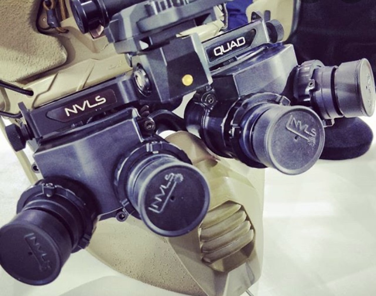

@ljstack. Are these products just a re-branding of NVLS’ products aimed at the US market? NVLS Minimus looks identical to PD-PRO-16B, and NVLS Maximus to PD-PRO-Q.
The NVLS QuadEye has also been tested in different versions, as seen in the pictures below. One of these claimed to be sub 730g, while what looks to be the newest version claims sub 800g. Was the first version not solid enough, so you had to toughen it up some?
Reactions: ljstack
On the NVLS products the answer is yes and no. NVLS has been a Photonis partner for over 20 years. They only use Photonis tubes and we have worked side by side with their engineers and our optics suppliers to build systems that are specifically designed, constructed and coated for Photonis IITs. So when we decided to enter the US market with our own line of systems, they were the first ones we thought about as opposed to machining the housings ourselves. So yes, from that standpoint. However, the US market is different and feedback from military and commercial users were different and they supplied quite a number of recommendations for design changes. So modifications were made at the systems level (meaning modifications to various parts) so that it better meets the needs of the US market. So in that respect it's a no, meaning its not just a straight re-branding, we implemented certain design changes. Part of the "problem" we saw in night vision reporting is that we never knew what type of housing and optics our tubes were being placed into. With NODS, the whole is greater than the sum of its parts. Maybe a good analogy would be building a rifle from a compilation of parts from different manufacturers. Sometimes you can do that and get a really tight rifle where every part seems to work in synergy with each other. Other Times you can do that and you end up with a rifle that can't group shots within a pie plate at 200 yards. Its the same with NODS, every part matters and the whole is greater than the sum of its parts.
