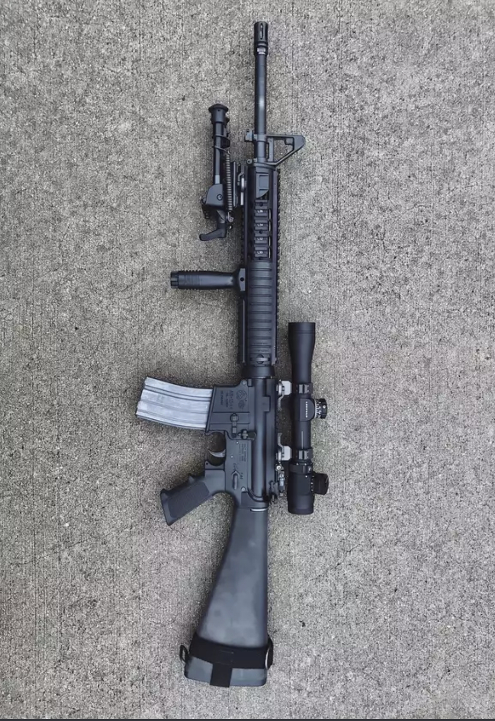

The SAM-R is what you’re looking for, I think. The rifle in the photo is not mine.

Yes a 12.5" will make "hits" out at 500yds. However if you want effective terminal ballistics at 500yds that 20" is where it's at.
If you are running a scope there is no need for a FSB, just use a set of buis. It's not like you can co-witness irons through a scope.
I know, just a whore for the look. Watched Black Hawk Down a few too many times.
Yeah my 77SMK is running at 2445 FPS. Pretty low. Need to compare it to some hard data for 16 and 20 in barrels. Thinking it’d be 26/2650-27/2750 respectably.
@Desert_Racer Yep, thats what I’m looking for, off to look up some SAM-R pics.
