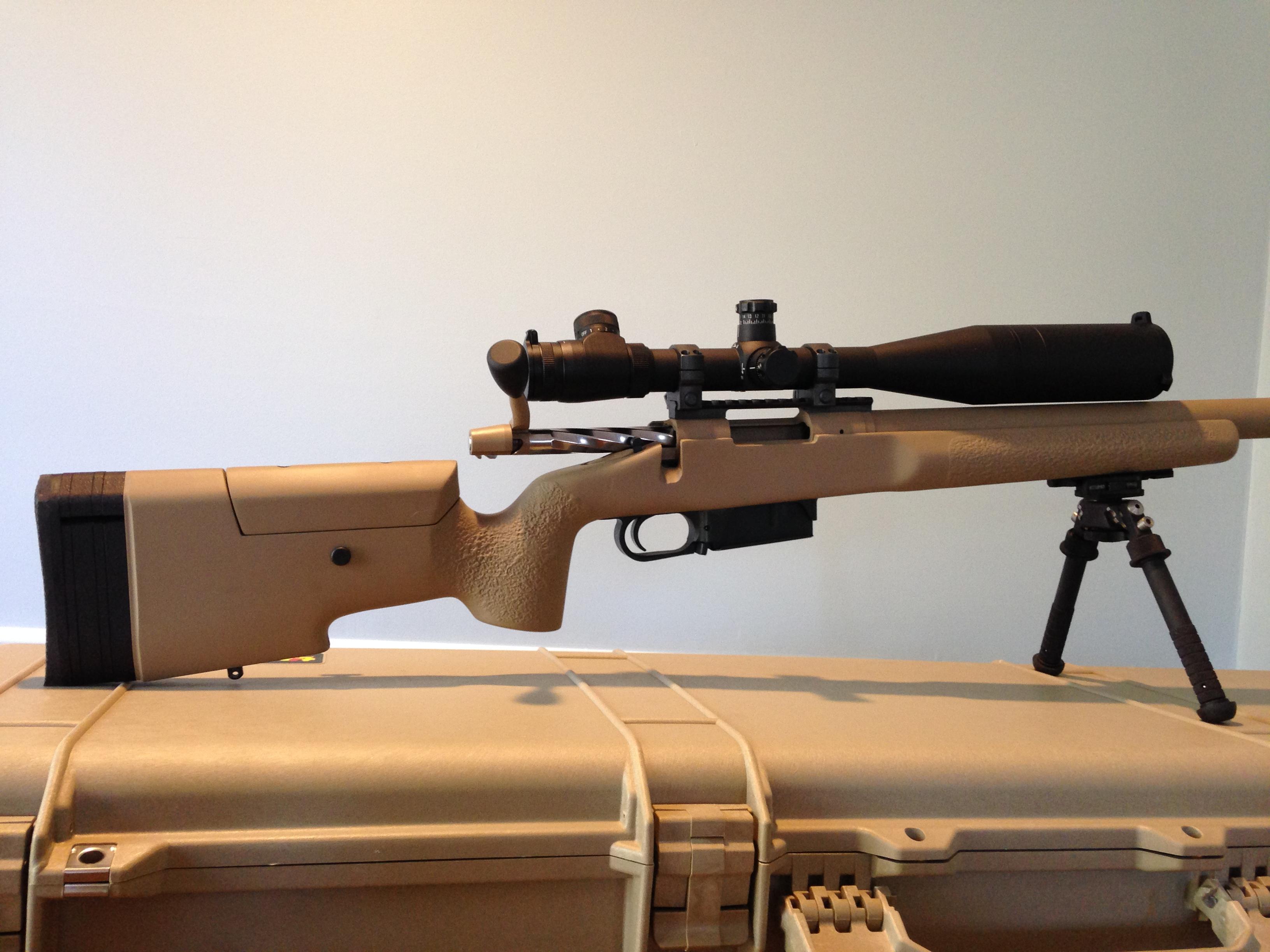

Maybe this will help ya out some. This is my rifle I built. It's a Remmy 700 in 308 with a Krieger 1.250" "no taper" barrel. The scope base is a Leupold 20 MOA, Leupold Mark IV Medium Rings, and a Leupold Mark IV 8.5-25x50mm. Either I got lucky, or I had one of those great days where all my math came out perfect, but it fits and it sits as low as it can get without touching. Although, when I measure the boreline and centerline of the scope, it measures out around 1.850".054 (2).jpg
Maybe this will help ya out some. This is my rifle I built. It's a Remmy 700 in 308 with a Krieger 1.250" "no taper" barrel. The scope base is a Leupold 20 MOA, Leupold Mark IV Medium Rings, and a Leupold Mark IV 8.5-25x50mm. Either I got lucky, or I had one of those great days where all my math came out perfect, but it fits and it sits as low as it can get without touching. Although, when I measure the boreline and centerline of the scope, it measures out around 1.850".View attachment 41749
That's some barrel you got there.
What's the weight on that rig?
