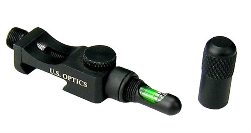

Europtic has 2 versions of this one - pictured is the swivel version - Derek at Europtic recommended it to me - he runs Badger low rings with a 30mm tube and it fits under his scope (unknown model) - I run a NF 20moa rail and NF 30mm low rings and it works under my scope too (3-12x44 LRTSI) ... I'm sure there are others but it's a start for ya ... best Michael

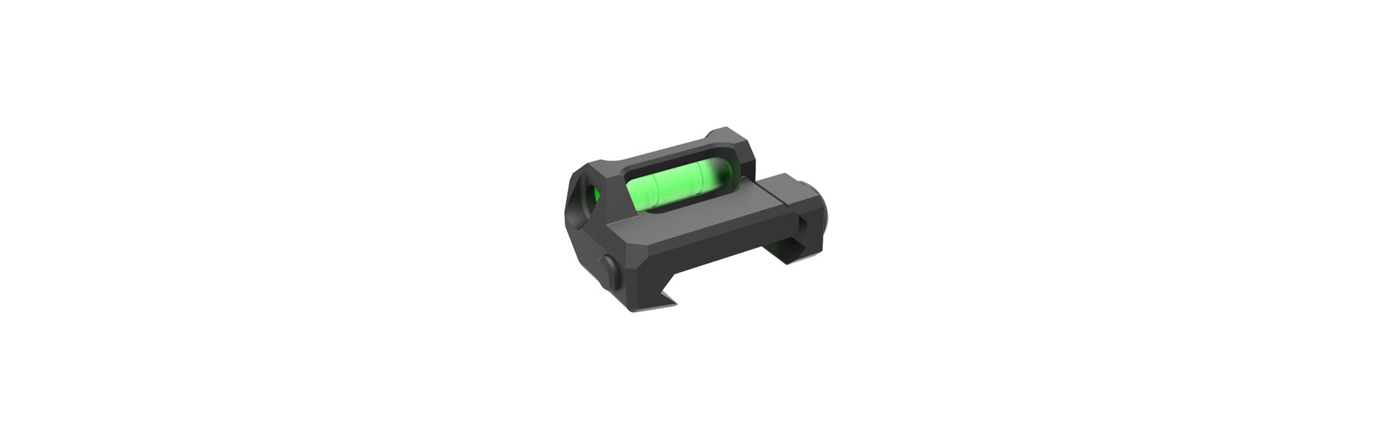

I think you'll like my levels quite a lot. My rail mounted levels are beefy and have a protected vial that is significantly more sensitive than others their size. Visible, but not needlessly large.

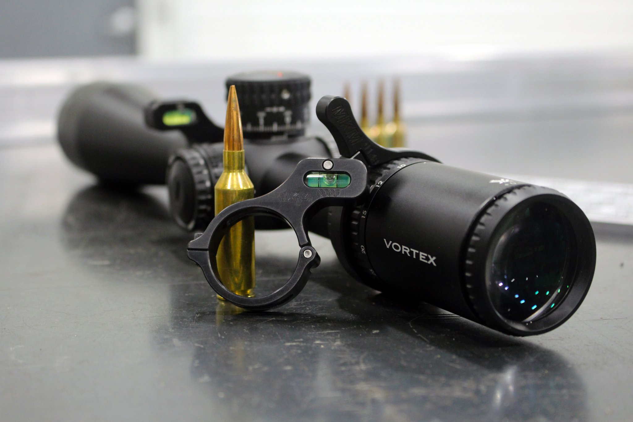

As others have said, scope levels are probably your best bet. My ULP version is similar to an Accuracy First at a much lower price, and dead simple setup. No huge honking level to stick out and snag stuff or be broken, yet plenty sensitive.
