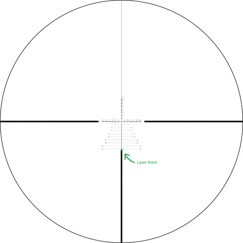

Hi, I have a Savage Axis 2 Precision chambered in 6.5 Creedmoor with a 20 moa picatinny rail and I recently bought a Vortex Venom 5-25x56 in mils paired with a 34mm high rings from Leupold. I was trying to boresight the new scope using a laser boresight at about 35-40 yards but I found my elevation turret maxed out and the laser sitting at the 11 mils mark. Should I upgrade to a 40 moa picatinny rail or should I do something else ? Thank you.

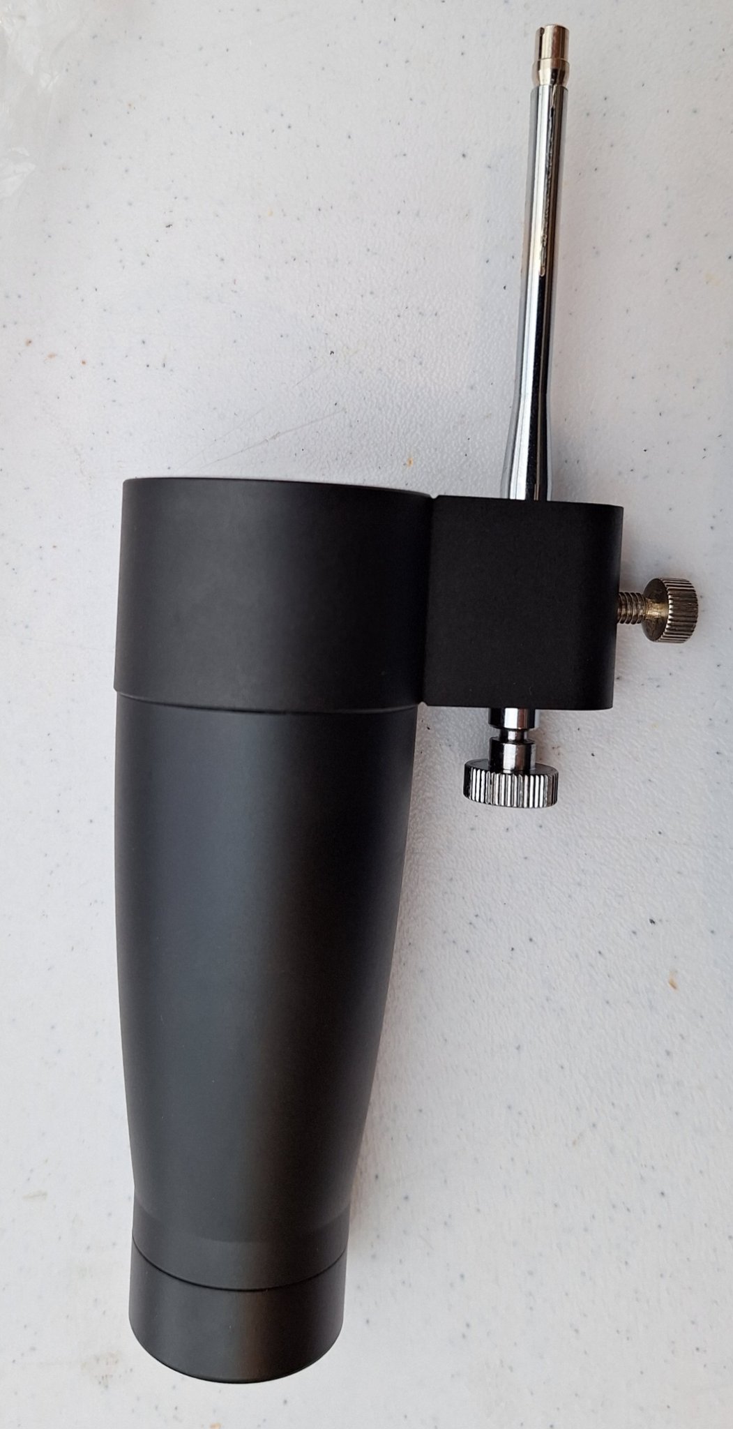

If you don't want to start with physically looking down the bore buy one of the grid in lense/bore spigot kits. I use one on every scope I setup and its the easiest way to do it, good on stuff like semi-auto/straight pull/pump where it's non trivial to look through the bore too.
You want a 20 or 30 MOA unimount to get the most from that scope too. The Athon ones seem to be best value here in Australia.
20MOA rail should put you about 1.3MIL under centre on elevation on most regular scope/rifke combinations unless something is wonky.
