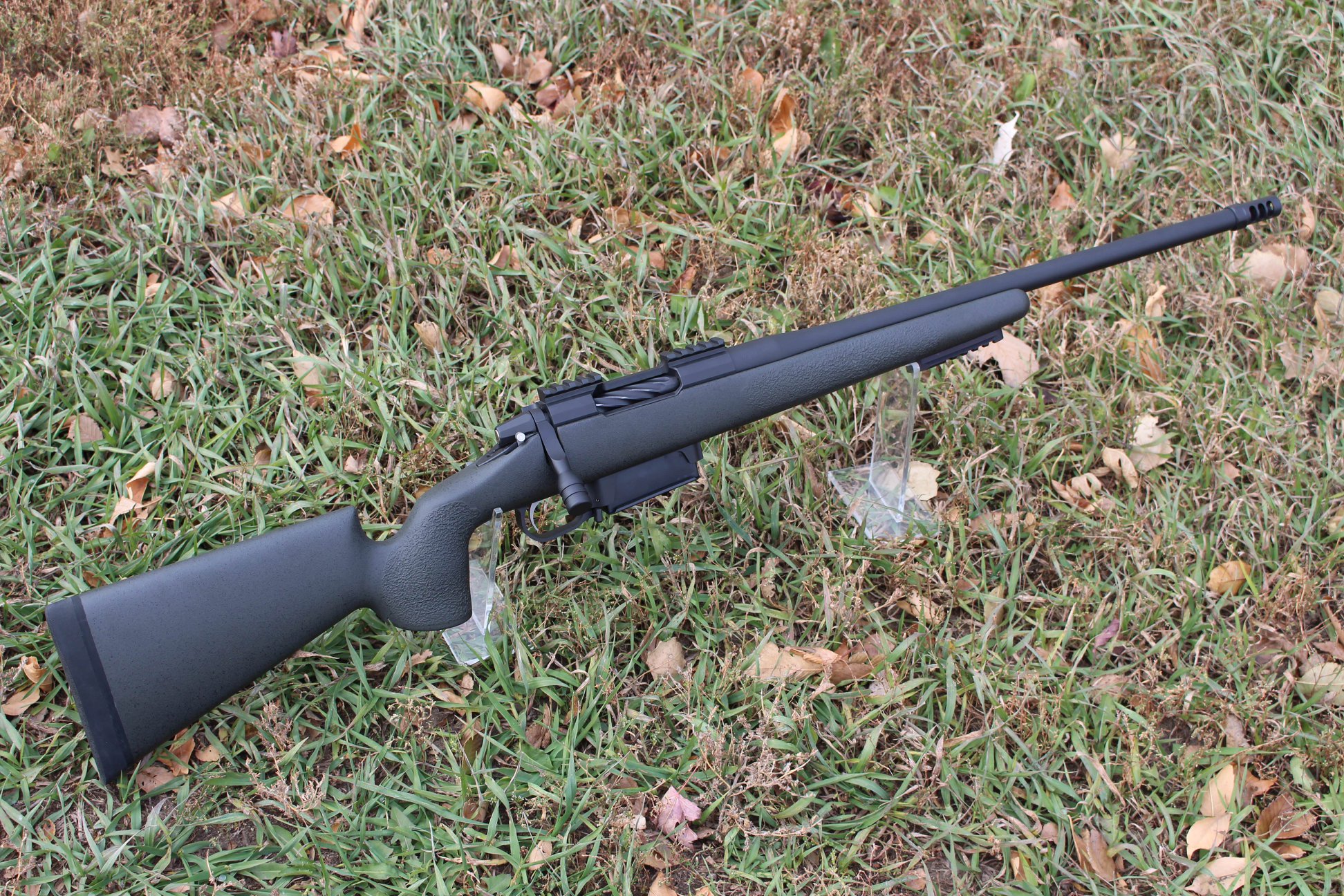

Give the McMillan "Remington " Hunter a look. In the "edge" tech, it comes in at 28 oz.
Stock is based off of the old sako hunting stocks. Looks like one of the traditional remington monte carlo stocks...but on the bench the grip fills like one of the vertical grip stocks. I have a several of the vertical grip stocks already mentioned- A-5, A3, Game Warden and Game Scout. They shine on a bench or prone, but for me anyway... they are little cumbersome if you need to move or control the weapon with one hand in the field when time is critical. This is where the the Remington Hunter shines. I have converted ALL of my hunting guns to this stock.
I feel like you get the best of both worlds. It's awesome on the bench, and prone AND maneuvers in the field like a hunting stock should.
BTW all of my best long range groups have come from guns with the aforementioned stock.

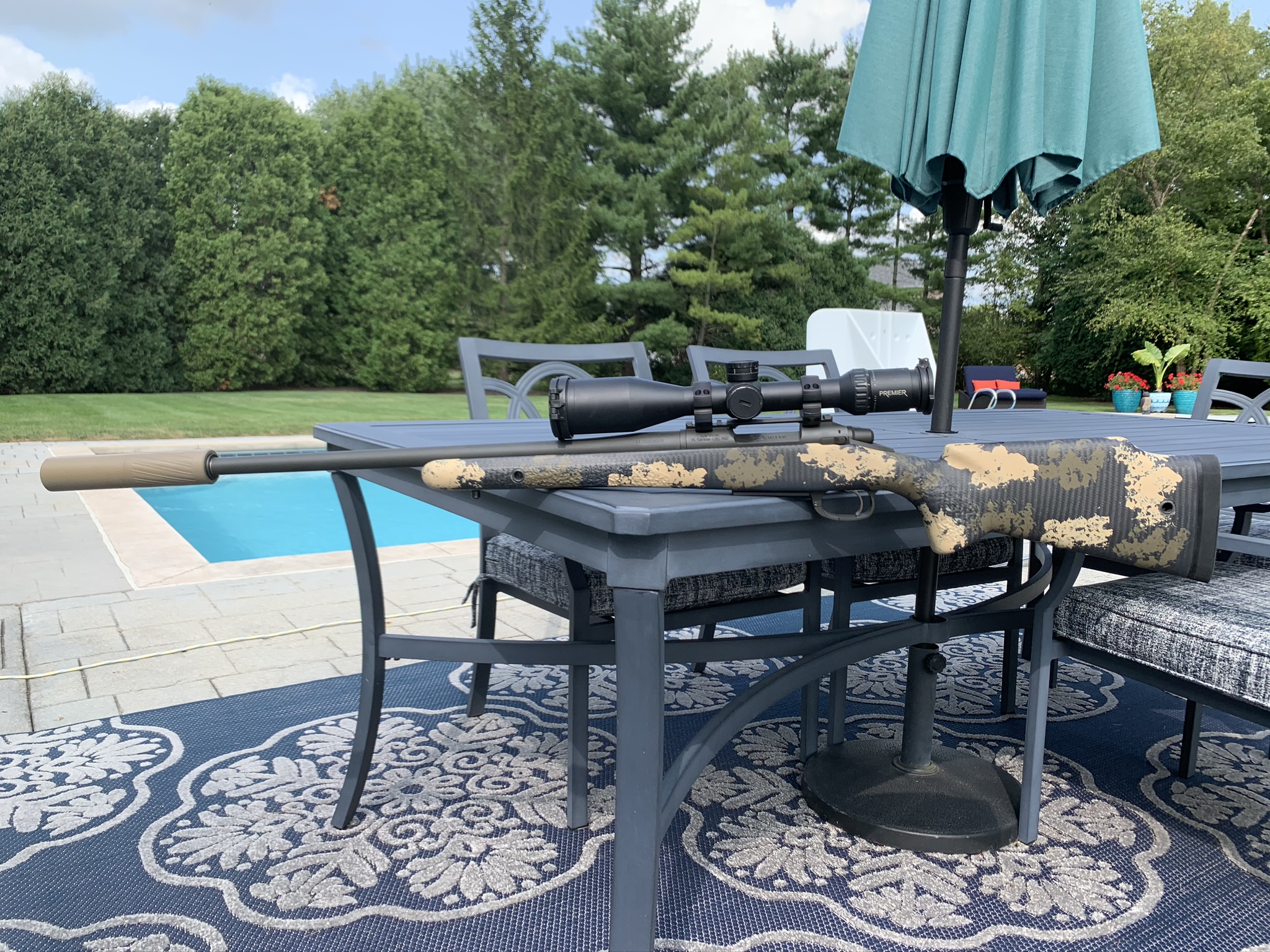

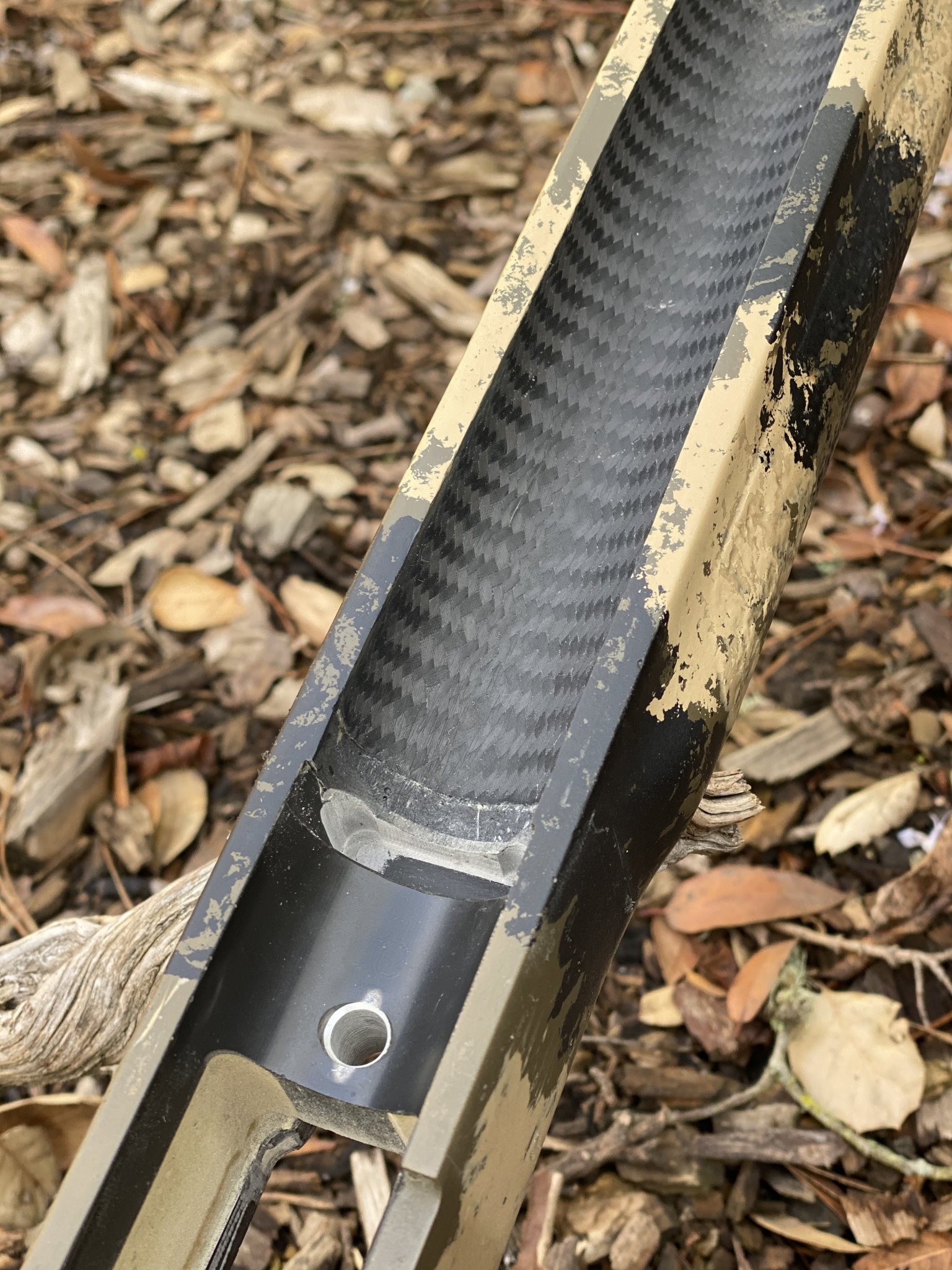

So my Grayboe Phoenix came in today, it was not a drop in fit for my bottom metal (Christensen Arms) so I had to do minor in letting which was a breeze. The action, to my surprise, was stress free but could have better contact so I did a skim bed on the action and bedded the bottom metal. My barrel is not even in the barrel channel, but it wasn’t in my prior stock either so I believe it is just the action that’s slightly off and not the stock. Regardless the stocks super generous barrel channel makes it a non issue, so I’m good.
My overall impression of the stock is very positive I didn’t have voids or uneven areas like others have said in the past. Mine seemed very well made. It’s super light and comfortable in the hand.

Interesting point re barrel channel. I started ordering stocks with 2 to 3 larger barrel channels than I planned on. I prefer the larger float and see zero downside to additional space.
Till you're going through the woods and a small branch or twig slides into the channel and gets stuck.
Have found the opposite to be true in my experiences. I have had things get “stuck” in my hunting stocks with slight gaps because it gets wedged. A large gap easily allows the item to be removed or swept out. Just my experience.

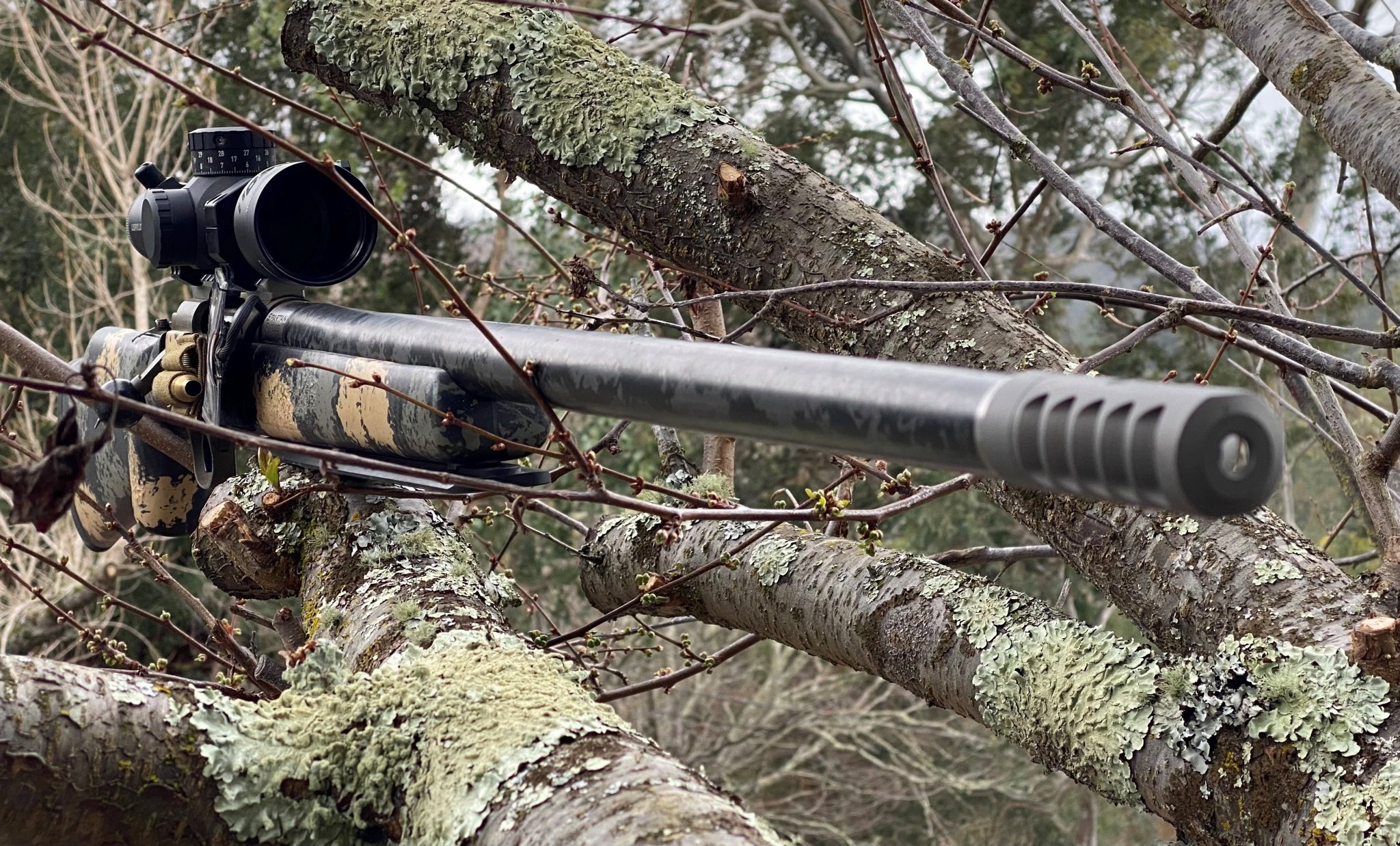

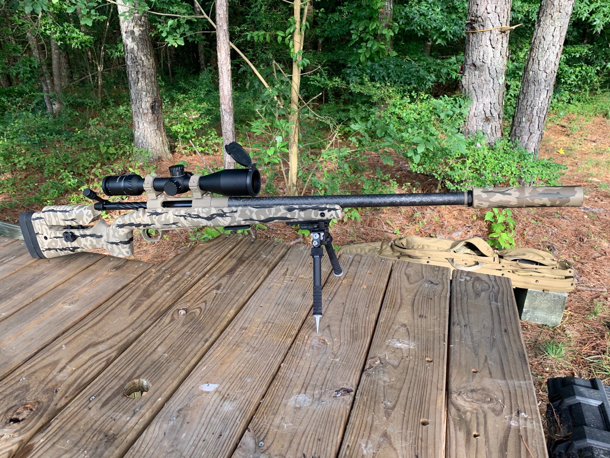

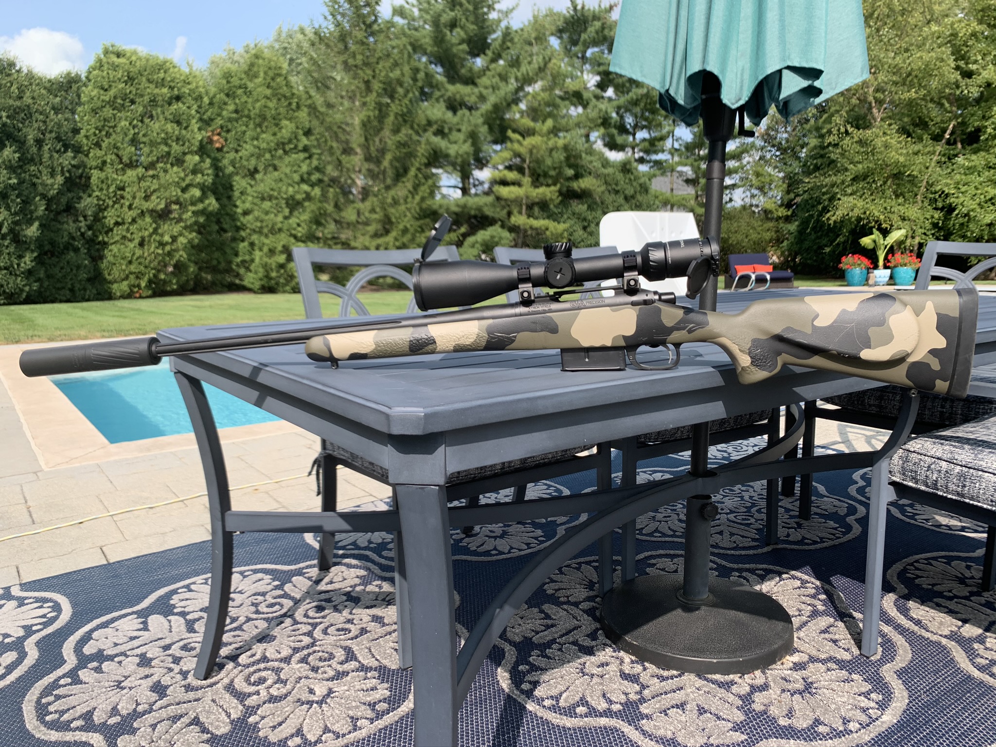

I running the same camo, almost the same stock, the Hunter T version.
I made some weight sacrifices (added weight):
Long Action Magnum, longer barrel 24", 5 port brake, 12" full Henderson 1.5" rail as makes tripod shooting faster or off bag more stable and worth the 3.5oz and of course a full-featured illuminated scope with locking turrets (kept the heavy magnification throw).
It still came in very lite; even pillars & bedded. I did just send the bolt to get a cosmetic skeletonizing treatment. This thing has a good track record on Elk. I second NOT having a big barrel channel opening, at least where we hunt, it's the tiny willow or hunker brush twigs maybe not more than 1/8' that will grab you and spin you in a circle before they even think about breaking.

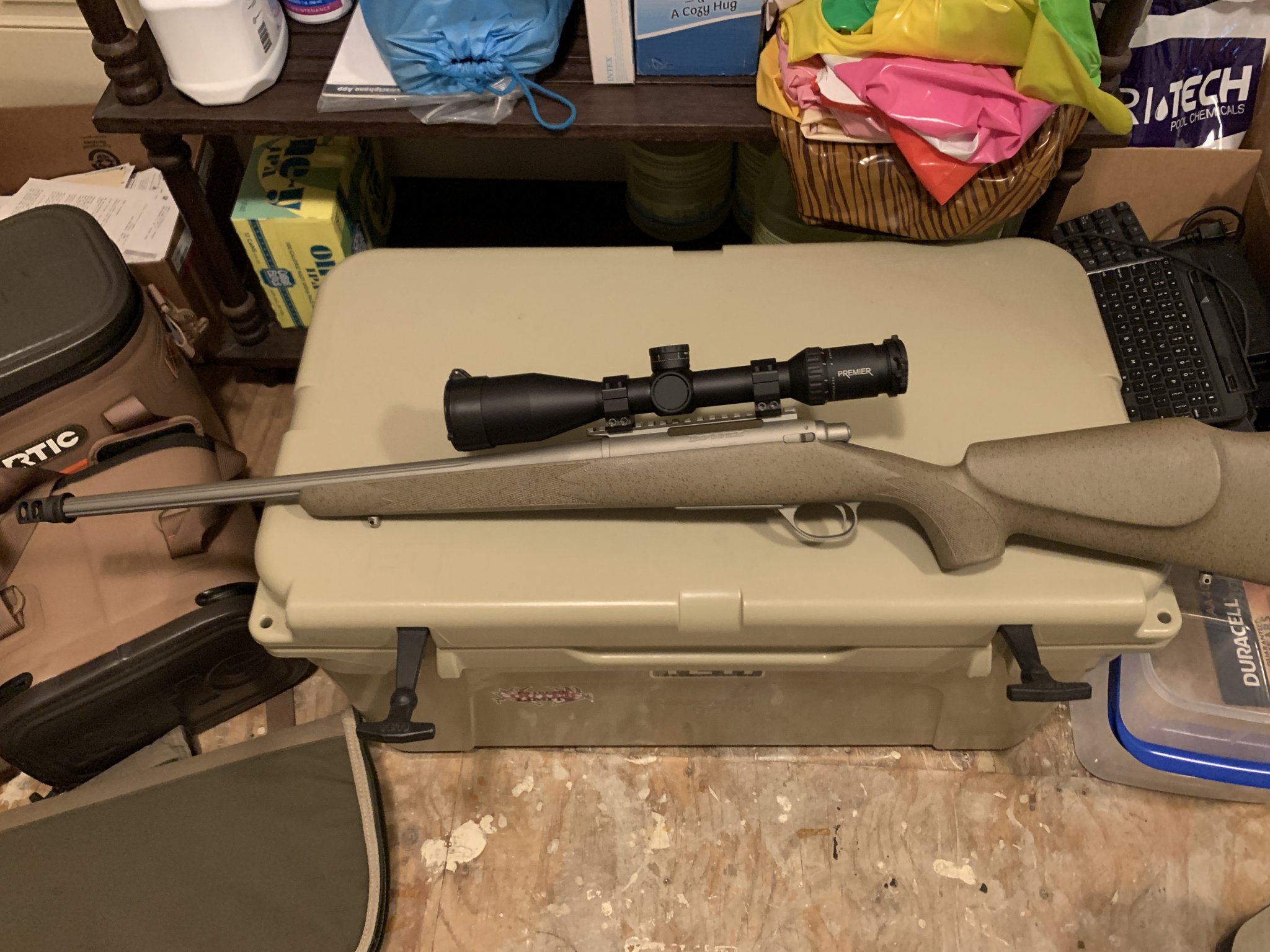

I switch two different actions into the stock and it’s not possible with a tightly bedded action
It is, if your actions are good and you bed either to the largest recoil lug you'll ever use; or just to the back of it.
I have had magnums side around in aluminum needing blocks. Something you can see as a bit of vertical, but also the bottom of the actions show the movement. LRI even has a 3D scanning and milling service to get aluminum bedding blocks to shoot better. That said, most of us don't need benchrest precision. However, if one is after the best and counting grams, bedding tends to be better.
Here is an example. This one shoots lights out, but has had Vudoos, Remington, Defiance etc, switched in and out. It was a spare I had. I will usually bed to the largest recoil lug rather than just to the back.
