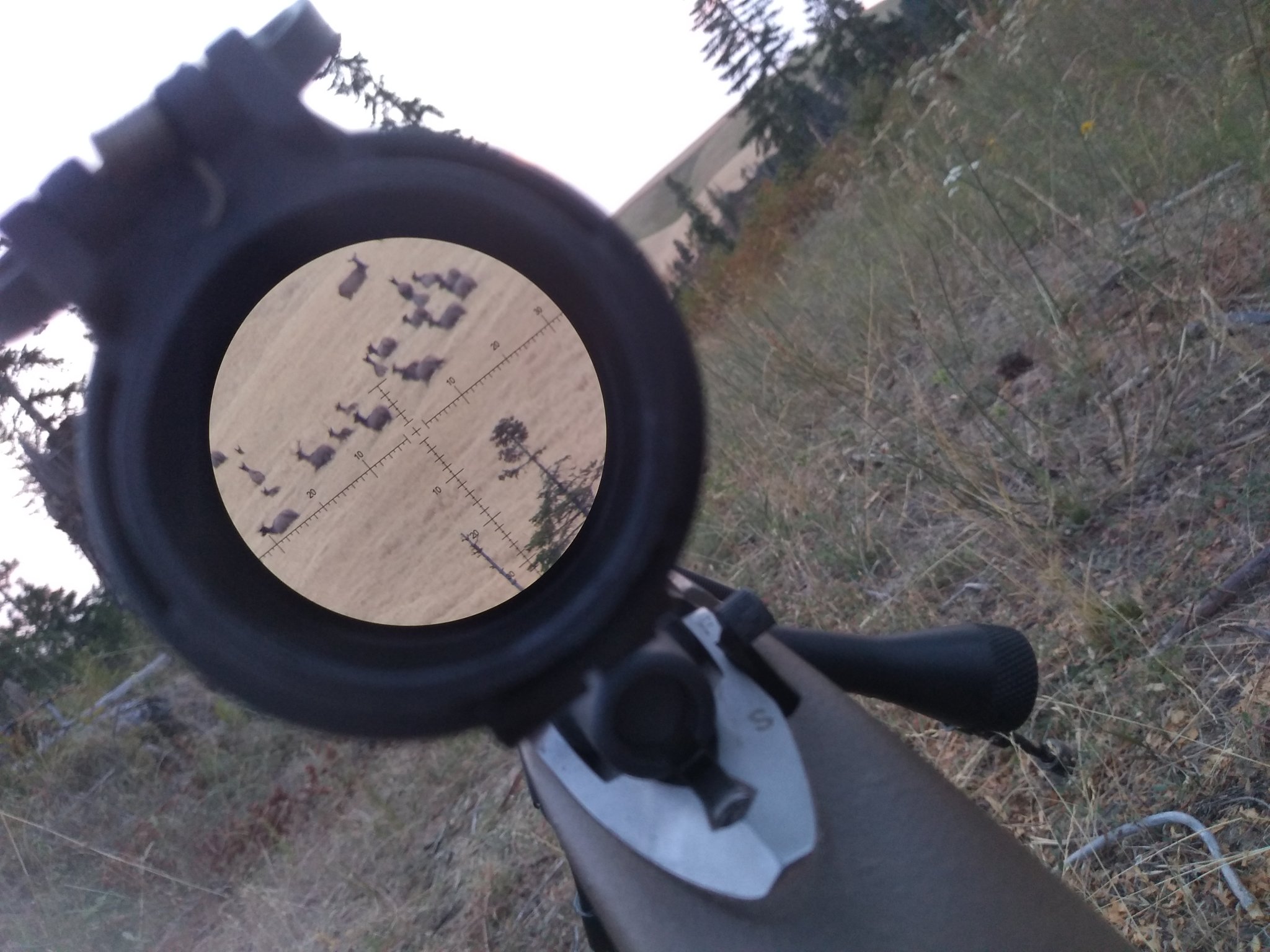

Here's a pic on 24x through the NX8 of a herd of elk at 900 hundred yards that I took 1/2 hour before dark this evening.
My shitty phone doesn't come close to doing the scope justice..

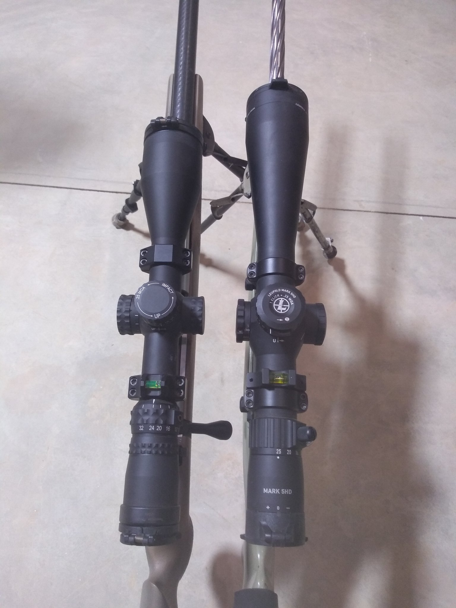

I did a low light comparison with the mk5 5-25 and my NX8 4-32 tonight and the NX8 was surprisingly much better.
The mk5 was at Max power, and the NX8 was just past 24x for this test.
The image clarity really suffered with the mk5 when it got dim while the NX8 was still crisp, I was able to clearly make out targets at 600 yards until almost dark and the reticle was much easier to see than the pr1-moa.
The NX8 is the better scope in my experience, it's really impressing me with it's image quality and compact size
Here they are side by side
That's really impressive considering the NF's 50 mm objective vs. LP's 56.

Yeah I was pretty surprised that the NX8 was better in low light, it really wasn't even close in my opinion one was still usable and one was not.
The glass is all around better than the mk5 to my eyes
