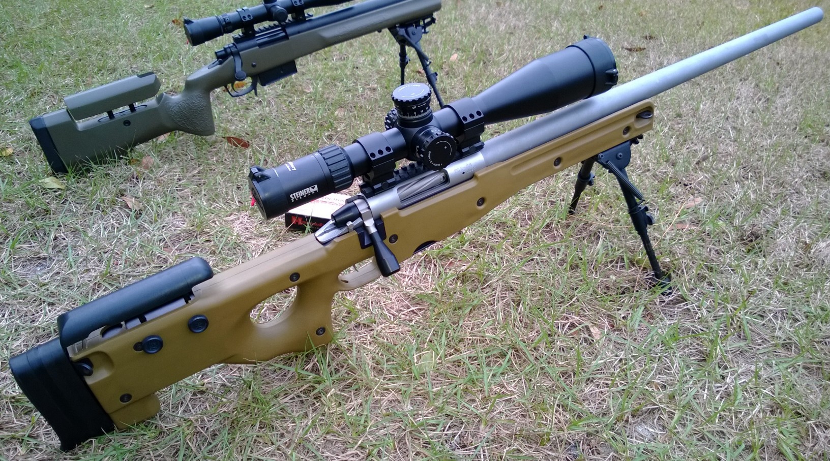

Wyfox, you've got it going on... Good looking Goat and rifle. I never shoot game with my .300 Lapua, killed a mess of Whitetail with my .300 RUM with 180 NBT's. Exit wound was big enough to put your fist in.

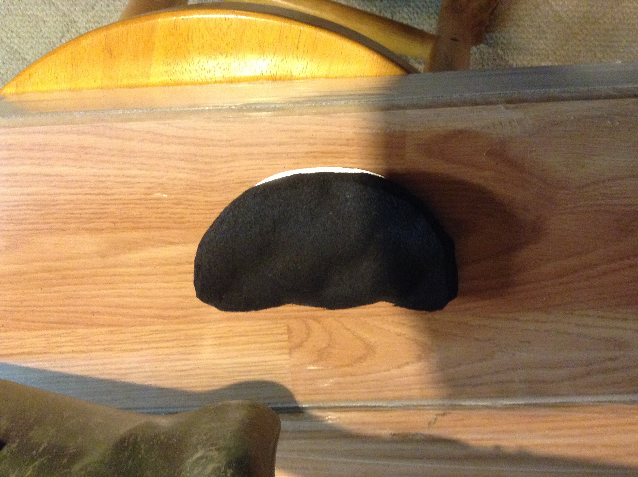

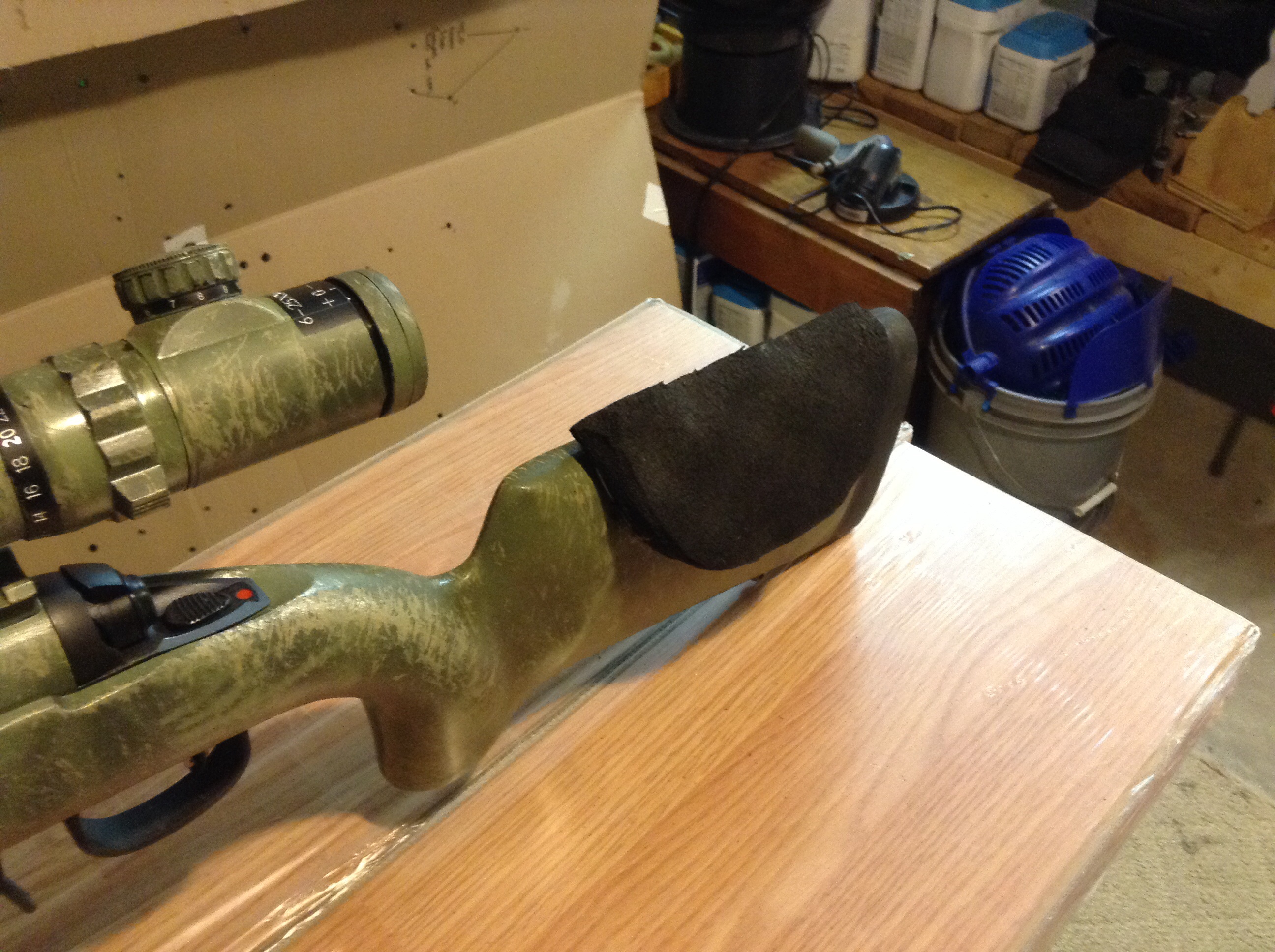

If you could post a couple pics cheek piece

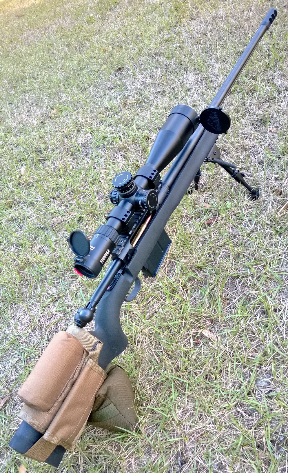

Took the FCP to the range this weekend. I really like it. I mounted a Steiner 5-25 Military on her, that I'm also using on my Creedmoor. I have found that all I need to do is zero on the CM, mount on the FCP and dial in 3 mils up and 1 mil left and have my zero for the other gun.
I was shooting S&B 250 gr and some old Lapua 250 gr soft points. The Lapua ammo sucked! The brass is what I'm after though. With the S&B factory loads the thing was a hammer out to 850, which is as far as I have used it so far.
I am hearing lots of Retumbo and H1000, I think I will buy both and some Berger OTM. Thanks immensely for the load advice, it will help when I finally get my supplies.
I'd like to post some pics, can you guys let me know how to embed them without having to click on the image?

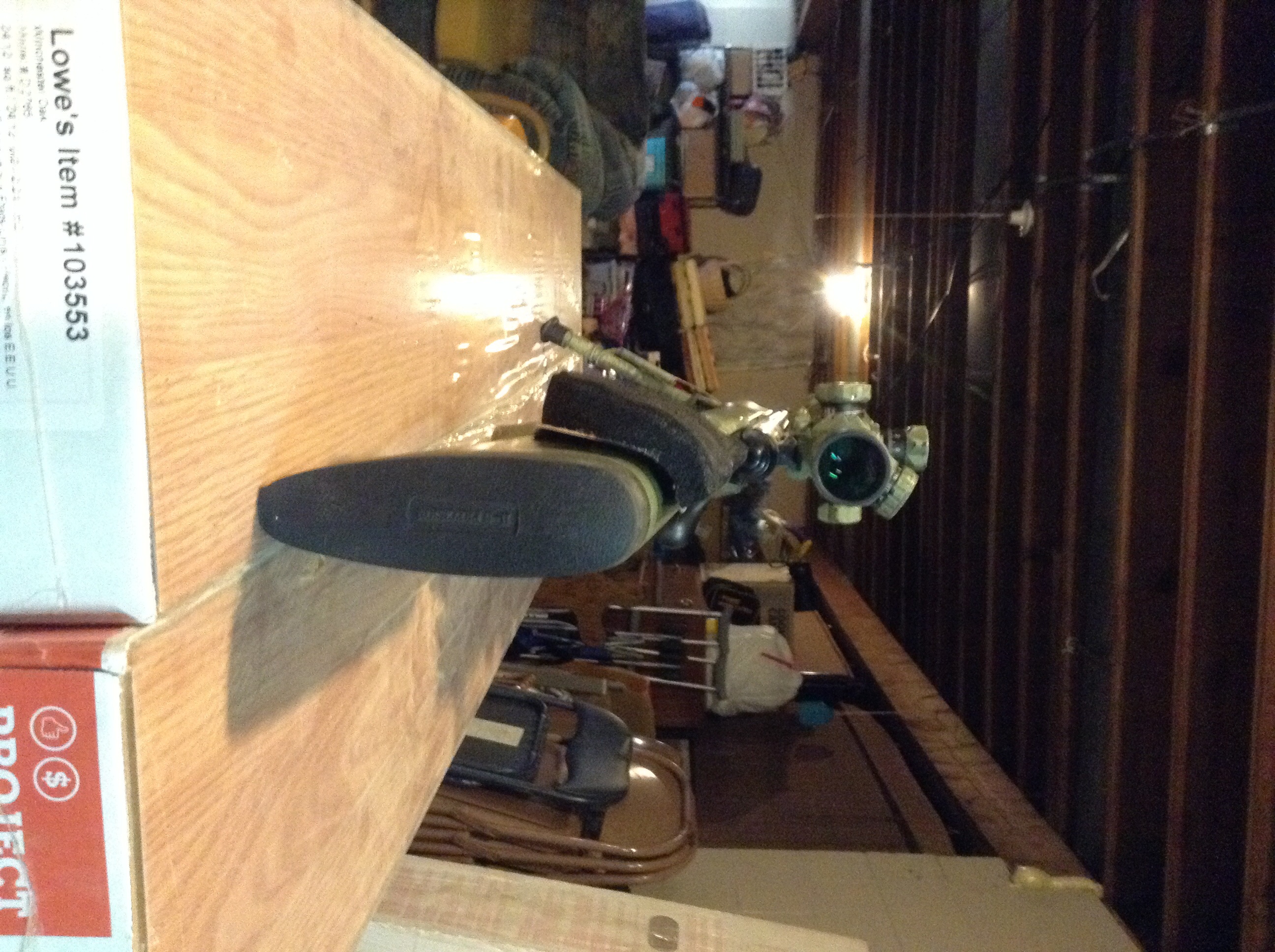

These are so pictures of my cheek rest on my savage i put a custom camo paint job on it myself also. I have yet to find a person to shoot it and not like the cheek rest they all raise one eyebrow at first but like it after thet try it.

I have both. Besides the obviously different stock, the BA has a heavier profile barrel. I'm not sure if they use the same reamer, but my load in the BA is 92 grains of Retumbo under the 300 OTM. That shoots .3 MOA in the BA and about 1.5 MOA in the FCP. It is also over 100 FPS slower in the FCP. Go figure.
-J
-J
