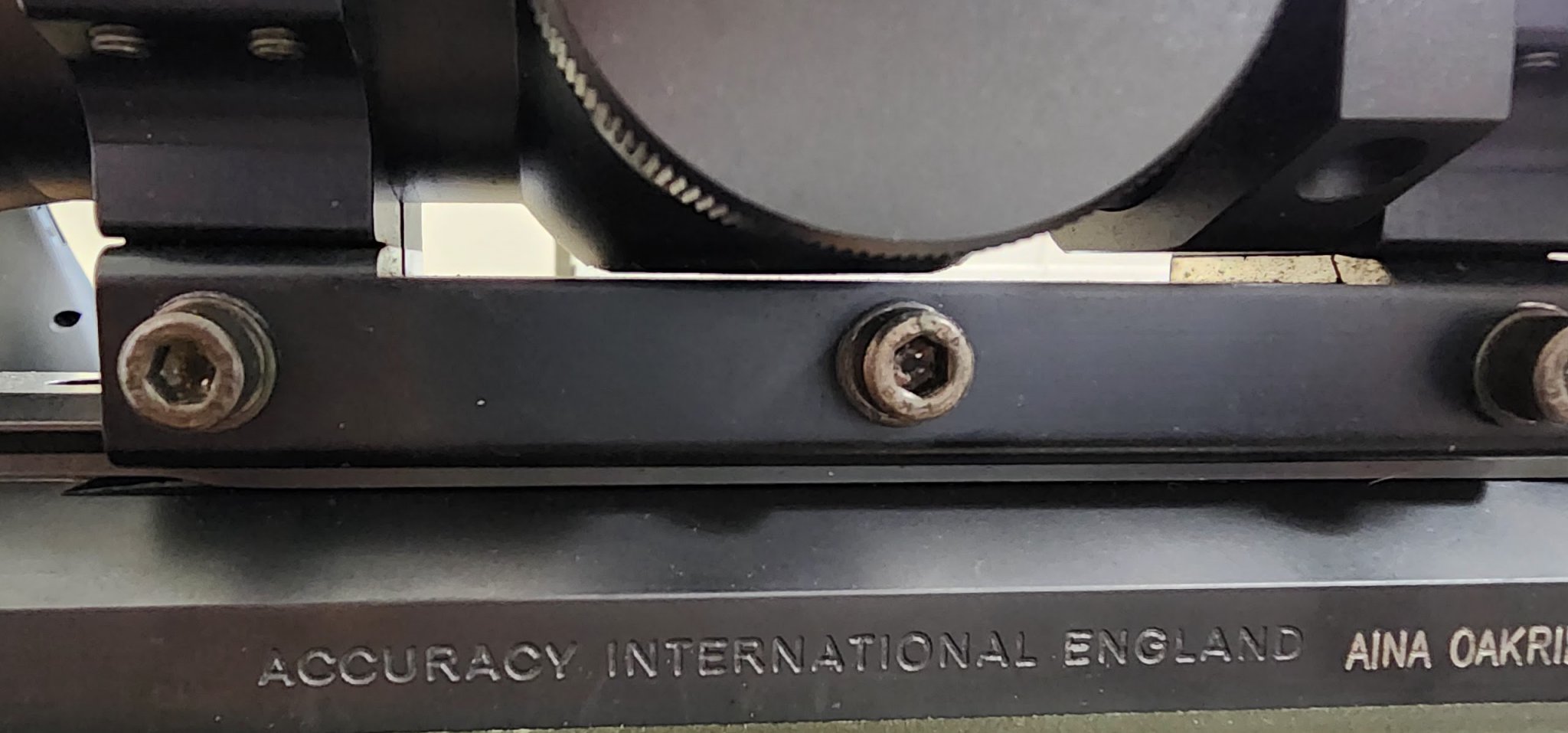

I have one of the Accuracy International one piece 18 MOA mounts that this was done to in order to fit the S&B 5-25x56 scope.
Without taking everything apart it's very hard to see anything from the photos as essentially it's put it in a mill, mill down a few mm of metal in between the rings and coat as you like and done.
The issue is the bottom of the bell that houses the adjustment controls extended down too far on that low mount.
That being said, that 18 MOA mount was great if you wanted to have a really low head position on your rifle.
Zero at 100 yards with .308 and shoot to 1000 only using just over half your elevation dialing ability. So it is a great setup.

Here is mine milled on my AW with the 18MOA mount and 5-25 S&B. This was done a bajillion years ago. There is about a tenth or so taken off the base of the mount to make it fit. There might be 30-40 thou of clearance between the scope and the bottom of the scope. Mile High use to do this modification all the time. I had it done by a friend that had a mill. We made sure the mount was perfectly level and where the ends were
