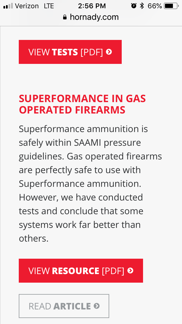

Even Hornady has stated that SuperPerformance is not for gassers.
They are correct.
I could have sworn that Hornady had put out a public notice that Hornady Superperformance wasn’t meant for gas guns but that no longer appears to be the case. Either way I’m still not buying it, the real world performance seems to leave a lot to be desired.
