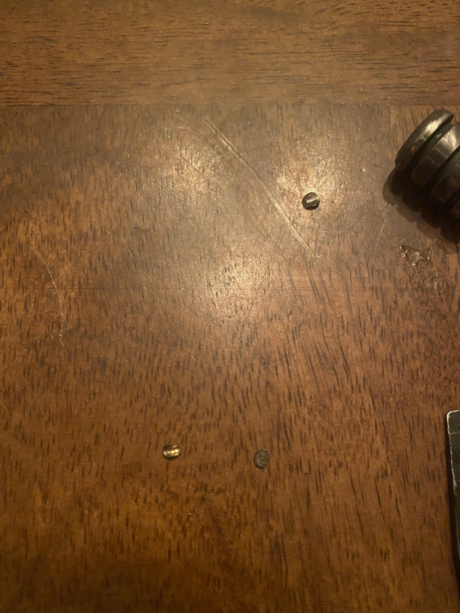

When it pierces that primer material gets pushed through the hole in the bolt face and can jam it up making it difficult to extract because the pin is pinching that material against the bolt body.

Ok. That's what I thought but I appreciate the detailed info. But that material would be from the primer being pierced only correct?
I’m sure it’s possible to get other crap in there but I’ve only ever had the little discs of primer cup when using a cci 400 instead of a 450
Here’s a pic from the web of the little discs that get pushed through the firing pinhole.
Reactions: KYyeeter
