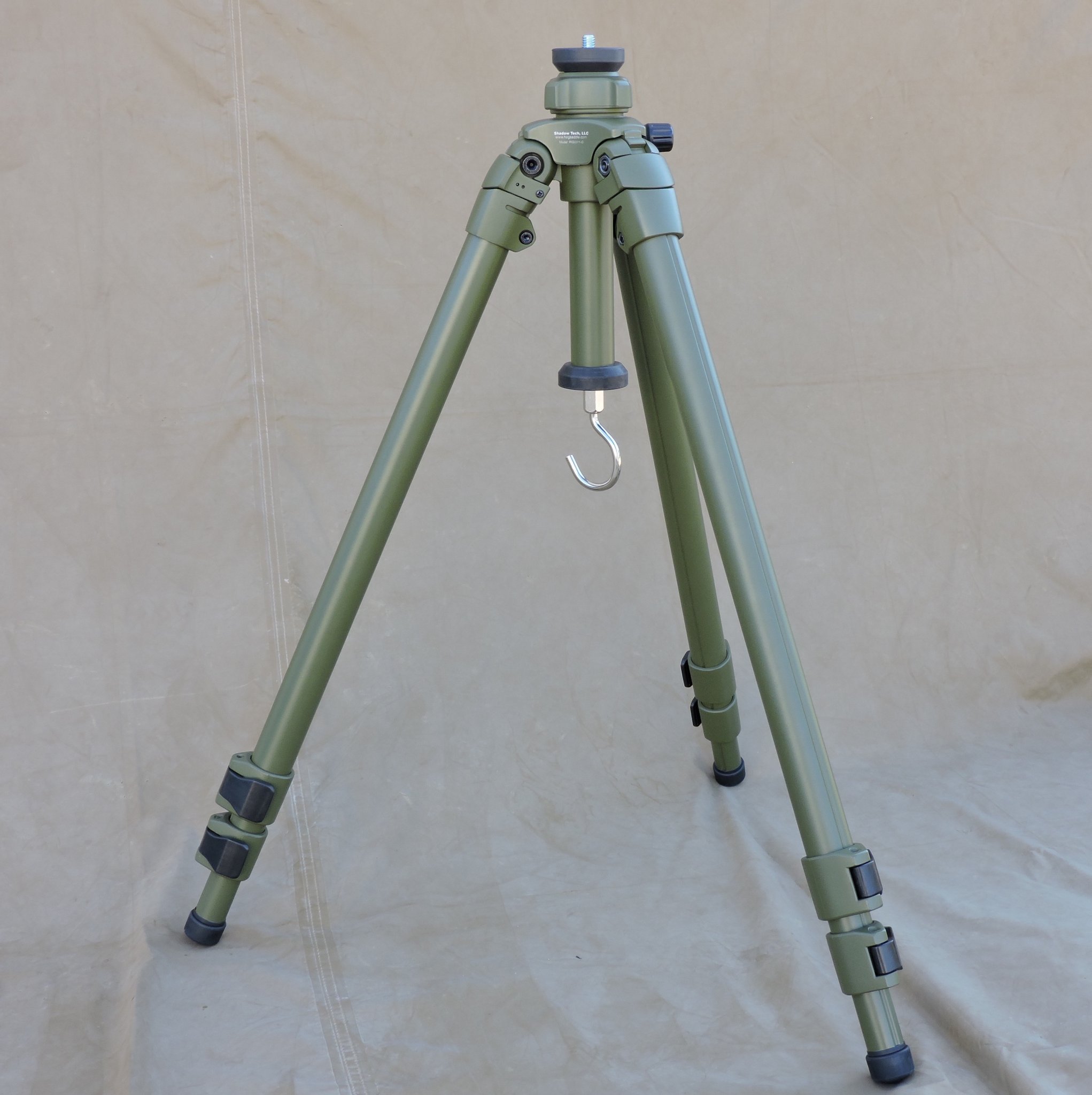

A no-nonsense field tripod designed for the active outdoorsman. This tripod was meant to get dirty, be thrown in trucks, and be used outside. Paired with a direct mounted PIG Saddle, this tripod can do almost anything a more expensive tripod kit can do (At a fraction the cost).
The GNN FB-52 ball head is a great match with this tripod.
  • The short center column allows the shooter to get all the way down to a 11.5” high prone position.
  • A removable, load bearing hook has been added to the bottom of the center column to hang weight, such as a backpack. The added weight will greatly increase tripod stability.
  • The center column can fully rotate 365 degrees. This is a great feature for those who intend to direct mount a saddle to the PIG0311-G tripod.

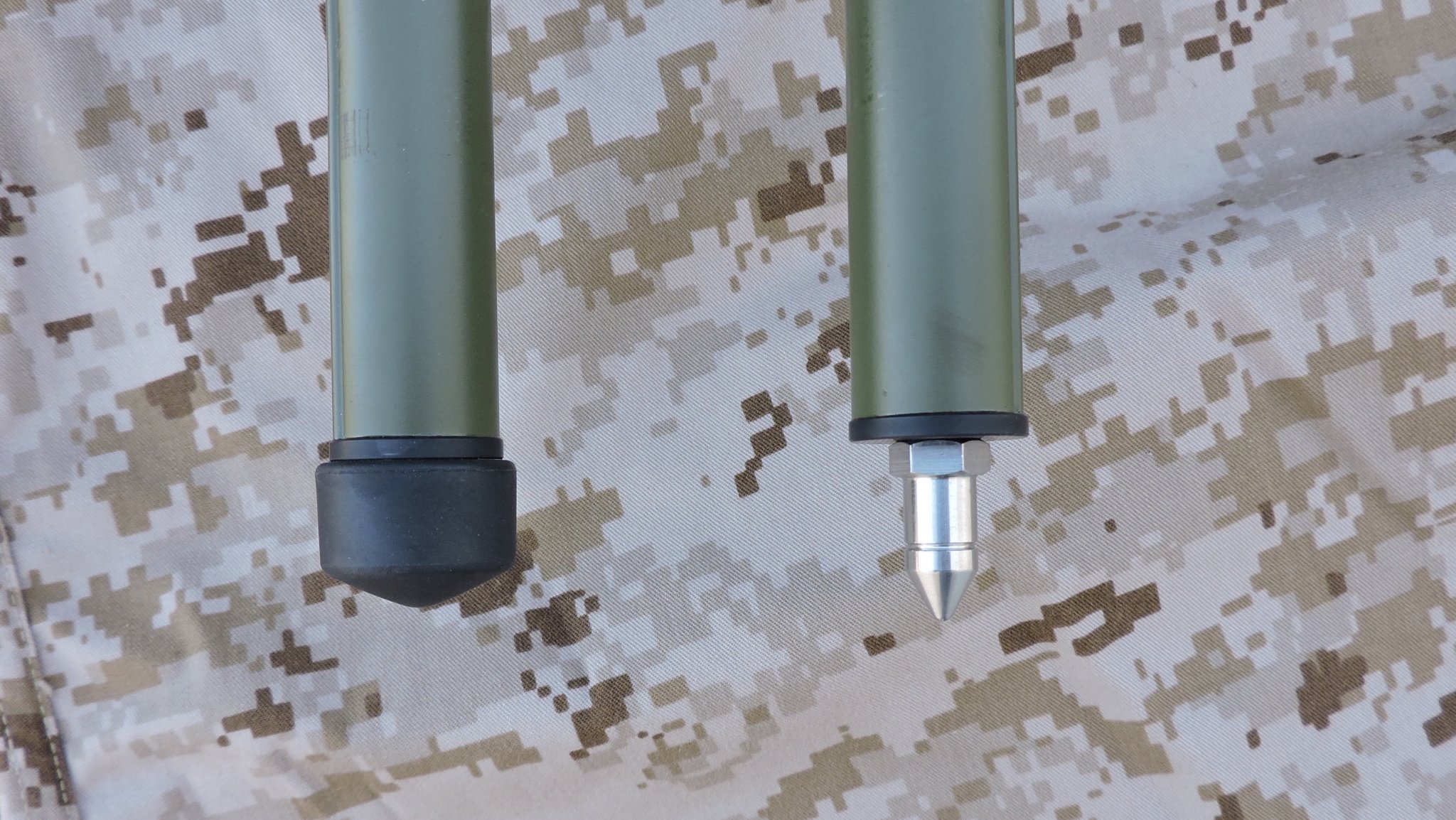

  • The tripod’s feet incorporate interchangeable rubber or spiked feet. (Yes, the spiked feet are included)
  • 26 lbs heavy duty weight rating. But don’t be surprised to see Barrett 50 cal’s being popped off this thing.
  • Lightweight magnesium body with aluminum legs.
  • Three section extending legs with cam levers.
  • Lightweight nylon carry bag included.
  • Finished off in flat OD Green paint job.

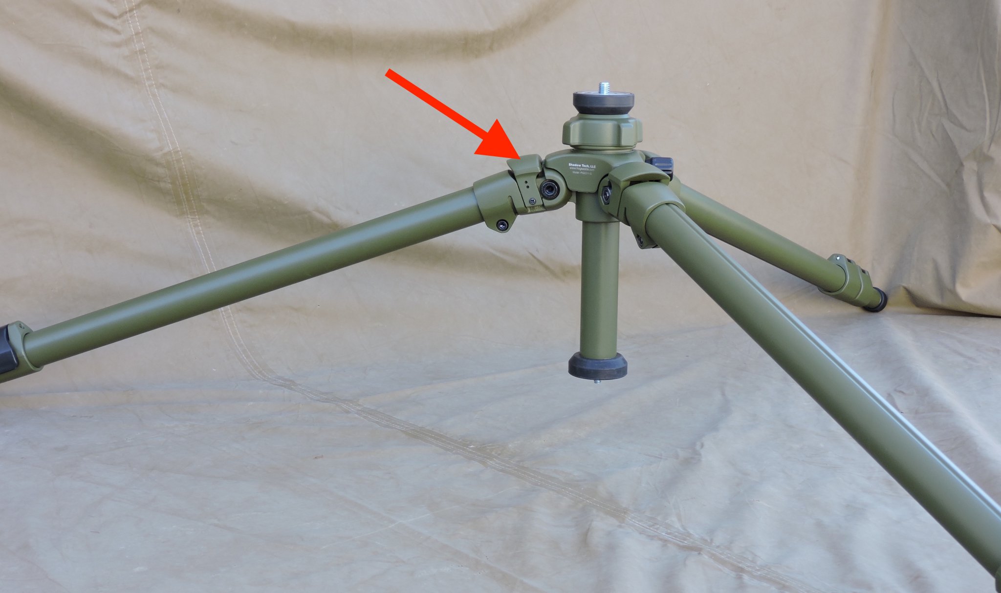

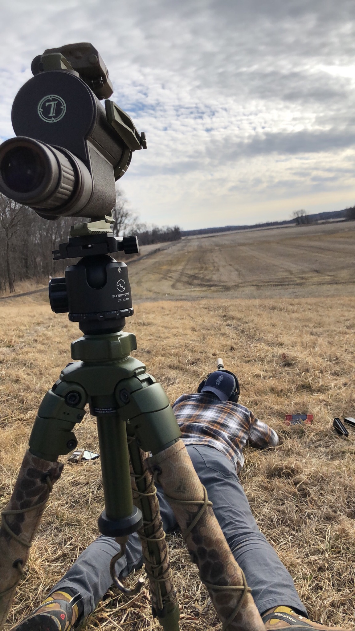

Here is a customer pic from last week...

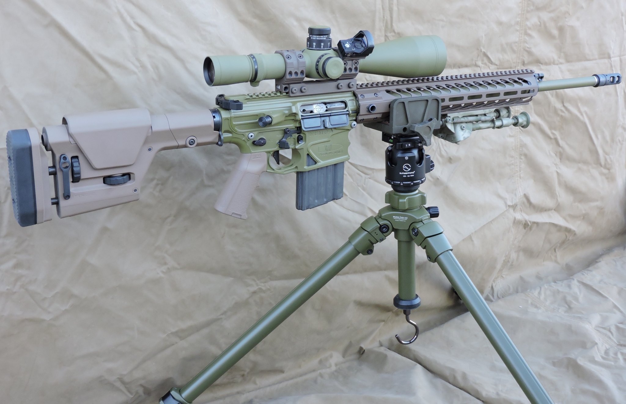

There is definitely a stability advantage to direct mounting a saddle, and not using a ball head. There is also the benefit of reducing weight and overall cost by ditching the ball head. I would try it out first and add a ball head down the road if you wish you had a little more articulation of movement that the ball head provides. We've seen a 50/50 split between customers using/not-using ball heads.
A ball head or panning head makes life a little easier when shooting from a tripod, and it takes a little more skill via the direct mount method.
The most accomplished real-world shooters I've worked with prefer the direct mount method. But in the end its your personal preference as long as targets get hit.
For the money, you can't beat the PIG0311-G tripod & PIG Saddle combo. This tripod and the DX700PRO tripod paired with a PIG Saddle has been extremely popular with law enforcement customers and hunters.
If you choose to use a ball head the Feisol CB-50D with arca-swiss Sunwayfoto DP-60R dual bolt QD plate is one of the best high load capacity, budget ball head options out there.
Will it be possible to purchase the spikes separately if you already have a Slik 700 with a ballhead and Pig Saddle?
Unfortunately not. The 700 model feet are hollow. For the PIG0311-G tripod we machined custom aluminum fittings for the spiked feet & rubber feet to thread into.
I'll look into doing a retrofit kit but that wouldn't be anytime soon.

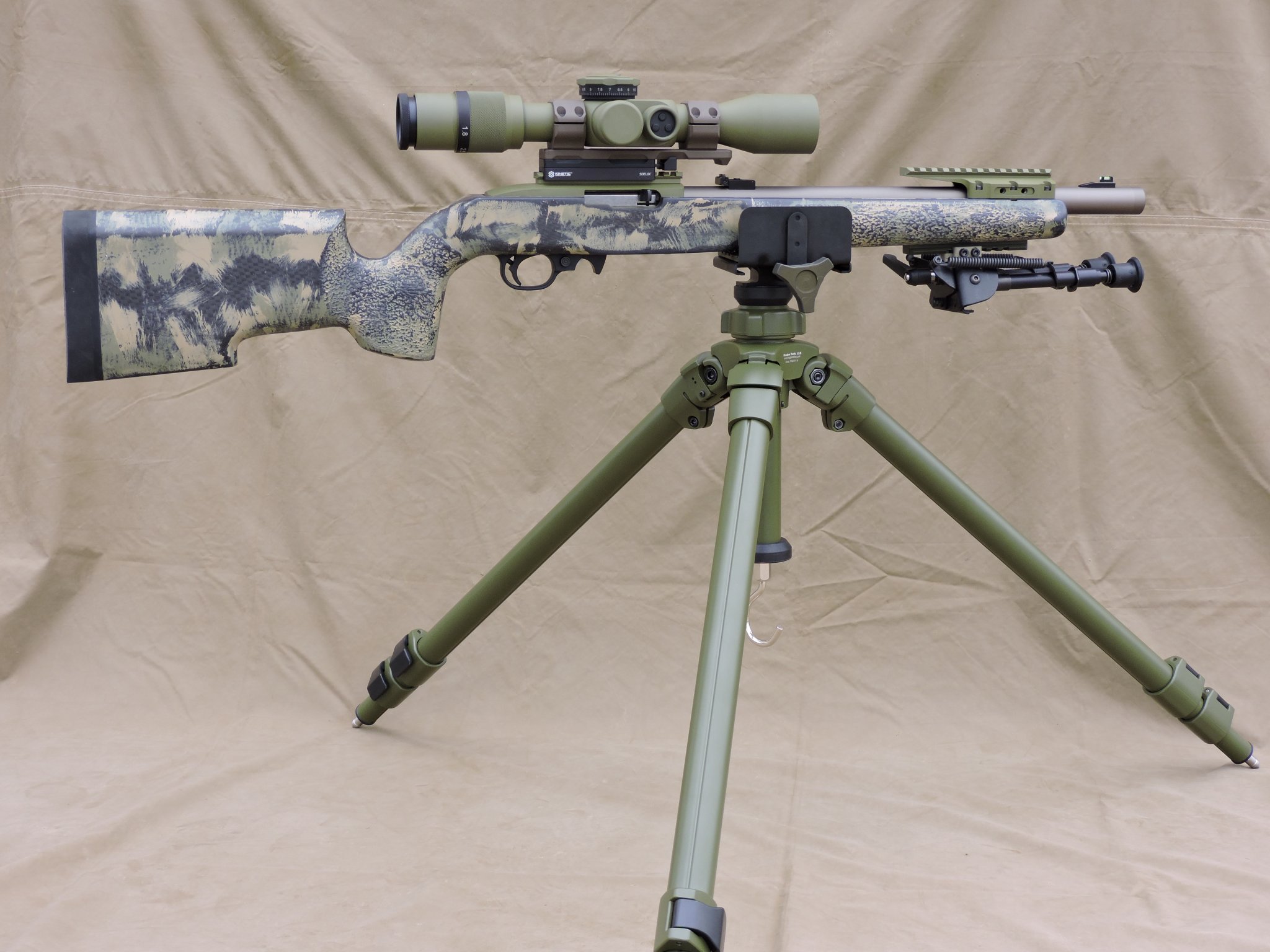

Had a chance to get out and shoot with this tripod and old Boegen ball head with arca/swiss adapter plate.
Shooting 10/22 with arca/Swiss plate on stock at 50 to 100 yards, 1 moa size targets. The weak link was me not the equipment. Hit ratio and group size exceeded expectations.
This will fit the bill for serviceable tripod head unit to leave and truck for spotting and shooting. Is it the lightest compact outfit for backcountry use, no. Is it the most rocksolid tripod available, probably not. Exceptional quality and workmanship for price point and something usable for most shooting and spoting situations.
every dollar I spend on shooting accessories is a dollar I can't spend on reloading components or ammo. Time spent futzing with equipment that doesn't work takes time away from practice. With that in mind this purchase provided great value it accomplishes the intended task and does not unnecessarily erode my shooting time or finances.
Looking forward to using same set up with 6.5 Creedmore semi this coming week. Undecided if I'm going to get hog saddle, or mount plate to bottom of manners for my bolt gun.
