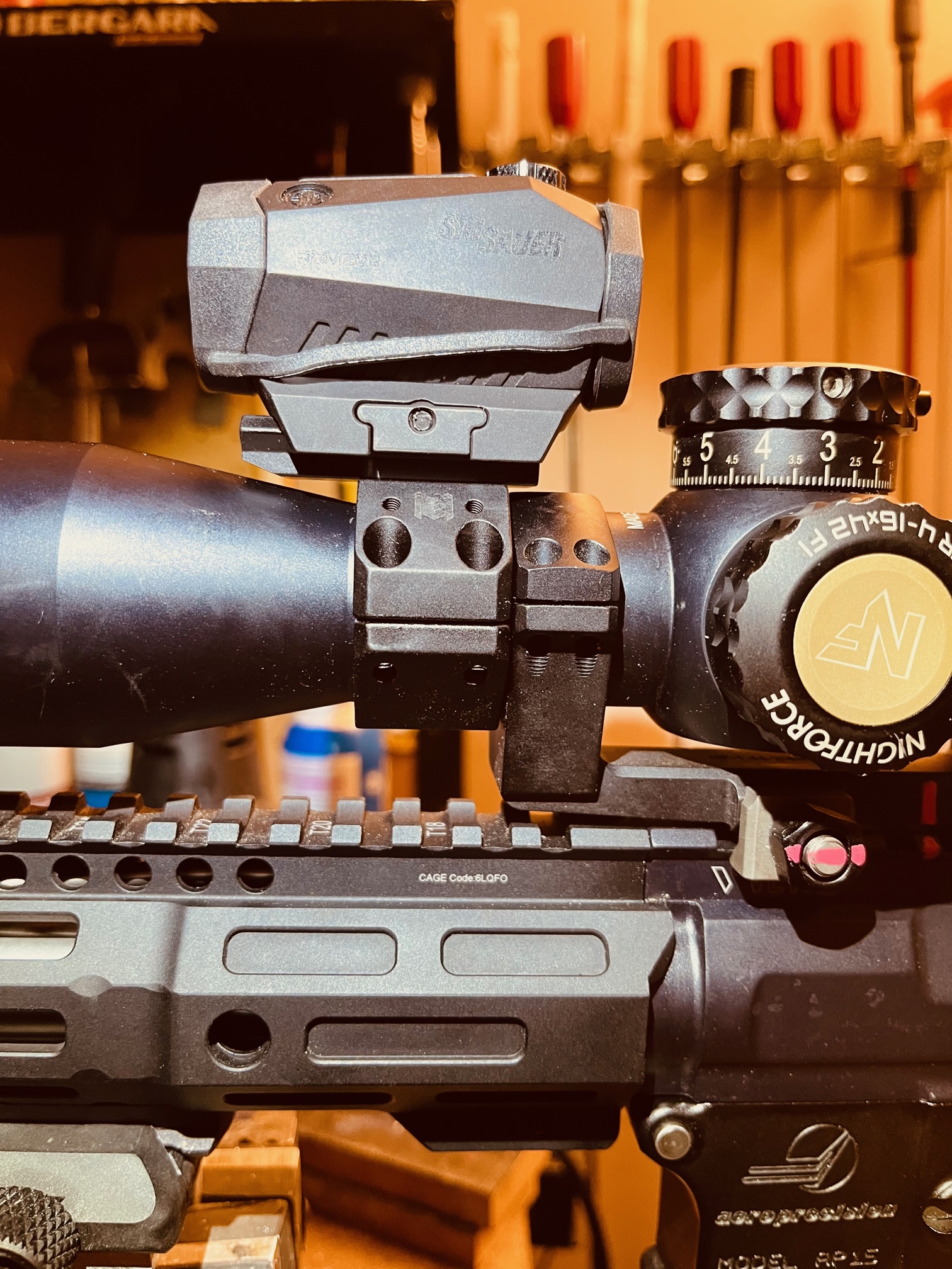

    The T-Rex Arms offset Aimpoint mount I had wasn't really working for me on my SPRecce with the NF 4-16 ATACR. So I started looking at some different solutions, an Arisaka offset mount was one of them but I also wanted to give a piggy back mount another go. The trouble was that the two 34mm options I found were $150-$170 which was a bit much for something I may not even like. However, I found a cheap option on Amazon, a Monstrum 34mm piggyback picatinny mount for a whopping $21.
    This isn't a review so much as my observations, for being a MIC product the quality isn't bad, the finish is consistent, the fasteners appeared to be good enough, even the small screws holding the rail to the ring cap. I had about 1" from the front of the ring to the start of the objective bell and this mount fit perfectly in between, I'd say it's probably .90" or so wide. There are two mounted positions for the rail so it can be biased toward the front or the rear towards the turret. On my set up, having it biased towards the rear was too close to the turret for me but forward put it a bit close to the objective bell so I filed it down for more clearance.
    Height from scope center to top of the picatinny is about 1 3/8", which puts the Sig 2" above scope center line with the low mount as shown. I zeroed it at 100 yards without any drama and it stayed put throughout the range trip so I'll chalk that up to a win in my book. I have to say the 12:00 set up is growing on me but I think I'd like something where the red dot is more directly mounted instead of a series of fasteners so I might start giving the LT787 and Reptilia options a closer look.
    The HOB above and zeroed at 100 yards means that of course I need to hold high A-Zone inside of 50 yards but I'm basically a dead hold from there until about 200+ yards and at 300 I'd be holding about the shoulder line on a BC plate.

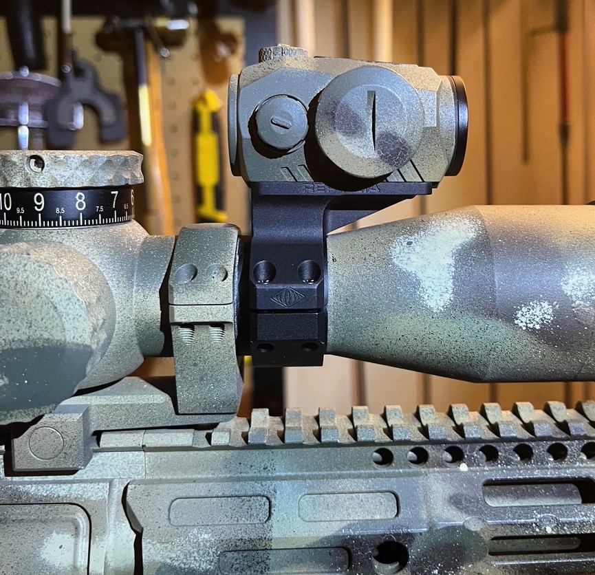

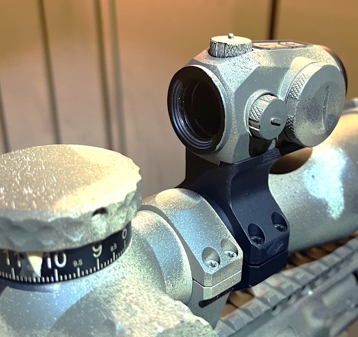

    After working with the piggyback mounted red dot a little bit I realized that I actually kind of liked it so I went looking for a better mount. Not many companies are making a mount to directly attach an Aimpoint T-1 footprint RDS to a 34mm scope. My options boiled down to LaRue and Reptilia and I got more of a warm and fuzzy feeling from Reptilia so I went with their ROF-SAR mount for T-1 footprint optics. I couldn't be happier with this mount, the Sig Romeo5 mounted up with no drama, the mount comes with mounting screws to make things easy, and I torqued them to 10 in/lbs with some Permatex orange.

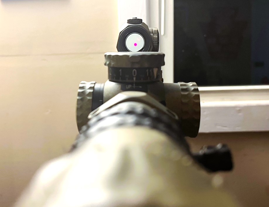

    HOB is 4.5" so it dropped down about 1/8" from the previous set up, which doesn't sound like a lot but it's noticeably better when behind the gun, I'm feel like I'm barely lifting my head before I see the dot over the elevation turret.

    Nice. I forget Reptilia has stand alone scope mounts for RDS. They make really good gear. How does it hold up to a whack against something, just curious if it's more prone to slippage than the ring cap option? Sure wish Reptilia sold their mounts with ROF options so you don't have a redundant ring cap.
    Reactions: FRESHPRINCE556
    The janky Monstrum Tactical set up held up well so I imagine that the Reptilia will do just fine. With it torqued around the scope tube I don't see it being anymore prone to slipping than the scope in the rings or other tube mounted accessories. It's not ideal but similar set ups have been used.
    Reactions: Glassaholic
    I could've but it would've put the red dot back closer to the turret and made it awkward to adjust the turrets without moving the optic and mount around to free up some space maintain eye relief. This solution was simpler for me.
