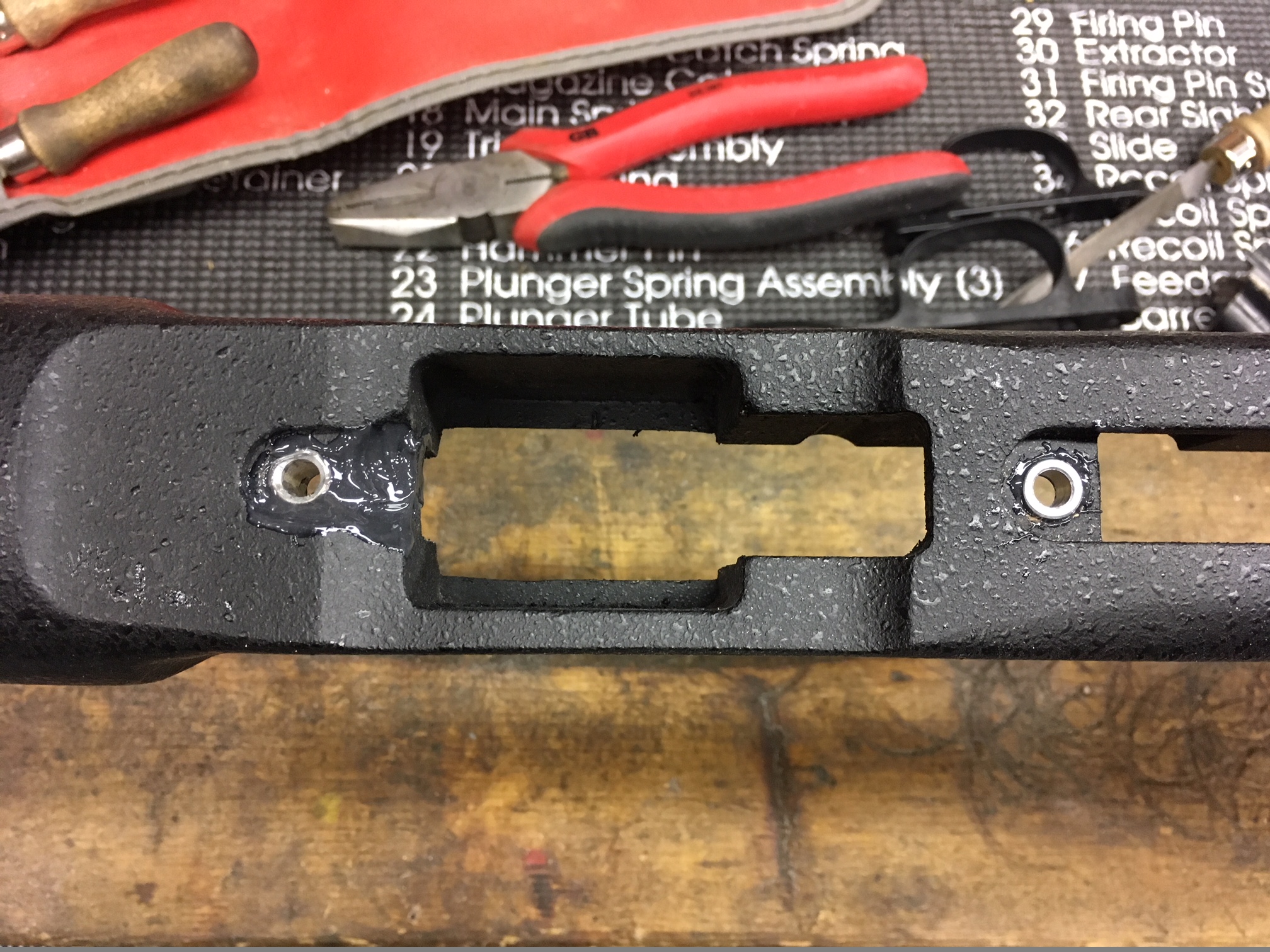

Here is the after set up, but before sanding.

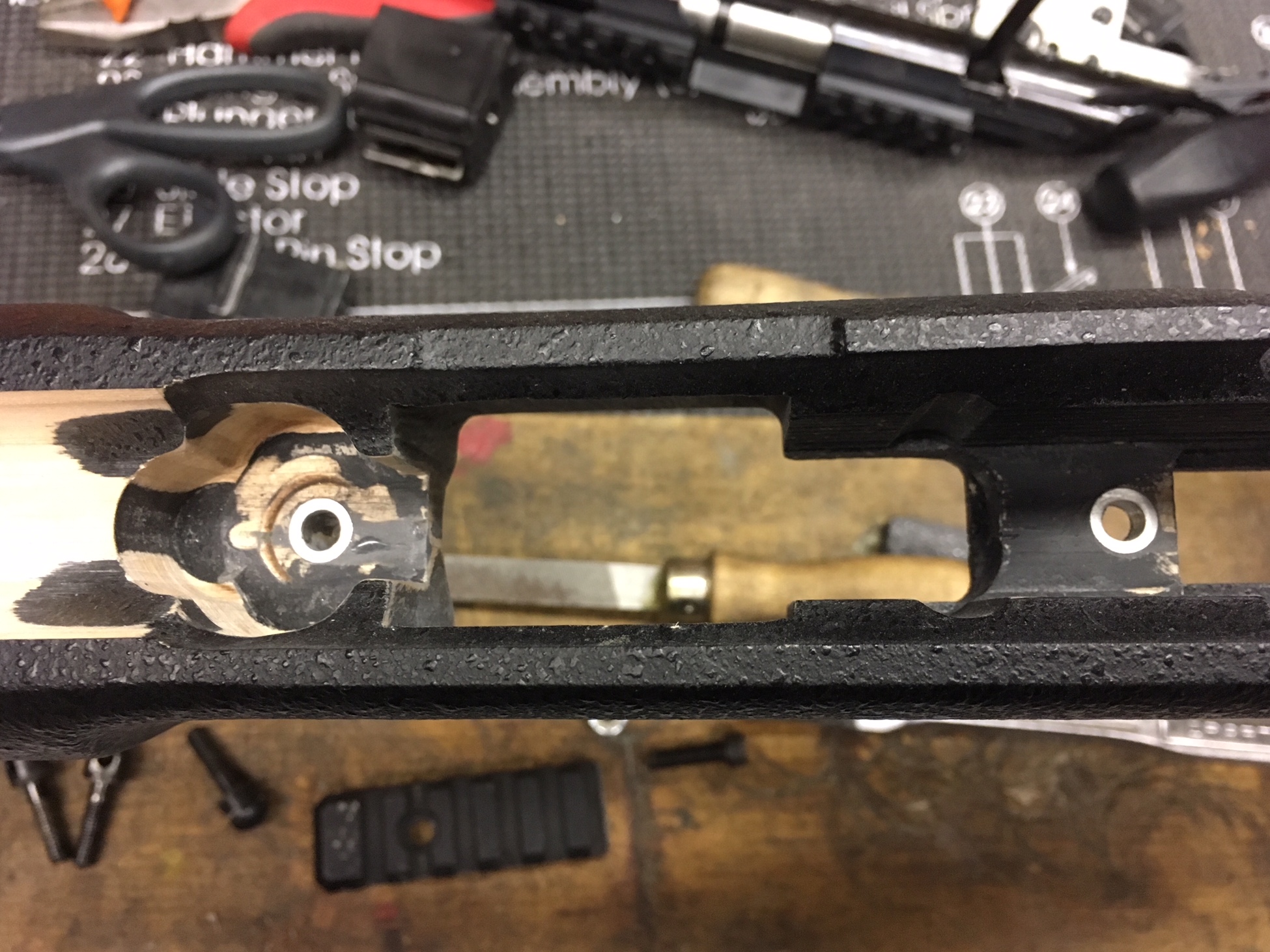

Groves on the o.d. of the pillars for adhesive.
