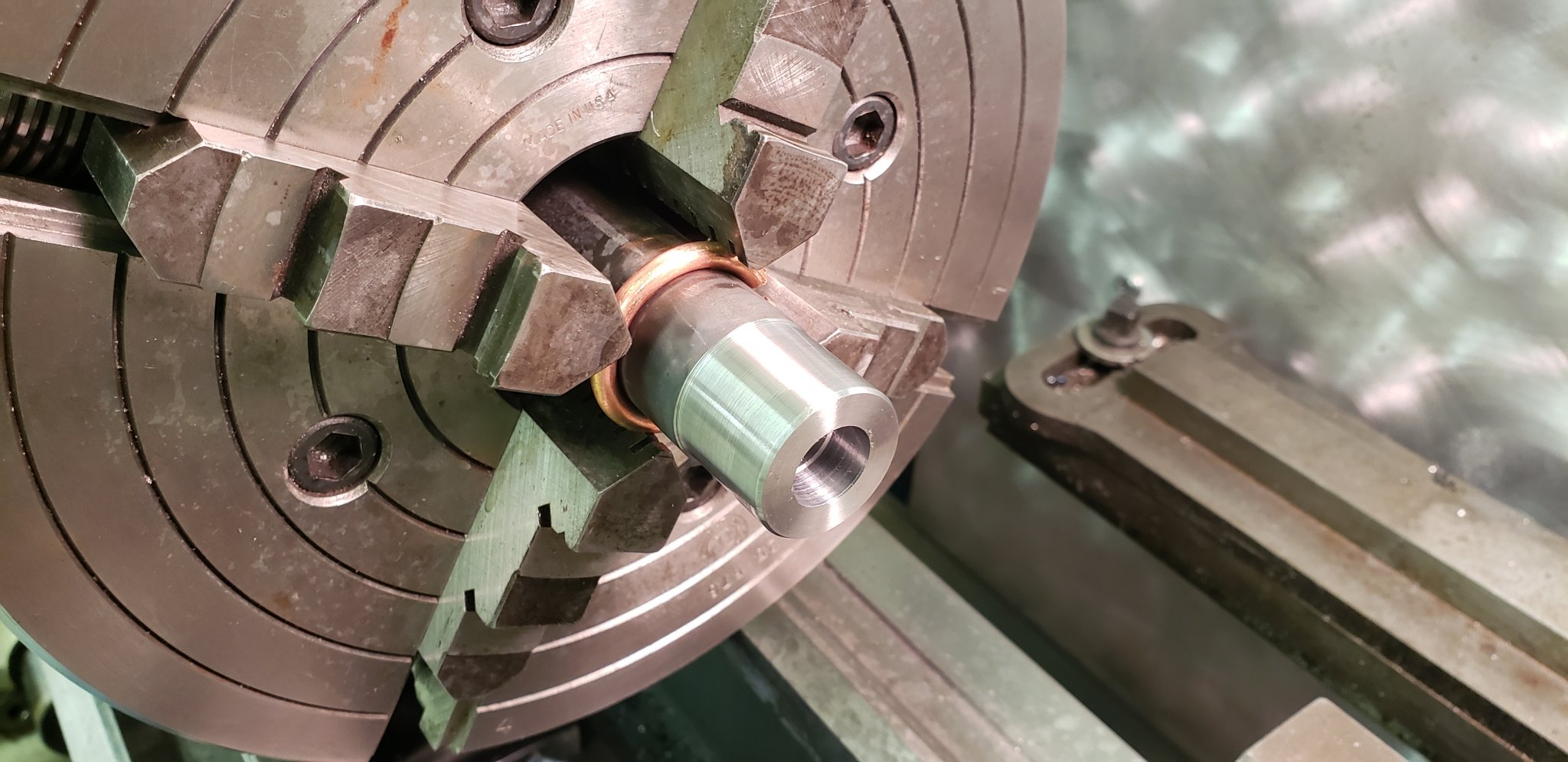

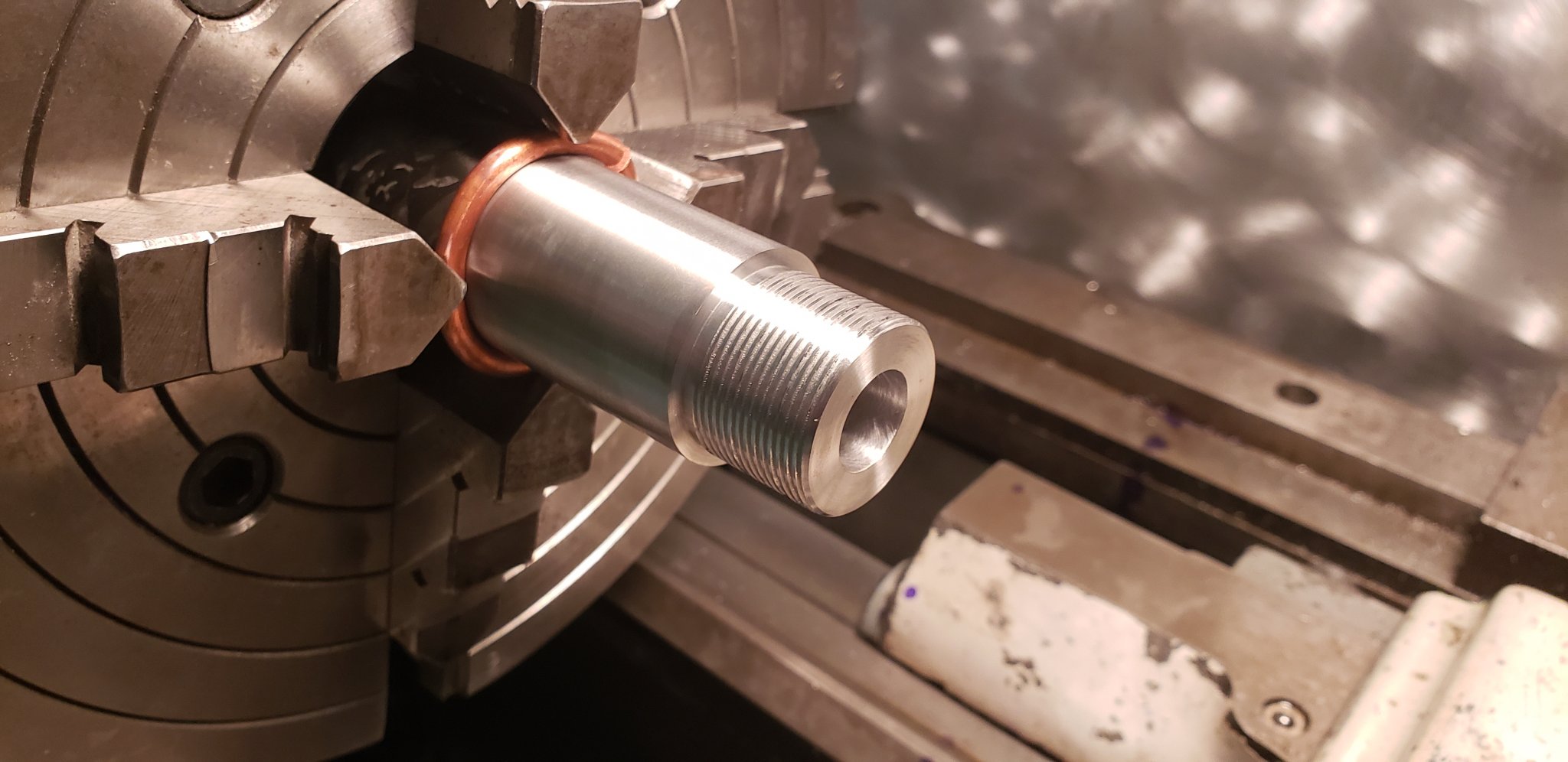

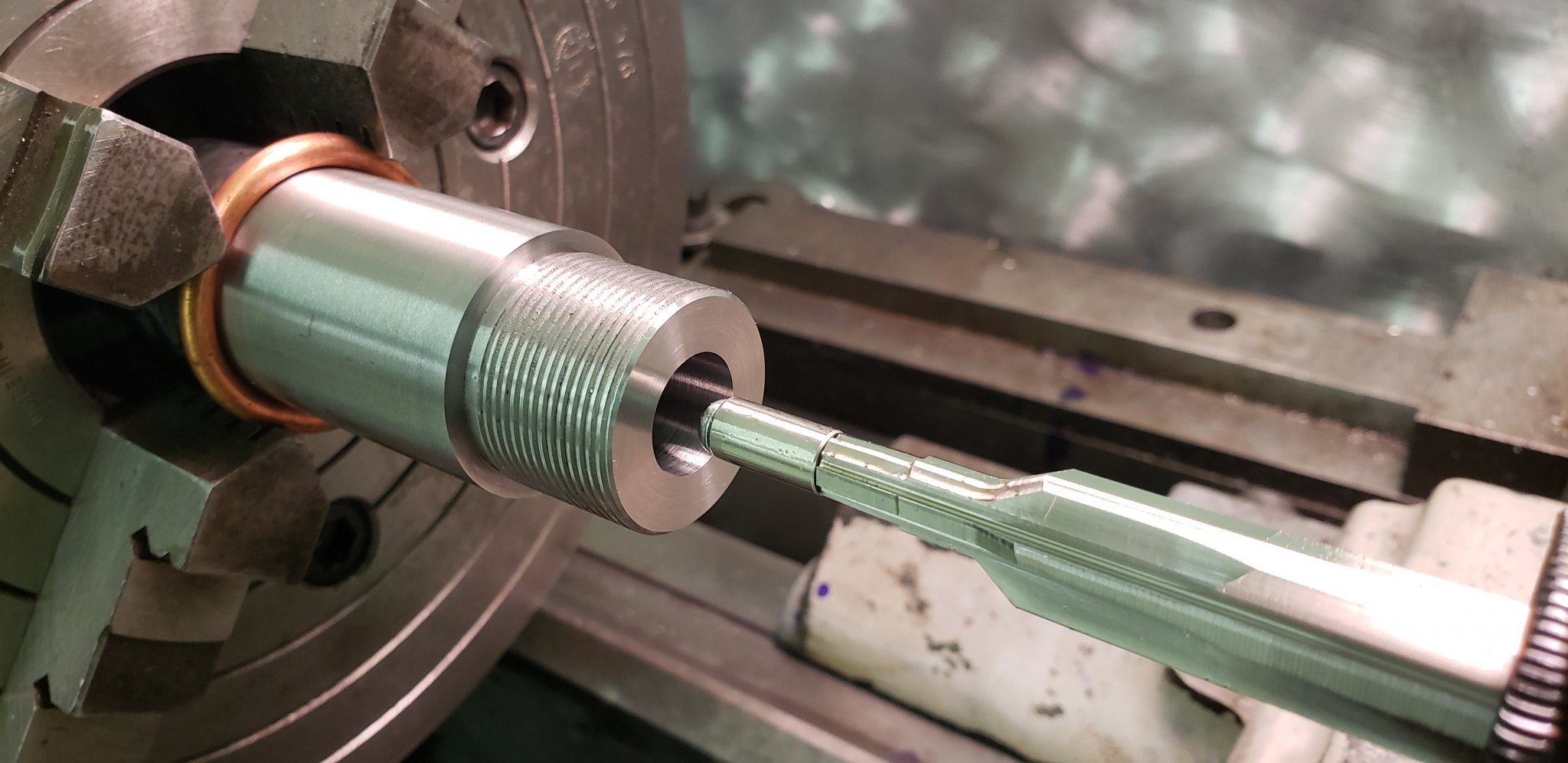

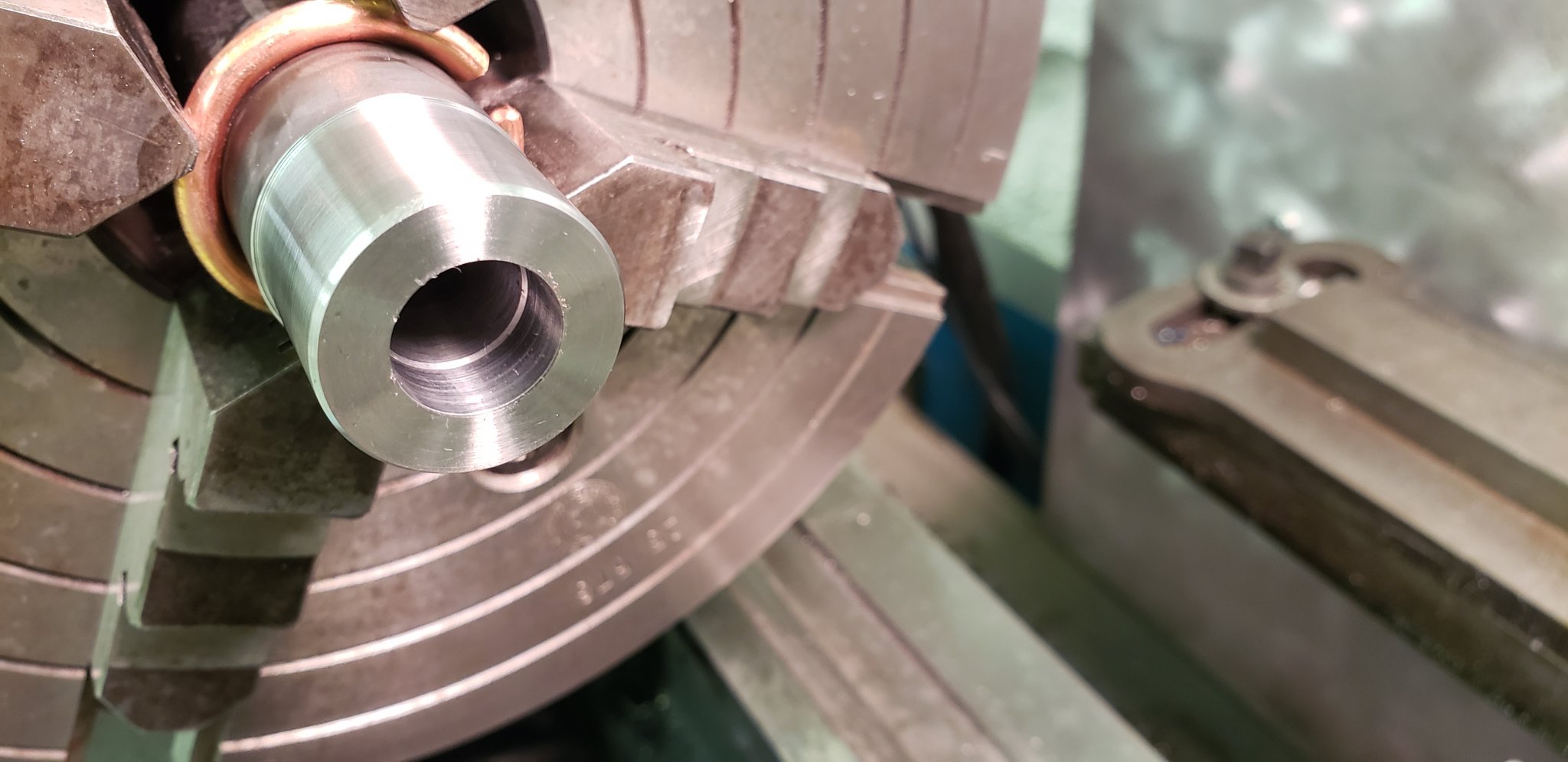

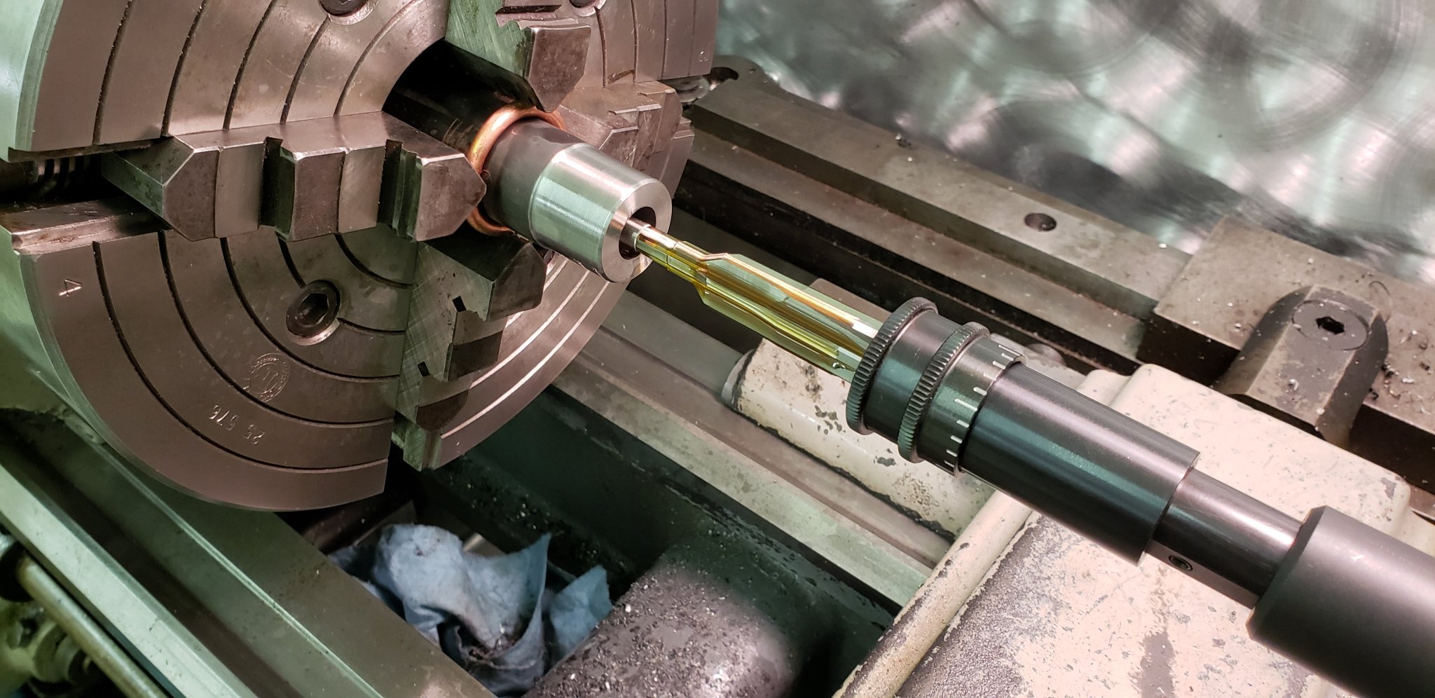

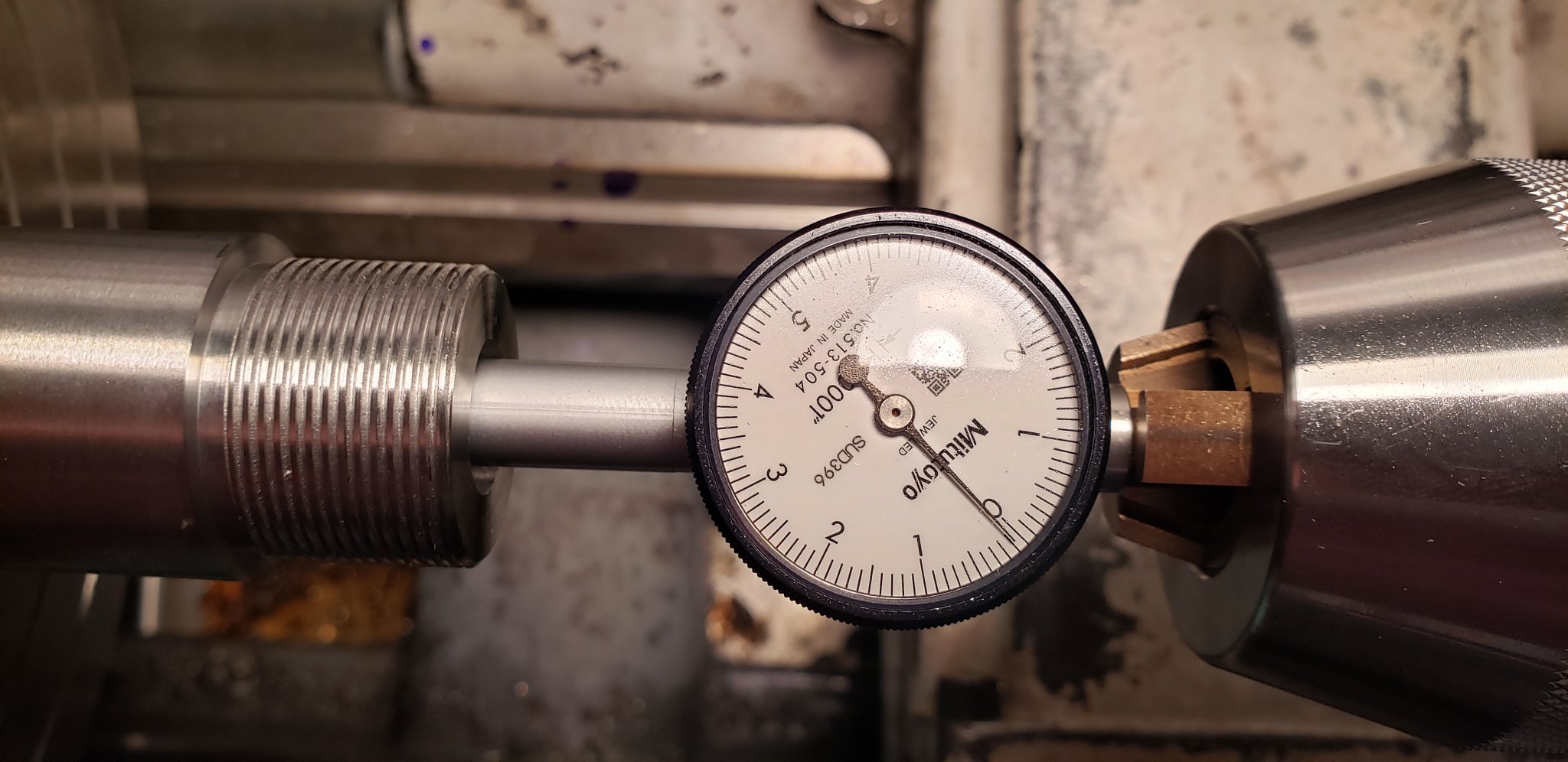

I wanted to leave some feed back for others on my experience with this topic.
I decided to try preboring a practice chamber before my next barrel.
I used many of the techniques suggested by Gordy Gritters in his latest book.
I drilled to about .200" shy of finished length. I bored it true leaving around .030" left to ream.
With prebore I ended up with a chamber that had .0002" runrout at the start of the chamber and a unpreceviable runout (less then .0001") at the throat. For a old worn out lathe I was thrilled! I will probably continue to use this going forward.
I am still learning and just want
ed to leave some feedback for others.
Thanks, I forgot to mention this was the first time I tried using the copper wire as a interface with the barrel and spider. Seemed to work very well and limited the stress input.
I love my copper rings. Probably a dozen of them on my headstock. I land them in the groove on the jaws so they’re nice and square in the same place on every jaw. Probably doesn’t matter but you might like it.
Reactions: Rprecision
I am still learning and just wantView attachment 7280571View attachment 7280572View attachment 7280573View attachment 7280574View attachment 7280575View attachment 7280576ed to leave some feedback for others.
Depending on the tip angle of your drill bit, no need to stop .2 short. That’s a country mile imo. If you’re going through the effort, stop .050 short.
