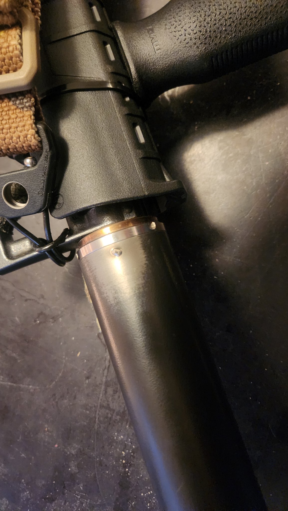

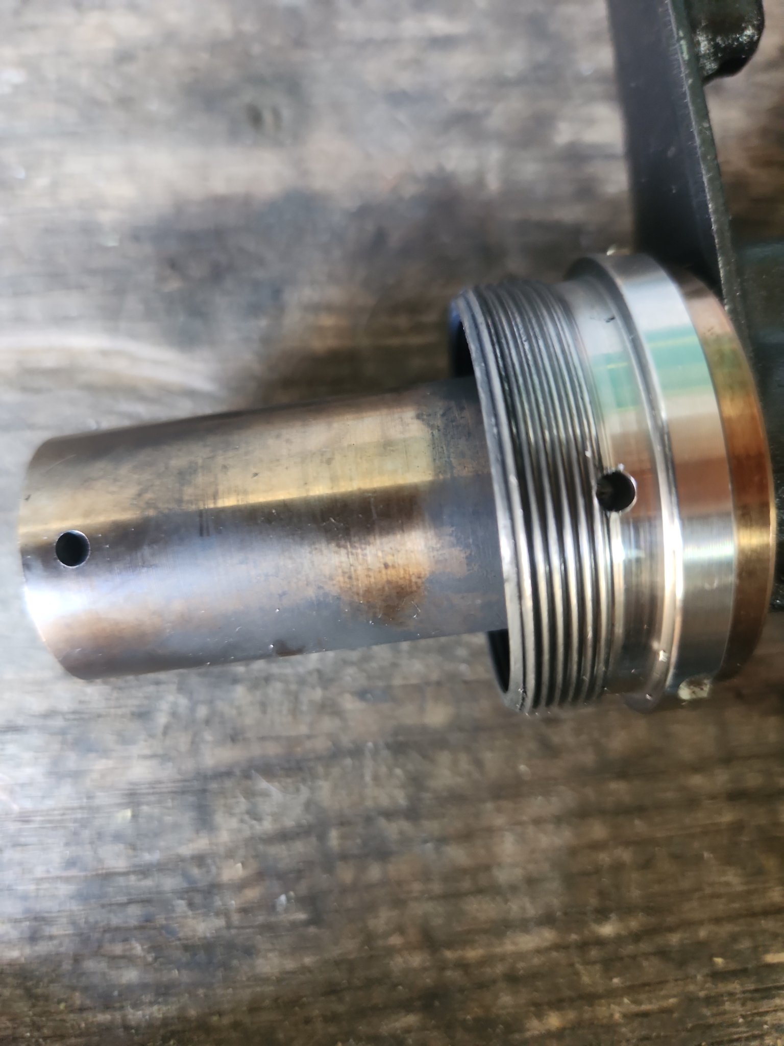

    Is that a pinned hub mount? If you wouldn’t mind, could you explain the process there? I see a couple of holes.
    Yes, it is. It's a 1.375 reflex mount from
    They make 2 different lengths in 17-4 SS. This particular one is the 2.25".
    I made a custom timing shim for the muzzle threads so the adapter would back up against the FSP perfectly. Then I drilled for the muzzle pin. The Ti adapter seen in the photos goes from 1.375 to 1.529 (1-17/32). I then lined up the tube, thread adapter, and reflex adapter, and drilled for that pin.
    Muzzle adapter got the lightning gun first; 17-4 is easy, just don't burn too hot or you'll melt too much to the pin and adapter. The goal is just to keep the pin from falling out.
    Then came the butthole pucker; that little tiny hole in my expensive Ti tube. I made my pins from hardened punches, drop the punch in, mark and cut. Ti is not quite as forgiving as 17-4. I made the pin a smidgen proud of the tube surface and we're off with the lightning gun again.
    Can has a removable proximal cap (business end); so after all the welding was done, I dropped the stack in, and tightened her up. This particular weapon system is 9.6lbs with loaded mag, eotech, and sling. The magnifier and suppressor cover add and 1.5+/-lbs. Not bad for a suppressed 11.5. It was the preferred choice when shot beside a 10.5" 5.56 w/hybrid 46. Shorter too.
    16.125" to the end of the tube.

    I have a pinned and welded 300blk a one of my HD guns. They were having a sale that they paid the tax stamp, so the way I look at it I saved $400 on a gun that sits ready 99% of the time, that ill shoot once a year to make sure it functions. My next build will probably be an 11.5 or 12.5 sbr with a can (unless Don and Elon make some moves before then). IMO a gun that your going to use a lot, I want to be able to take the can off as I please, mainly for cleaning the rifles barrel, let alone the can itself.
    I have no reason to pin and weld a suppressor, but carbide tooling cuts dowel pins, taps, etc.
    Part of my job was getting broken form taps out of expensive parts.
    I used a CNC mill for complete control...super rigid machine, precision holders, run at high speed and low, one ten thousandths feed.
    Never lost a part to a broken high-speed steel tap, broken off deep into the part, all safely removed without damaging the orginial thread. Just clean the tapped hole, check depth, tap deeper if necessary, and you're good to go.

    It's really annoying to not be able to change gas block, handguard, barrel nut etc without dealing with the pin weld. Hell, sometimes it's nice to run a different suppressor. Fuck the 16 inch arbitrary length and keep some flexibility with a brace or sbr if at all possible.

    Lots of great feedback in here, I've had my own ideas of a pin and weld to avoid a 2 tax stamp setup.....in the end...I'm glad I didn't. Honestly the only way I'd ever do a pin and weld is a setup posted above where the entire core of a can is the muzzle brake
    I floated ideas of running a can under a handguard......overall too much hassle in my opinion.....deal with muzzle brake/suppressor removals and one will quickly steer away from that most of the time
    As far as titanium......I'd would HIGHLY recommend getting/having experience with titanium before wanting to pin and weld that. I work with metal all of the time at work......titanium is REALLY different than any other metal as far as grinding, cutting, drilling etc......it is extremely resistant to heat but once it hits a threshold it instantly melts then as soon as you back your heat source off (grinder, tig touch etc) it INSTANTLY rehardens. Obviously there are people skilled enough to work with it.....just saying familiarize yourself before going down that road

    Thanks bud. This is what I was really worried about. What's starting to look like the smart thing to do is just sticking with a pistol brace. I hate dealing with pin and welds too. Eh, I've done some stupid crap over the years, just because something seemed like a good idea at the time.
    Thanks for talking me down.

    Titanium is a pain in the ass to work with all the way around. It’s supposed to be welded in a sealed chamber, as I recall. Though you might be able to get away with not for something as simple as a pin and weld, because you’re really not doing much there.
    And it’s a pain to machine as well. The chips are flammable like magnesium. And it’ll break drill bits if you don’t know what you’re doing with it. And the cutting speeds for titanium are pretty slow.
    If you’re not experienced, and don’t have access to the proper equipment it’s going to eat your lunch.
