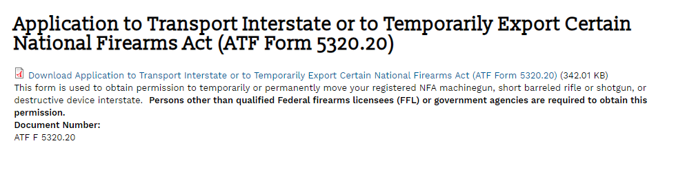

Different strokes for different folks. We have a couple pin and weld demos with no issues. Besides avoiding the Form 1 stamp, you can also take it across state lines without doing a 5320.20.
Please elaborate on the 'take it across state lines without doing a 5320.20' Ignorant me?‍♀️ thinks I always have to do this.?
If its not a NFA machinegun, SBR, SBS, or Destructive Device then you dont have to fill out the form for transport of NFA machinegun, SBR, SBS, or Destructive Devices...
