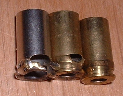

Here is a picture of right to left:
a) bulge over feed ramp [10 gr]
b) case hole over feed ramp [10.7 gr]
c) case head failure primary failure [extractor failure is a secondary failure] [11.5 gr]
What does it all mean?
In a work up, when you see a feed ramp case bulge... STOP.
Never shoot that load again or anything hotter than that.
Back off the powder charge 6% from the first tiny sign of case bulge.
That is the max useful load in that gun.
