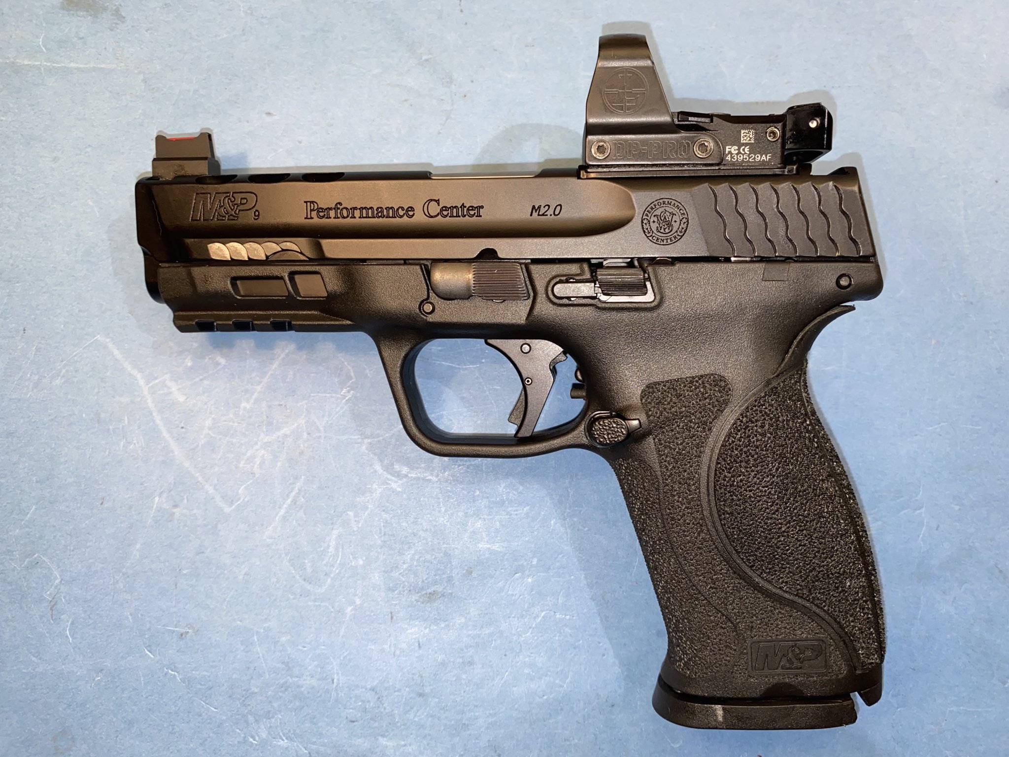

I prefer the rear BUIS in front of the optic if possible. As shown on my rusty project bedside gat.

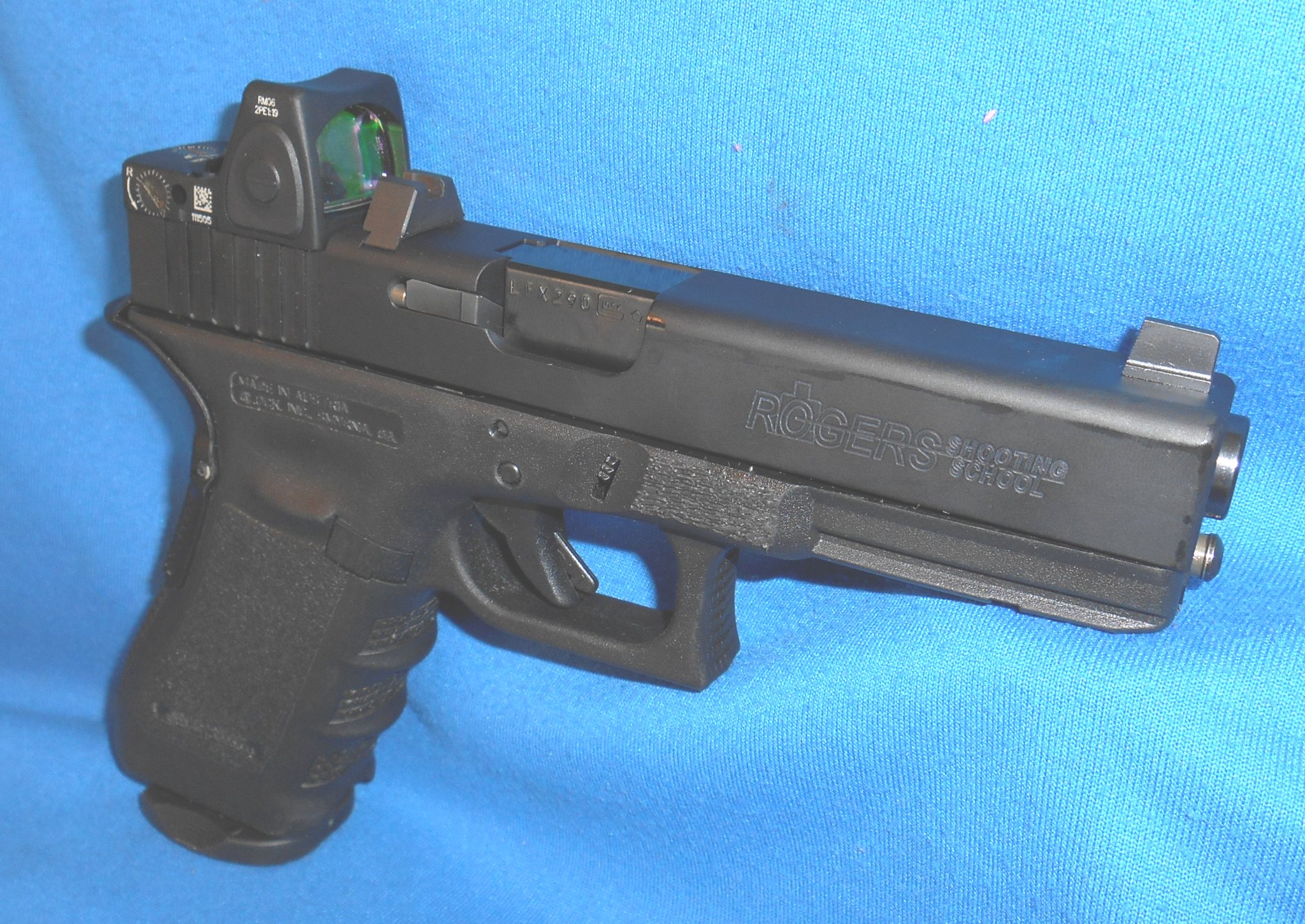

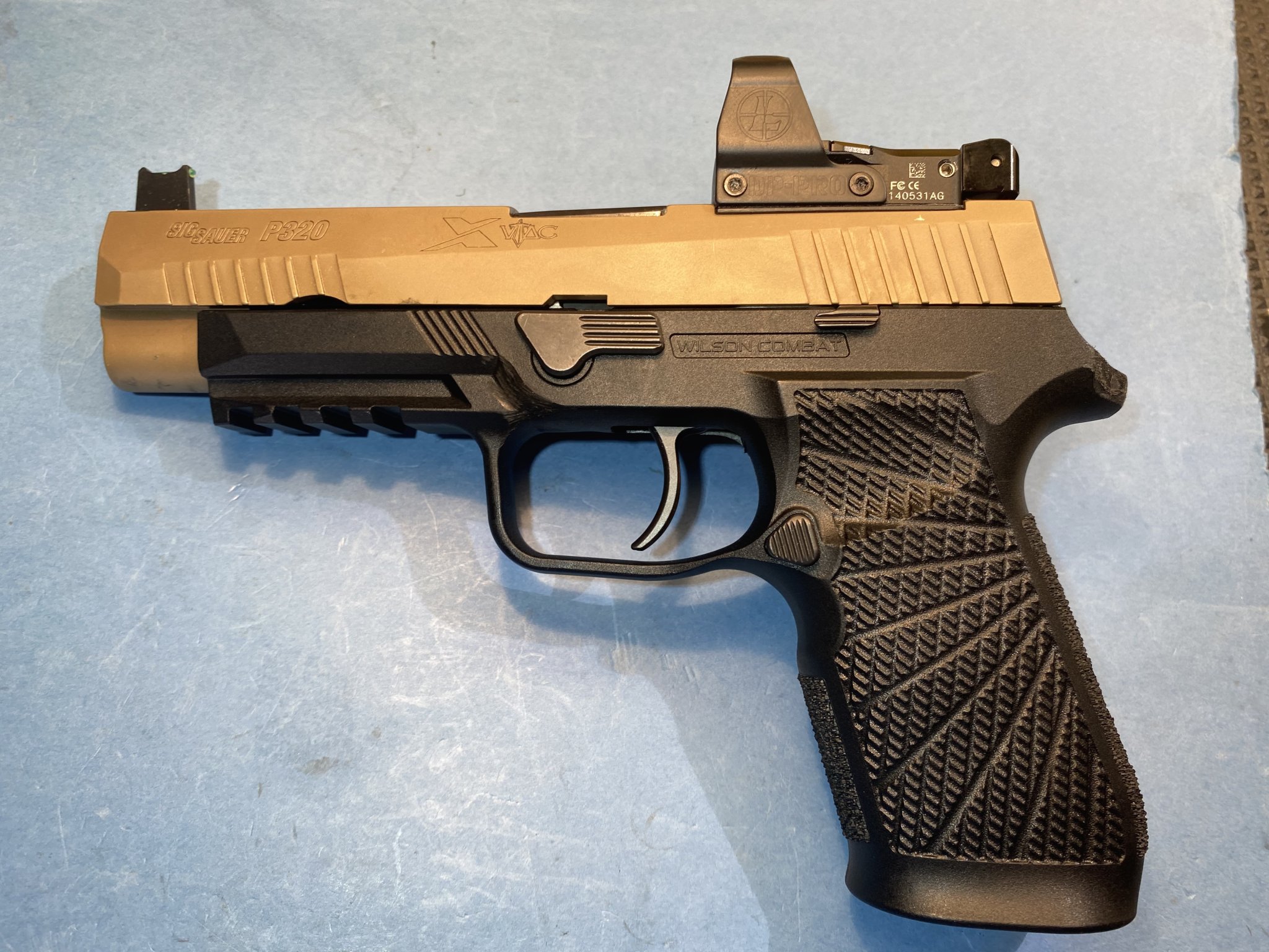

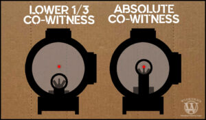

Try to have the iron sights appear through the very bottom of the glass so they don't obscure the optic's window- lowest possible co-witness.

FULL/Absolute co-witness is when the sights are in line with the center of the window and Dot- and full co-witness has been losing popularity because that decreases the view and quick acquisition of the Dot- which is the whole point of a Pistol Mounted Optic- clean draw and presentation of pistol and Dot appears over intended target... Having sights fully co-witnessed makes that tougher. Lower third or lower quarter co-witness is much more common now because it keeps the sights low and the view cleaner.

Yeah it was lower 1/3 and it was still too much. I could see that if the irons were mounted in front of the red dot, my eyes might not have gravitated towards the irons so much.
