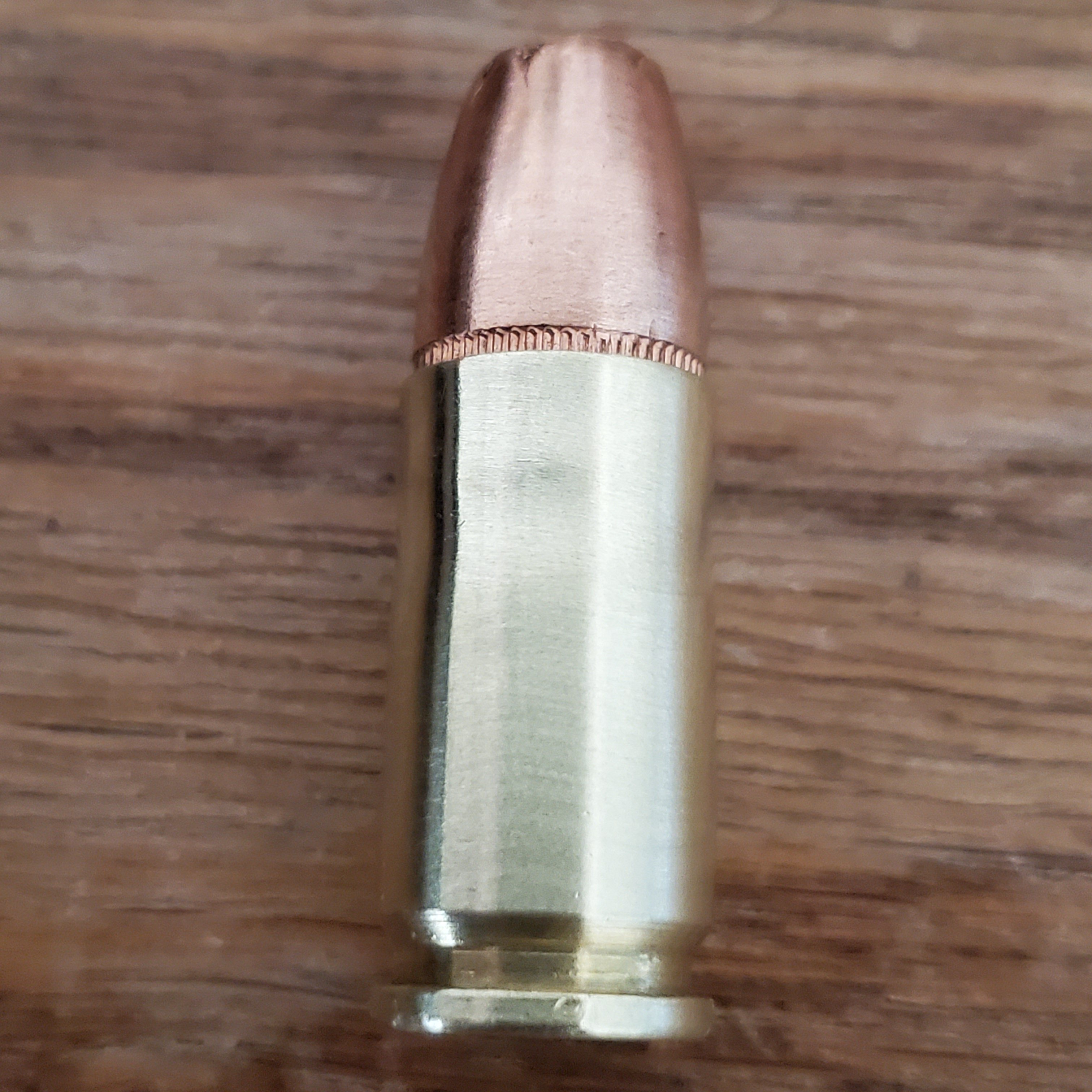

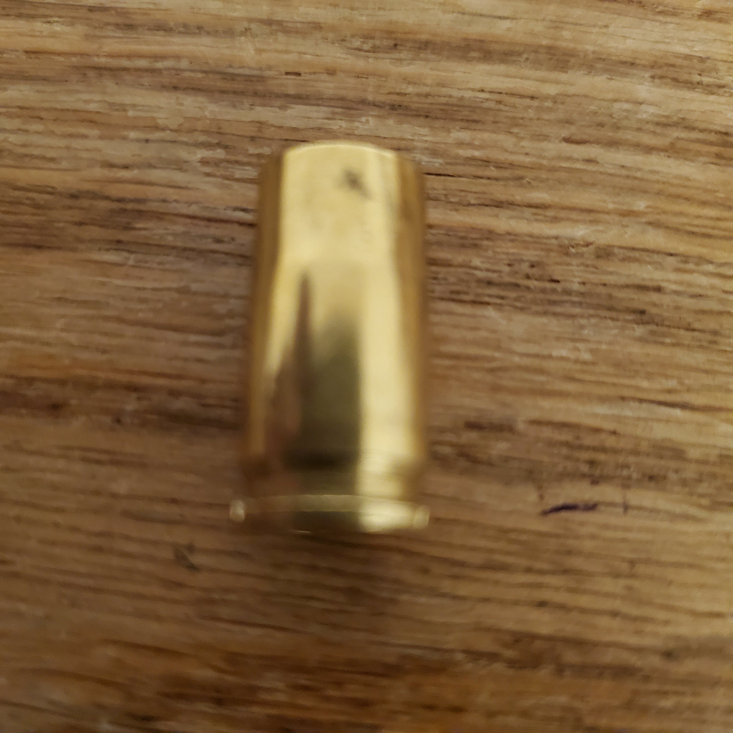

Use a 380 ACP carbide to partial size the case just past where the 9 mm 115 gr bullet base ends. Flair out mouth to seat the 9mm bullet.
Works well for undersize bullets use 454/ 45 Colt carbide die to partially size 450 Bushmaster cases when using .451" to .4505" pistol bullets, if having bullet set back or incomplete ignition.
Reactions: wvfarrier
The 380 carbide die works, here is an example. The bullet slightly bulges the case when seated...and the bullet can not set back. I used it for some .3535" seconds, but this is a .355" 9mm seated.
Some companies Cannelure the case here to prevent set back.
