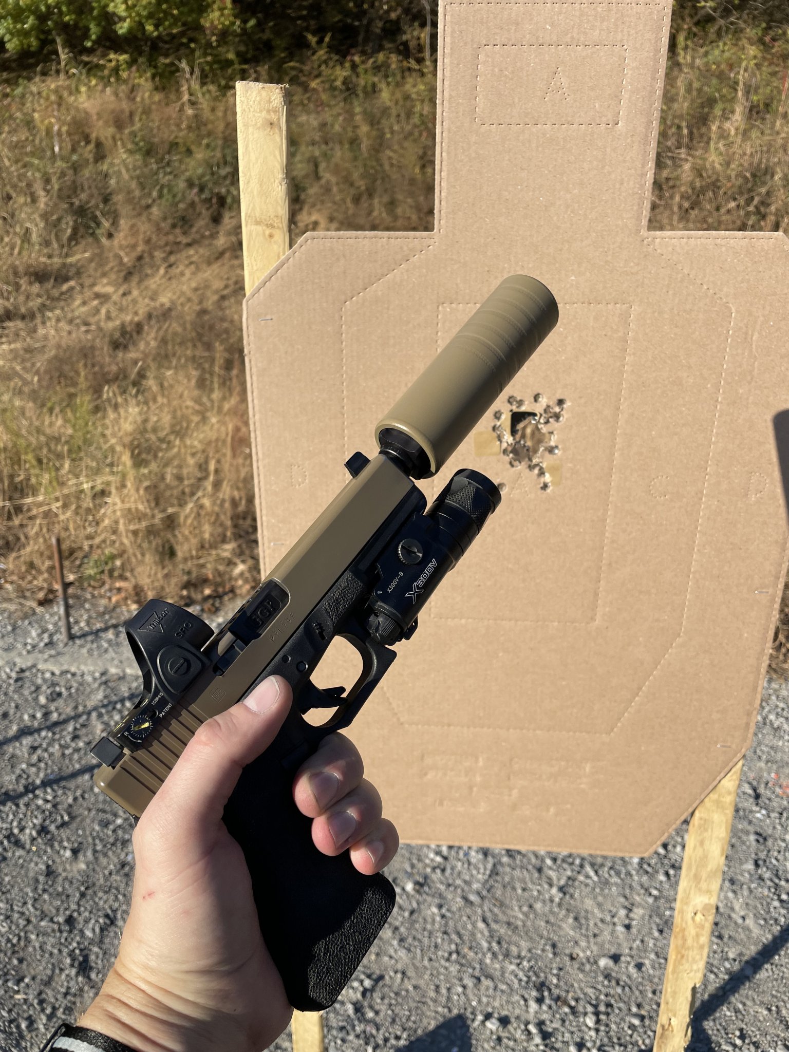

Thanks for the information. My gun and ammo worked great today. No malfunctions and no POI shift with my 124gr USPSA load.
I’m looking forward to loading some 147s and trying a few boxes of the 165s.
