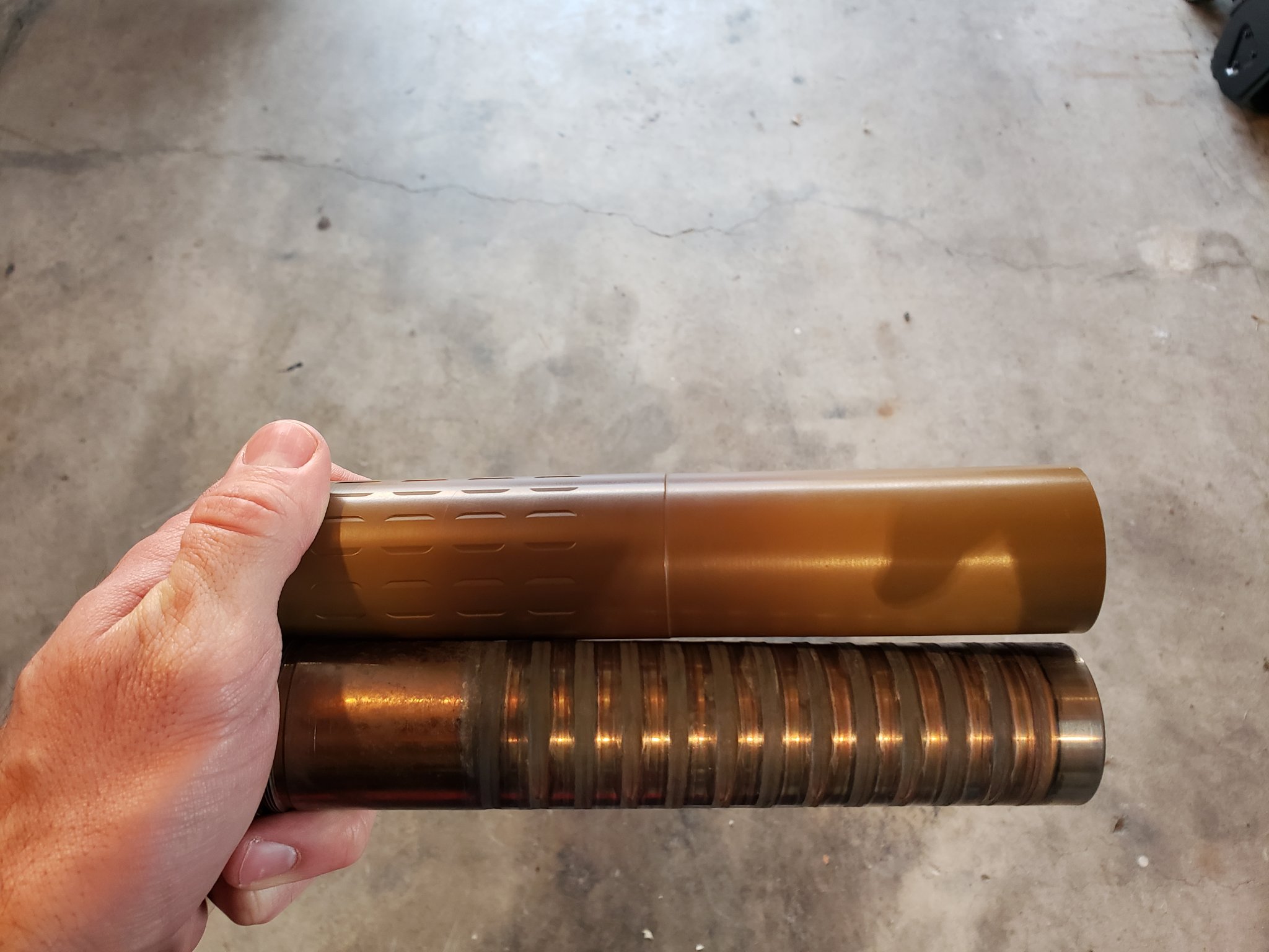

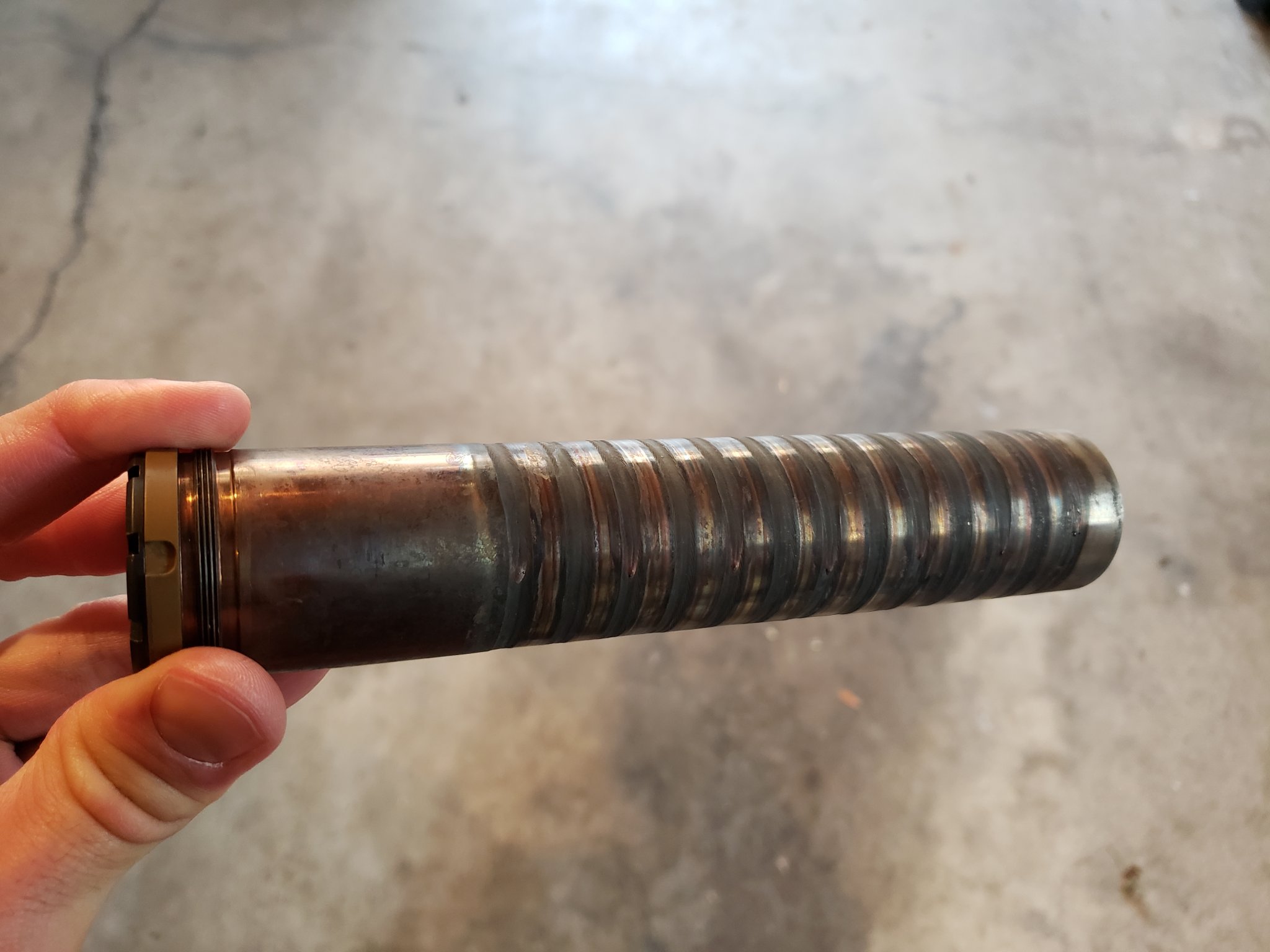

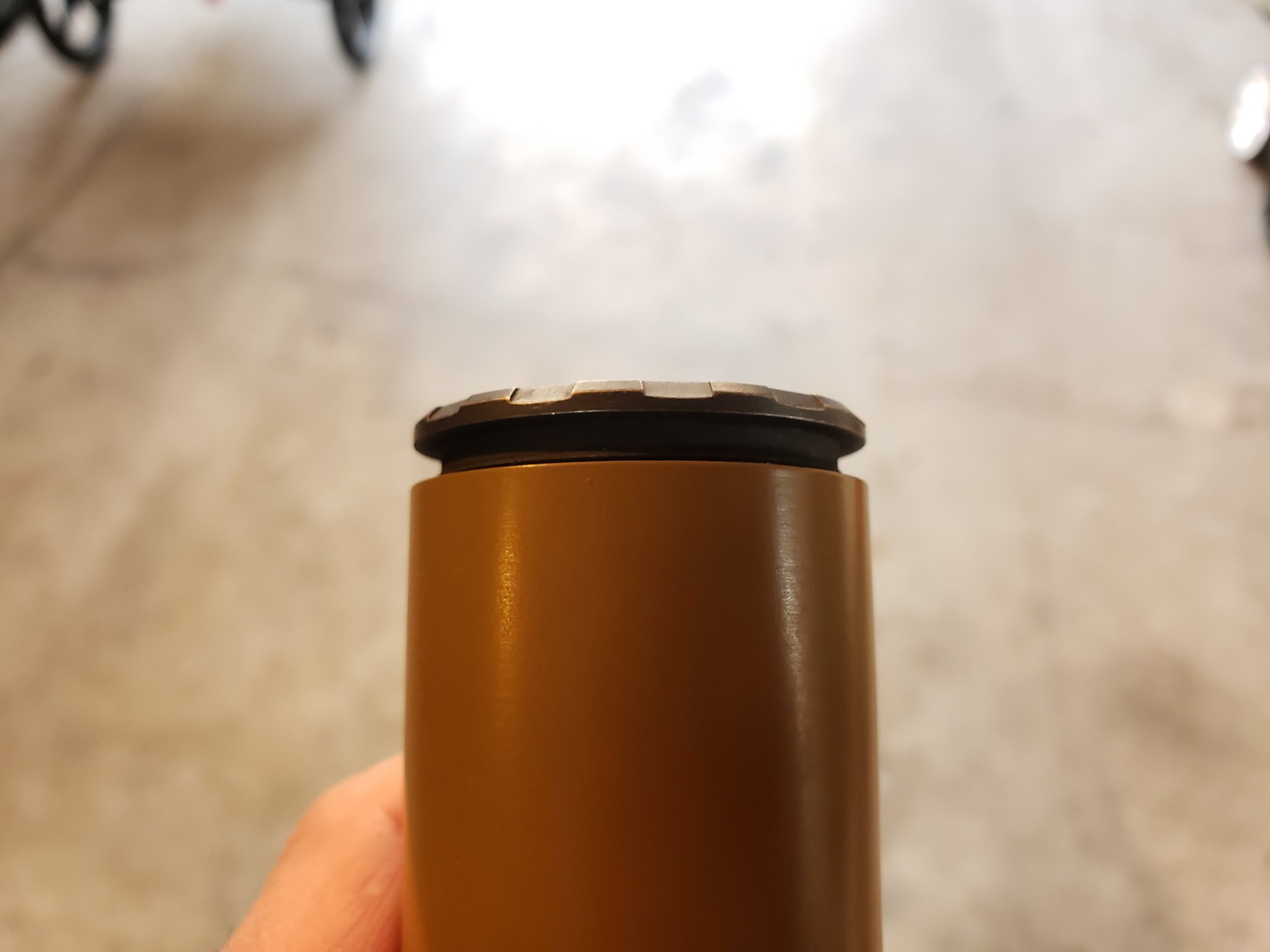

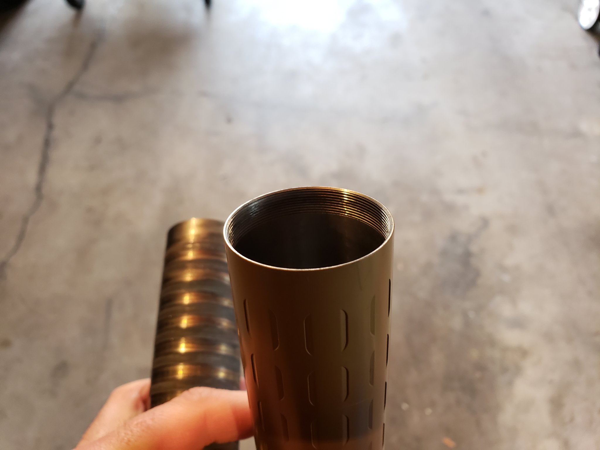

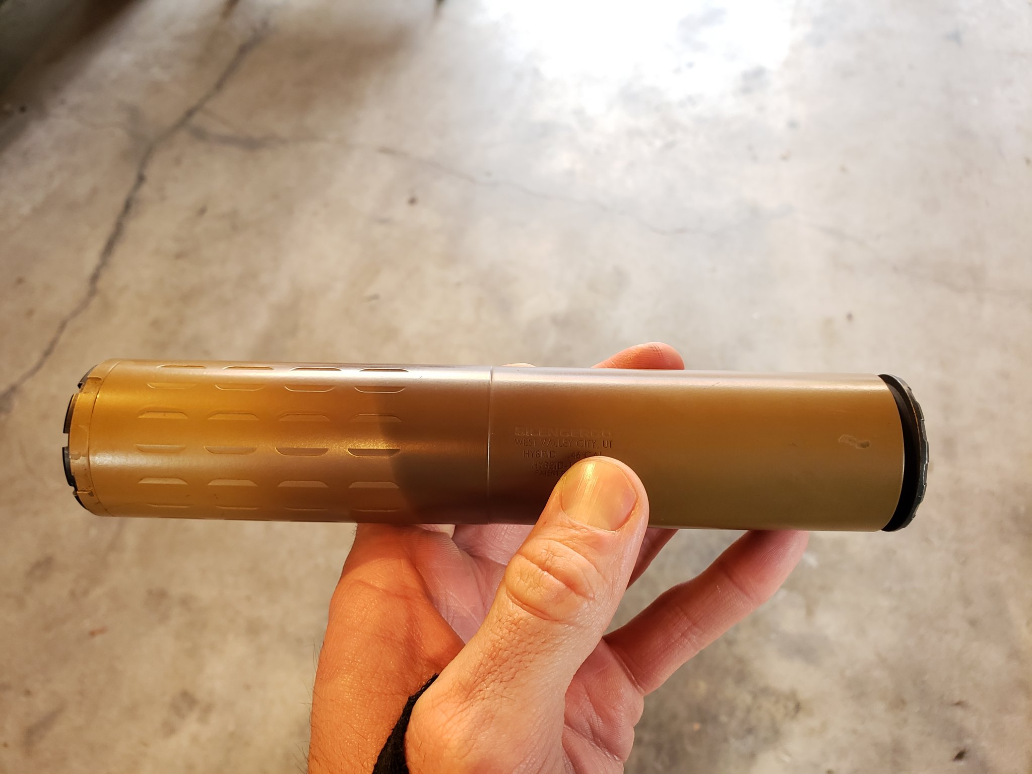

I thought only the Omega was glued. Can not find any info on the hybrid being that way.
They both are I can post a video and pictures later of me taking the sleeve off... The difference is the hybrids sleeve is threaded on the chamber end and the end cap extends over the muzzle end pinning the sleeve holding it in place so it can't go anywhere unlike the omegas where it heads down range out of nowhere.
They both are I can post a video and pictures later of me taking the sleeve off... The difference is the hybrids sleeve is threaded on the muzzle end and the end cap extends over the sleeve holding it in place so it can't go anywhere unlike the omegas where it heads down range out of nowhere.
that makes more sense
I'm not a tech guy can't figure out how to post a video from my phone but here are a couple pics of my hybrid showing the endcap overlapping the sleeve, the threads on the baffle stack that hold the sleeve on etc
