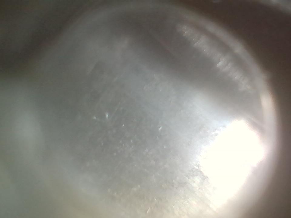

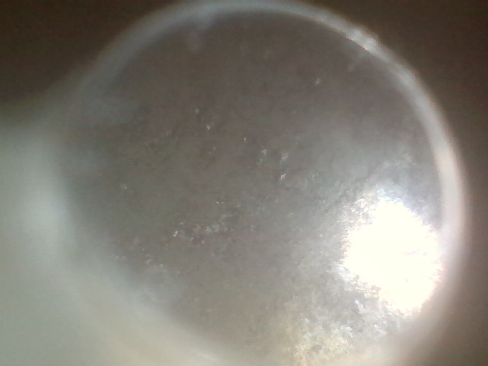

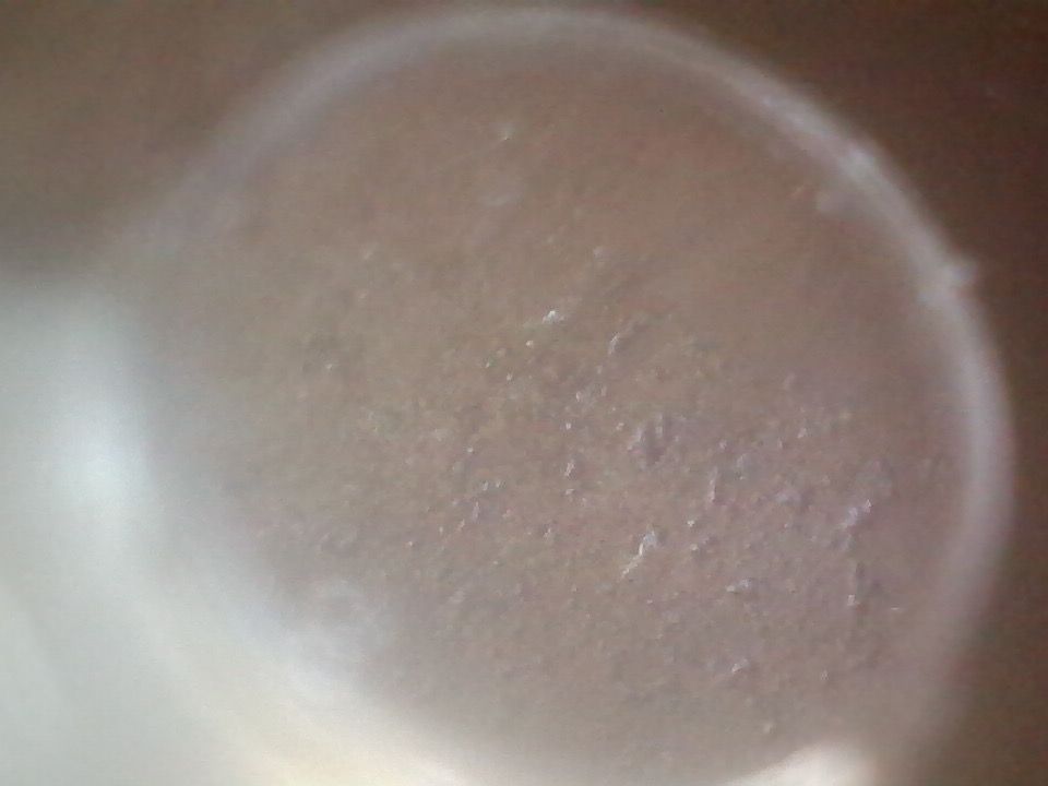

I have a Remington 700P in 308 that is a hammer but it has a rust problem. It sat a while until yesterday when the owner shot it and couldn’t extract the case. We didn’t really know why until we got the case out by driving it out with a brass dowel. Ran the bore scope down it and the chamber is pitted bad. (Bore is pristine) I have tried JB bore compound with kroil and it shined it up but didn’t help the pitting. I shot it and stuck another case. What are my options? I can use the abrasive JB, I can get a cylinder home, or I can try to get my hands on a reamer. I want to save this barrel and not scrap it.

Just an update I was able to get it running again. I got some Iosso and let the drill do the work. I shot 4 rounds, all ejected easily. I will measure that spent brass along with some brass that was fired before the rust issue set in to make sure I didn’t waller things out too much. Pretty sure it’s gtg. This is the only picture I got, which is the worst spot in the chamber.
