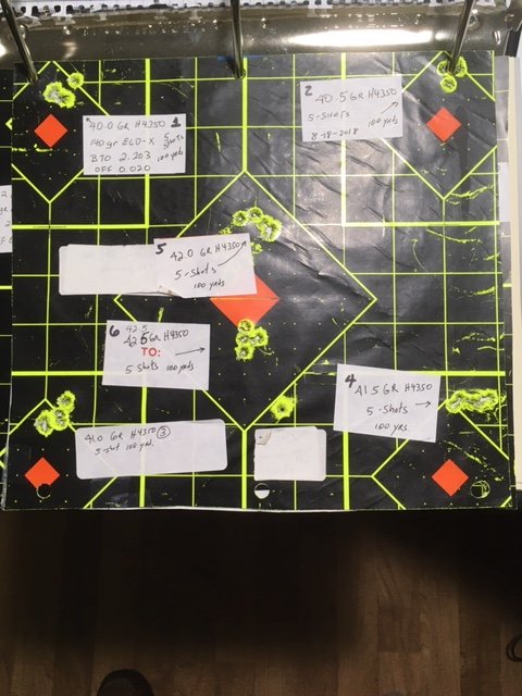

These are a photo of load development that I did back with Hornardy brass and Federal large rifle primers. The Hornardy manual states that Max charge of H-4350 is 41.5 grains!!! I exceeded that but that was my rifle. Please work up. I hope this is of help.

Reactions: docohm
