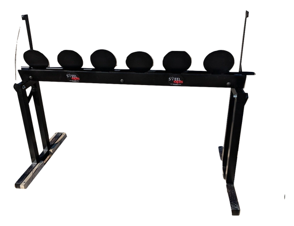

Gents,
I'm looking for a plate rack suitable for use with rifles up to .308.
Frank's shooting one in one of his videos and it has the ability to reset.
Backstory: my wife saw me watching the video and suggested that I might need one for my birthday. Unusual, but when there's a green light I step on the gas. Hard.
Thanks in advance and God bless America.

Many thanks for your replies. When I asked the question I figured $1000 ish. Was I ever wrong.
Spife is right. For the money i could spend on a resetting rack I could have steel at 100y increments out to 1000. For cheaper, really.
Thanks and God bless America

But, if money is no object that Steel Ops rack looks really nice! I'll bet it's no joke to transport though. I will never stop being jealous of all of you who can shoot off your porch. I'd have all sorts of shit out there, like Hickok but far, if I could shoot at home.
