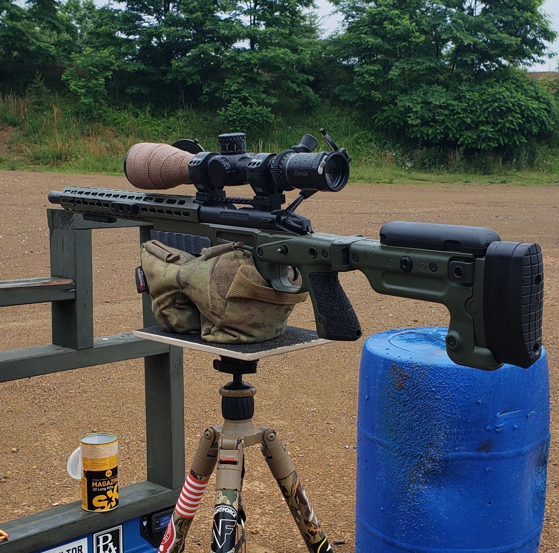

Plate to go on top of tripod
SourMash
Aug 18, 2012
228
183
GA
was at a rimfire shoot this weekend. I saw a man sitting on his tripod like it was a perch. he had some sort of a plate on top of it. I cant do that but Im curious about the plate that he used. It could be used to hold a bag or even as a very small table? Just wanted to know where he got something like that. Sorry but I dont have any pictures of it

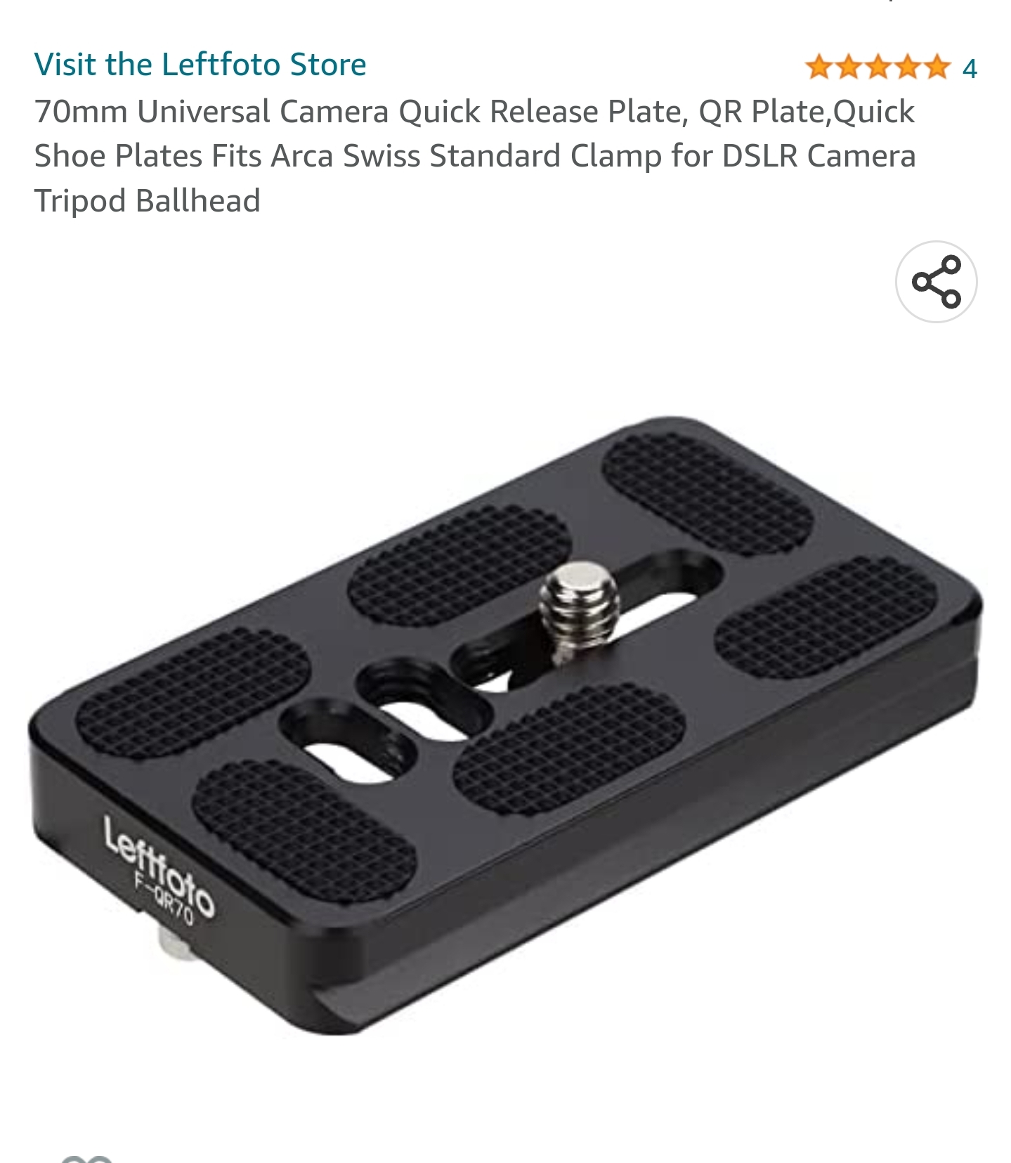

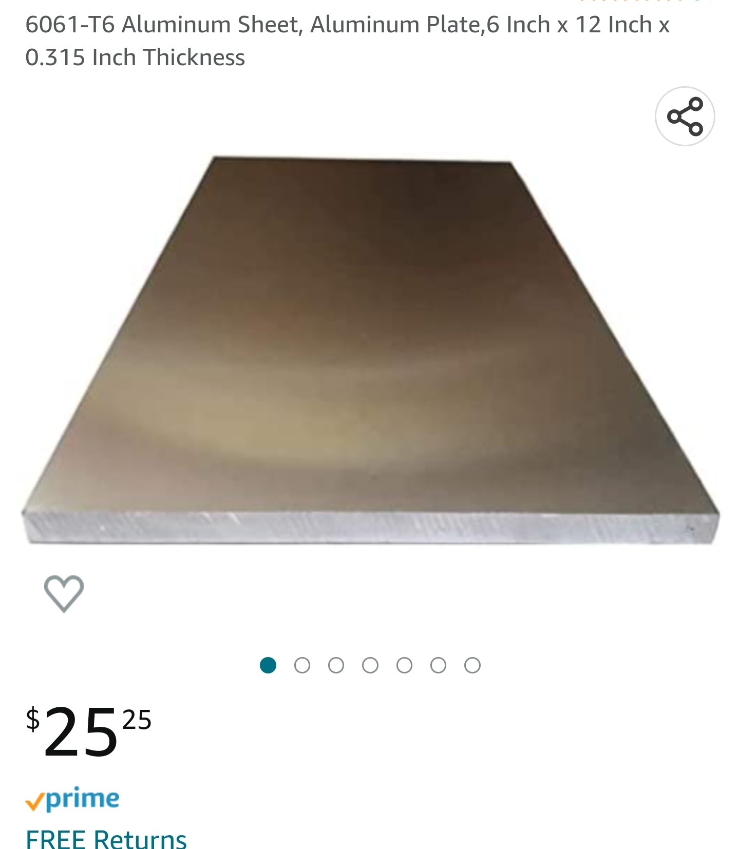

I bought two items from Amazon:
a 6x12 aluminium plate. Smoothed out the edges and painted it. On the bottom i drilled and tapped a hole for a ARCA plate screw.
Attached the ARCA plate to the aluminum plate.
Atrached the whole thing to my tripod..
Nutin fancy, but gets the job done for sure

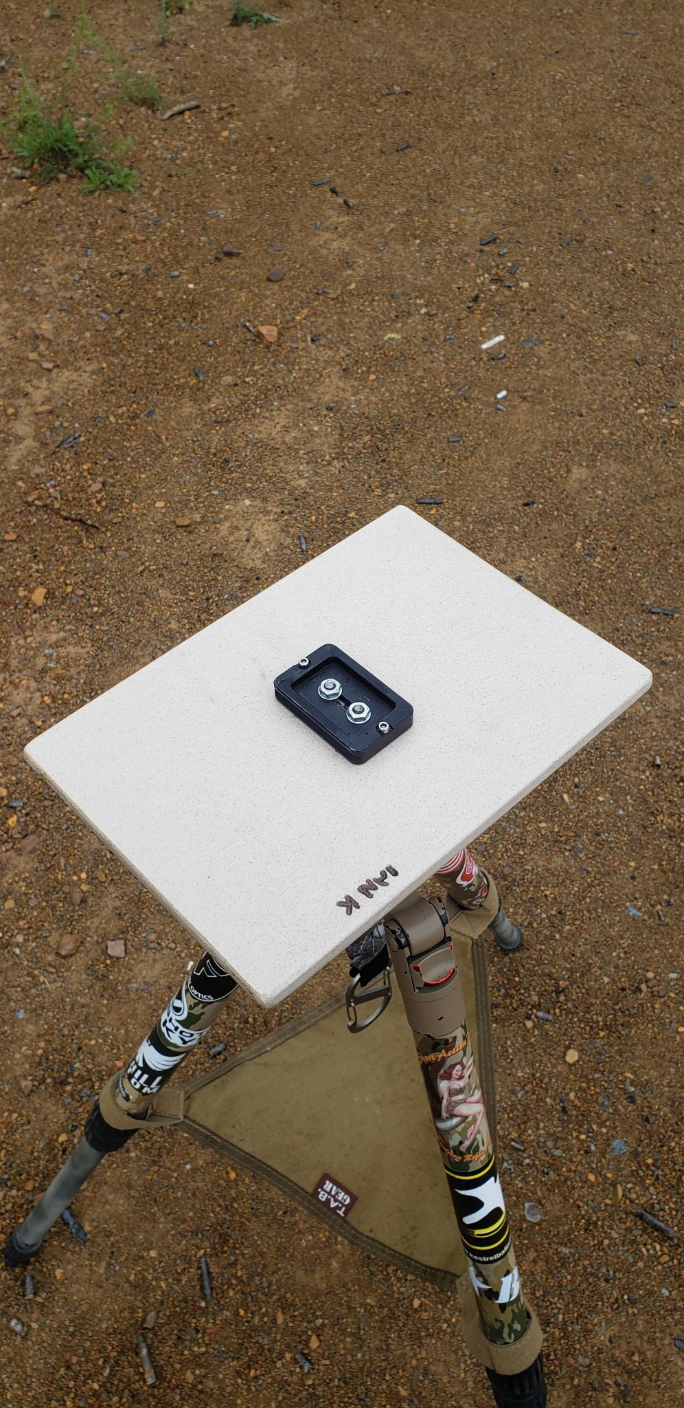

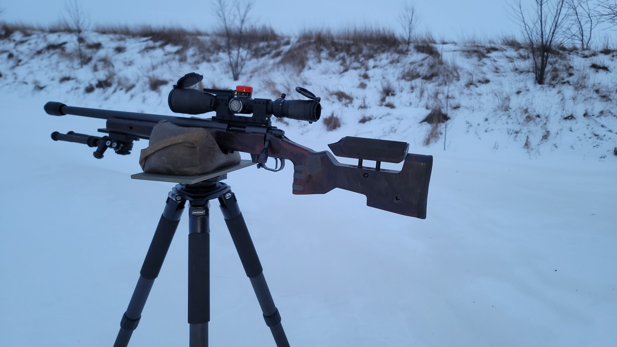

@Badjujuu thanks for the pictures and the idea! I ordered the same piece of aluminum and I had a cheap arca rail here at the house. Also had a can of “spray on” truck bed liner which worked out great as it left a texture for the bag.
