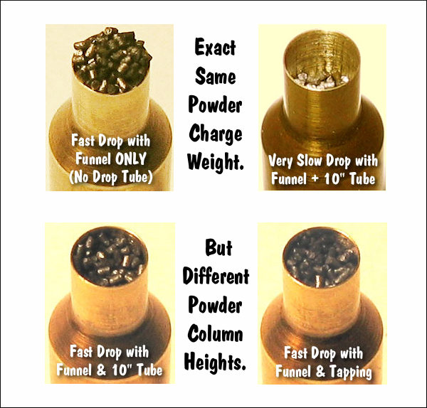

Drop your powder into the case using a funnel with long drop tube. Your powder will settle better in the case.
I’ll give that a try, currently using the rcbs goldish colored one that came with my kit. It has a fairly long nose the pour the powder but maybe I’ll try something else or work on leveling it differently
